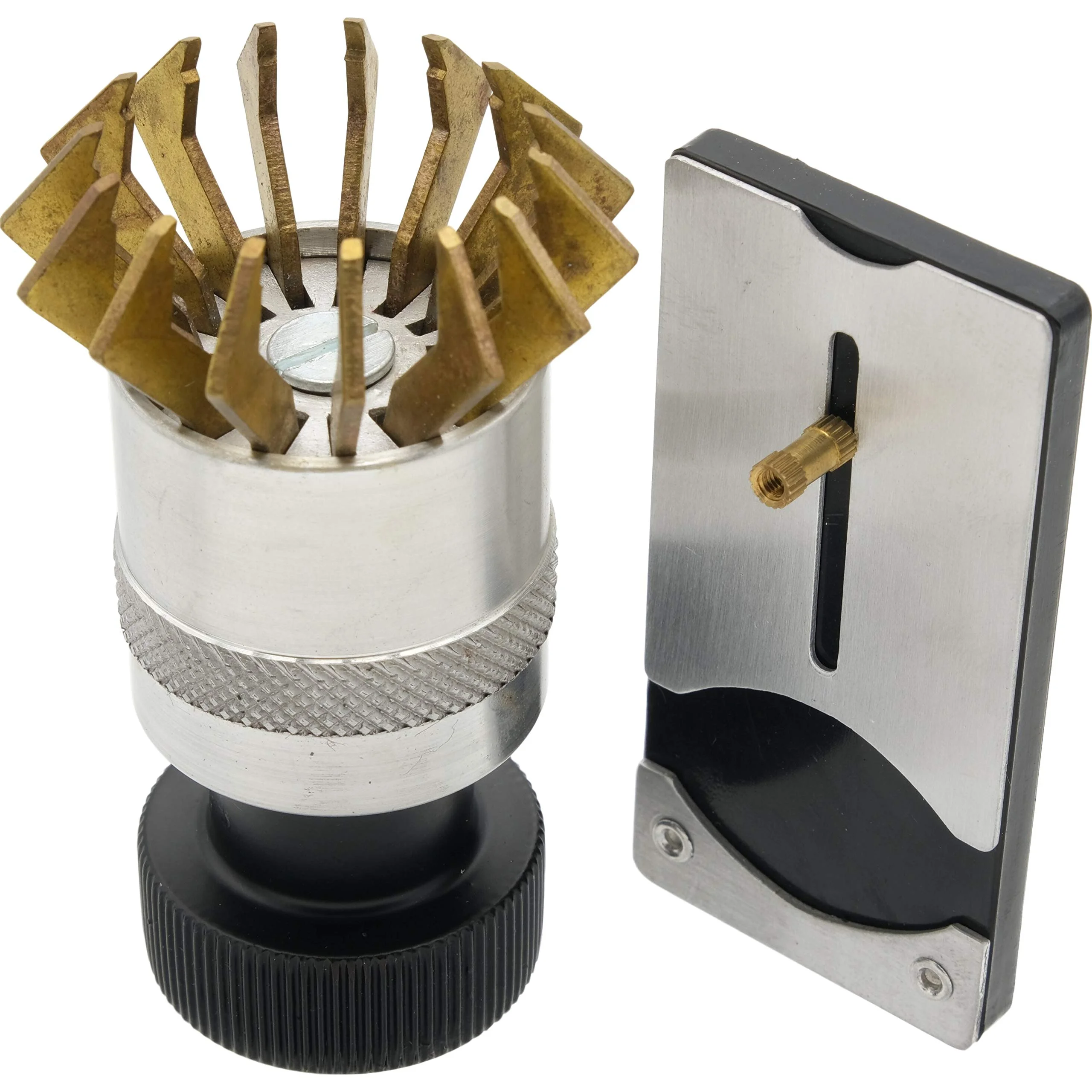

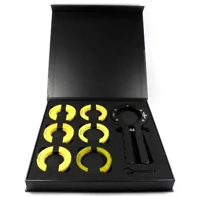

One of these:
My question is, now that the bezel is off, how does the crystal come out. A normal front loader has a plastic crystal with a boss to hook a crystal lift onto. I can't see that in an Aquaracer.
Edit: Here's what's needed for a crystal lift:
From the G-S catalog. Notice the step near the rim; it's a cylindrical region for the lift to grip.
A crystal lift:
Still, this requires a plastic crystal to be flexible enough to compress into the case. Also, the case needs to have a tapered lip to grip the crystal once installed.

I will probably go for the Bergeon BG7052 tool which uses the same ring inserts as the tool in the above pic, just a smaller hand grip. But still not sure how to apply the force (assume it must be twisted in the normal bezel rotation direction) or if the bezel needs to be in any certain position to be able to lift it up.
792
915
The 7052 uses screws to tighten. I considered that but the 7152 was recommended.

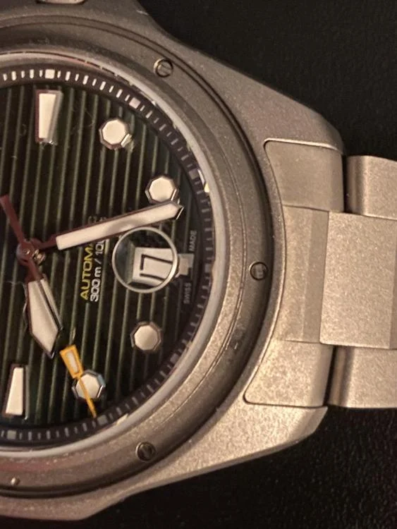

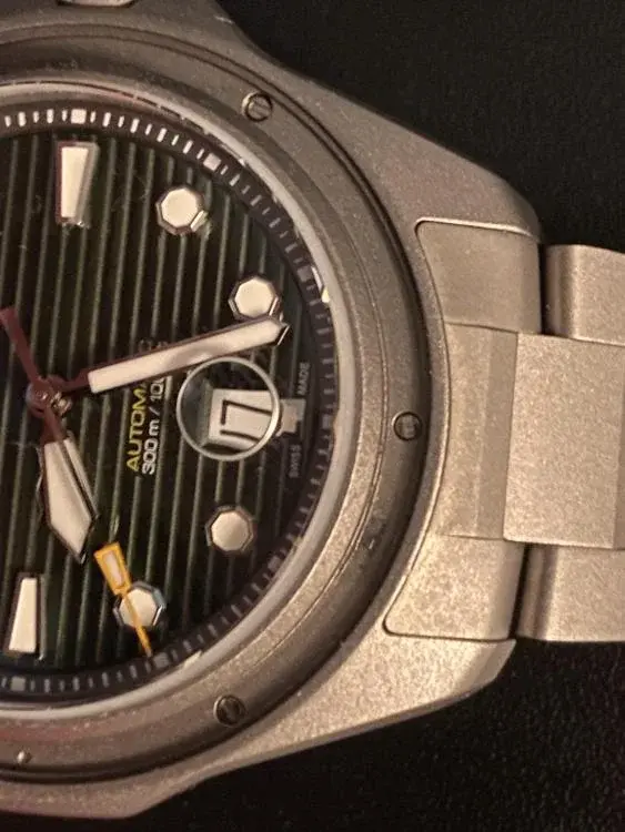

Here's a shot of the screws (snaffled from watchrepairtalk via a couple clues on WUS [thanks Timeless Epoch and nnt]):
They are under the spring plate that makes the bezel ratchet.

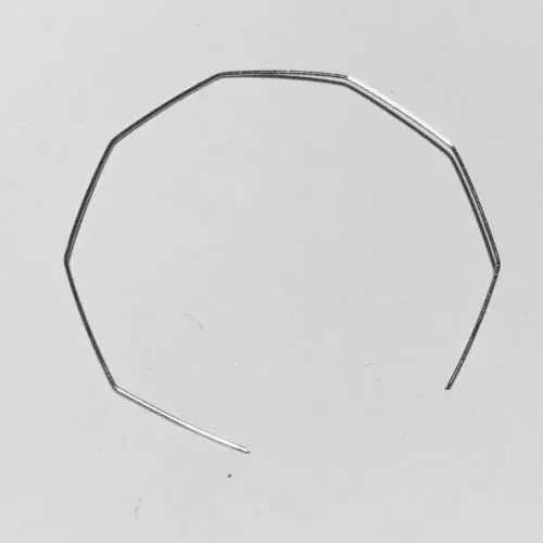

Some more detail about the bezel attachment. Picture a groove turned into the OD of the cylinder that holds the crystal. Also, a matching groove in the bezel, only turned into the ID. Now picture a "wave" wire like this:
The points are sized to fit into the groove in the bezel such that the flats protrude beyond the ID of the bezel, in fact into the groove in the case.
What happens when you pull and twist is that each flat grabs the edge between the case OD and upper groove wall. Twisting causes the wire to distort until the flats are all pushed into the bezel groove and clear the case OD. Voila, the bezel pops off.
The clue is to pull really hard, but also put even force on ALL the flats at once. That's what the tool does, lets you apply this even force.

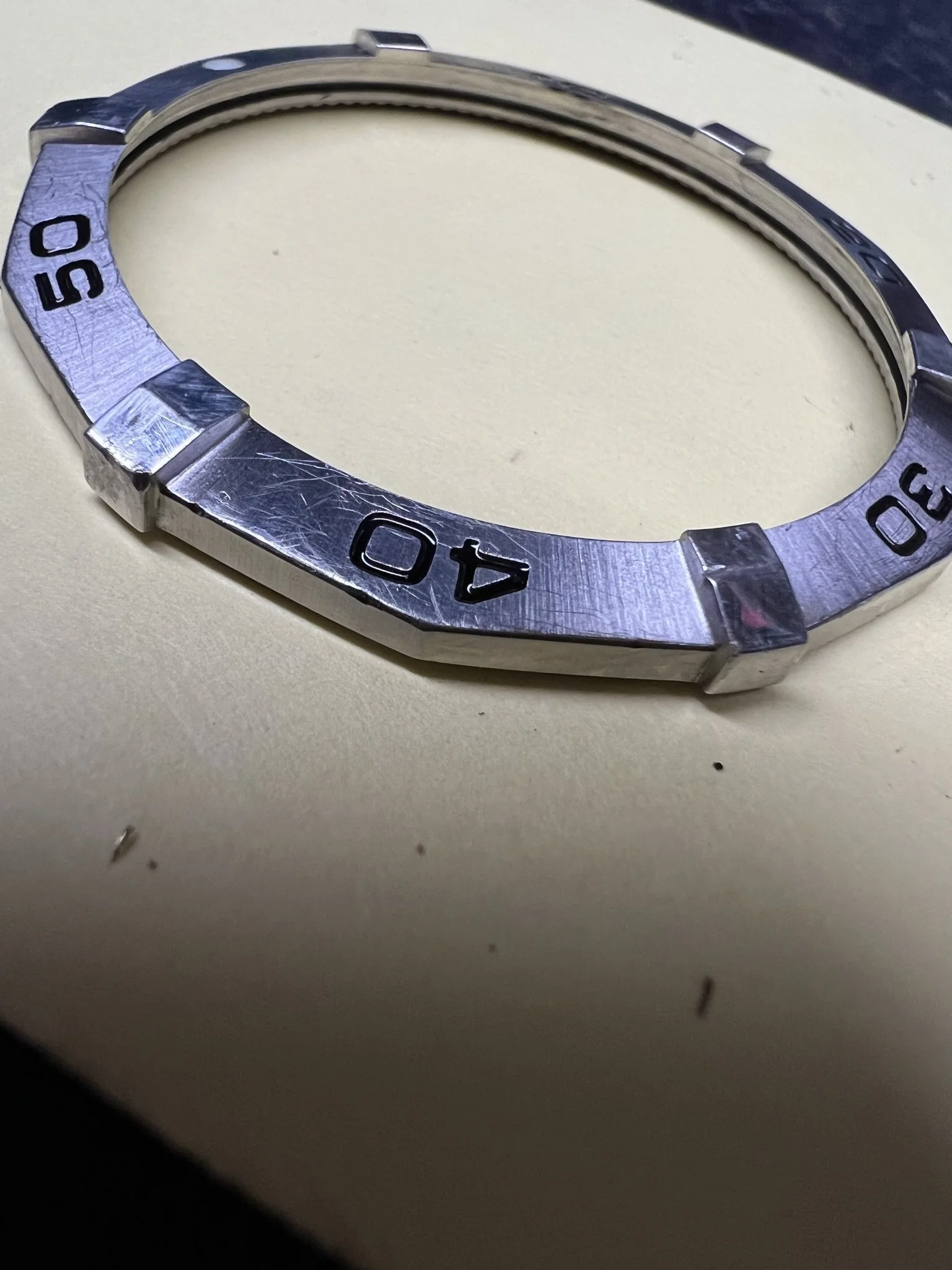

I learned this the hard way on a WAF2010 by prying between bezel and case, but on only one place at at time. I was able to remove the bezel (and figure the rest of this out) but it took me a couple hours to straighten the bezel back out.
Here's the bezel after a engraving redo:
Oh, and many years of our son's abuse.

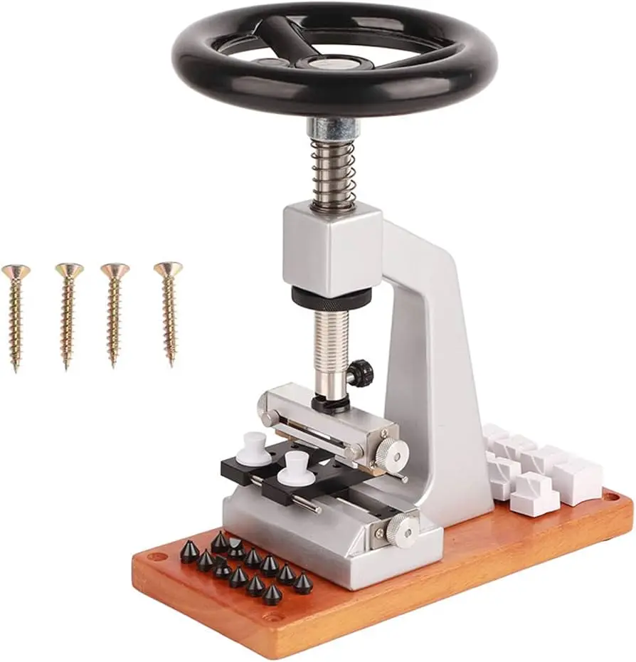

My old 2000 was frozen solid. I used a breaker bar (a hollow longer cylindrical extension) in conjunction with my case vice/clamp and case-back tool remover wrench. That gave me enough torque force to do the trick.

Wow. How on Earth did you get the tool to stay in place? That seems to be the biggest issue really, constantly slipping out of the grooves. I probably need a better tool... but even so. I can't imagine wafting it around on the end of a bar.
I had visions of you a tool like my breaker bar, 1 metre long with a 3/4” drive on the end for using with sockets on troublesome bolts! Glad you explained.::facepalm1::

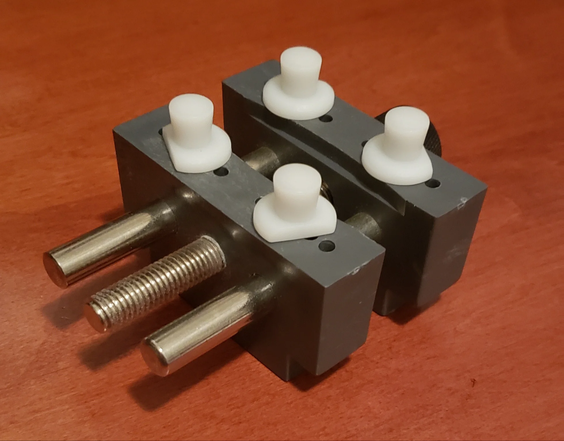

So how do you hold the case clamp still ad how does the watch not slip out of it? Maybe that's a Kirium problem, very slippery shape!
I was looking at these things..
Looks helpful since you not only hold the watch but your applying force to keep it in place from the same base.
Plus you can screw the whole thing to a bench
I didn't keep the clamp still. I turned it clockwise with the bar, turning the case-back cover counter clockwise with the remover wrench at the same time. More force coming from the breaker bar clamp side, keeping top down pressure on caseback cover side and everything flat on a table.
That tool looks like it will do what I basically did in a less professional manner. But if it's really stuck, the bar I used can apply more force than that circular handle.
I think the shape of the Kirium is problematic if it won't stay firmly in place in the clamp
