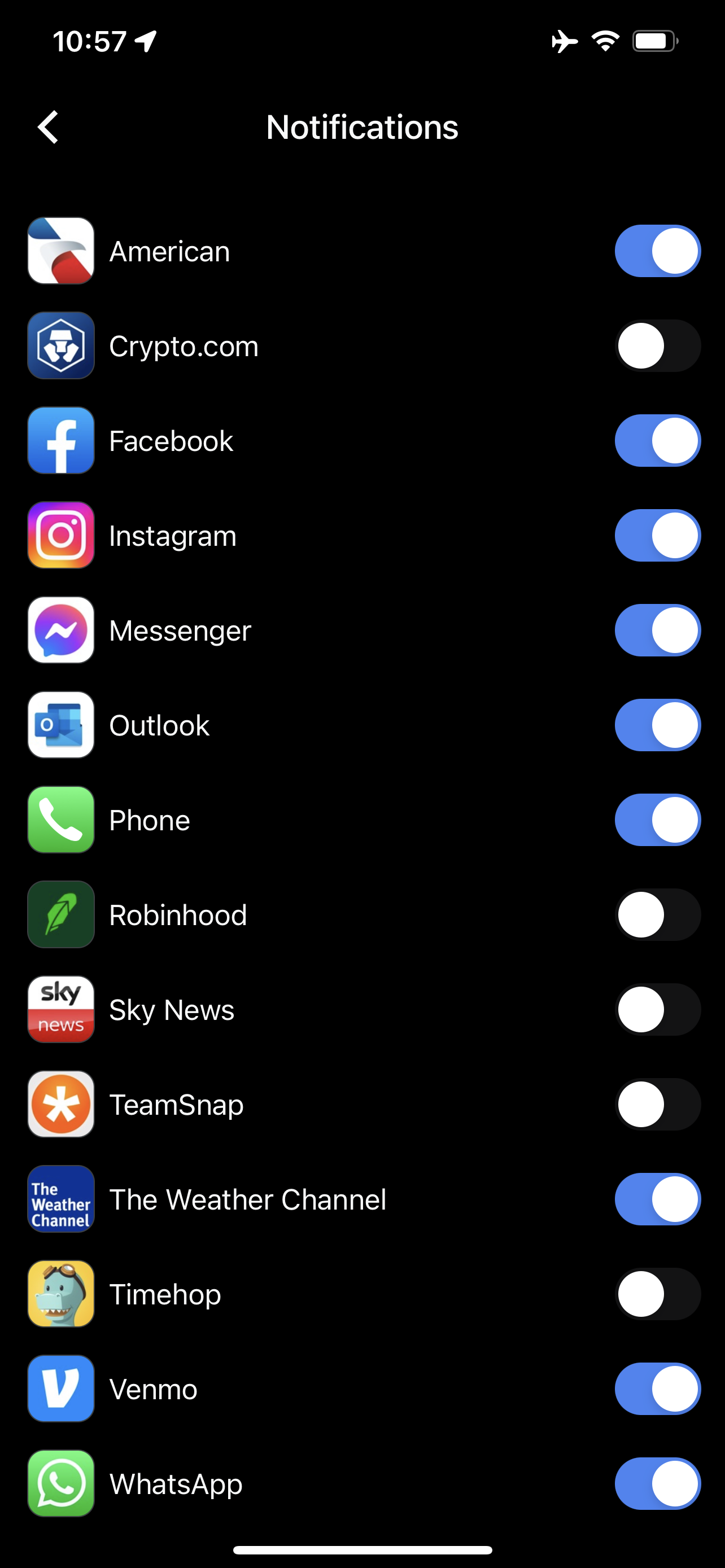

Hey everyone,
would someone be able to help guide me please? I got the connected watch and on the notifications on the Wear OS app, the option for notifications for messages isn’t there.
Does anyone know why or how to get this as I’m assuming this is the reason my watch isn’t receiving sms or iMessages.

I would try to delete the wear os app and reinstall.
Then you need to re pair the watch.
See if that helps. I've not had that problem when using Iphone 13 pro.

Just use the phone and watch (paired by bluetooth, and with the Wear OS app on the phone always running at the background) during some more time.
Not all the app notifications appear at the same time since day one. Some of them are apperaring during the first days of use, also when these apps are asking for it

Has anyone resolved this to get iMessage notifications on an E4?
I had the same issue and found that turning off iMessage on my phone, rebooting both devices, then turning it back on helped get notifications working properly again.
Had the same issue when setting up my Wear OS watch. Turns out my phone’s notification access was turned off for messages. Once I toggled it back on in settings, it worked. I also run a small side project with a sip trunk provider and learned how important notification settings are for real-time alerts.
