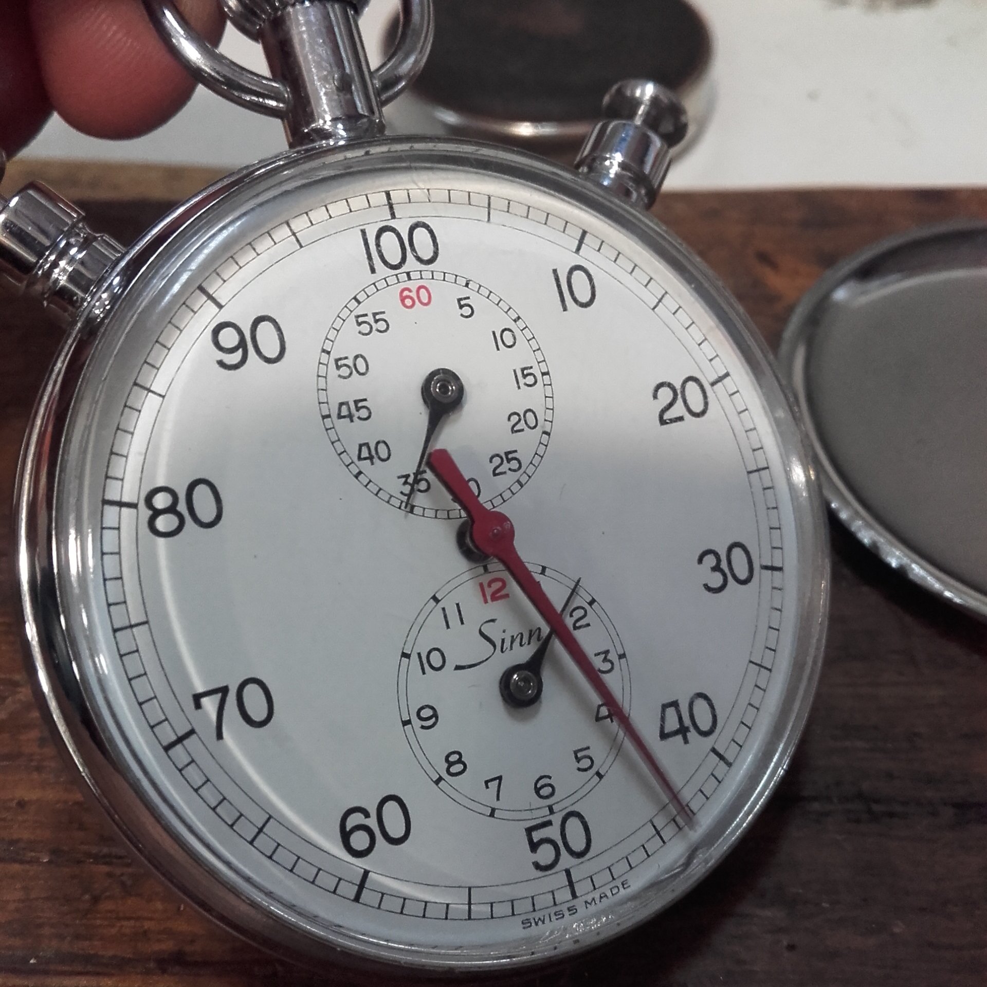

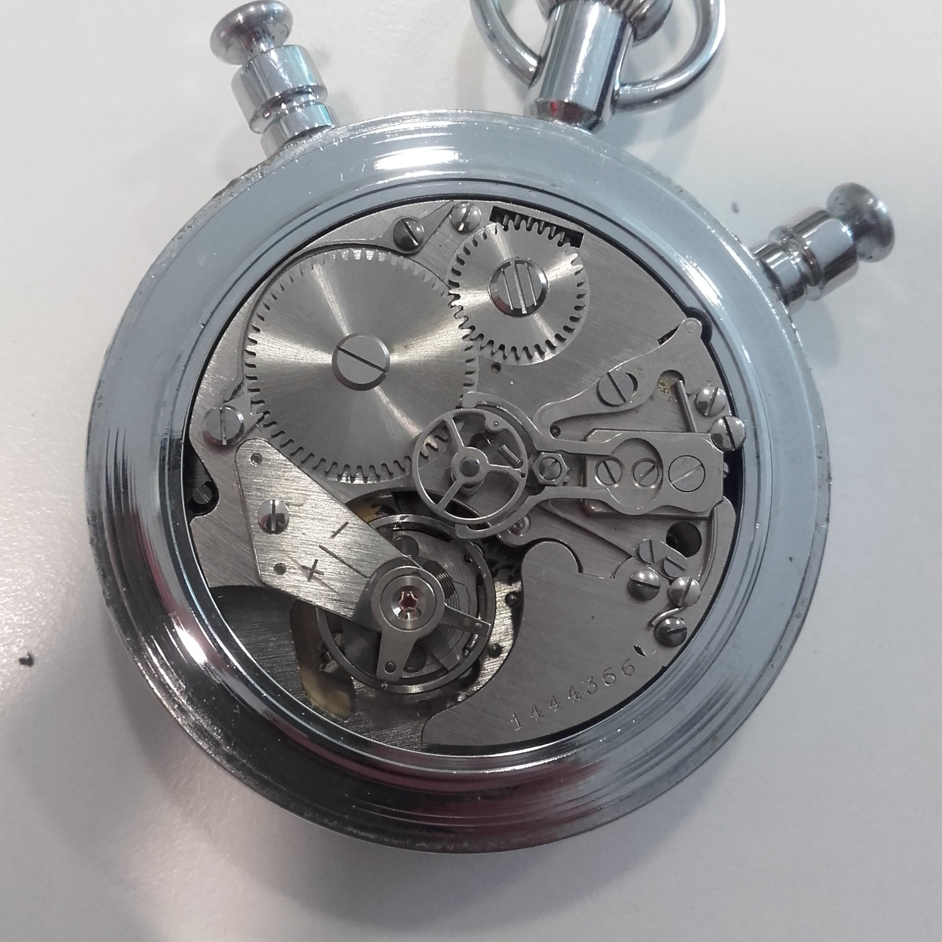

Hy,
I got this stopwatch Sinn and when look at movement i see its made in Heuer style. Becouse I can not find caliber number inside and I did some search with no positive results I am asking if some1 recognize this caliber? Thank you for any infos.
Its split second stopwatch.
643
765
Try a search for Sinn rattrapante stopwatch and you may find same models for info.
Maybe worth checking with Jeff over at On The Dash as he has some experience with Heuer stopwatches I believe.
7,124
15,117
Heuer did not make its own movements for Stopwatches- they were supplied by Valjoux, Baumgartner Freres/ Lemania and others...so yes, the movements would be exactly the same
