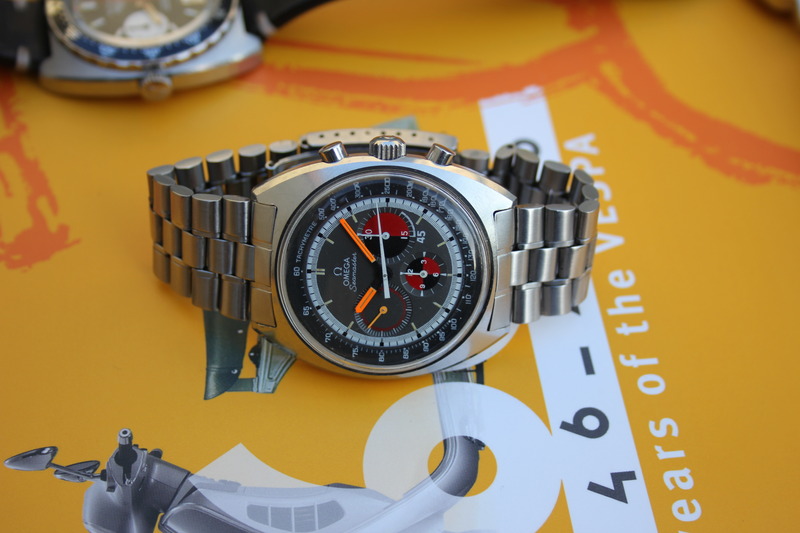

Heres mine. Currently strapless.
The minute hand is wrong, not for this watch. It's thinner, too long and may scratch the inner bezel any time. The orange time telling hands should normally go with the black/grey dial. White dial usually has the black time indicating hands set.
Also, the dial doesn't look centered, likely because some movement spacer/retainer ring or spring is missing. If you pull out the crown, does the dial move as well?
13
Thanks TNT
I suspected the watch was a mixed bag of parts. When I got it the bezel crown had a hatched design which I had replaced with an Omega one. The second hand is clear of any obstruction. I dont know if the picture shows? Yes the dial moves when the crown is pulled out. Check out the other pix and feel free to comment. Thanks
2,876
1,962
I mentioned the minute hand that is wrong, not the chrono sencond hand.
This confirms the missing part or parts I mentioned. The movement is not being held by the proper parts at the moment. Do you have pictures of the inside?
33,160
37,893
That's an absolute franken, its not even a genuine Omega movement, just one of the other off brand Lemania movements that someone has tried to fake into an Omega Cal 861 by adding an Omega bridge to it, but they didn't even get that right as its a Cal 1861 bridge...
That's all sorts of trouble in there.
