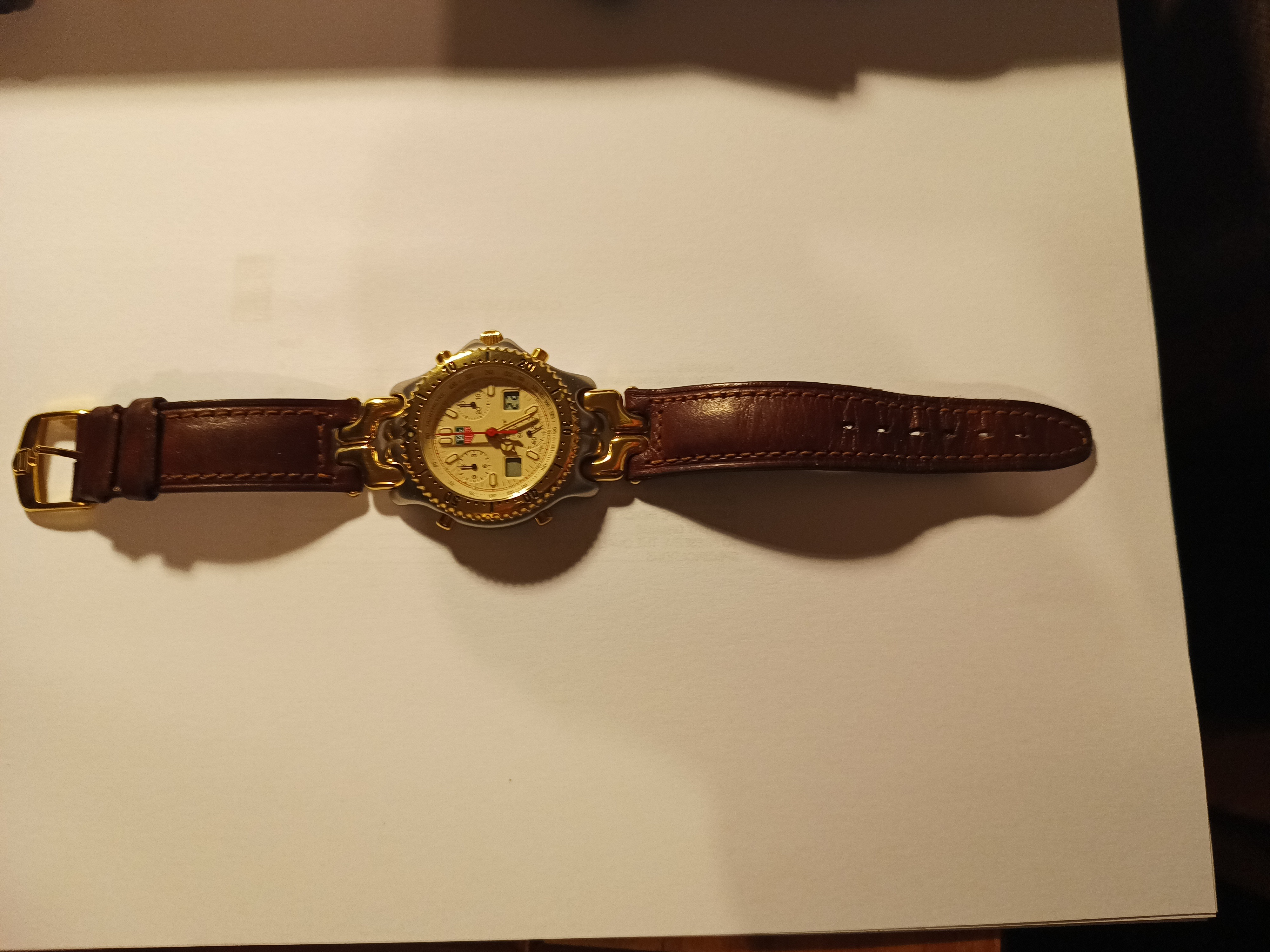

Hi
I have just acquired SEL CG1123-0 which came without instructions, I have got instructions for the Chronograph functions, but I don’t know how the left hand buttons work for the 2 digital displays.
I would be grateful if anyone could help me with this.
Steve

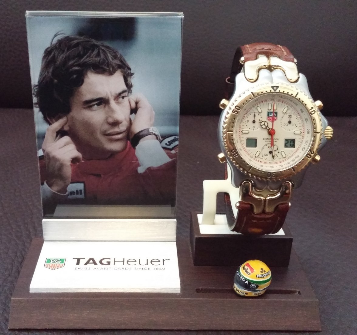

My Idol
Hey, this one is actually my picture of my watch and my stand! 😀

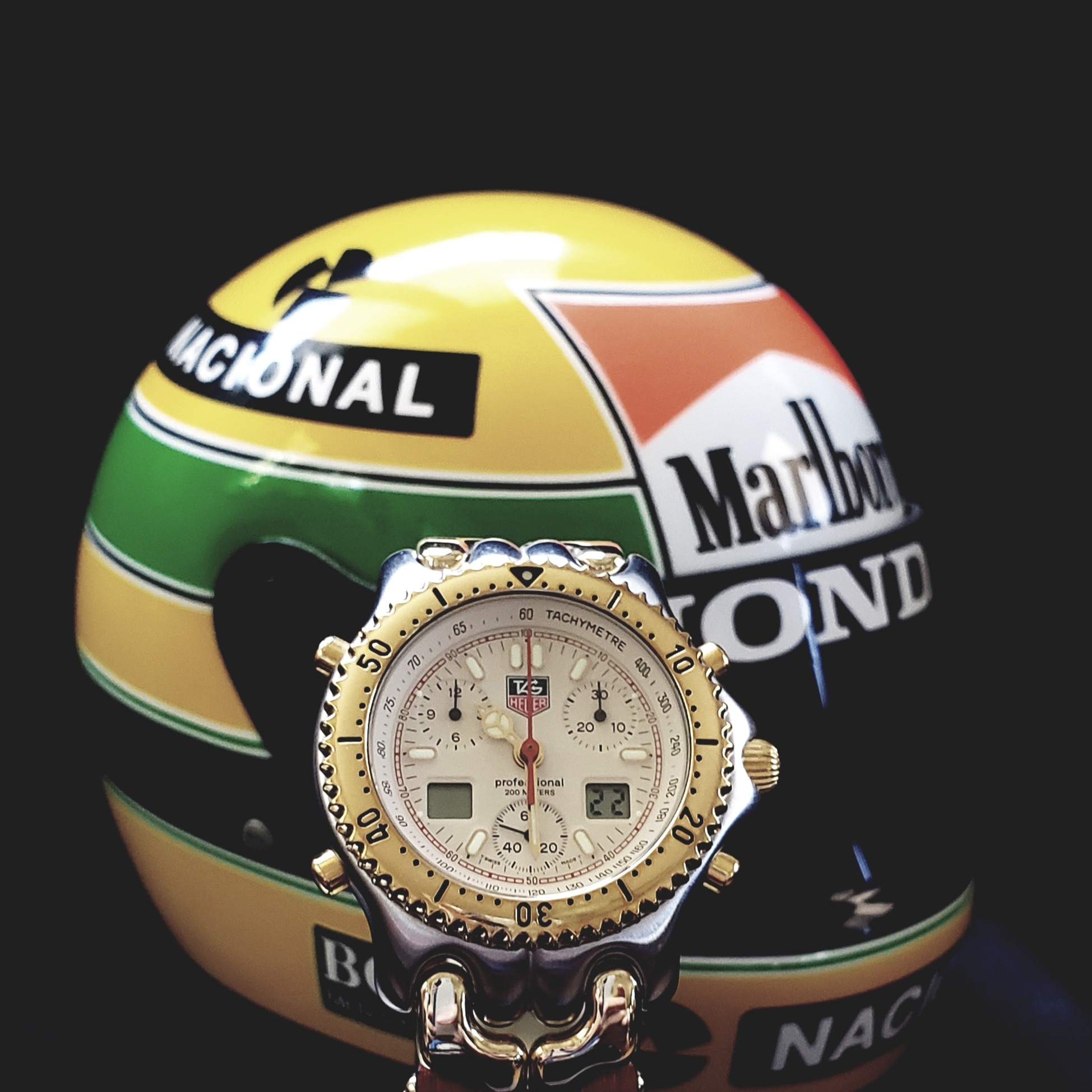

That is a seriously grail watch for Senna edition fanatics like me.
125
559
Huge congrats! A grail watch for all Senna fans, as stated above. My S35.406 says hello!

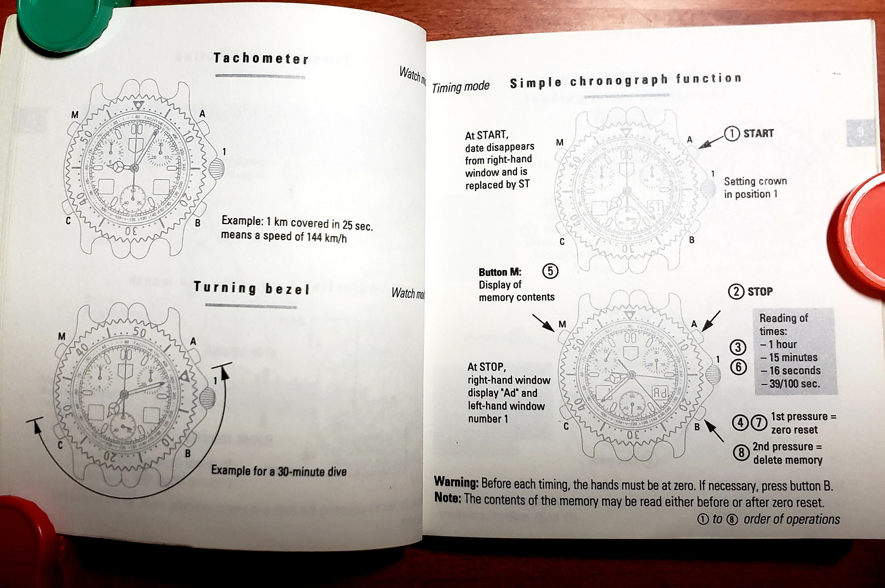

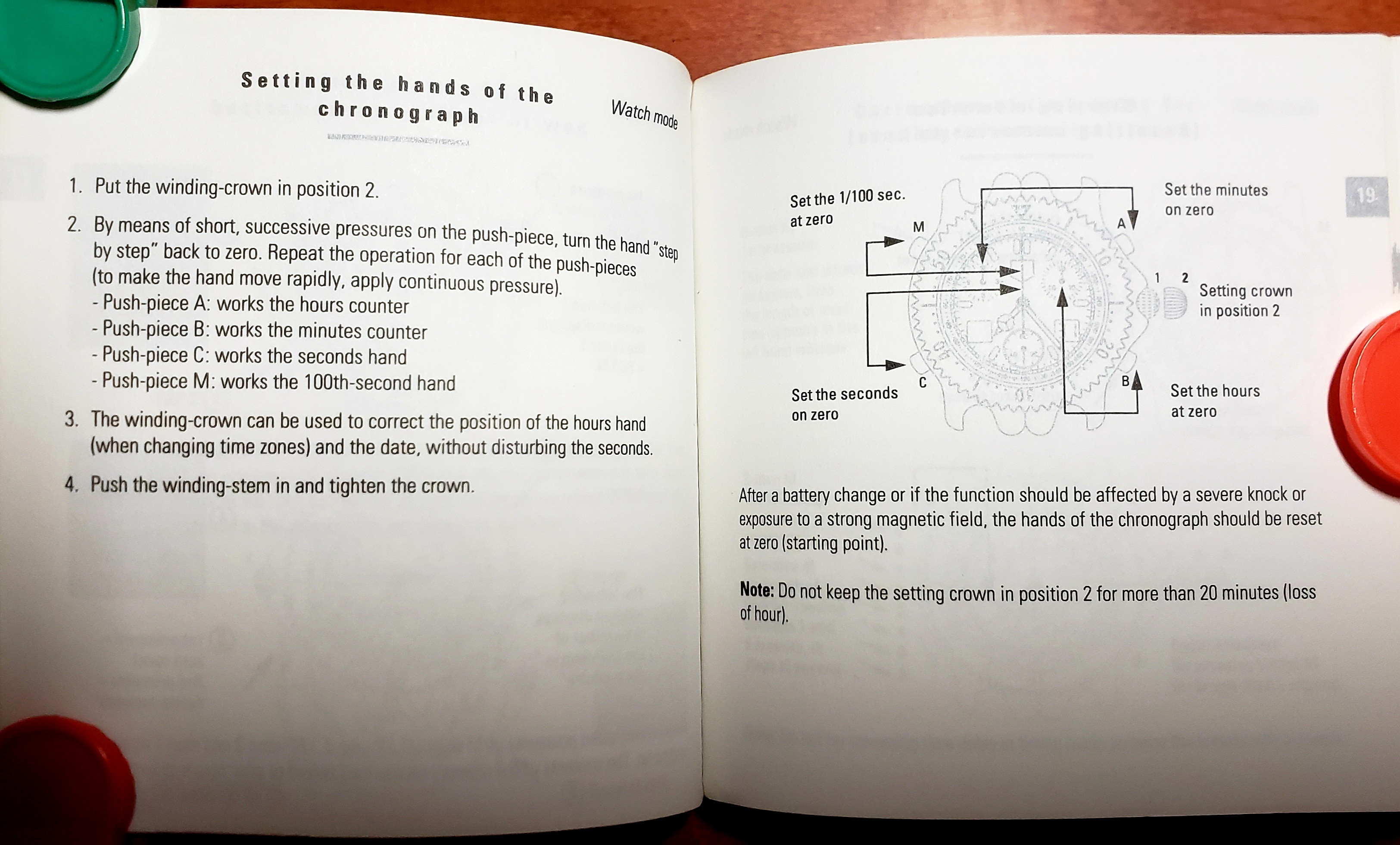

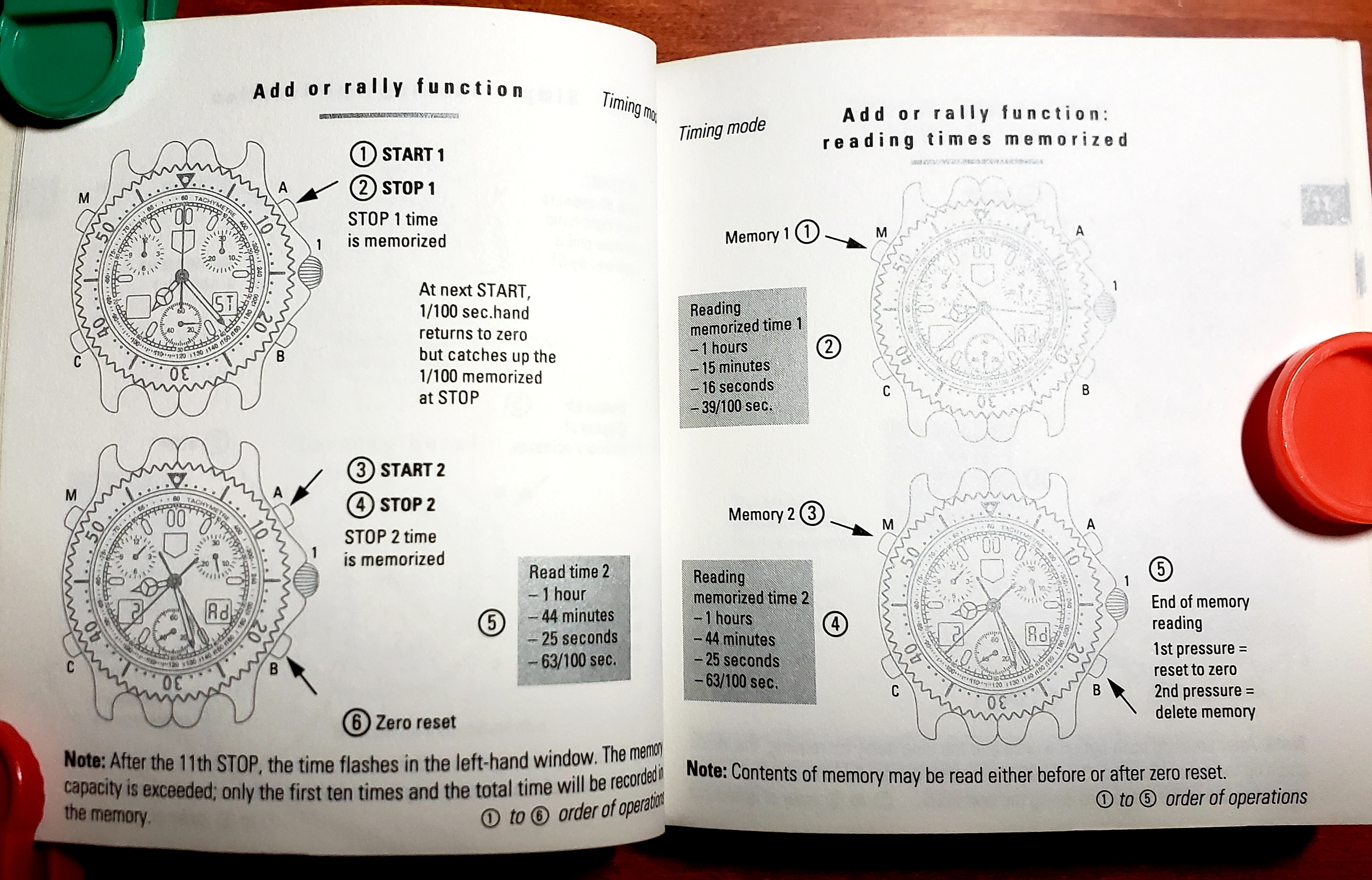

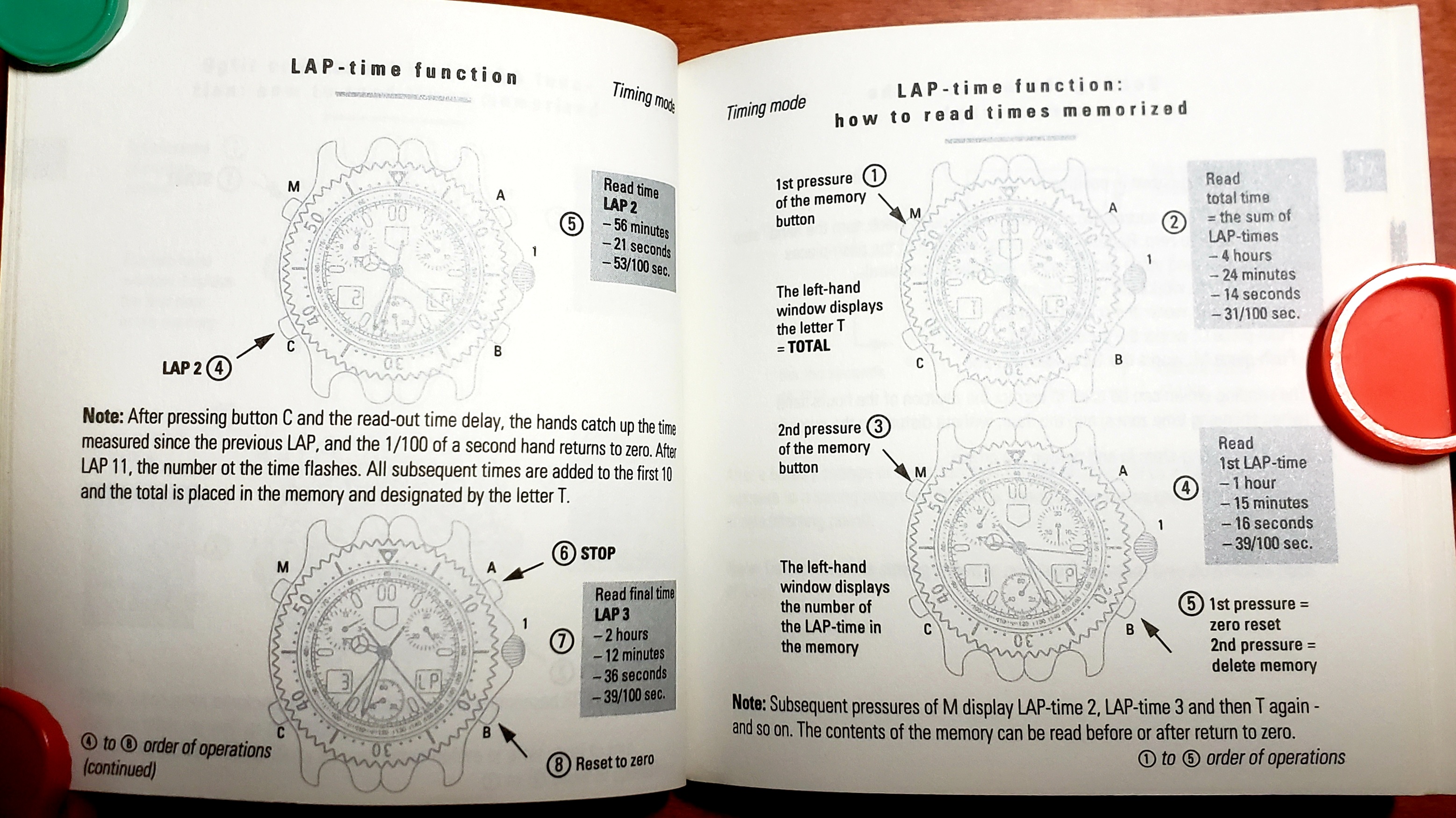

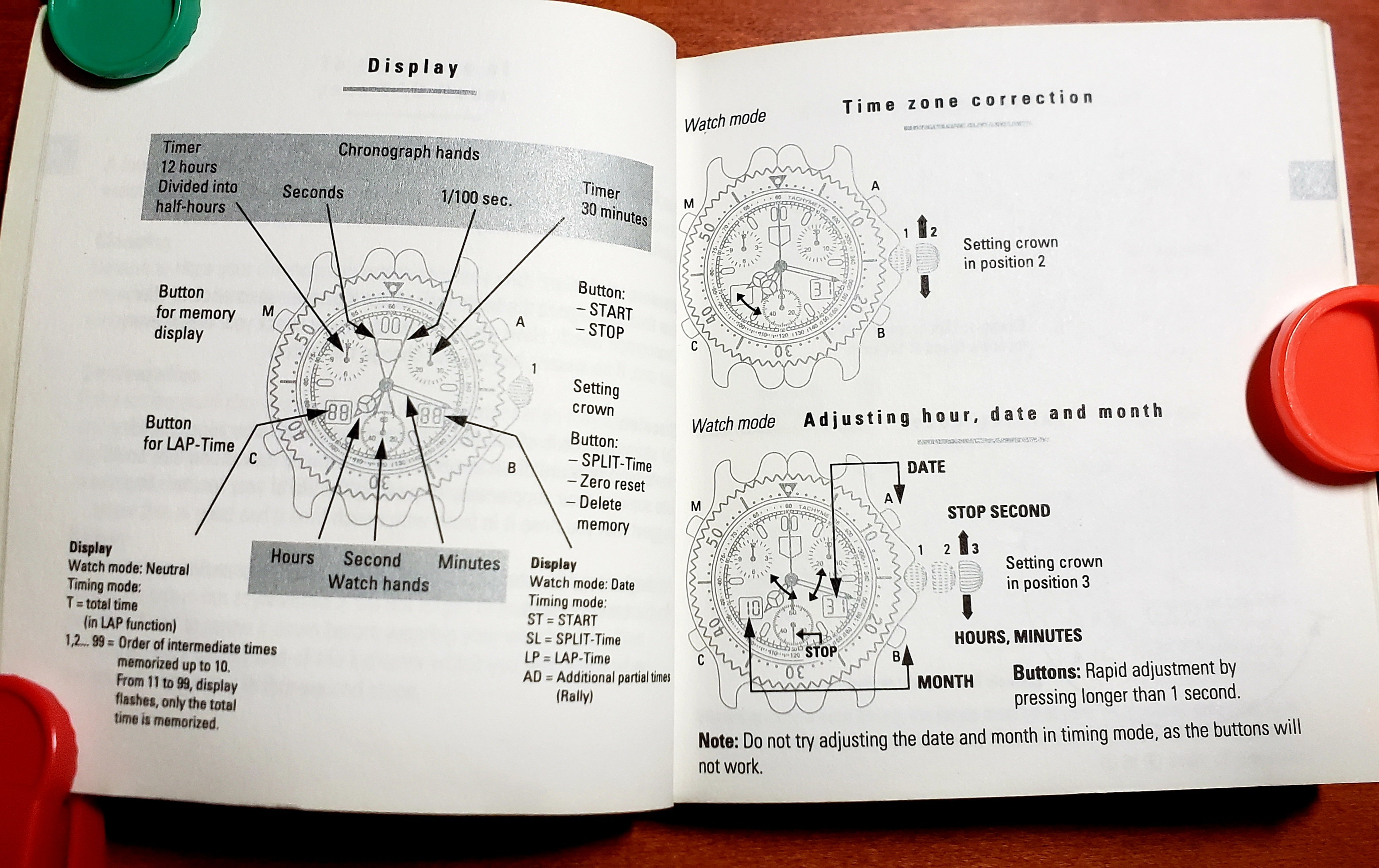

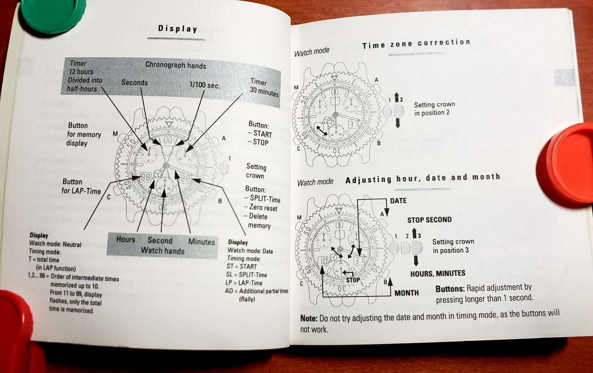

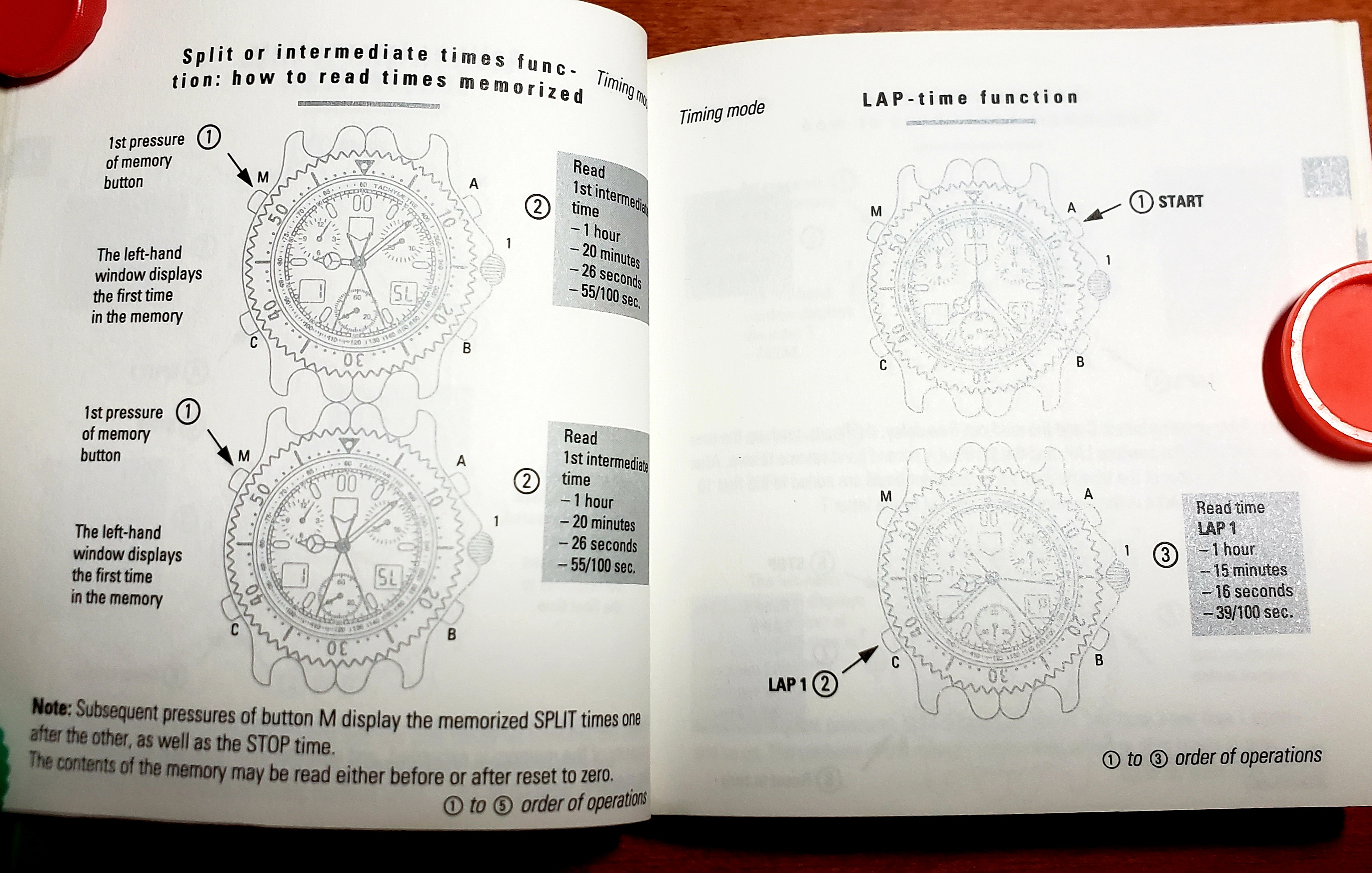

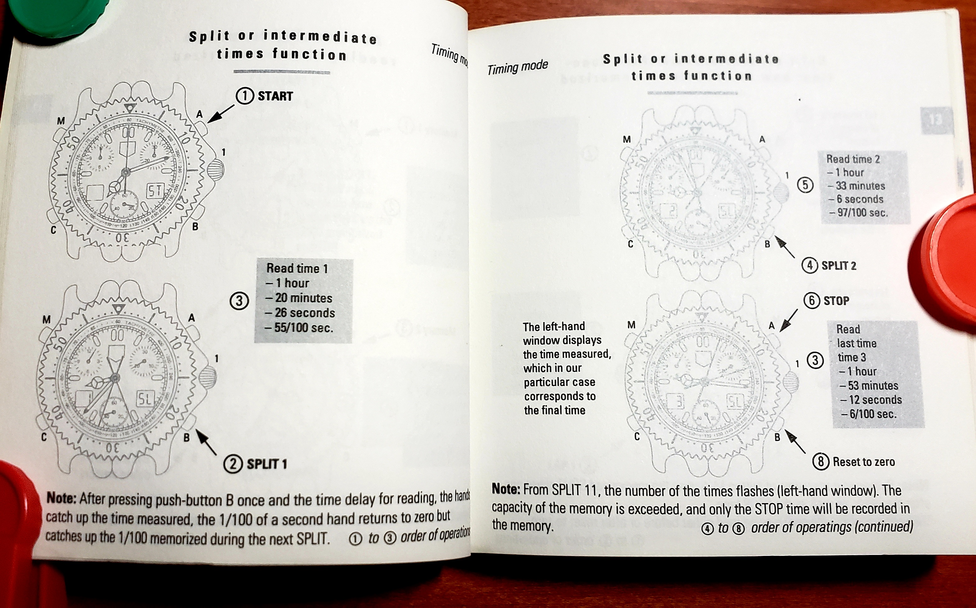

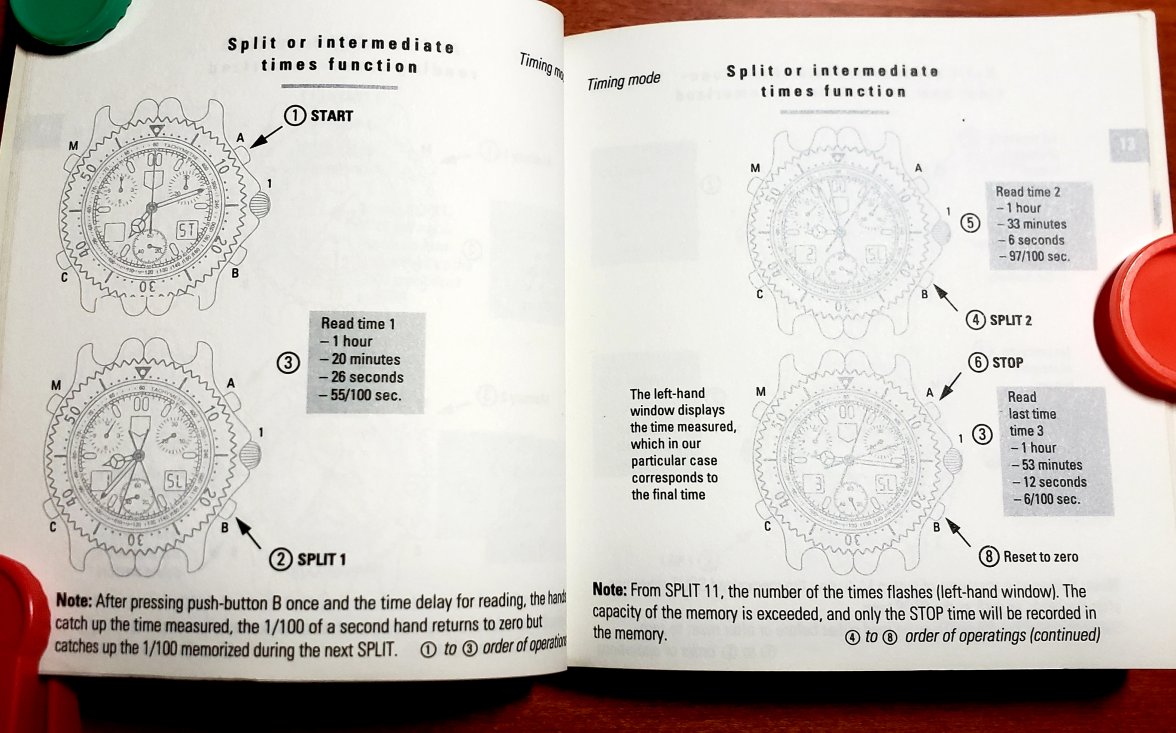

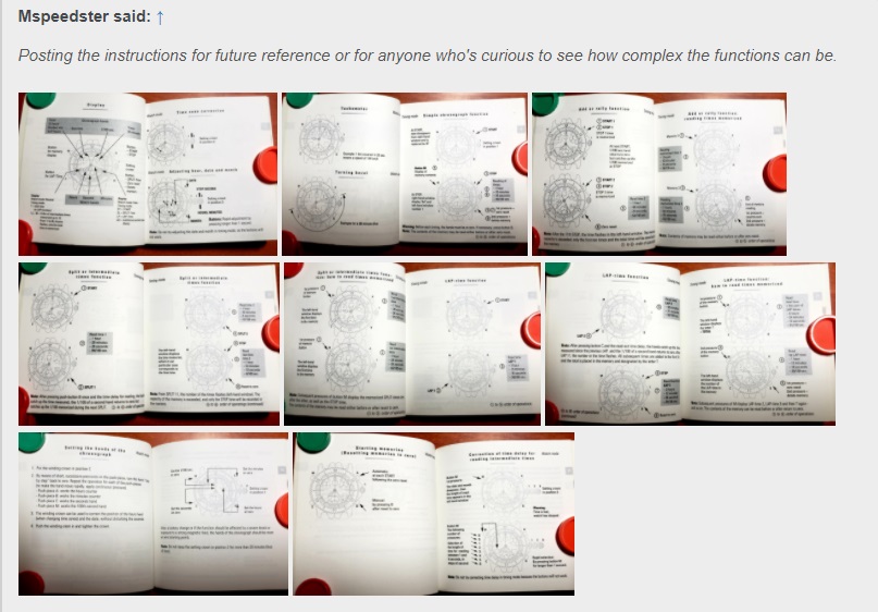

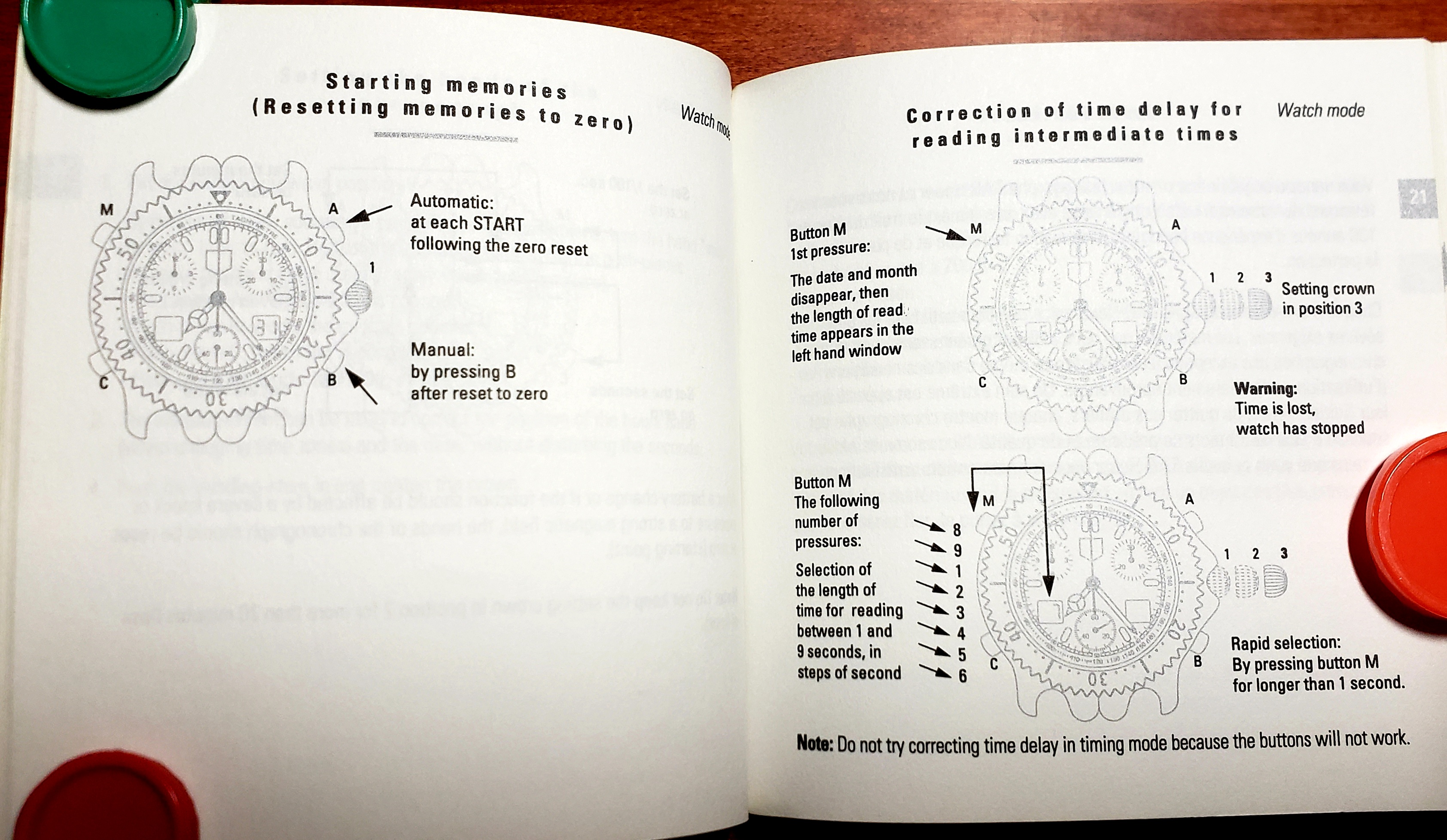

Posting the instructions for future reference or for anyone who's curious to see how complex the functions can be.
20211123_190319-jpg.1323711 20211123_185930-jpg.1323712 20211123_190242-jpg.1323713 20211123_185822-jpg.1323714 20211123_185752-jpg.1323715 20211123_185654-jpg.1323716 20211123_185553-jpg.1323717 20211123_185520-jpg.1323718
9
6

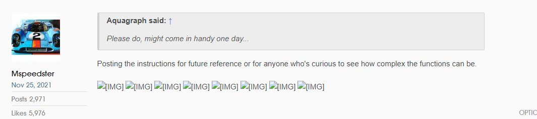

Hi Mspeedster,
Can I ask if it is possible for you to re post the images as I have recently purchased this fantastic watch as a gift but do not have the instruction manual. Or perhaps emai?
Kind regards

I don't understand. The instruction images are posted right here, or are they not showing up?
