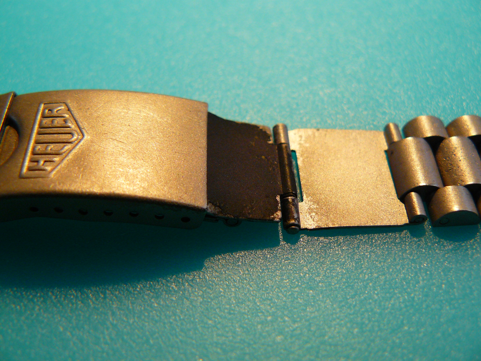

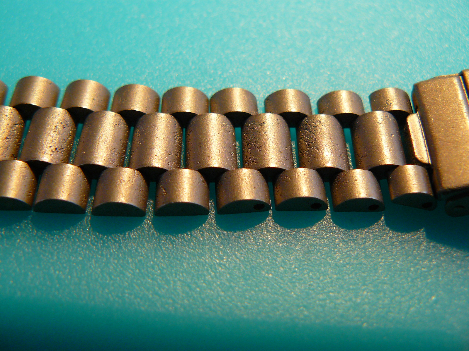

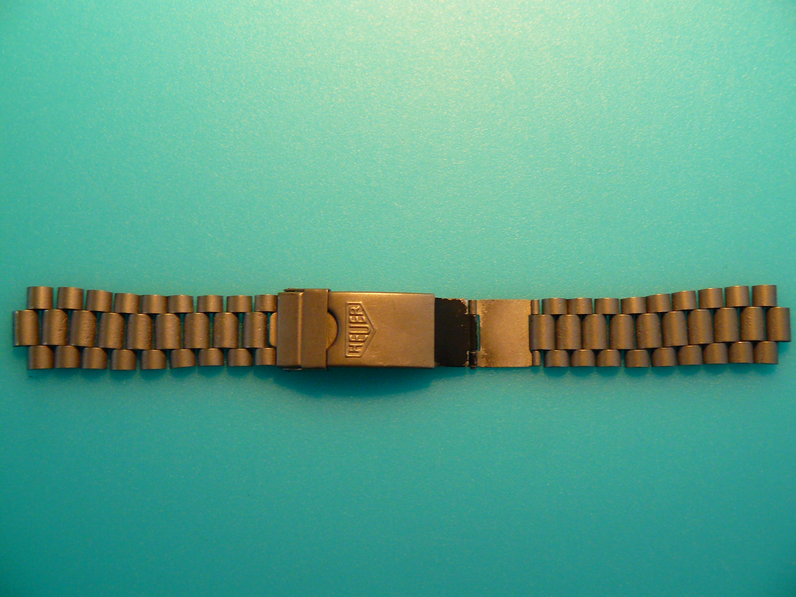

Exactly as Calibre11 says, see here an example of a "refinished" bracelet from black pvd to grey that I have overhere.
Not nice.

Is that pitting caused by the bead-blasting?
375
223
I am not sure as I bought it in this "refinished" condition, but it certainly looks that it has been bead- or sandblasted before they put "a" coating on it.
I threw it straight into the parts bin after I received it though, haha, too ugly.
I have read years ago that the best way to refinish a PVD coating is polishing off all the old coating and then put new coating on it, whether or not with a primer... but may be there is a better technique to do this?
