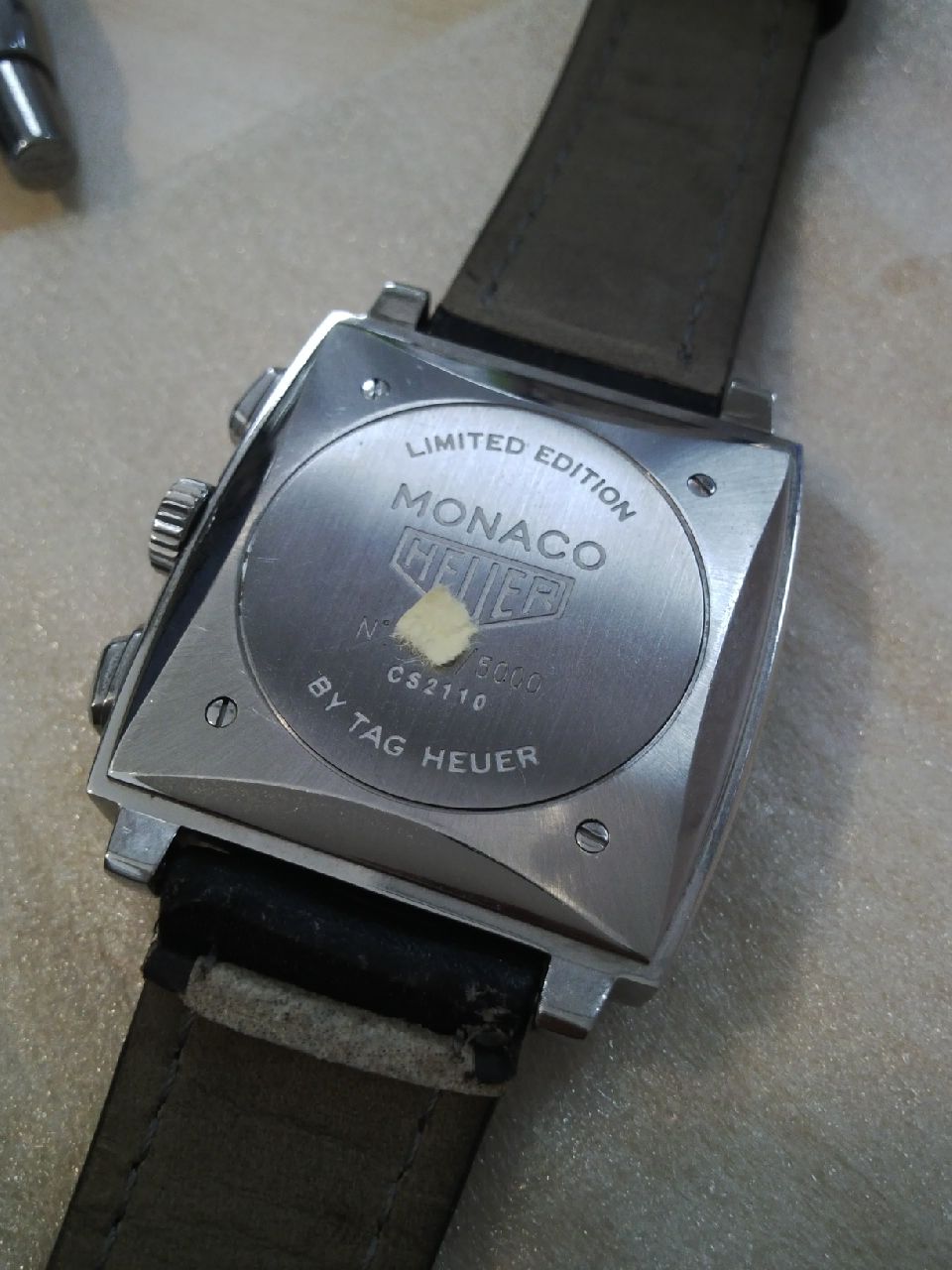

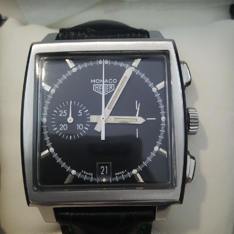

I bought a Heuer Monaco CS2110 few months ago from ebay Australia. The seller is reputable but there is no box/papers, and he is not the first owner of the watch.
I have been enjoying wearing the watch (rotate with TH GC cal 17 & TH F1 chrono), for its distinguished square case and clean dial look. Although i have to admit i prefer the more iconic blue dial CW2113 i used to have.

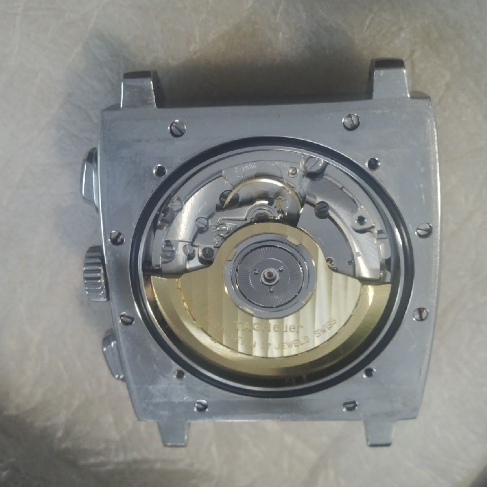

My joy turns to doubt when i opened the case and showed it to my friend. He's quite certain the movement is not 100% genuine. His argument is plates in TAG Heuer movement usually uses steel in silver color with stripes pattern and fish-scales pattern. While mine is gold color with stripes pattern and plain silver steel. He admitted there are some similarities in the movement so his next guess is that the movement has been modified and some original parts were replaced.
I agree that it looks different from other TAG's movement i used to know, but for me it doesn't always mean it's not genuine. My only assumption is that it's produced in 90s so maybe back then TAG Heuer had different design.
I have compared the outer parts (case, dials, back case, buckle etc) with pictures from the internet including from www.calibre11.com and i'm confident that they are the same as the original except for the leather band which is a replacement. Unfortunately from google i cannot find pictures of the movement for the same type of watch to confirm my (hopefully not his) opinion.

1. I don't see any obvious signs that the case/ dial are fakes- they look OK from these photos. Some of the detailing looks a little rough, but that could be the photo quality. A "fake" would typically have fake dial/ case as well as movement.

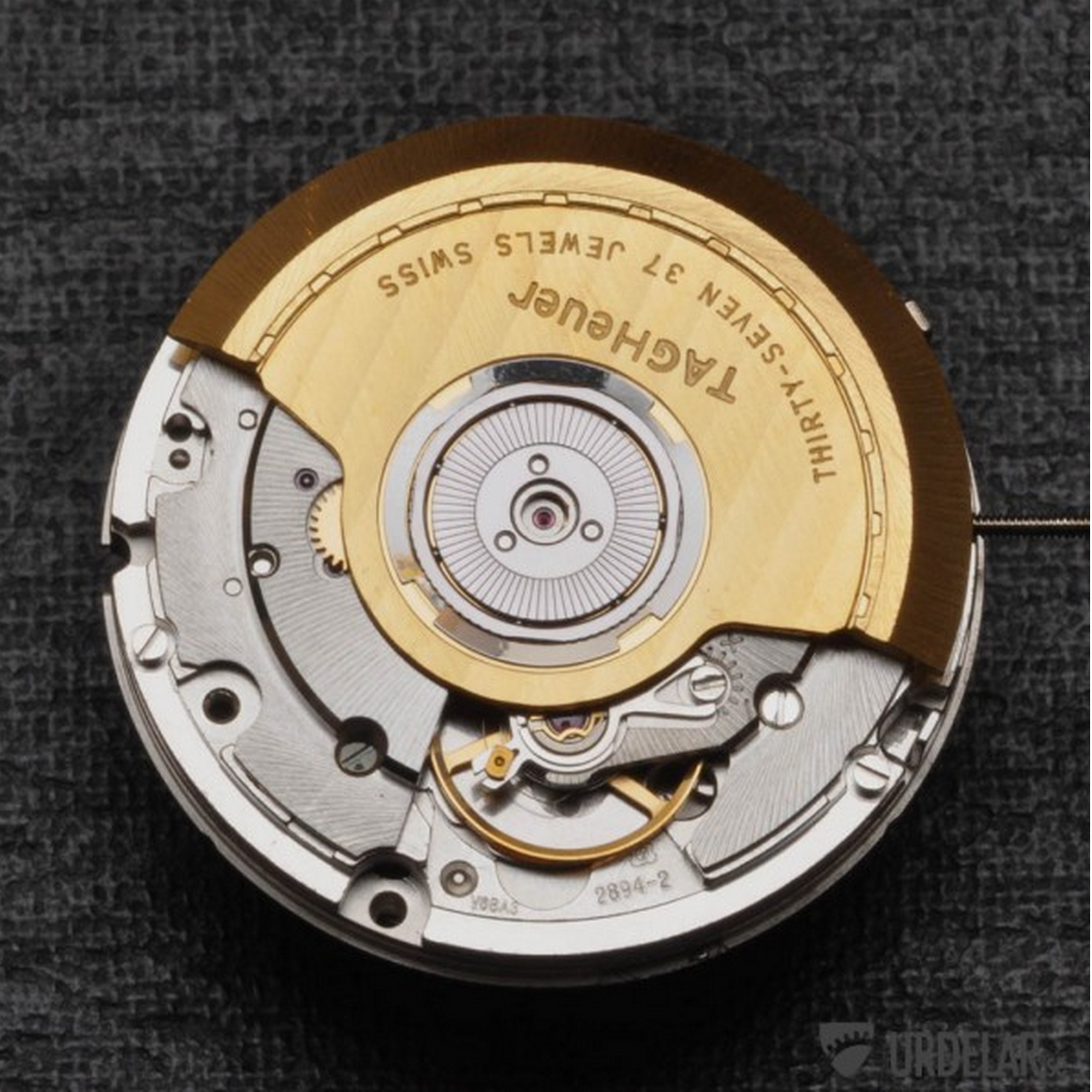

2. I don't agree that TAG Heuer don't (or didn't) use Gold rotors, although it's true that steel is more usual. Here is a Calibre 17 movement sold by a Swedish watch parts website
This is a Calibre 17, same as yours, although there are two flavours of Calibre 17. The one above is a 3-register version, the ETA 2894-2. Yours is the two-register 2894.
You can read more about this movement here, although note the article focuses on the 3-reg 2894-2 from a watch a couple of years newer than yours: http://www.calibre11.com/tag-heuer-calibre-17-review-eta-2894/
The cotes de geneve pattern on the rotor above is the same as yours.

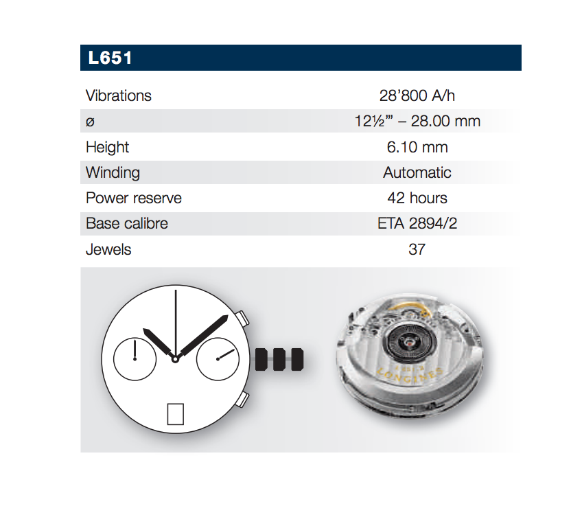

You should check your movement to see if there is a movement number and/ or an ETA stamp, as that would help confirm things. I think I can see that it says "2894 2". I have seen some some 2-register 2894s marked as "2894-2" (see below from Longines), even though common convention uses that name for the 3-register.

Glad to see other movement of TAG Heuer with identical gold-rotor and design to support my opinion. In the first picture there is a movement number 2984-2 and stamp similar to ETA stamp (i don't have magnifying glass to confirm it, though).
