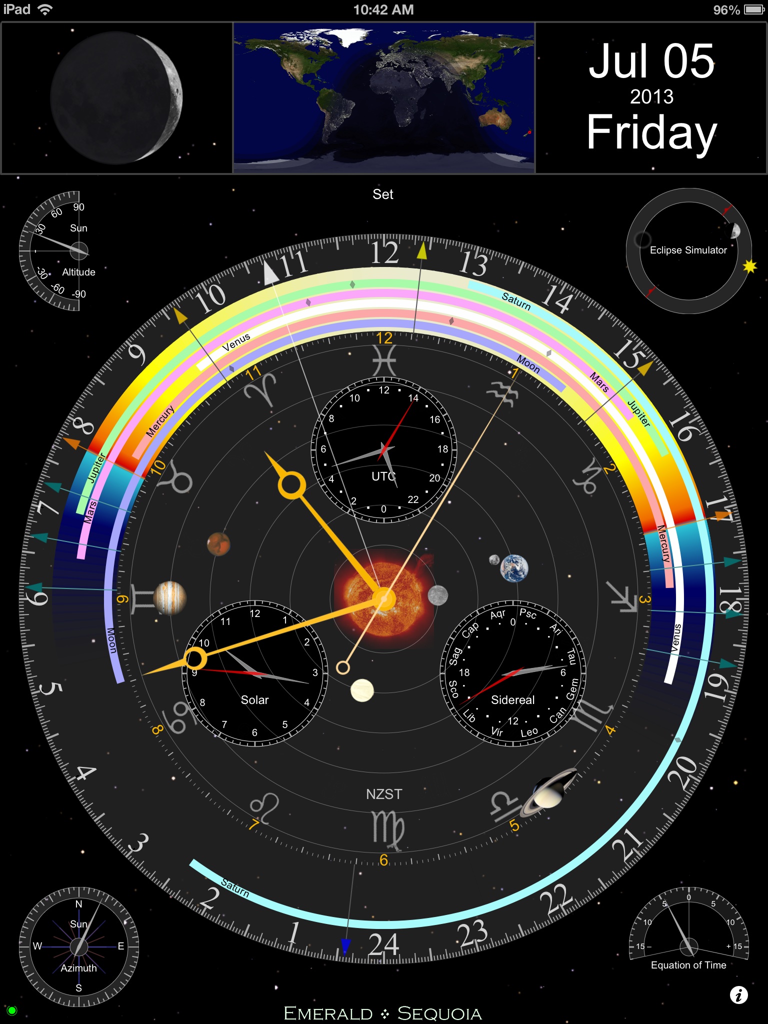

I use an app on the iPad, you can look at your watch then hit the SET button at top, clock has markers of 0.2 resolution.
