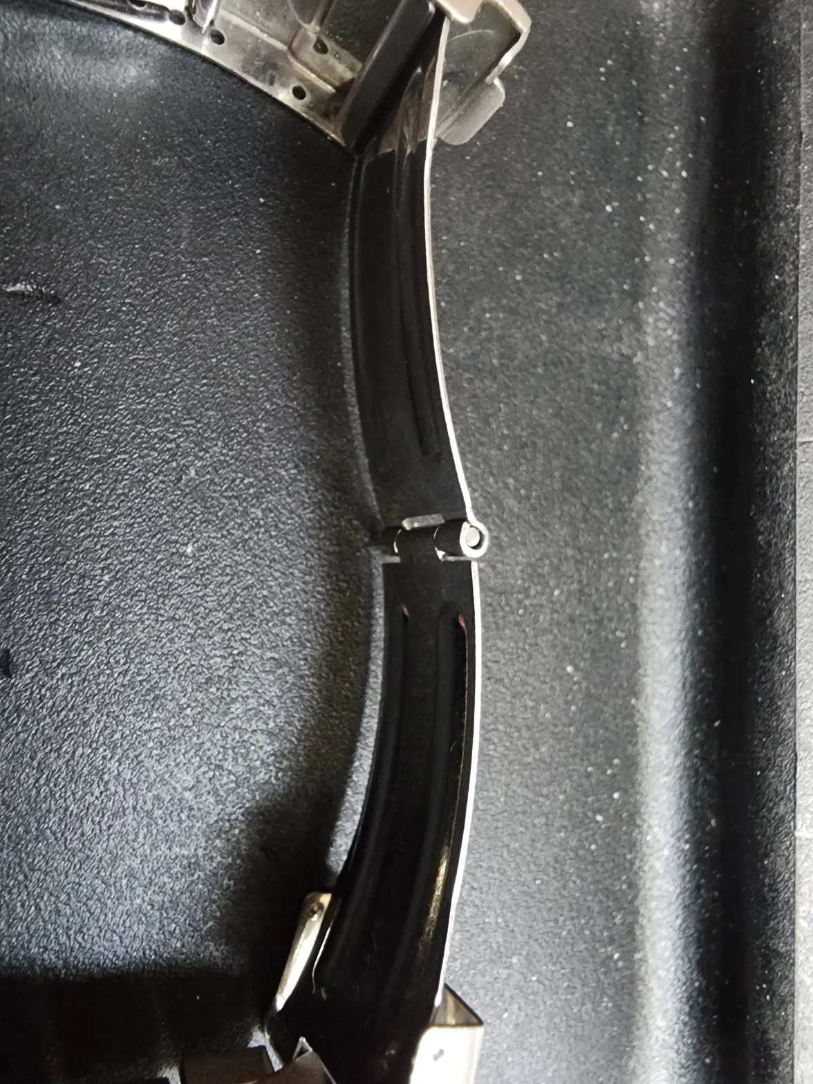

Could you provide photos just to confirm which pin we're discussing?

The closeup photo identifies the pin that is in its slot because the TAG sales assistant replaced it when I was at the store.

If it was me... I'd let the pin drop out (but not lose it!), then use a pair of pliers to squeeze the lugs slightly, then push the pin back in again. It's basically a friction fit, so you just need to ensure the friction is available.
But.... that's me: I'm a mechanically minded tinkerer. So if that approach hasn't been your immediate thought, then I'd suggest that it's not the first thing you try.

That would be my guess, from your description, yes.
2 things:
first: I don't know which of the 2 metal plates which the pin holds together actually grip the pin (it could be the plate in the middle, or the plate that is "forked") One will hold the pin, the other will be loose (and needs to be loose).
second: I wouldn't use superglue, because you can't get "inside" the little lug to clean out the tiny bits of dust etc that will be in there. If you don't clean them out, the glue will only stick to the particles, and not the metal. (Also, superglue, in my experience, doesn't form a great bond with metal).
Any jeweller/watch-repair person worth half a pinch of salt will be able to do this repair with any effort, you don't need to go to a TAG dealer.

The middle of the deployant clasp is simply folded steel that grips the pin (on the outside, not the middle) and it can open up over time resulting in the pin becoming loose. Very easy to remove the pin, tighten the loop, and reinsert the pin.
I understand you not wanting to do it yourself. It's a five minute job for anyone with the knowledge and tools, so don't let anyone charge you too much. Honestly, I'd probably do it for free (Brighton, UK).
