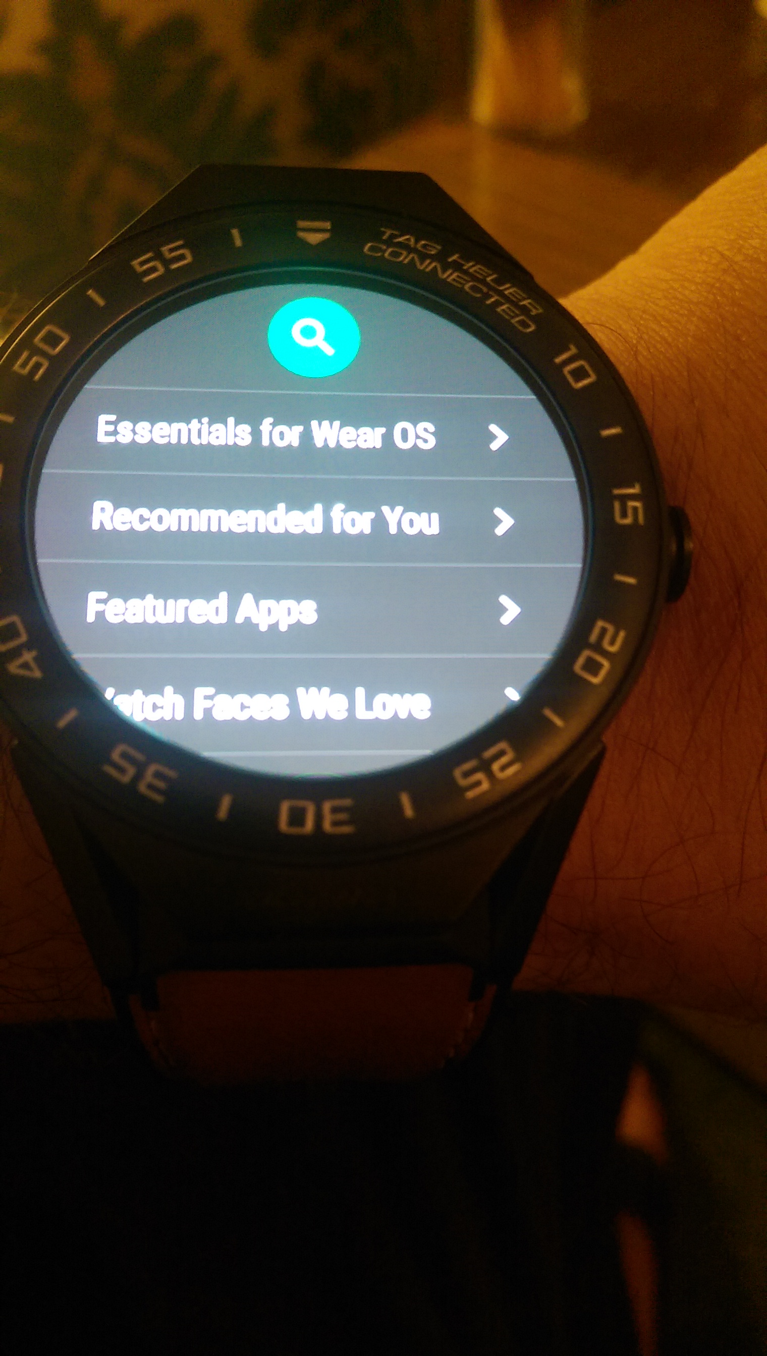

Does anyone else have problems connecting with Playstore? I’m connected to wi fi and often find I can't connect to Play store . Its very frustrating watching that little green circle going round.

Try to do it with the watch at the charger (best option), or switch off your phone Bluetooth. In both ways you are forcing the watch to use Wi-Fi, otherways it could be difficult to update the apps or the watch system, or even sending new faces to the watch from the WatchMaker app.
