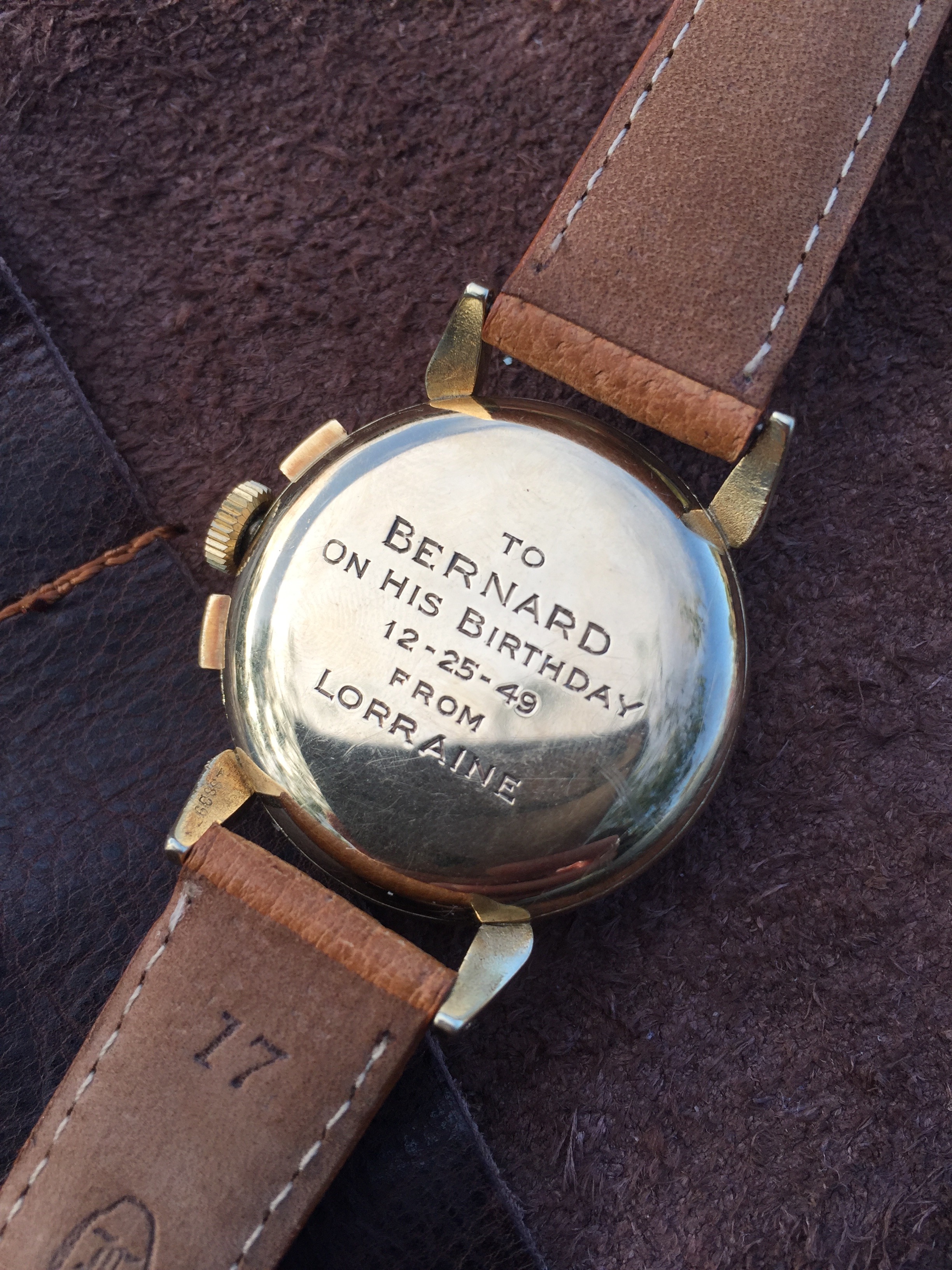

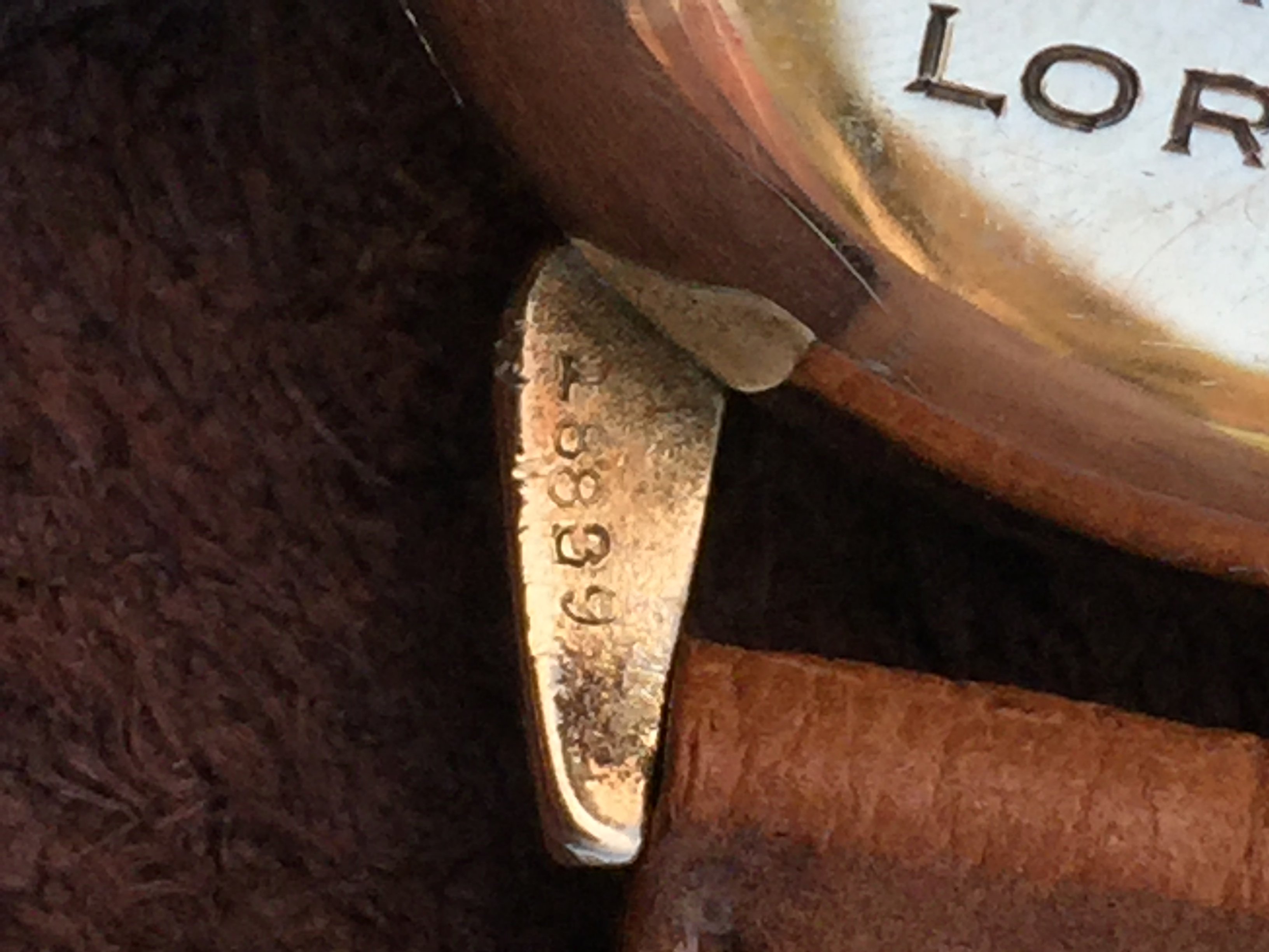

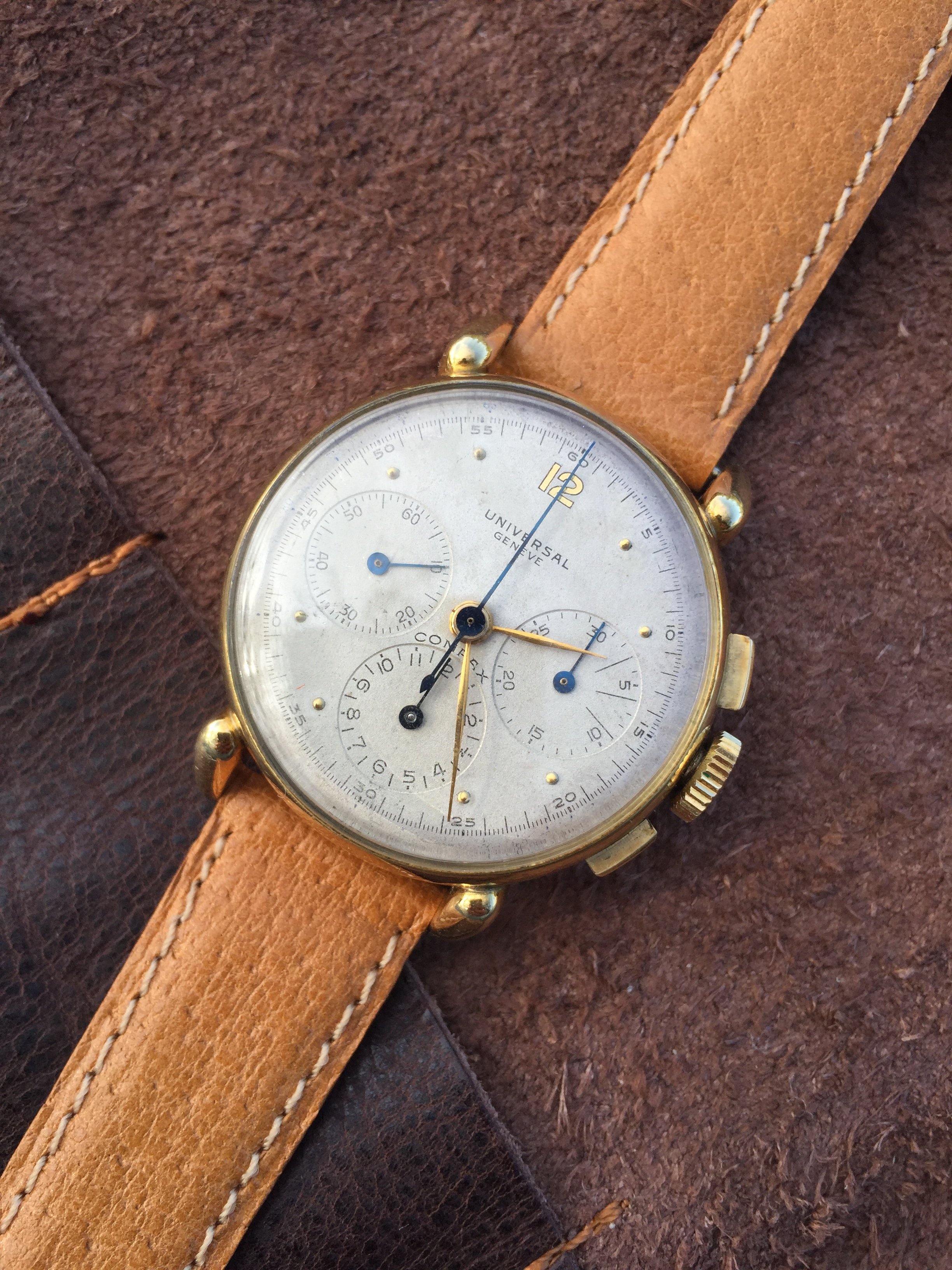

I was just inspecting my gold compax closely last week and notice that there are some numbers behind one of the lugs. I've never seen this in UG before and those numbers definitely aren't the case reference.
Has anyone seen this before in UG watches? Or if anyone know what does these numbers mean. I've asked around to a few people and no one seems to know what it is.
Thanks heaps
Andre
1,424
3,001
Usually, marking on lugs are there to associate the case (top) with case back. There does not seem to be any sort of correlation between numbers on lugs and numbers on case so I am a little lost.
1,931
22,752
My Italian collector friend told me that marking on lug normally found on military issued UG chronograph as he has one of those, especially the one found in South America. But obviously this is not the case since the movement is stamped HOX and definitely a civilian gift.
Anyone else seen this on UG chrono?
6,712
18,569
I have a Brazilian issued UG Compax and there is no such number
1,931
22,752
That's what I said as well to my friend, as I know that you have one of those and you've already told me that you've never seen the engraving behind the lug before! Anyway, I'm still waiting for his UG photos.
6,273
9,833
This looks like a Cartier inventory number…

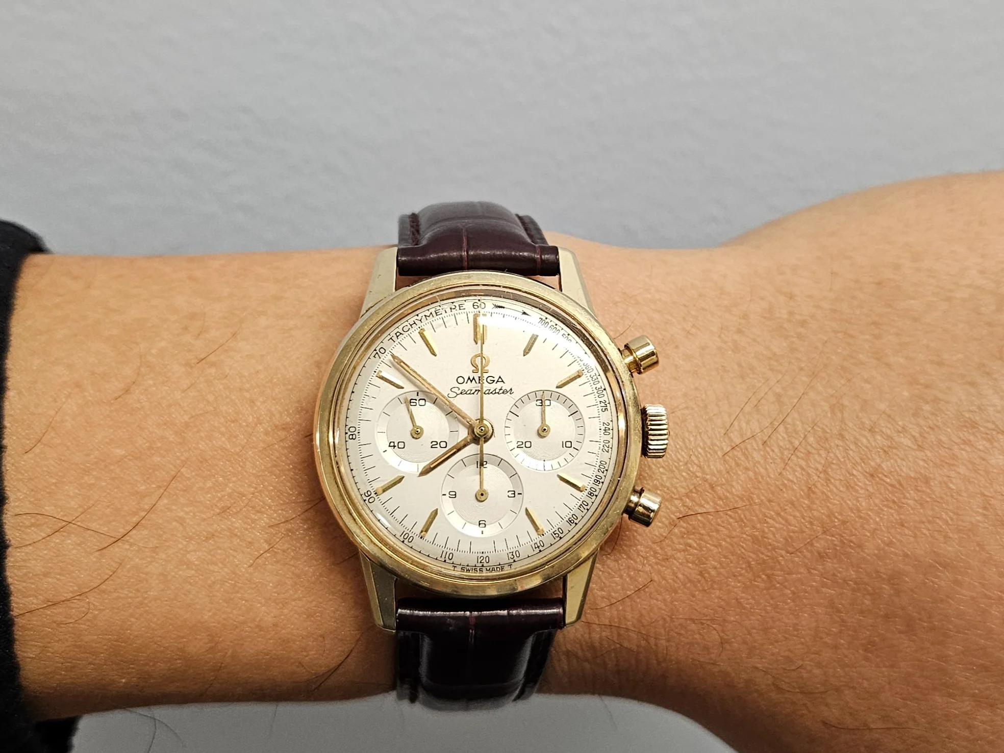

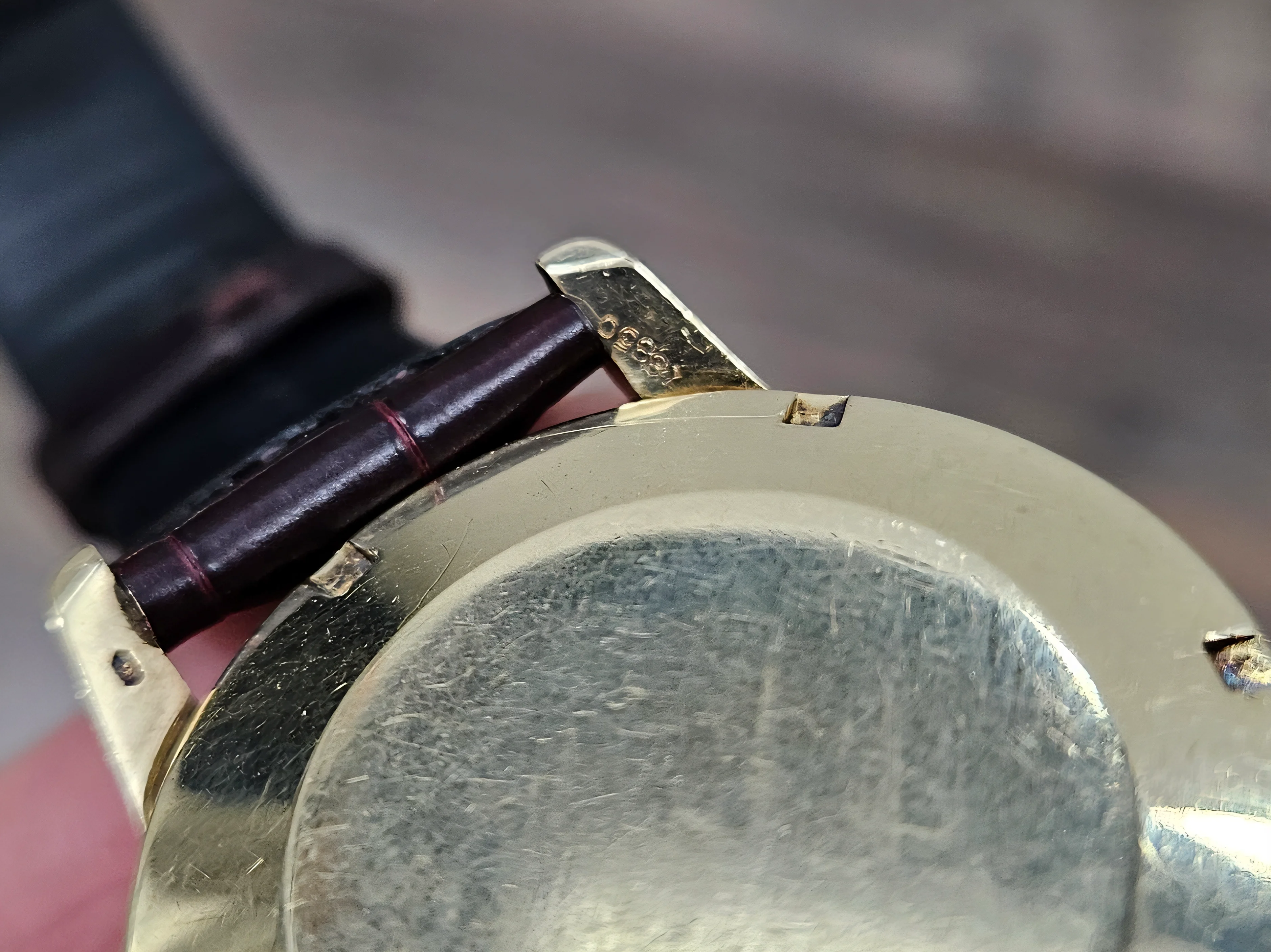

Sorry to bring up an old thread. But a letter and numbers were also stamped on the lugs of my Omega Seamaster in 14k and it looks very similar to the stamp the OP was inquiring about on his gold UG. So it really could be Cartier inventory number? Just wanted to provide another similar example for the record.
6,273
9,833
Think they use another font. And what does make you think this is a Cartier?
317
528
I posted another thread in the Vintage Omega board about the evidence behind it. The number on my lugs "Lxxxx" matches another sold IWC retailed by Cartier Hodinkee example that had "Lxxxx" also stamped on the lugs. Both my example and their example were made in the mid 1960s.
