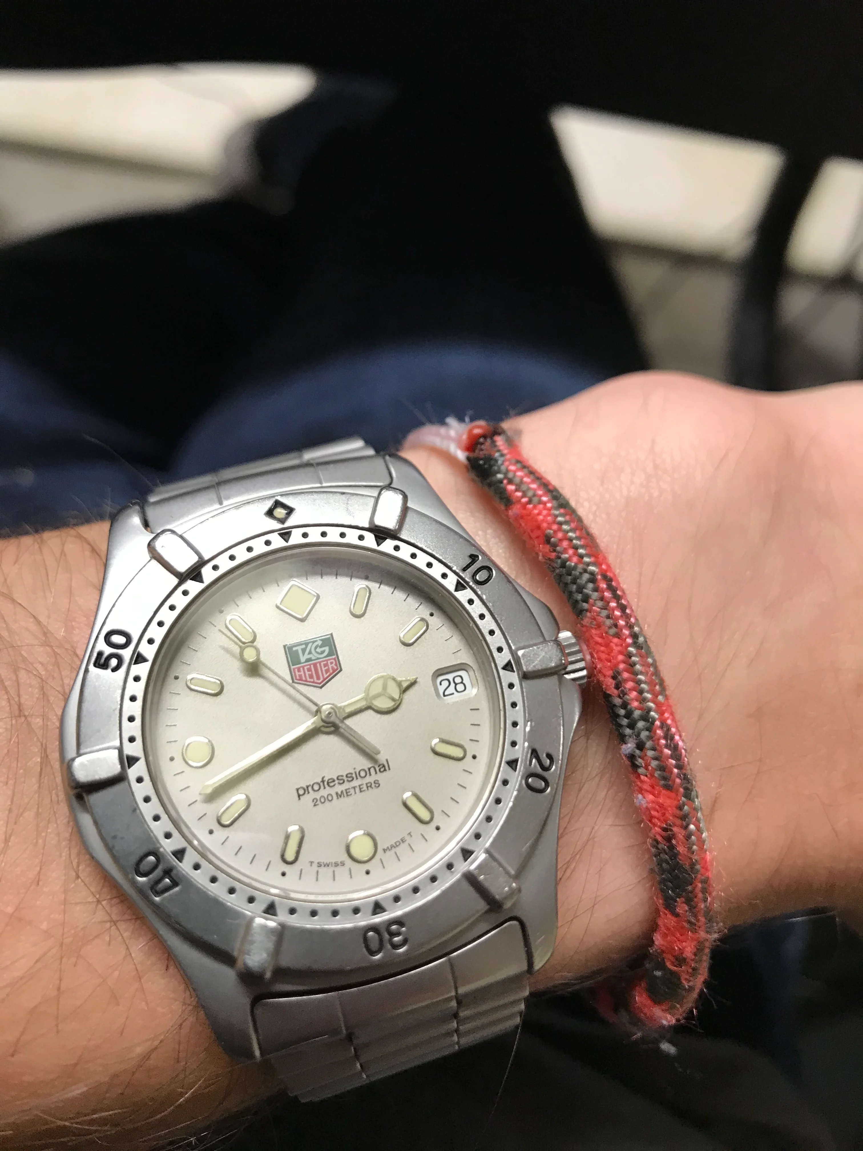

Now, my question to all you subject matter pro's, is about my Tag Heuer 2000. I have done (what I feel is) extensive research trying to understand the reference number on the caseback, 962.206-2, and I just can't seem to find a lot really. When I look up the model and reference number, I see 2000's with no applied indices and a black square around the date window with the odd photo of a watch that looks like mine. I look up the model with the reference 962.206R and it's the same thing. Thanks to On the Dash, I was able to identify that this watch most resembles the WE1111 from the 1994/95 catalogue. Is it possible that the 962.206-2 was the reference used on this updated version between 1992-93? Is there something fishy here? I saw another member post about a 962.006 black dial which looked a lot like mine, but notably it emits the -2.
Attached is the very first photo I ever took of my Tag Heuer 2000 on wrist, for fun and as a reference!

Not sure anybody has really nailed down the variations between the various suffixes on these!
Nothing fishy, just a complex and obscure system!
Plain old 962.206 was the first. Then there is the - 2,the R and an F as well.
There are variations to the dial as you noted and also to the bezel, bezel click spring and case.
The case on early 2000's is really quite different to late models.
A change in letter suffix often meant a minor change to the case as seen in the 1000 range,there we see an L suffix and an N suffix had case differences.
Yours could be WE1111 spec but from before the renumbering from the old Heuer references took place.
I like the sound of your Navigator btw, good looking watches.

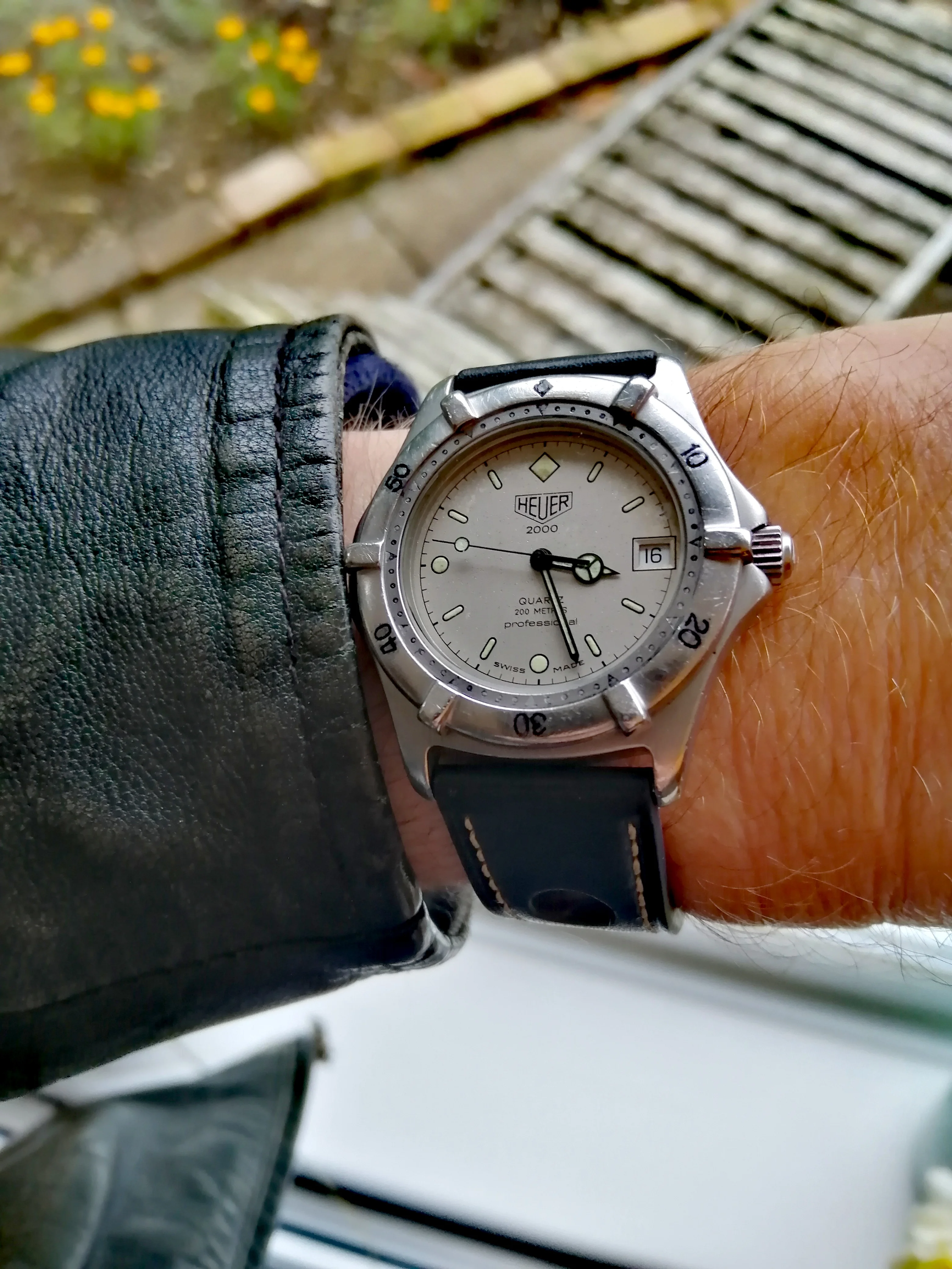

Here is my very early Heuer 962.206 from the early 80's,these had a slimmer side profile, especially on the lugs.

Thank you for the feedback, that's reassuring to hear!!

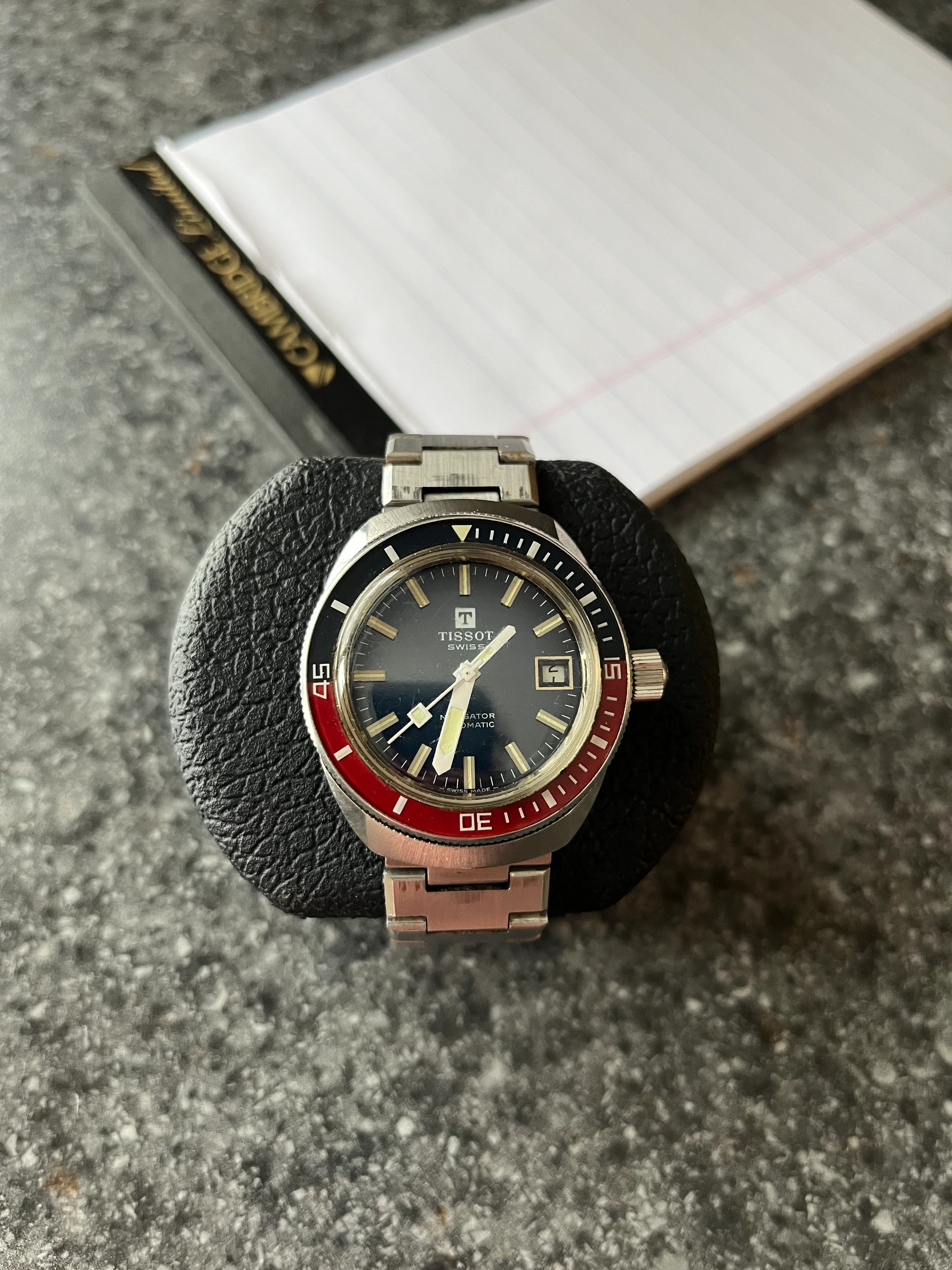

Here is a photo of my Navigator pre-service! I think it's in exceptional shape for it's age. I had it serviced by a reputable shop in my area, but I regret to say the bezel is now a bit less vibrant because some of the bakelite-like material was washed out when they cleaned it. It still looks great though, I just don't have a decent photo of it post-service at the moment!

No problem.. I think you are about right with your date estimation. I would put it early 90's too.
It's interesting how the 2000's evolved over a long period. You can see the crown guards differ to the very early one too.
Love the Navigator, great watch and on the original bracelet too. Very nice piece to have in the collection 馃憤

I agree! It has always been interesting to me that the 2000 was the model that was developed into the Aquaracer. Definitely cool to see the evolution of the design.
