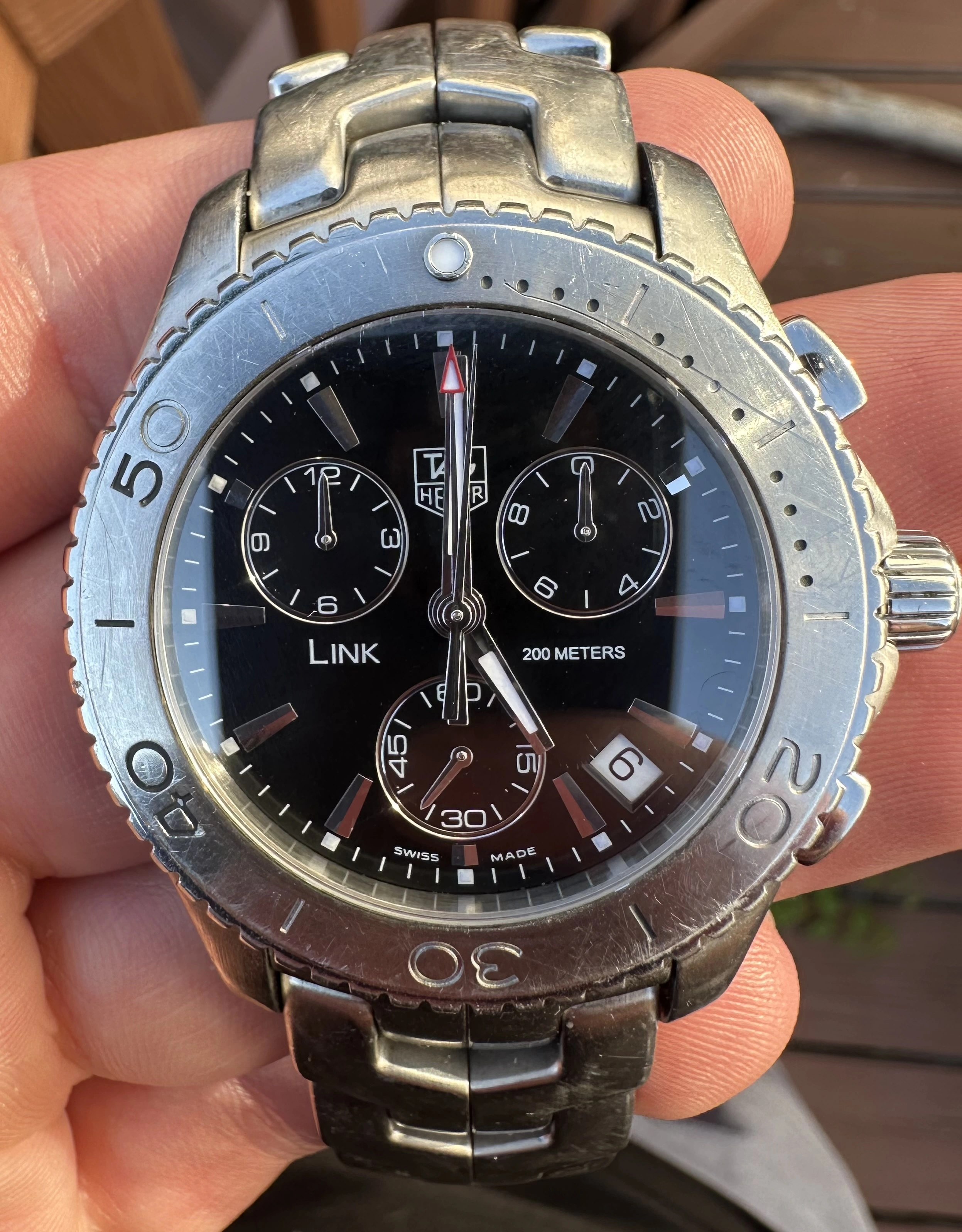

Hey, appreciate anyone who can help and answer a simple question. I have a Link Quartz Chronograph CJ 1110.BA0576 that was given to me by my father before he passed away. The movement for the seconds stopped working when I went to get the battery changed the other day. So I am ordering a new movement ETA caliber 251.262. While my local repair shop (really talented older gentlemen who has repaired a Rolex of mine) is changing out the moment I was seeing if anyone knows if a CJ1112.BA0576 or CJ1111.BA0576 will fit. Or if any other blue or white dial can be swapped out. This watch is a forever watch for me so I don't care about destroying the value it will be passed along to my son when he gets older. I already have a black dial Rolex and would like something different so I will wear it more often
Both CJ1111 and CJ1112 dials can be used to replace CJ1110 dials, yes.
