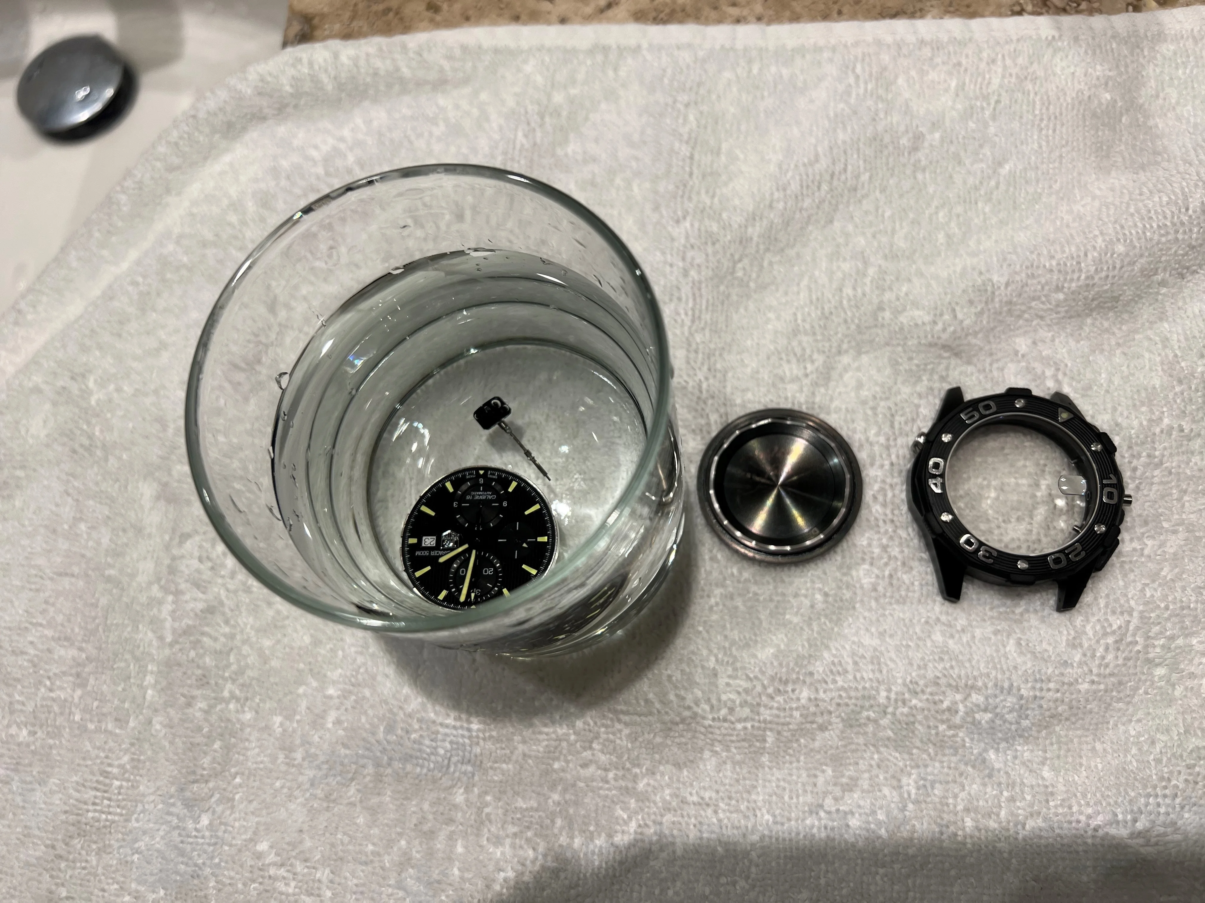

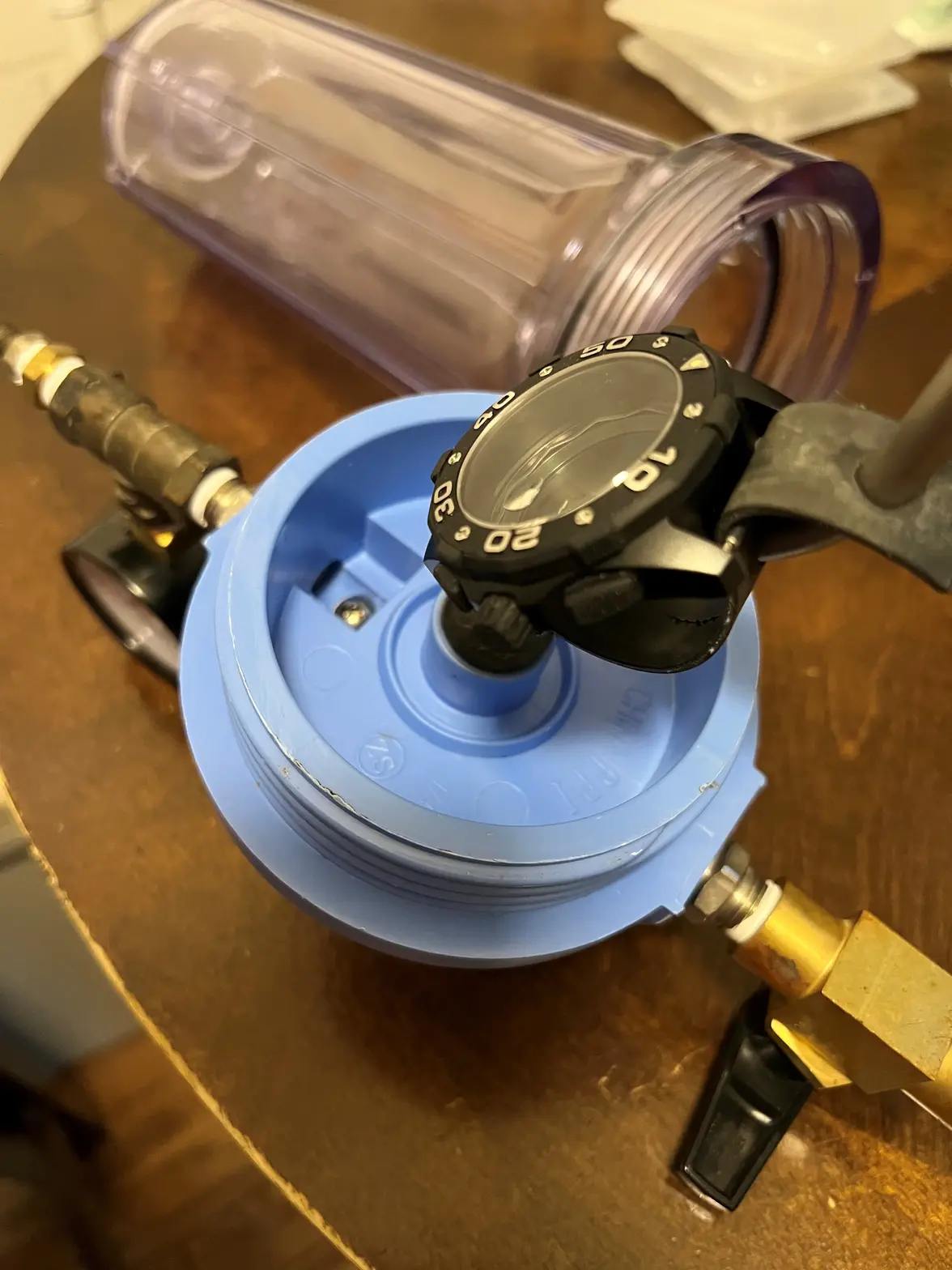

Here's the result of a sticky pusher:
Long story short; I bought this about ten years ago and took it diving, but before I got a camera. Recently, I thought it would be nice to get an underwater shot:
OK, shot taken, but after surfacing and sitting in the boat for ten minutes, I noticed a thin fog on the crystal. Yup, inside. My first thought was "What do I need to do to preserve this watch?"
Answer was to get it open and in fresh water to preserve the dial and hands. The movement (SW500-1) I can replace. Fortunately, I brought a cheap service kit and used a bracelet pin punch to work the back off. Into the dunk tank it goes.
Once back home, I reassembled the case and gave it a leak test in my wet tester (water filter mod.) Not a leak to be seen:
Prior to all this, I had noticed a sticky pusher but thought nothing of it. Granted, this watch was made in the early teens and hasn't had anything done to it since, so I got what I deserved.
The movement still runs but the reverser is jammed. That should be expected.
I'm not going to do anything about it until I get a reliable way to tell if it's leaking.

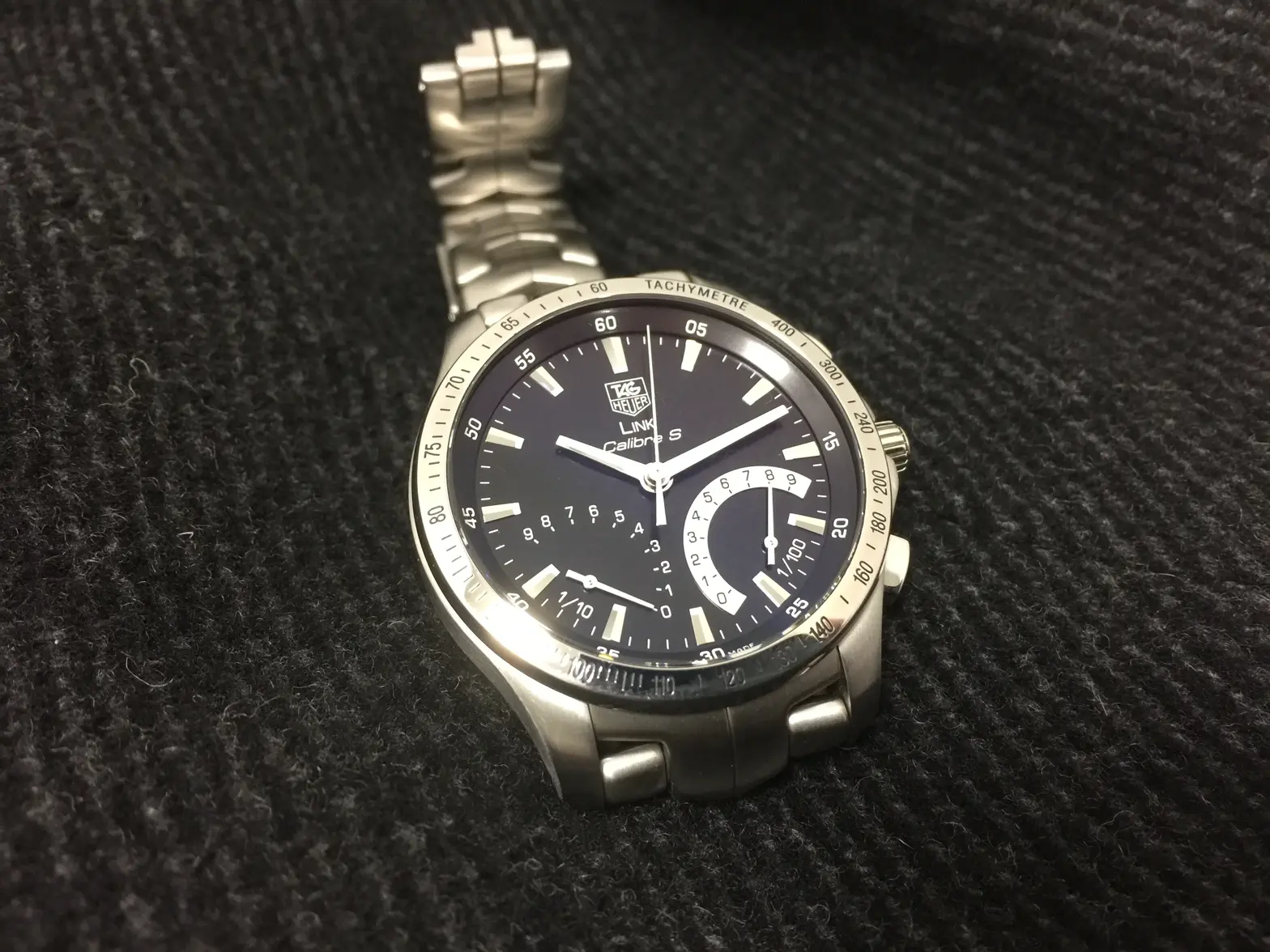

In the meantime, a picture of my watch. It is actually my 9th Tag and the one I've had the longest as it ticks pretty much all boxes for my taste...
