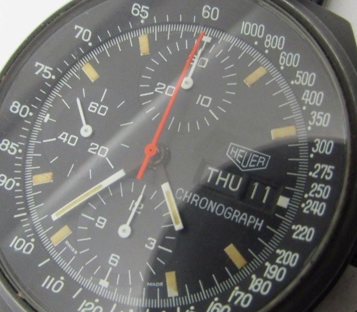

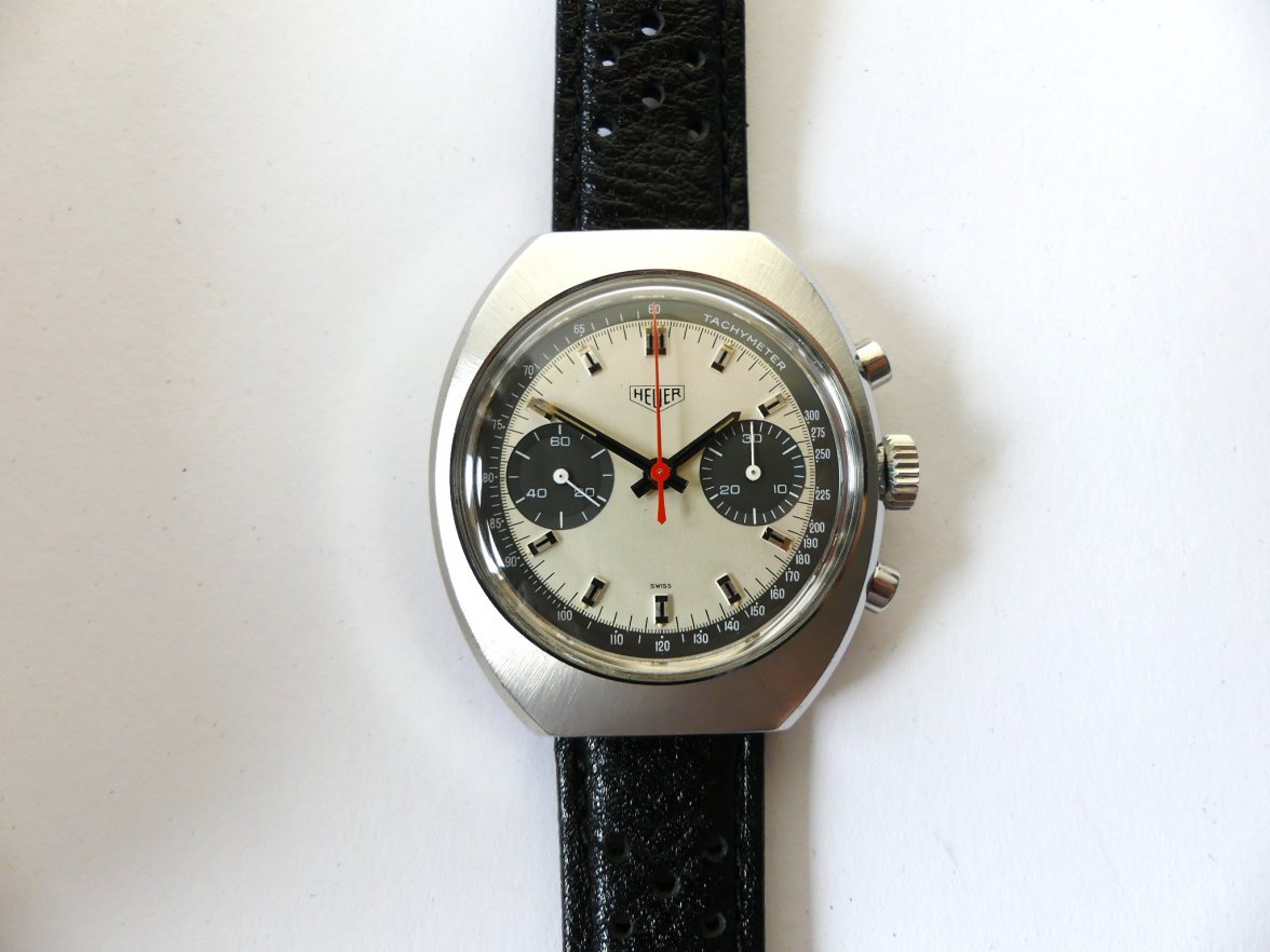

Yes, looks OK to me- a Day-Date "no-name" Pasadena
Thanks for commenting! What caught my eye as "strange" is the word "chronograph" instead of "automatic". As well as it having the small rectangles at 12, 3, 6, 9 instead of dots (as far as I've read, 'no name' Pasadenas have dots, 'named' Pasadenas have small rectangles, like this one)
7,124
15,117
I hadn't noticed the dots/ rectangles on my phone.
It's true that Heuer made these watches for other brands- for example, there is a LeJour that has "Chronograph" under the Day-Date window. I can't see the integrity of the Heuer shield/ script on your watch in enough detail to know if the dial has been refinished.
3
Thanks for your input! So indeed there's something odd about this watch! Movement looks good, doesn't it?
Here's a bigger pic of the dial. Sorry for the poor quality, that's the best "closeup" I could get from my mobile...

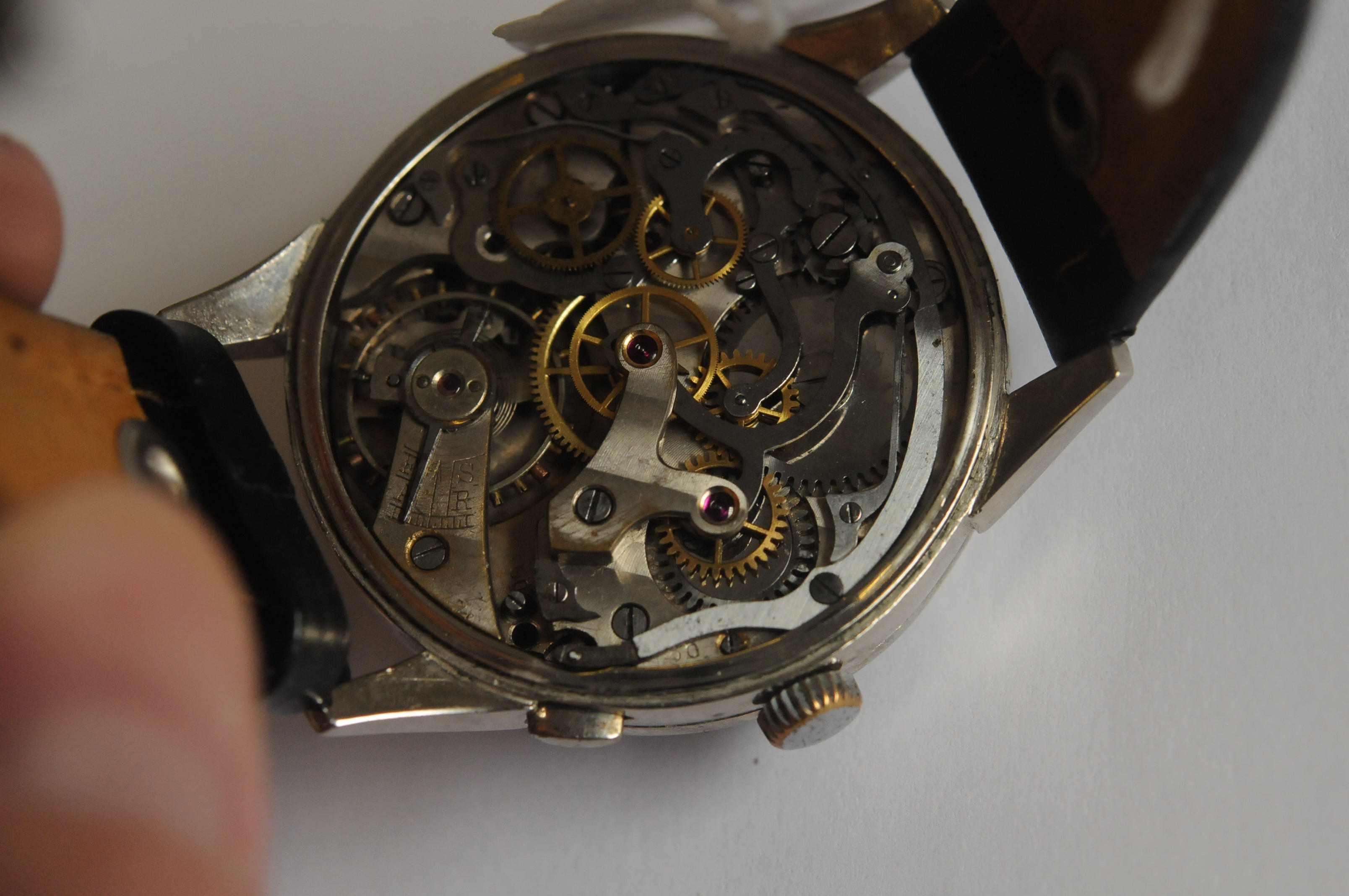

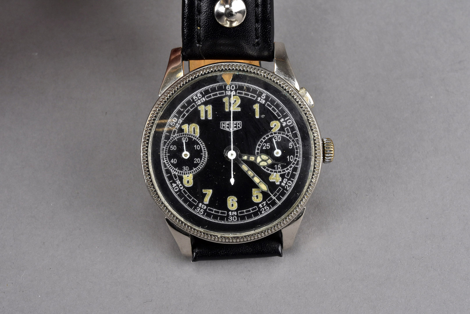

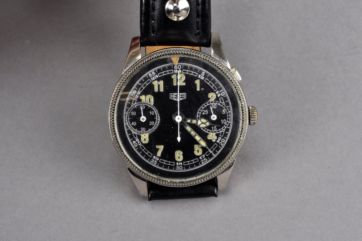

Hi,
Can anyone please confirm if this is a real Fleiger. The chrono movement is only marked '50'. The case lugs take a spring bar and are not fixed like on 30's Fleigers. Any help would be appreciated.
Regards,
G reg.
7,124
15,117
Hi,
Regards,
G reg.
Hi- no, this one doesn't look right. Heuer did make a Fleiger, but those had very different lugs- as you say, fixed lugs.

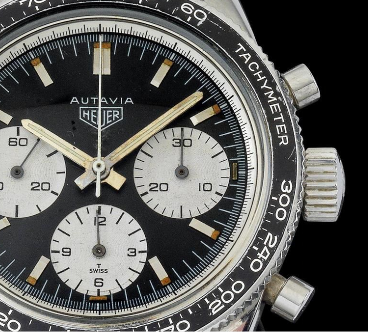

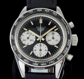

Hi - I am looking at an auction of this Heuer Autavia. At first glance looks like a 2446 I would think but then the outer white second ring strikes me something i have never seen before.
Any views on this would be highly appreciated.
Thanks
493
1,066
Thanks
It looks like the chapter ring / tension ring from a Carrera was used instead of the polished rehaut. The incorrect m/h hands might be the bigger concern though.
833
1,563

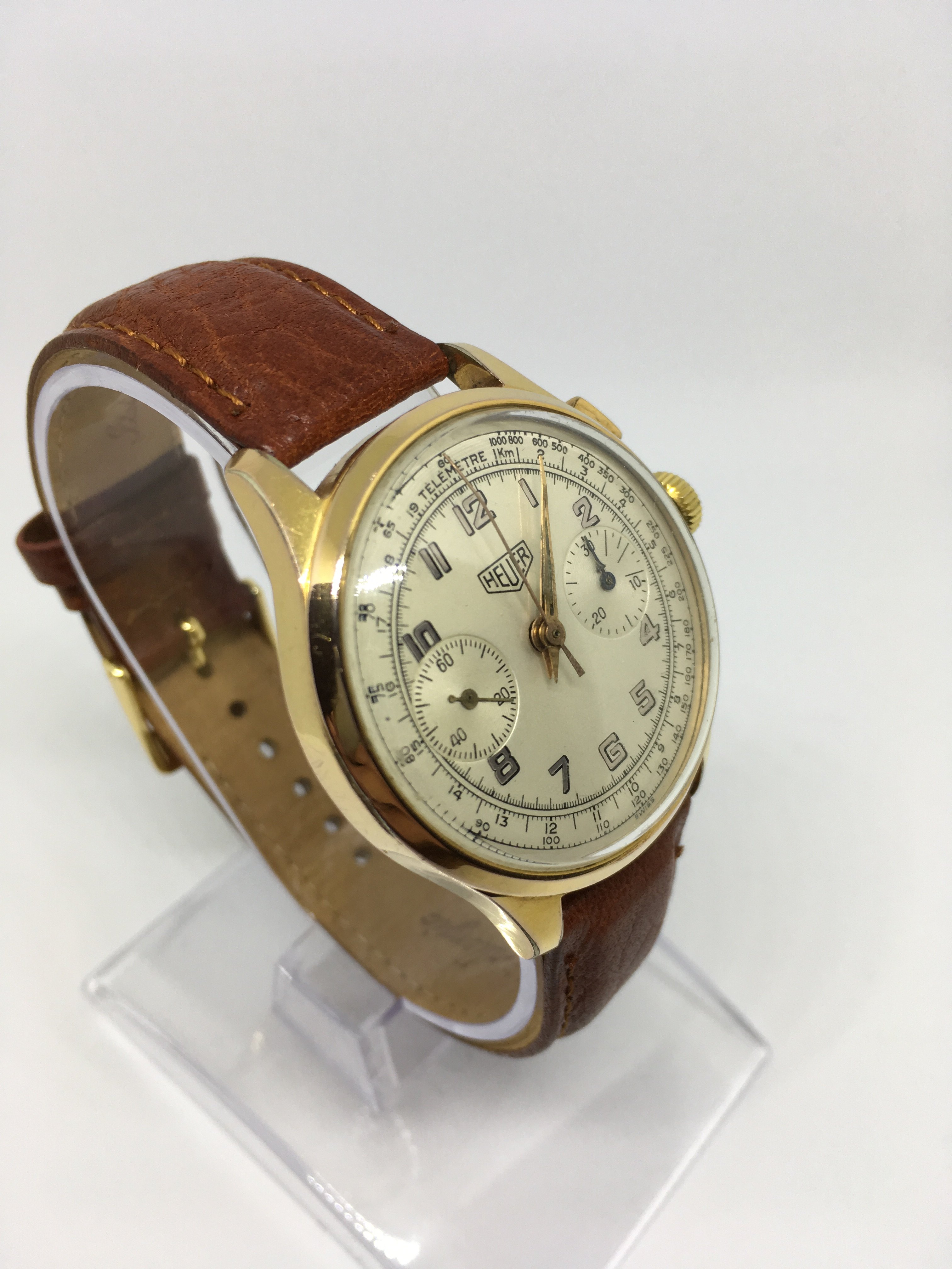

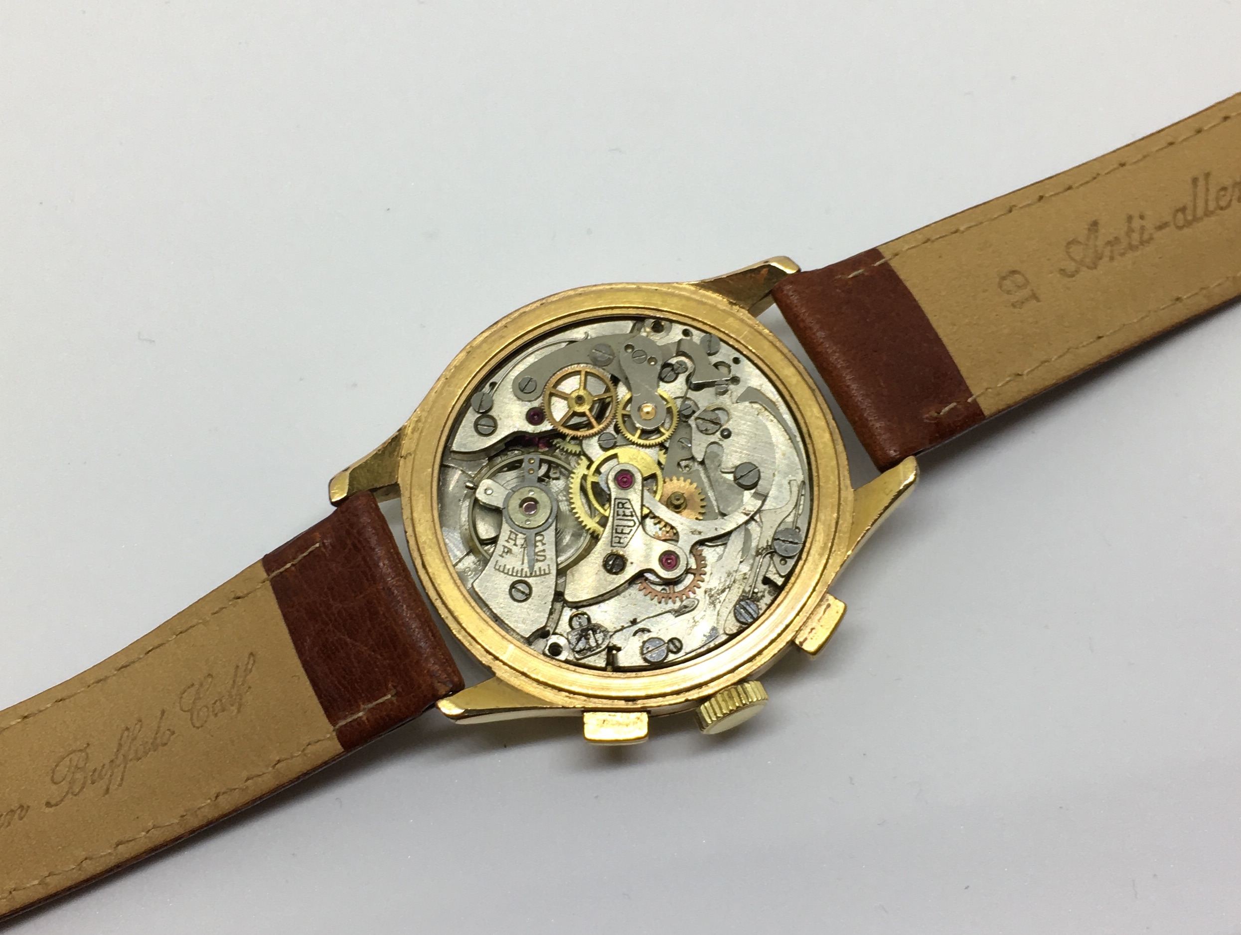

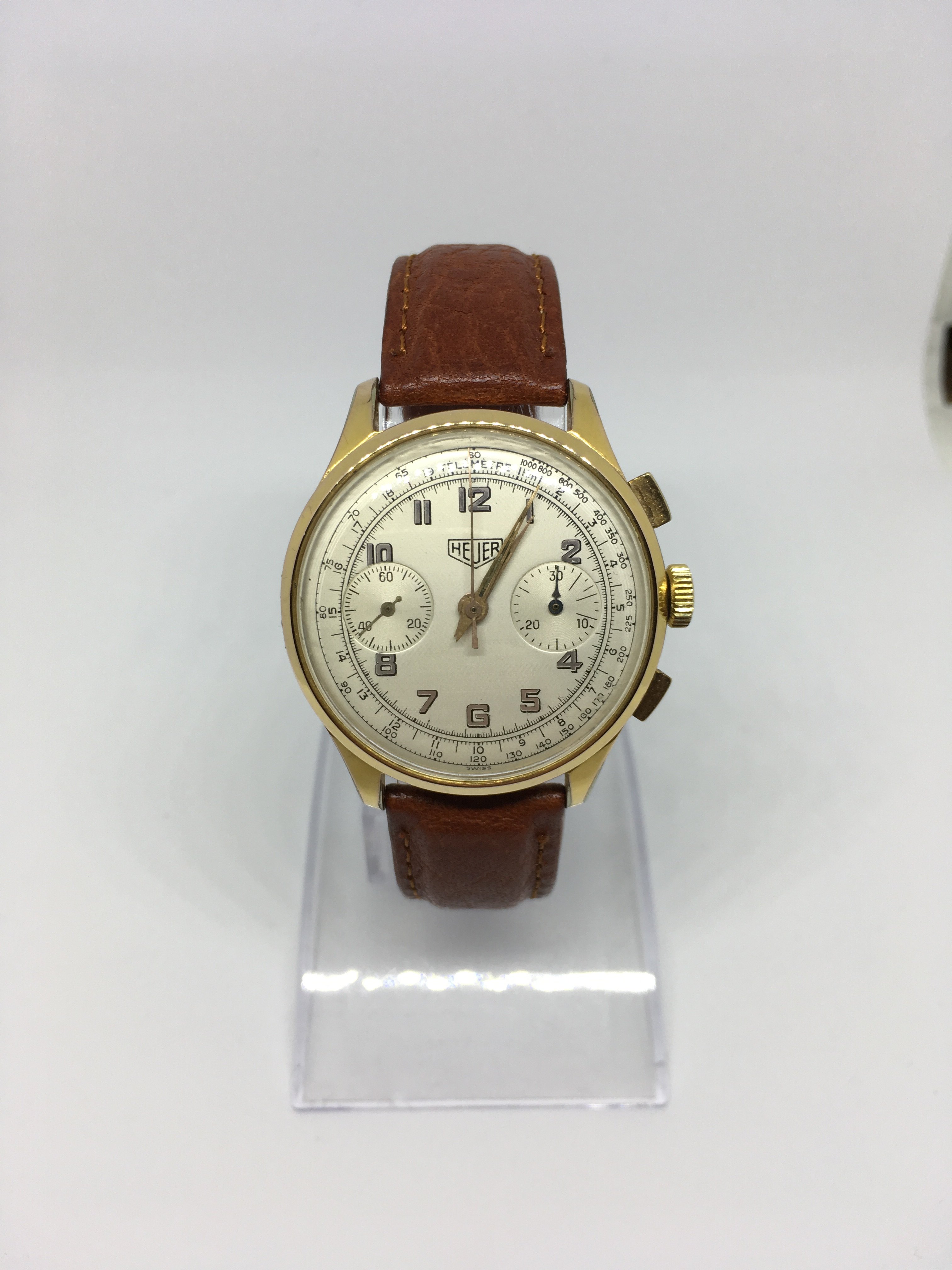

12
Sorry-I don't think there is anything Heuer/Leonidas there. Even the movement looks to have been 'signed' by hand!
Steve
Thanks Steve. Out of curiosity, what piece are they trying to copy here?
833
1,563
No problem. The movement is made to look like a genuine Heuer signed Valjoux 7733, but aside from that there is nothing overly similar within the Heuer range. I guess the closest would be the Heuer model 73373
Steve
