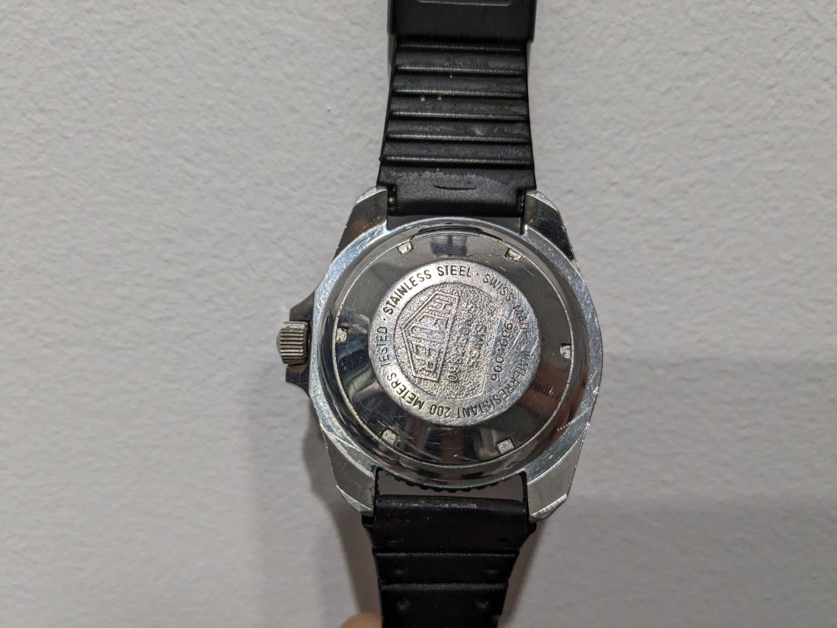

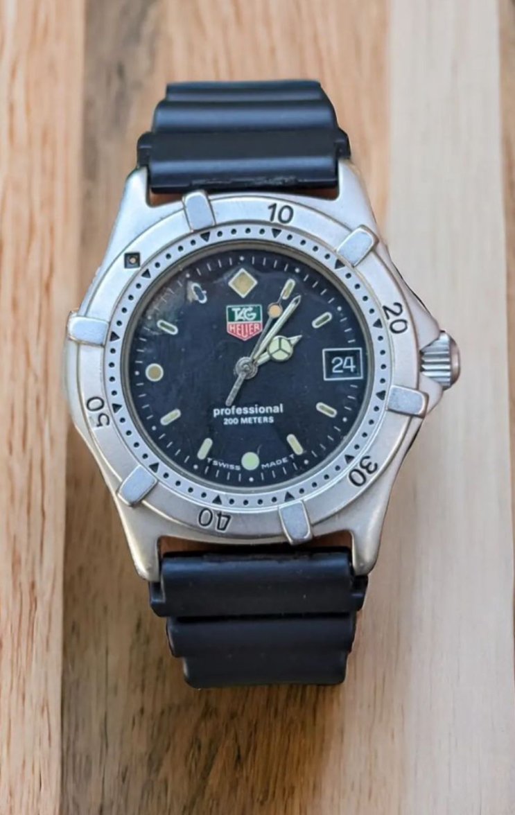

Hello guys ,i hope this message find you good,here is a ebay purchase ,i bought it for my father,i only collect vintage omegas ,tag heuers are not my thing.I received it today but it looks very weird to me.It is a fake?let me know please in order to send it back.(the seller didn’t upload the see through case only the movement so i thought it had stainless steel caseback).Thank you very much in advance.

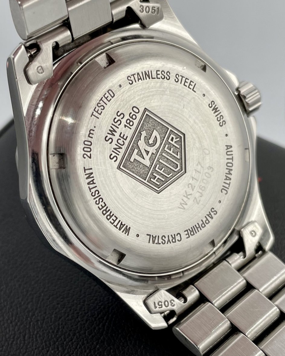

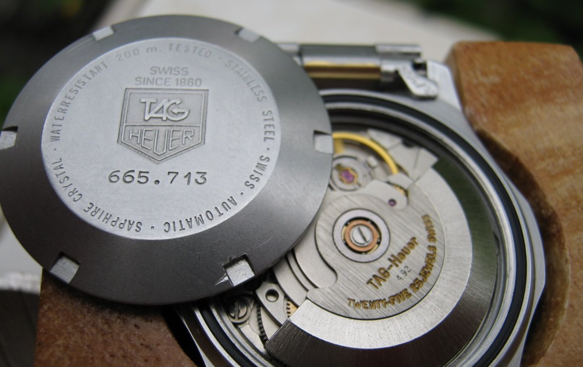

I'd say it's a fake. The logo looks suspect (poor quality), as do the endlinks on the bracelet (shape looks off). The caseback and rotor just look wrong. I don't believe TAG Heuer ever offered the 2000 series with a see through caseback. Should look more like these examples.
If you have a reference number for what the watch is supposed to be, I could tell with even greater certainty.

Thank you very for your responses guys ,i thought so too..It was a last minute auction and i didn’t see the photos well and it hasn’t shown the see-though caseback.Just open the case in order to return it.

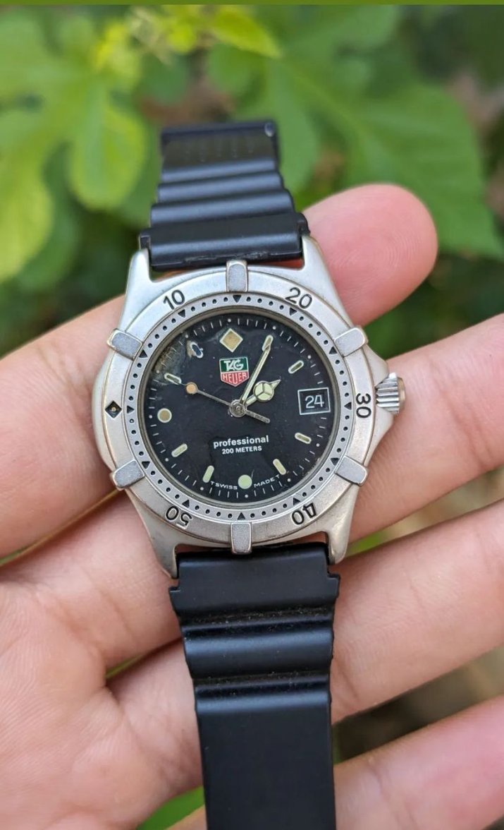

is this genuine?

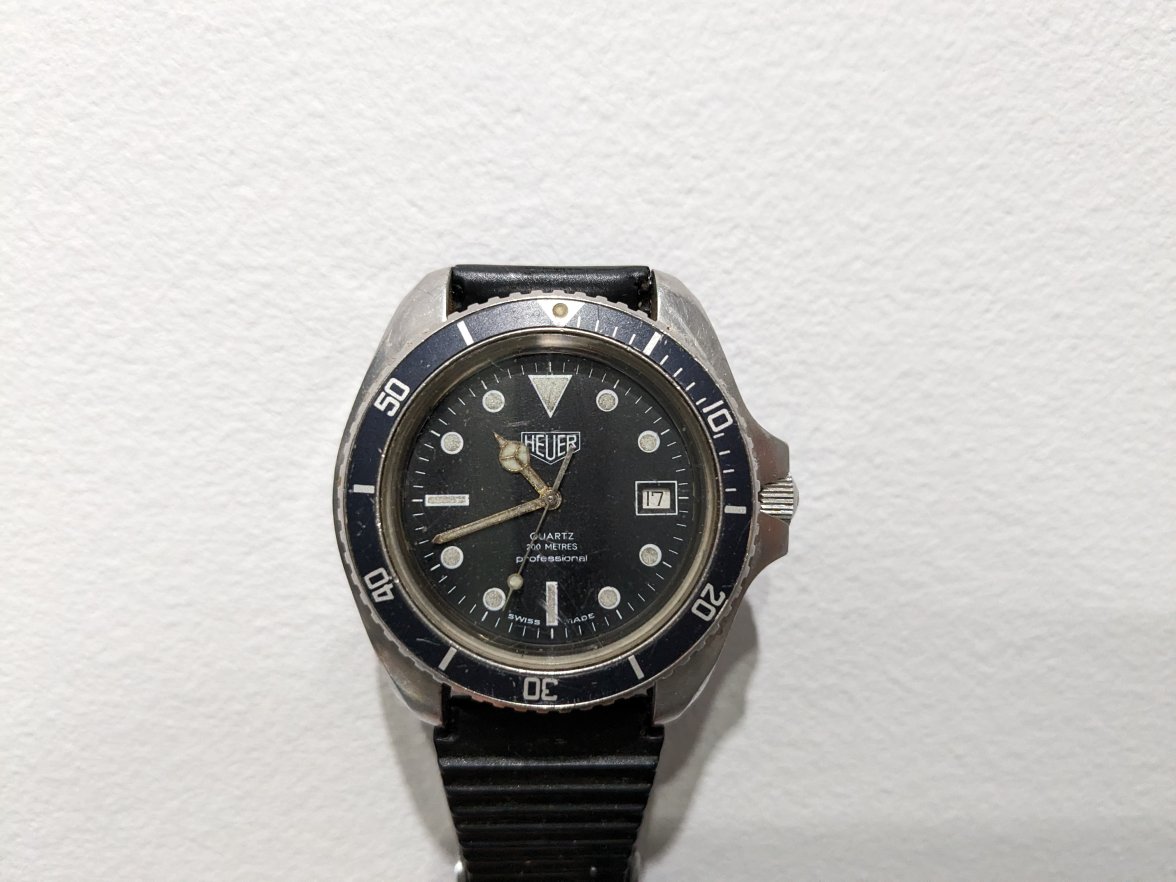

Need a lot of help here. My father gave me one of his old diver watches and I am trying to figure out more information on it. From my research it is an 844/4 and is in full working order. I sent it to Tag to just get a service and they informed me that they cannot service this, nor could they tell me anything about the watch. I would love to get the watch appraised and restored to gift to my father for ....any advice or help would be greatly appreciated.

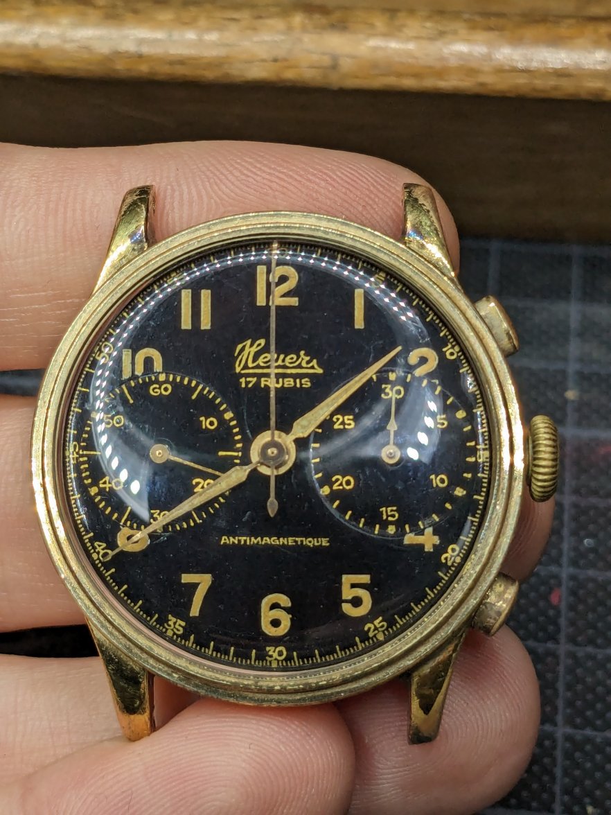

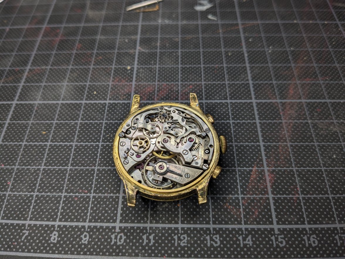

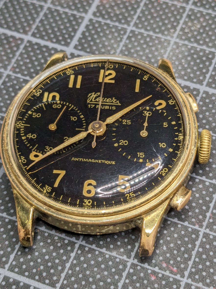

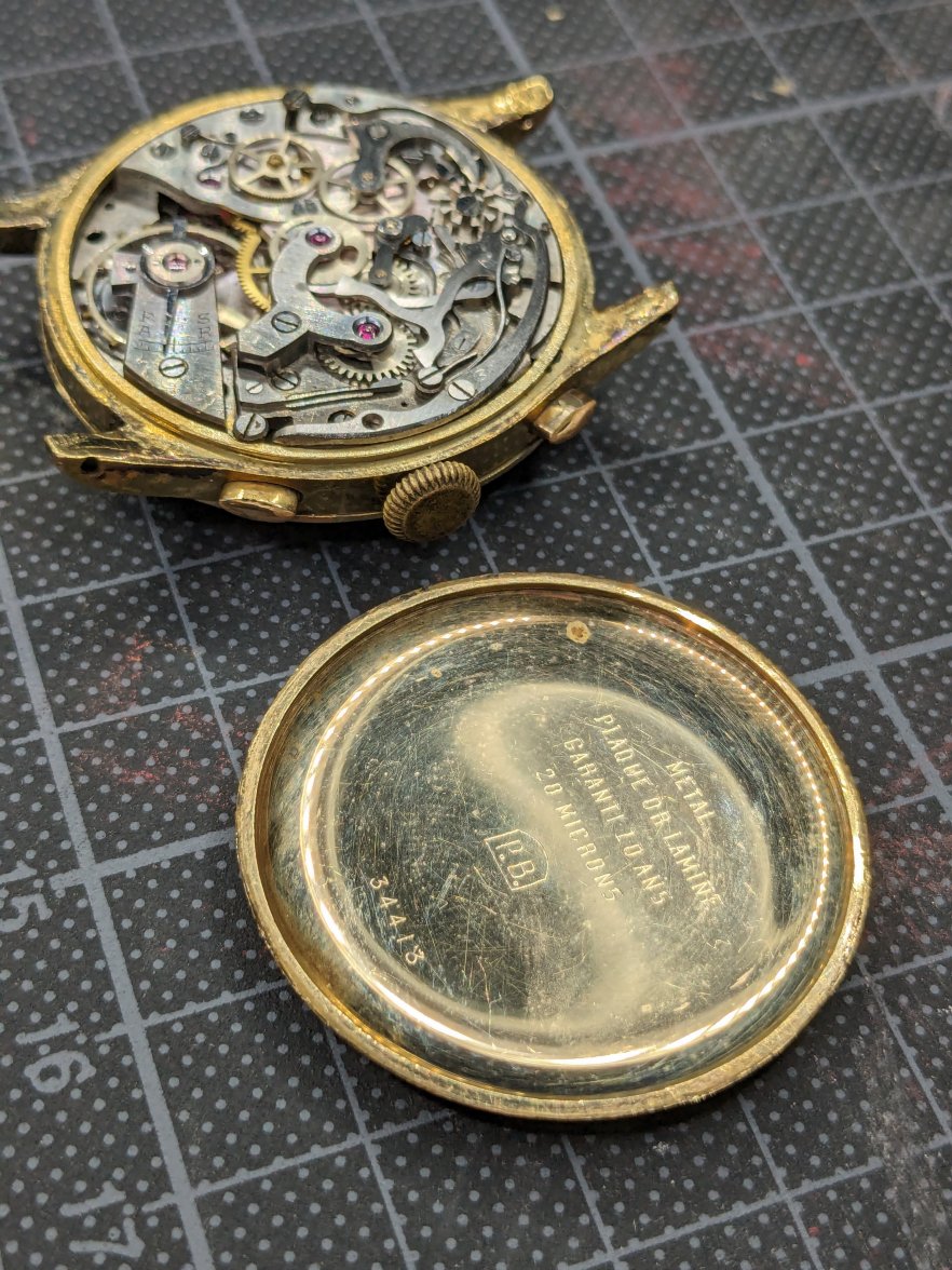

I recently acquired a "Heuer chronograph watch" unfortunately I cannot find any reference to the Heuer logo being in this style (though it resembles a slightly stylized version of Ed heuer's signature the inside of the case back is signed with plaque or Lamine garanti 10 ans, 20 microns, the initials p.b. and case number movement seems to be a valjoux 22. Does anyone has more information? Any information is appreciated
(P.s. New to this forum, but happy to be around here, please let me know of I can improve something.)
Edit note: uploaded some extra pictures in better lighting
