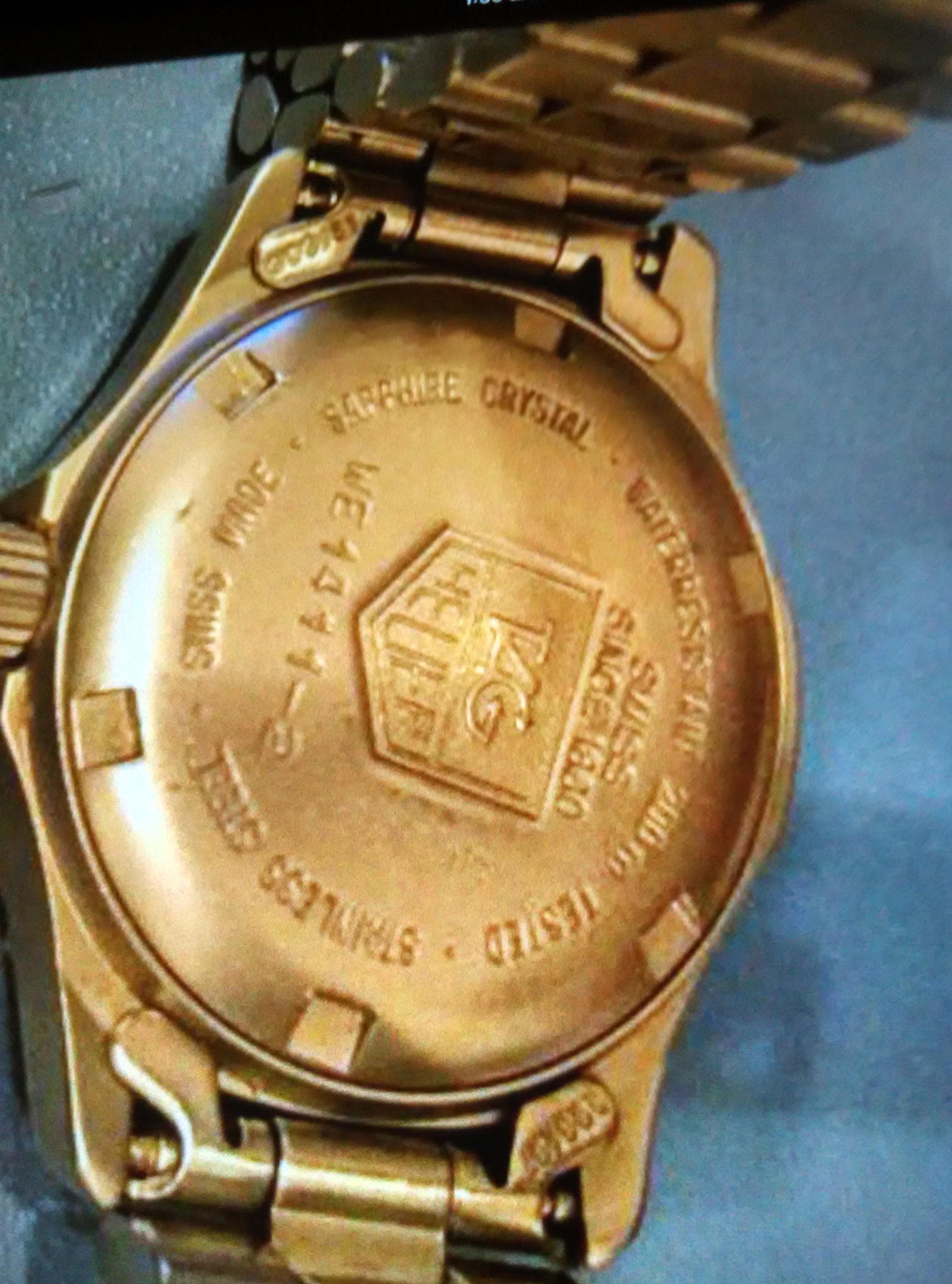

I was gifted a new Tag Heuer ladies watch quite a number of years ago, probably at least 15. I wore it only a few days while my other watch was being repaired. So it has been back in the original box all these years. I would like to sell it as I do not wear it but hesitate to do so in case it is fake. It did come from one of the jewellrey stores here but they also do not sell Tag Heuer anymore and have all had rumors of not being quite honest. So although the numbers are not one on top of the other but one on each of 2 sides. I am suspect but want to make sure. One number is WG1322-RO and looks original and the other number is RT8222 which looks a little bigger and not as deep engraved. How would one tell?

I suspect it's real, but if you can post a picture then I'm sure we could tell.

Yes Donna, I would advice to take a picture and show it here, that's the best way to check the watch, but the numbers and positions of them does not raise an eyebrow here, sounds OK to me as Imagwai already mentioned above.

Actually, not from this picture, need a much better picture than this one, preferably a couple of pictures made from different sides (front, rear, etc.) and do you have any more info like model number, numbers on the clasp and endlinks?

Hi! Ok will get it frm the seller. Thanks.

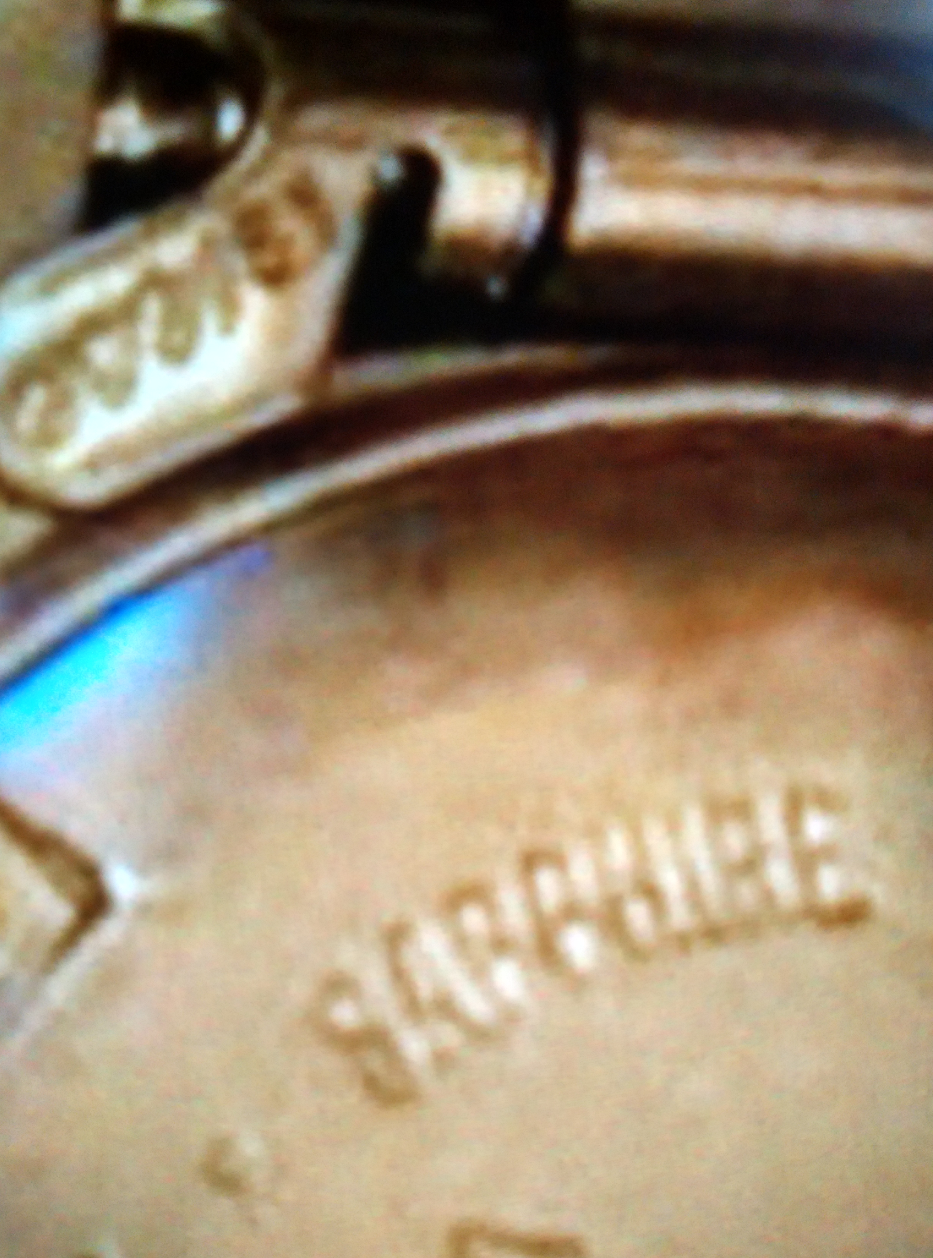

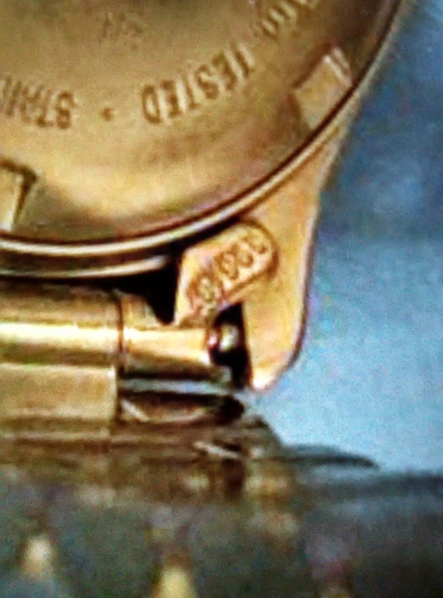

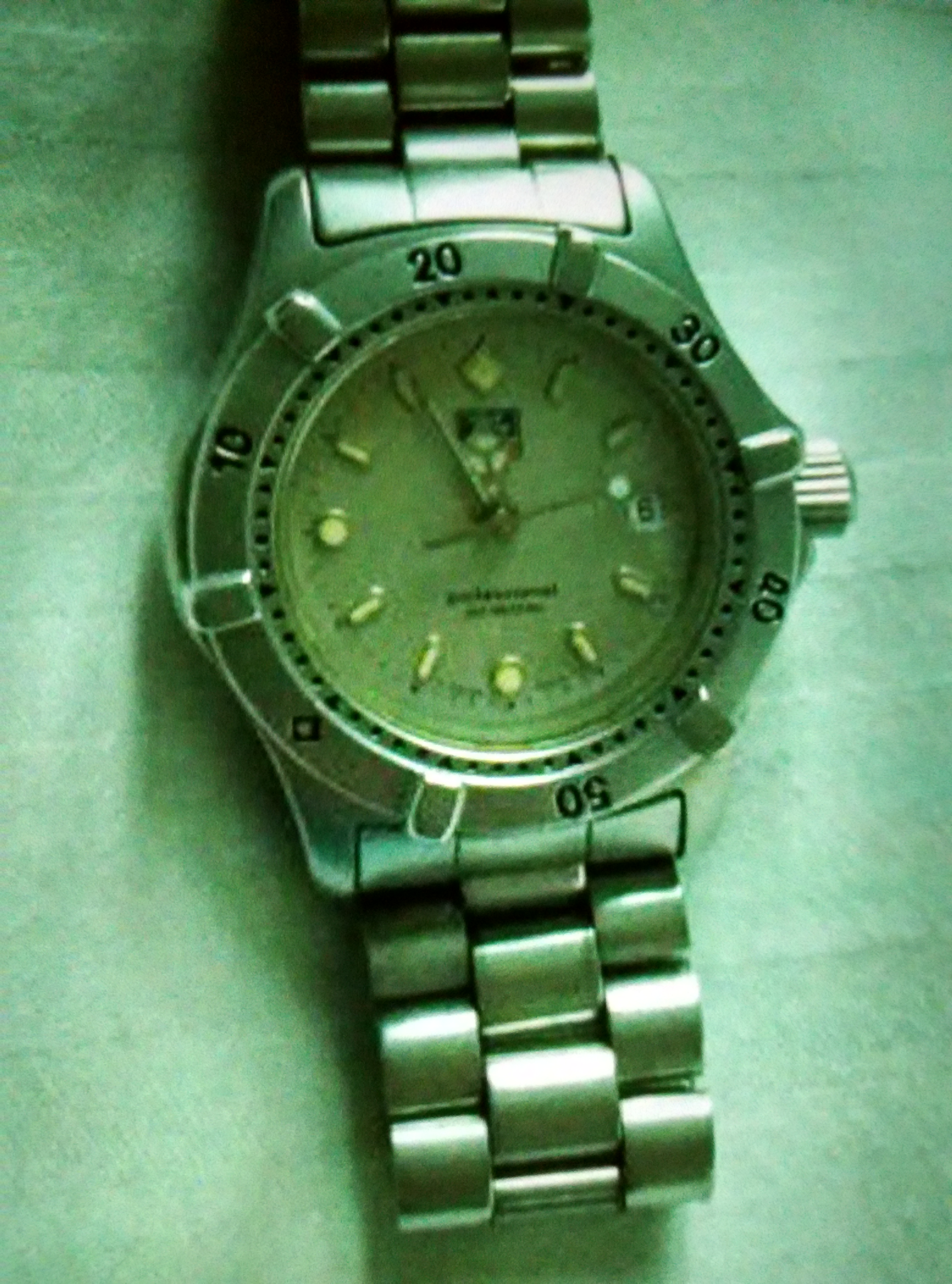

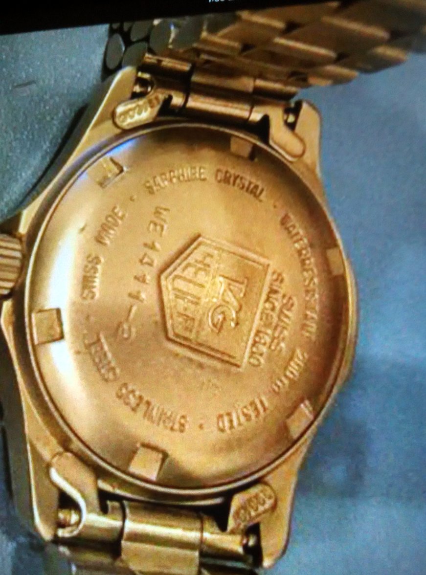

These are the pics that i can get from the seller. Will these help? Thanks.

Probably genuine, although the quality of the pictures is terrible. That's a ladies model at 27mm diameter.

Exactly as Imagwai says!

Ok thanks. Yeah...the seller took it frm a room with a yellow light.

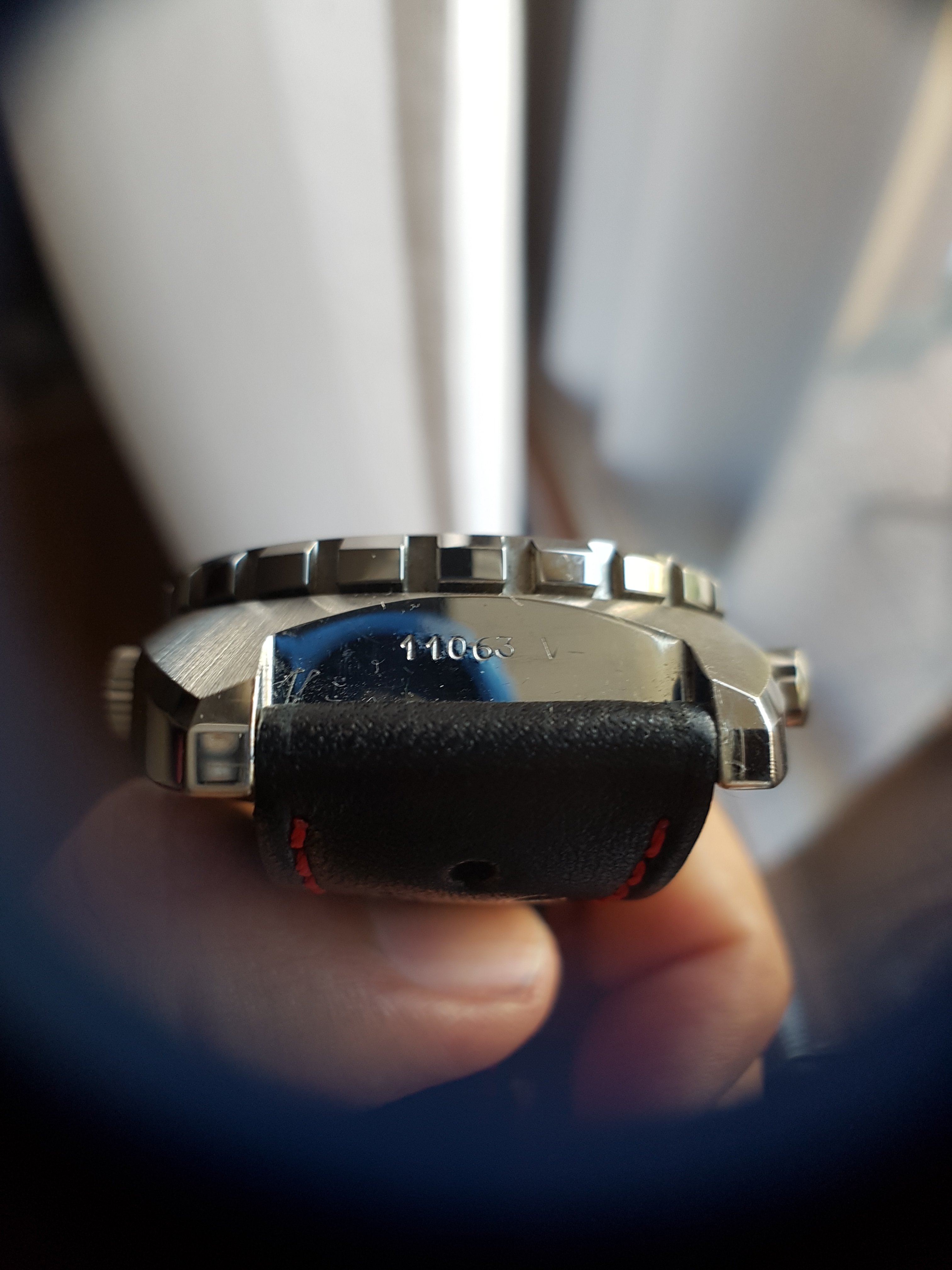

Hi All,

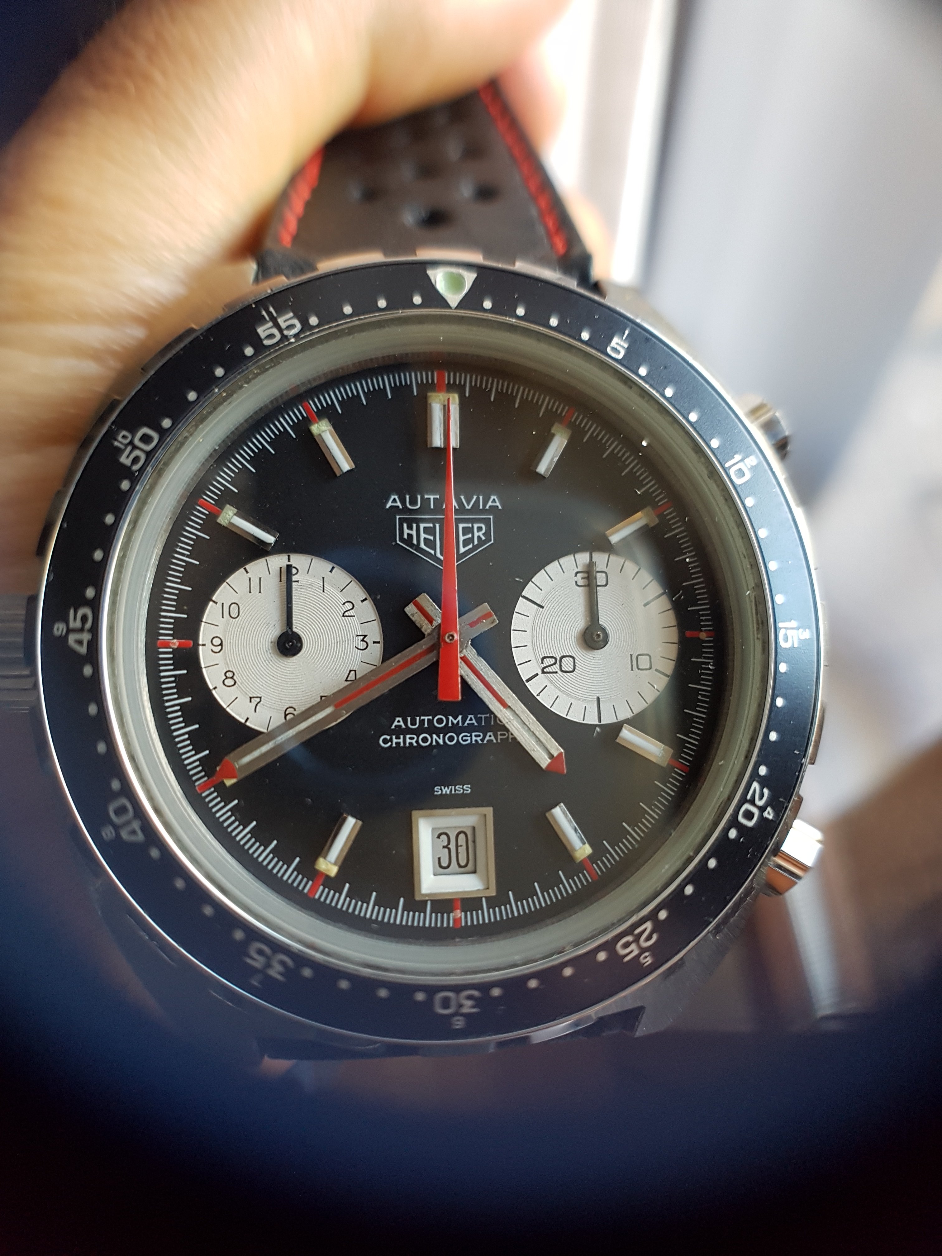

I am looking for some expert opinion/advice about a Heuer Autavia 11063 V that was offered to me a couple of weeks ago. Below the configuration and my concern:
- About the watch: it's a close-to-mint condition Autavia 11063 V, with a correct 11063 V case with sharp edges, unpolished. MH bezel, movement, dial and hands are in a superb condition as well.
- The case number is '394XXX', which gives me concerns. According to the OTD reference table (http://www.onthedash.com/Guide/_Chronographs/62.Autavia/), this watch is supposed to have a black/black dial and different hands. Alternatively, this is a correct Viceroy, but then the case number and the bezel don't match.
- Photos attached as a reference.
I think originality comes first. And even though I have identified the mismatch above, seeing the condition of the watch gives me doubt that this might have been assembled like this back then, and it falls under the category 'undocumented factory assembly' etc. I'd love to hear what the community thinks about this.
Thanks in advance!

Hi,
The guys at OTD have done a power of work on case reference numbers, but I would be cautious about using them as hard and fast rules- especially in the early/ mid-1980s.
Yes, I'd say that there is a chance that the watch has been put together later (especially as the later Autavia 11063 with Viceroy colours is the 11063T- so not with the MH bezel.

Thanks for your response, Calibre11! I could not agree more, especially on point #1: I have a lot of respect for the OTD's list and the effort behind it, and that's the exact reason why I always find it difficult when someone comes along challenging it. Btw: as someone pointed out on a different forum, the dial seems to be original but for a 1163, the bezel being MH instead of a T could be a factory option. So all original? Yes. Is this how it came from the factory? Well, hard to say.
7,124
15,117
It's also worth keeping in mind that in the early 1980s, Heuer was a bit of a mess. After Jack's exit in 1982, it was all hands to deck to keep the company alive. Sometimes we expect to see a logic and precision in- for example- which bezel is used that just wouldn't have been a huge priority back then.
I believe the OTD list is based on taking a series of samples from collectors. That's the best way that we have to work out serial numbers, but it's not bullet-proof.

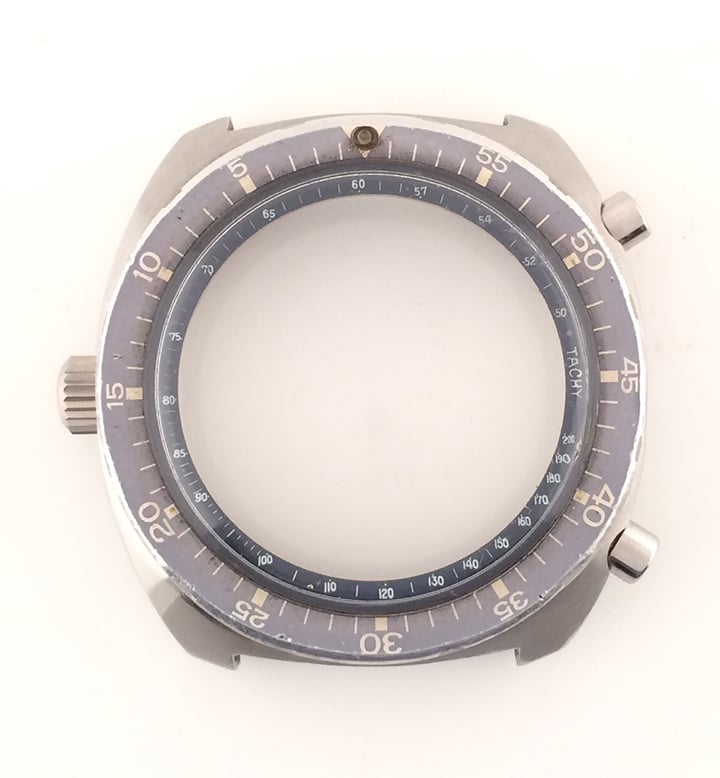

Not new to vintage watches, but brand spanking new to chronographs and Heuer, so forgive the Newb question:
Is this a Heuer case/bezel/outer ring? It was advertised as such, but I cannot locate the model.
Thanks for any help locating the model or debunking it as a Heuer.

No, this isn't an Autavia case/ bezel, but it does look to use the Chronomatic movement. I don't know Breitling's back catalogue very well, but they were the other brand that used the distinctive left-crown movement, so I'd look there.
