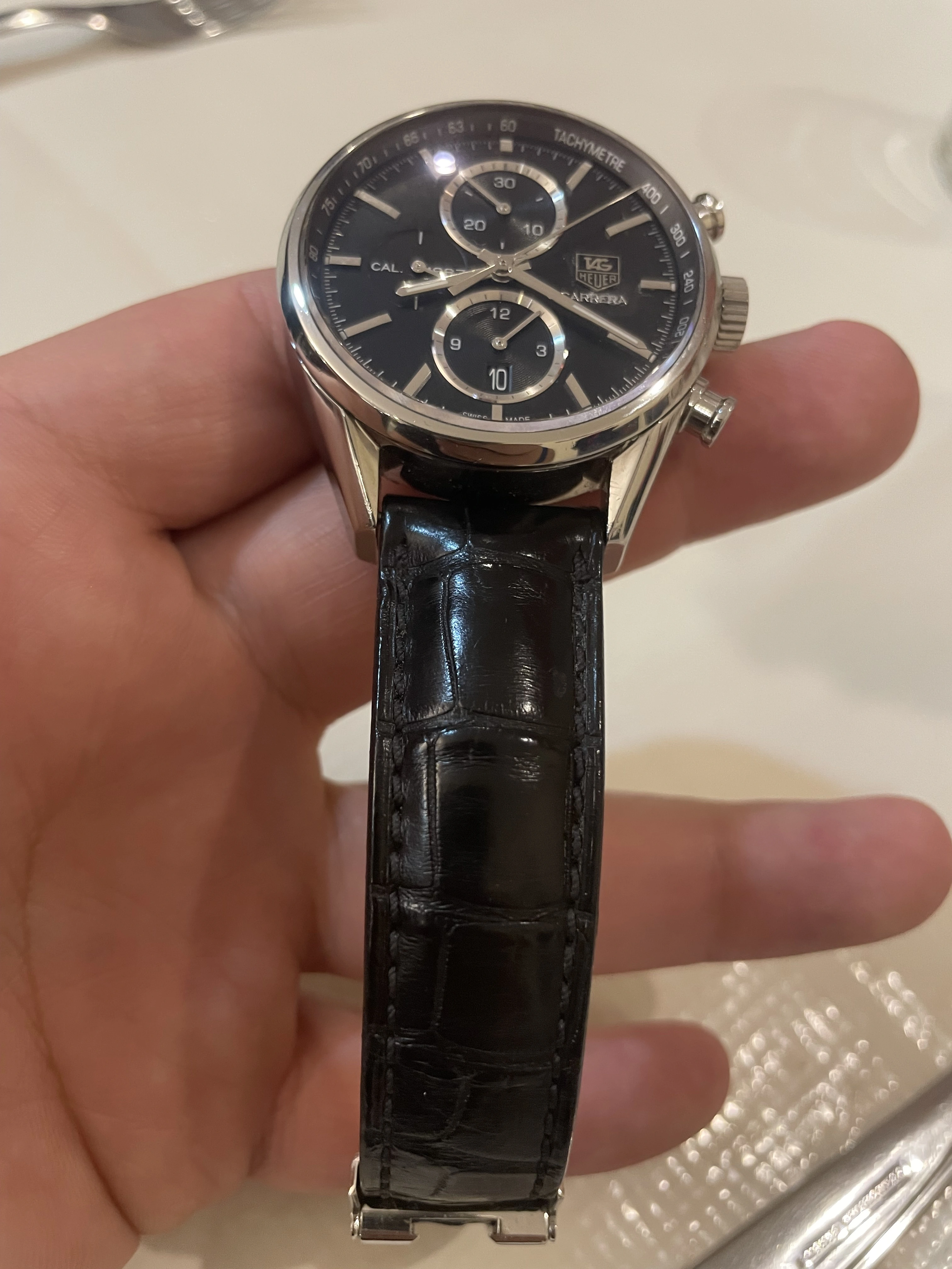

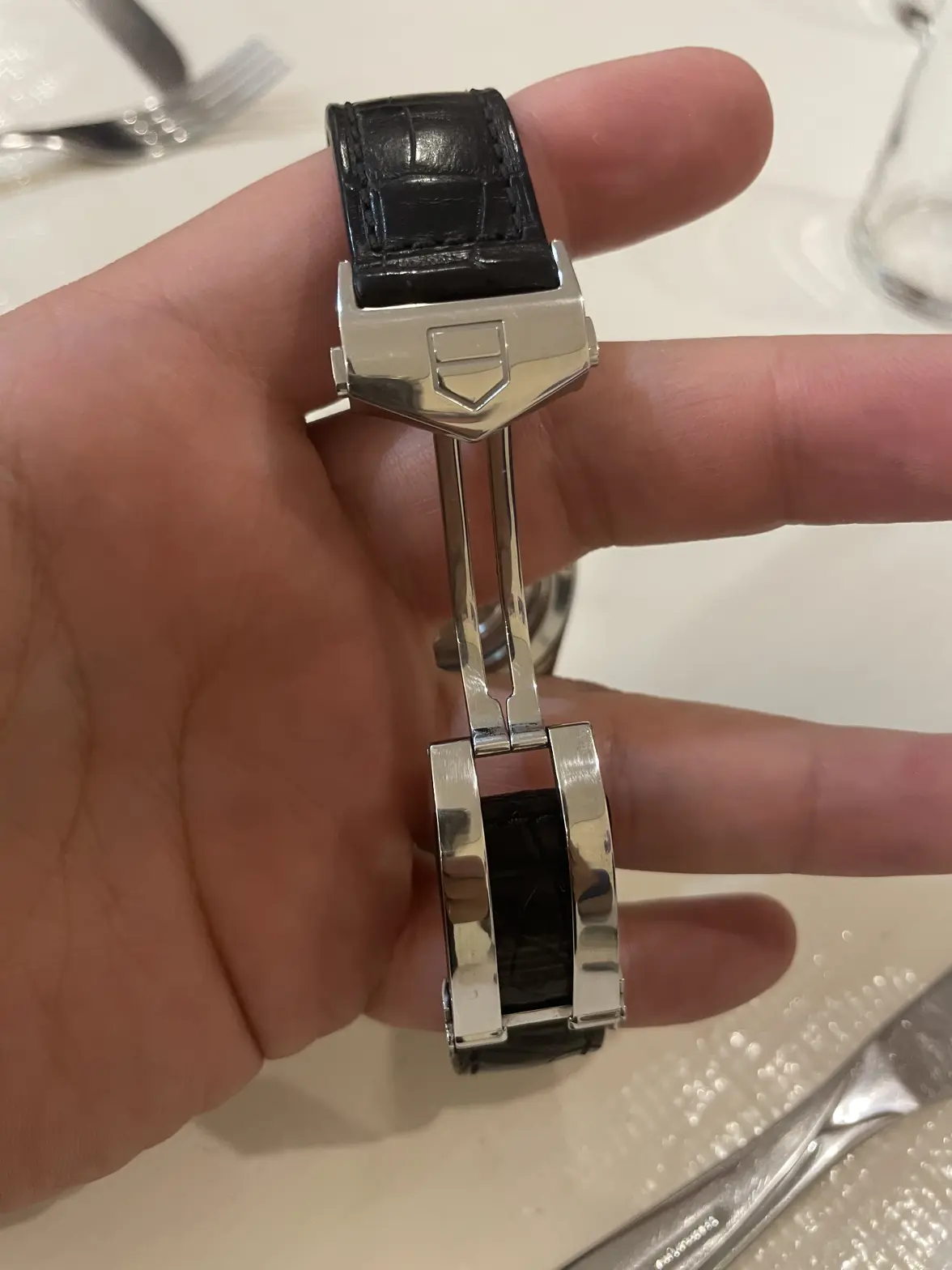

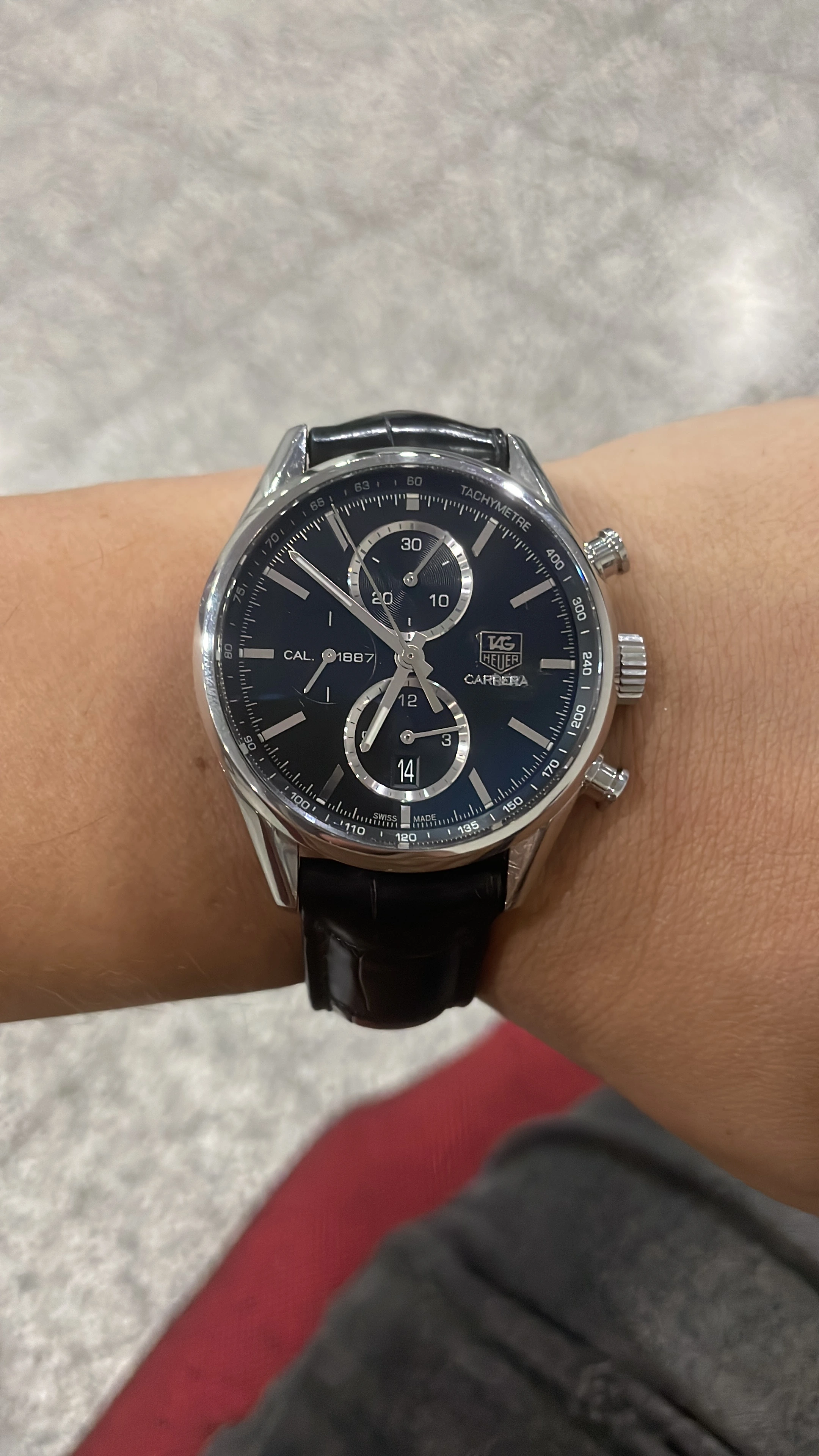

Alguien puede decirme si este Carrera es original y de qué año es?
Watch model is from 2010
I’m not sure about its authenticity…. movement looks fine, but logo on the dial is not correct, and also there’s something wrong with the 'CARRERA' text. It’s maybe an original watch that has suffered some damage to the dial.
Parece que sufrió algún daño en el dial, y le han colocado un logo incorrecto, y le han pegado el texto “CARRERA” de forma un tanto chapucera…

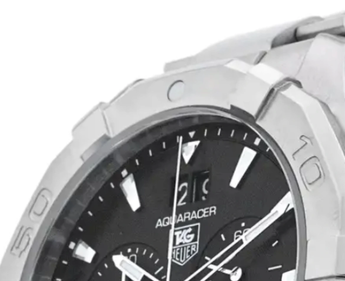

Personally I have never seen a genuine one with that lume pip of yours, one of the easiest and most common issue and tell on a counterfit Aquaracer.
This is the lume pip on an authentic CAY1110:

Hi Drew,
Your watch was returned from official TAG Heuer service rejected due to counterfit? Now three independent jewellers looked at it and tell you that it is genuine. Do I understand correctly that you trust three independent jewellers over the official TAG Heuer service center? Or did you talk to the service center and clear things out like you said you would, after which it was confirmed that TAG Heuer does not consider your watch to be counterfit?

Hi Drew,

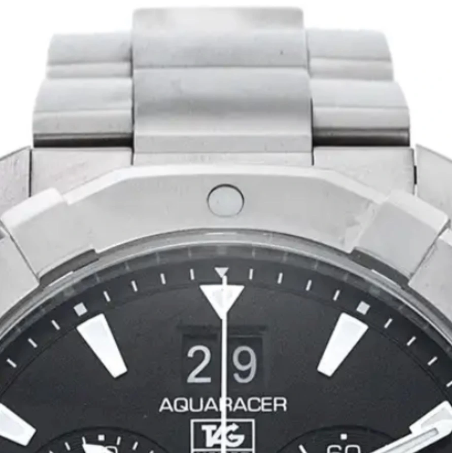

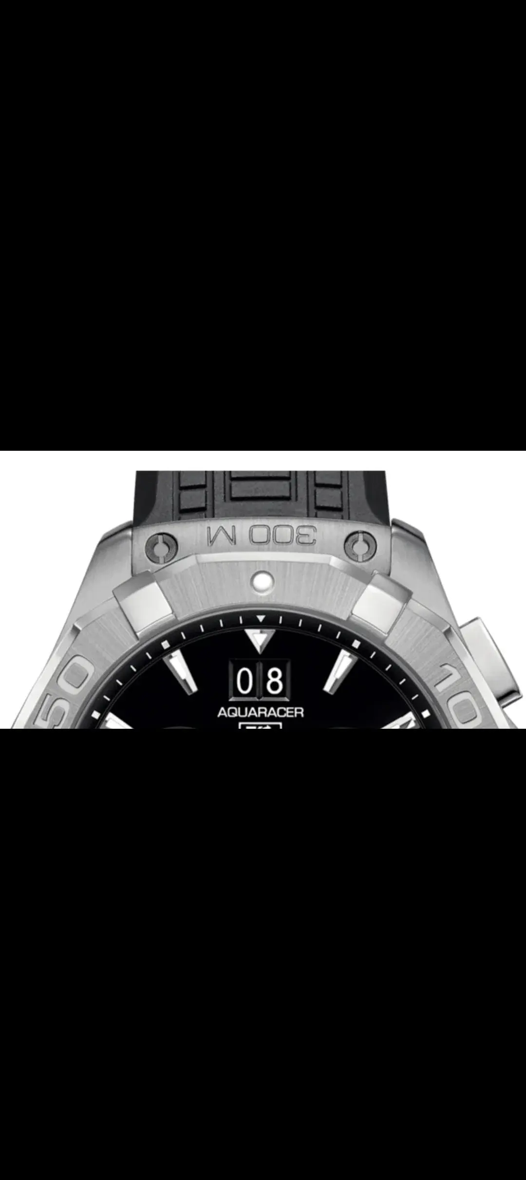

This is an official TH website photo showing the Lume pip to be exactly as mine. There were also some slight variations to this model.
After ten years of spending way too much of my time reading about, collecting and obsessing over TAG Heuer, one thing is for sure and that is the fact that digital online renders rarely look like the actual product irl. There is a running joke in this forum that TAG should fire the person responsible for digital renders.
Either way, there is no point in arguing, the important thing is that you are happy with your watch and that you feel comfortable wearing it.
