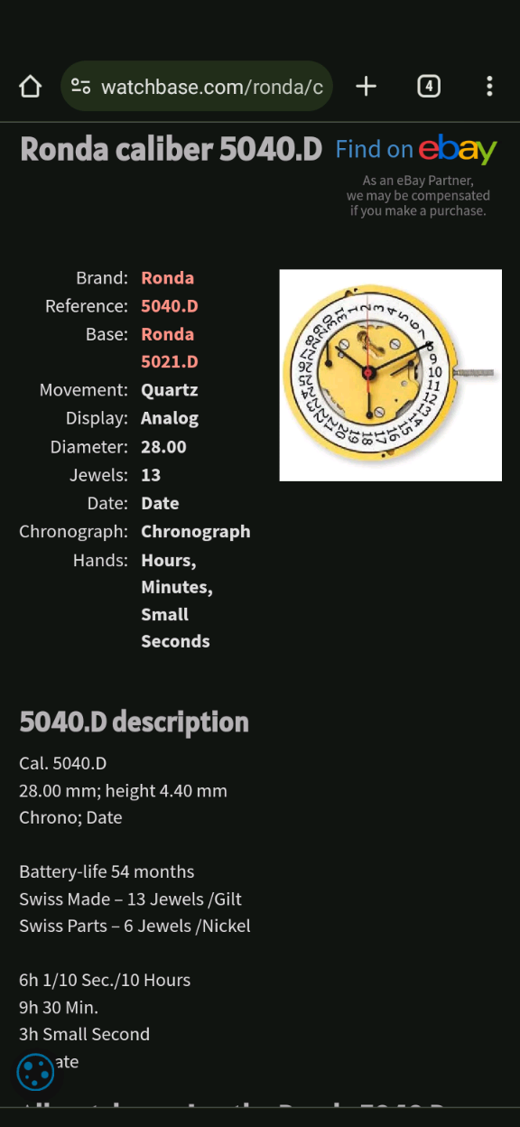

I check watchbase for info but it lists both 13 and 6 jewels for a Ronda 5040.d in that model:
https://watchbase.com/tag-heuer/aquaracer/cay111b-ba0927
https://watchbase.com/ronda/caliber/5040-d

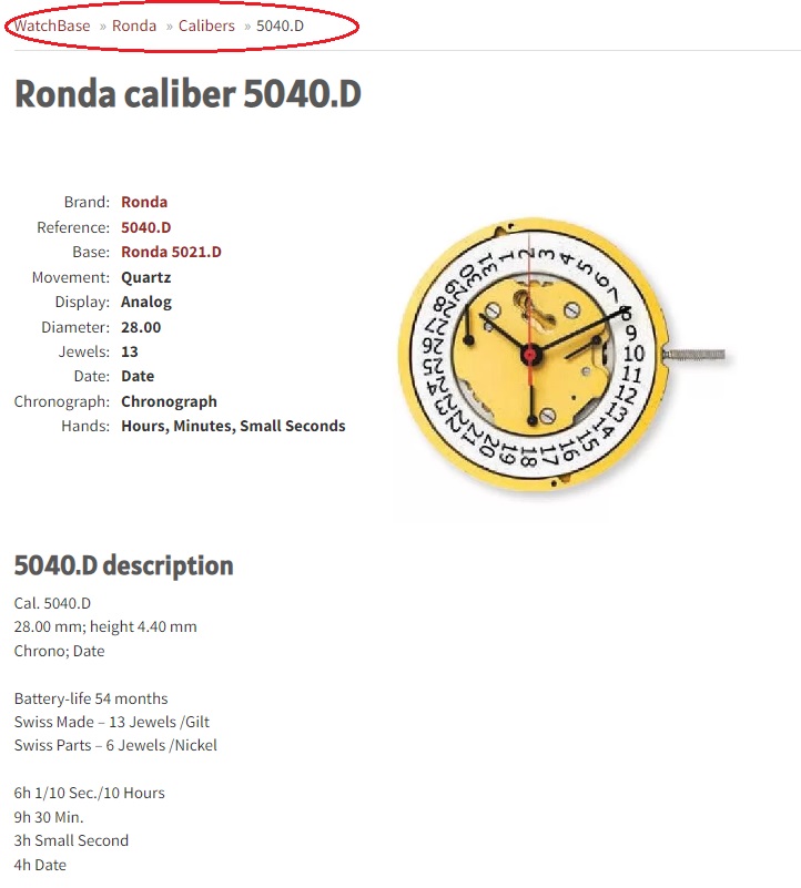

No, I don't feel that is what Watchbase is saying. Watchbase doesn't state the specific Jewels used for the CAY111B, it just lists the movement as 5040.D.
Then when you click on "5040.D", it then brings you to an independent & separate page for the Ronda movement. It's this generic page on the Ronda movement that says two versions, Swiss Made 13 Jewels or Swiss Parts 6 Jewels. It's not specific to the Aquaracer CAY111B. Any watch listed in Watchbase that uses the same movement would go to this Ronda movement page if clicked on. For example, if I enter my F1 Gulf CAZ101N.FC8243, it shows the same.
See the heading says Ronda> Calibers > 5040.D, it's not specific to the Aquaracer in question.
Most places that list specifically for the Aquaracer CAY111B (or CAY111A black color) say 13 Jewels. Crown & Caliber says 10, but I'm pretty sure that's a mistake.
I've not run across a site that says 6 Jewels for the Aquaracer CAY111B.

Understood, fakers seem to rely on Watchbase for their info.

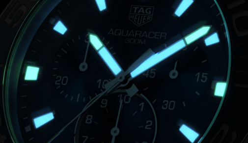

When we are at it I did a lume check and colours are wrong on the hands. The hands have the same greenish colour all over, should only be on the tip. This pic from TAGs site.

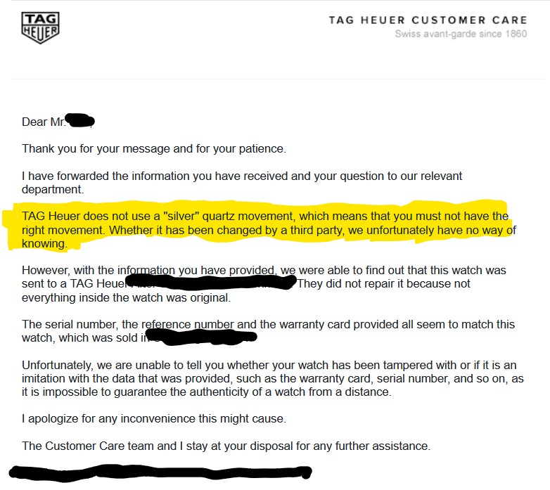

Today TAG Heuer replied to my e-mail and confirmed that they never use the silver version movement in the watch. Kind of expected but nice of them confirm this.

That should be enough for you to return it, no? That and the many other red flags we discussed here…

Probably a good idea since this is a statement from TAG it adds some significant information on a legal level. Although well known by some experts in here.

The problem with the "Is My TAG Heuer Authentic?" thread is that there are literally thousands (6000+) of posts in it, making it almost impossible to find things. I rarely ever read that thread now days.
It would be better if one of the mods, @Hubert or @Albert-AMG, could rename this thread something like "How to spot a fake quartz Aquaracer" and make it a sticky.
It also would be helpful if @Patrick Pihl can post an actual copy of the official TAG Heuer response here, with anything personal deleted or covered up. That way it's more than just hearsay found on the internet.

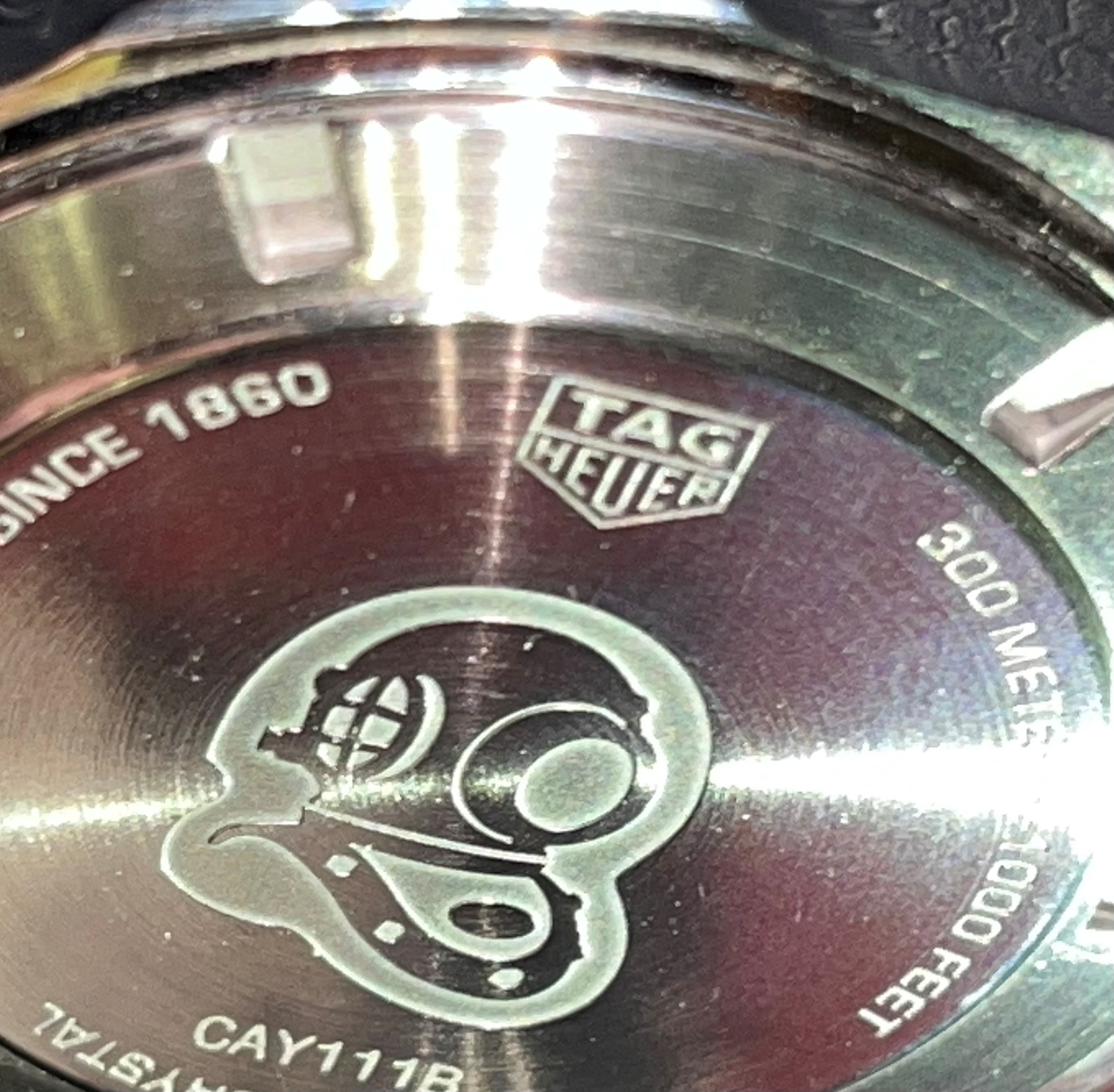

Im not 100% convinced that one could tell from bad photos. As I said it look much better IRL. I gave it a thought and landed in that my iphone processed a lot of low light noise and smothered out details. The photo below looks much better then the one on page 3. Anyway the movement gave it away for sure. TAG service centre had the watch for repair/service and did not noticed it was fake until they opened it. Another reputed watch firm here in Sweden said it was genuine and they even changed the battery and was asked the specific question, is it real?

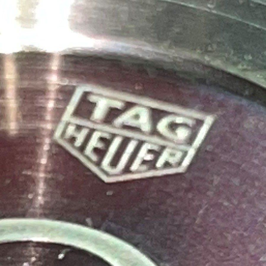

That does look better from afar. However, the TAG logo is now out of focus, so it's even harder to analyze the details when zooming in.
But I agree it's super hard to visually spot the differences on these well made fakes. I can spot fakes of the F1 Gulf easily because I own the real deal. For the average buyer who doesn't have an authentic piece to compare, it's very hard to know.
