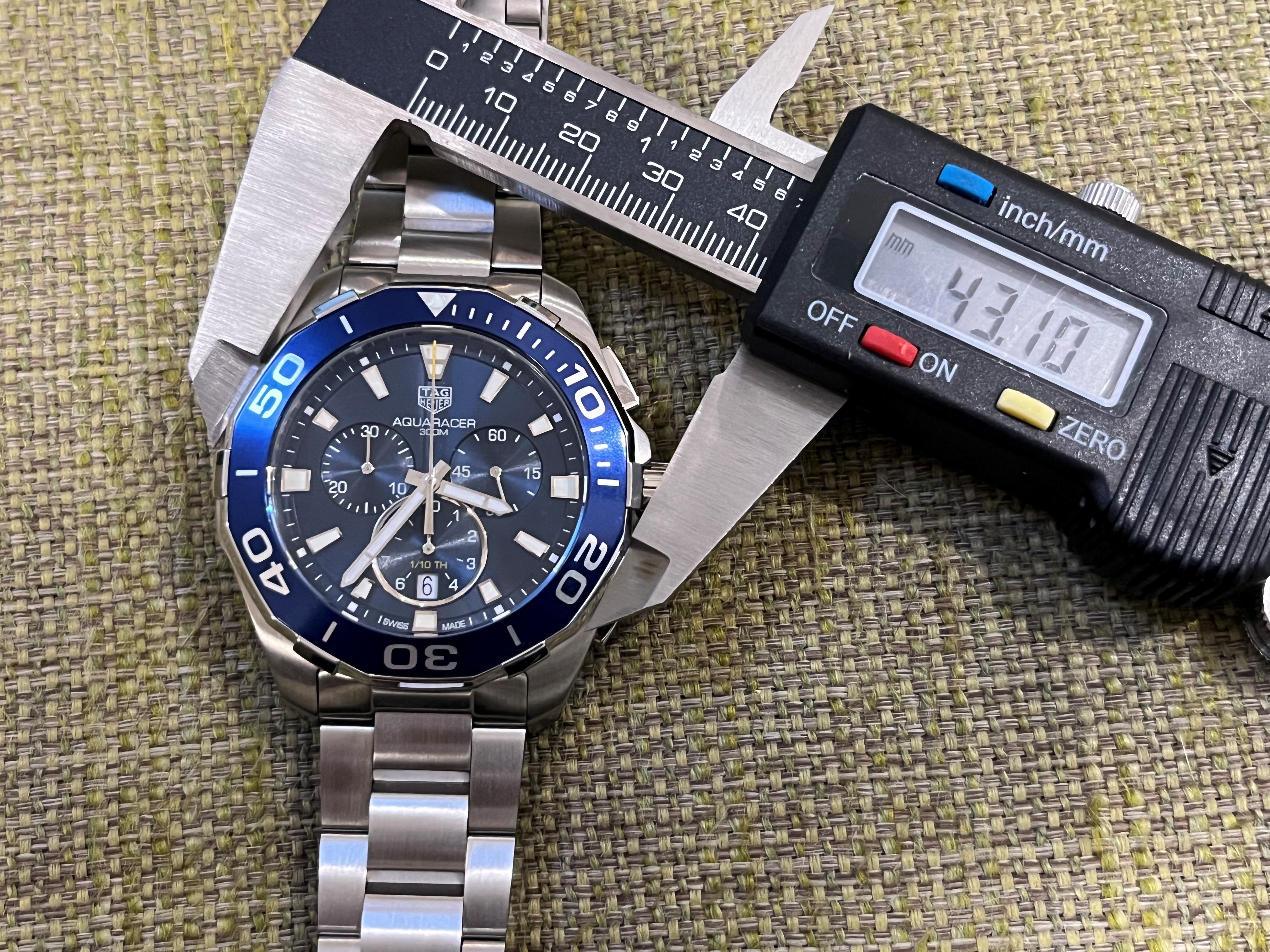

My first Tag Heuer CAY111B just arrived 😀 Im a bit puzzled on the size. I says 43 mm but when measuring I get the bezel to be 43 mm and the case somewhat bigger?

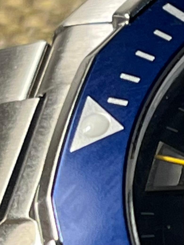

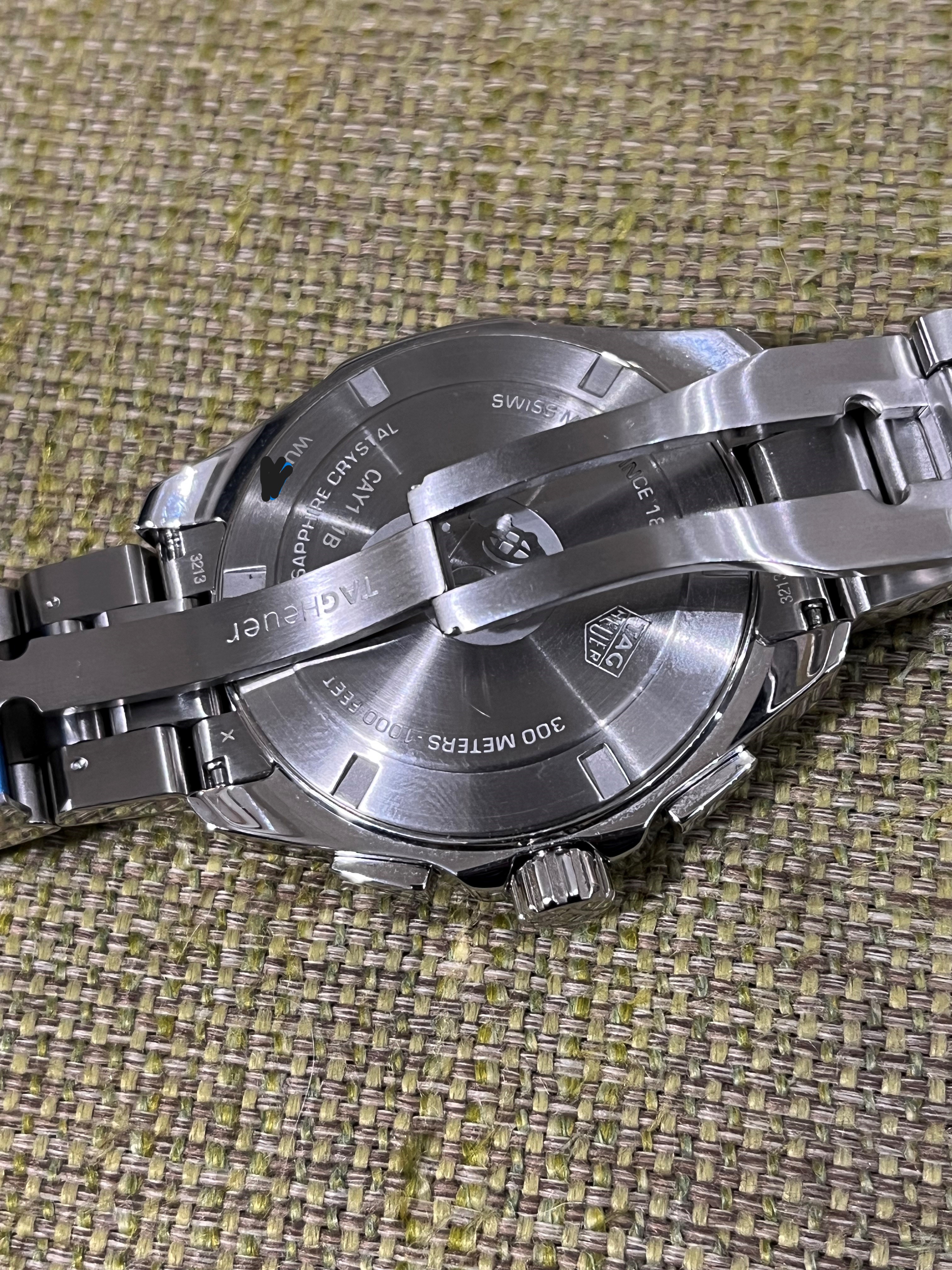

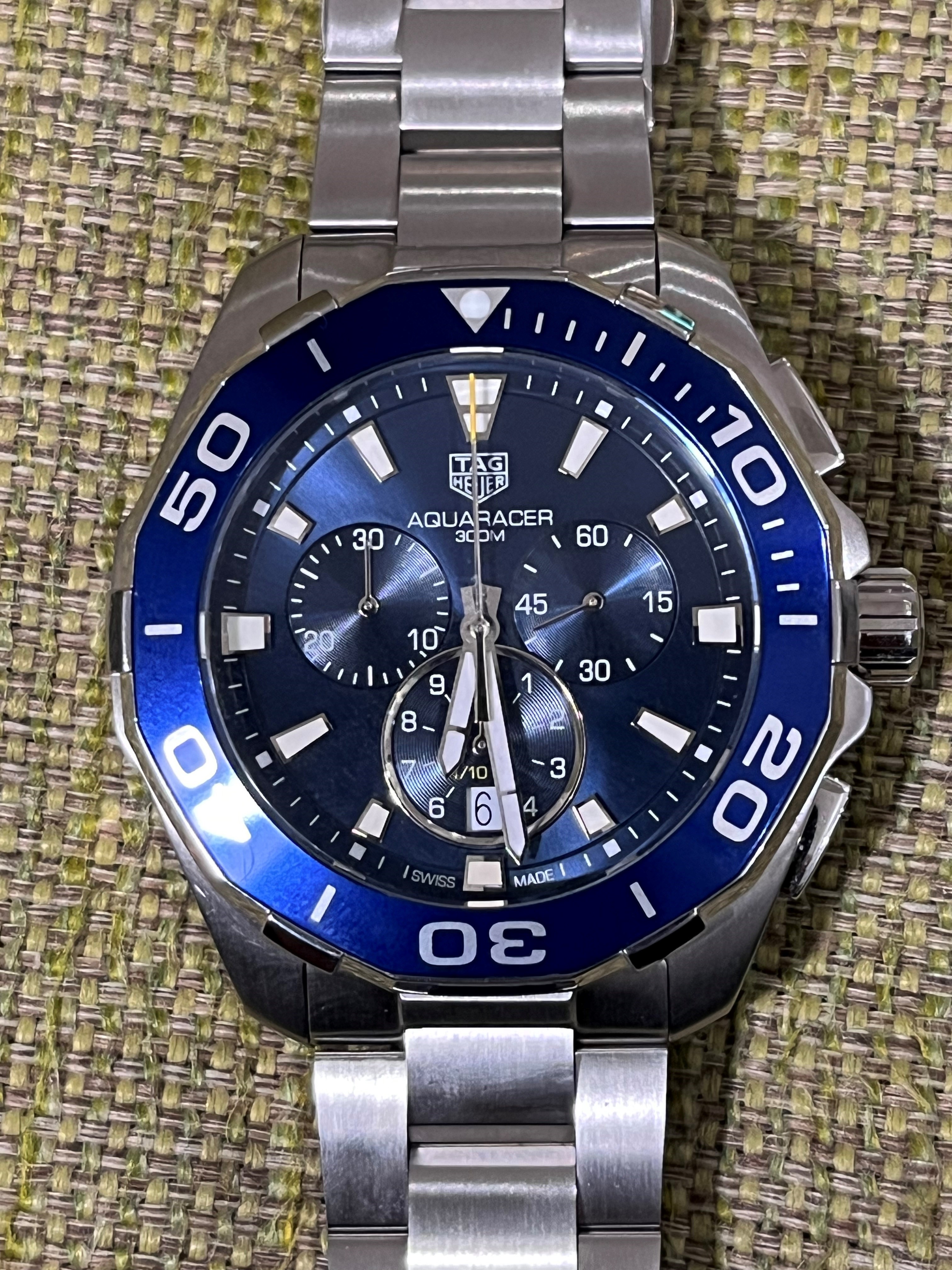

Pics.Some imperfections might be of photographic nature.
Yup to me it is very clear that this is a counterfit watch, it has the classic instant giveaway, that being the lume pip on the bezel. The lume pip looks nothing like it should on a CAY111B

Yes I have read about that and it should be immersed. Still when looking on photos on other watches of this model I cant always see that?

That is most likely because the world is full of hundreds of thousands of people wearing fake Aquaracers, posting photos online, thinking they got a "good deal" on crime bay (Ebay).

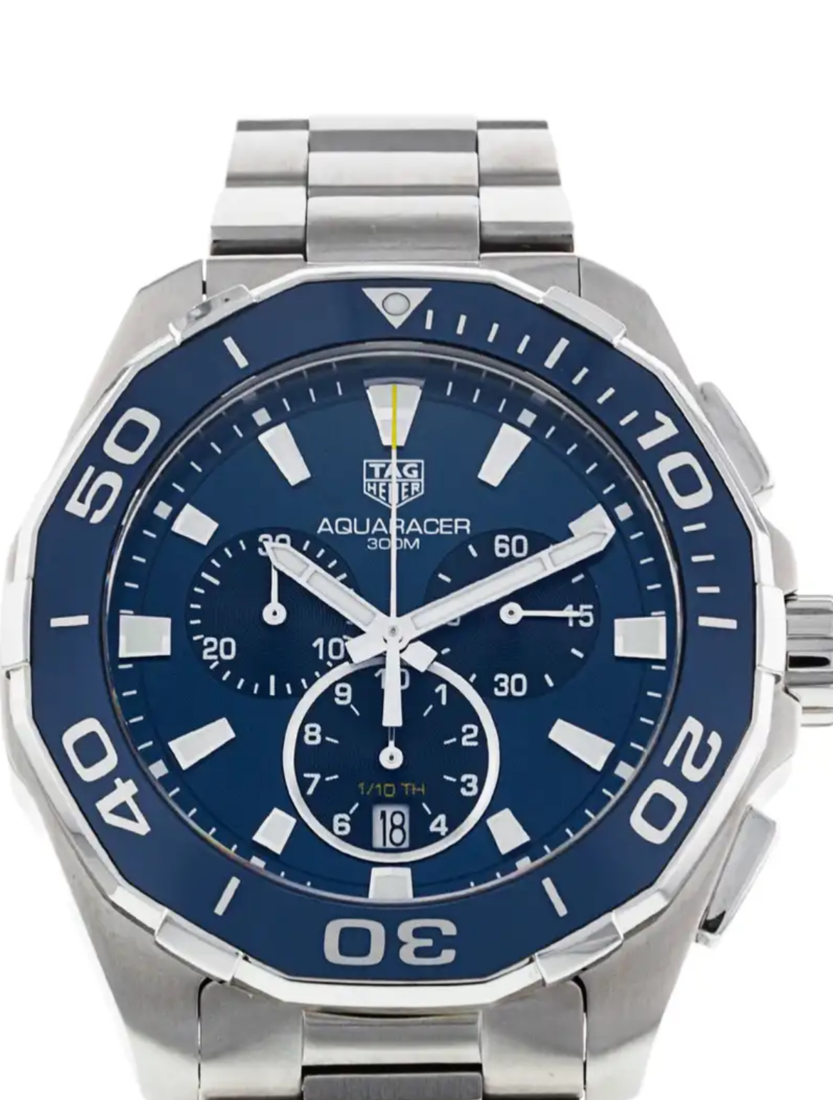

This photo from Watchfinder shows what the lume pip should be like

How about the size? Where to measure 43 mm?

Regarding sizing, it’s never an exact science

sizes are consistent for a given model, they just don’t match the ‘41mm’ or ‘43mm’ that the manufacturers state.

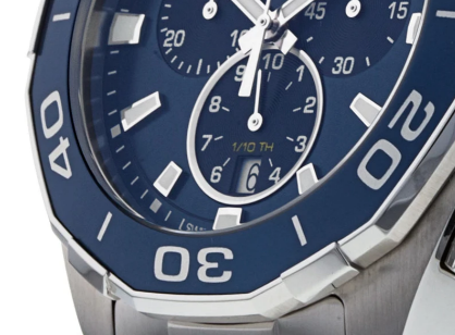

Compare the lume pips:

Yes what Doug means is that many times it will say that a watch is, for example 39mm, but in reality that model might be 39,6 mm. I think most manufacturers simply don't state the exact size down to tenth of mm.

Here is another shot of the lume pip. I looks quite different in this pic/light. It is recessed but not 100%.

I'm no expert with these fake Aquaracers. But even the Watchfinder photo looks suspect if you ask me. It's missing "Swiss Made" at 6 o'clock.
Nope, you are wrong. That is just the angle of the photo. Here is another photo from the same listing and we can see the beginning of "Swiss" showing a little bit.
