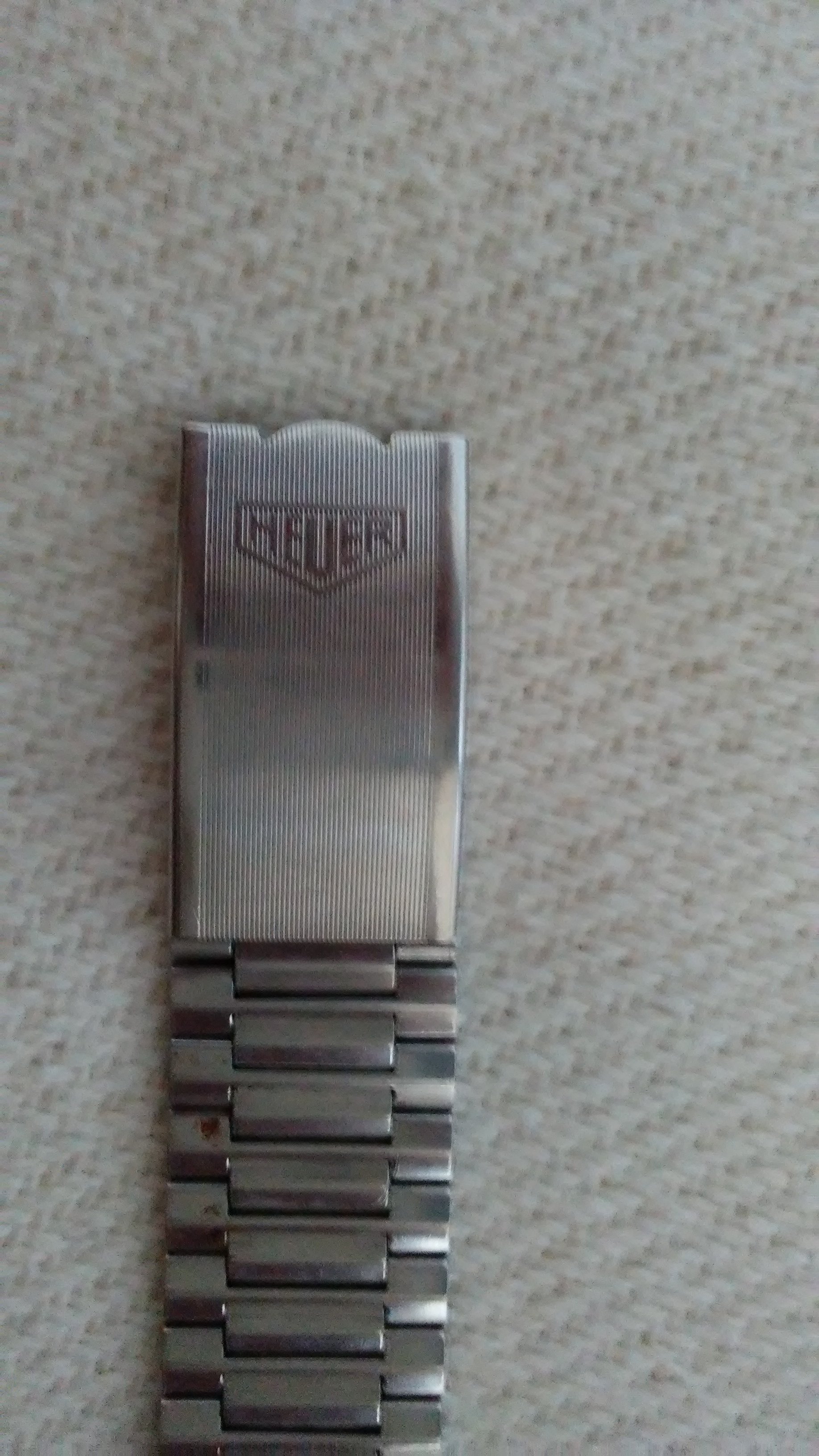

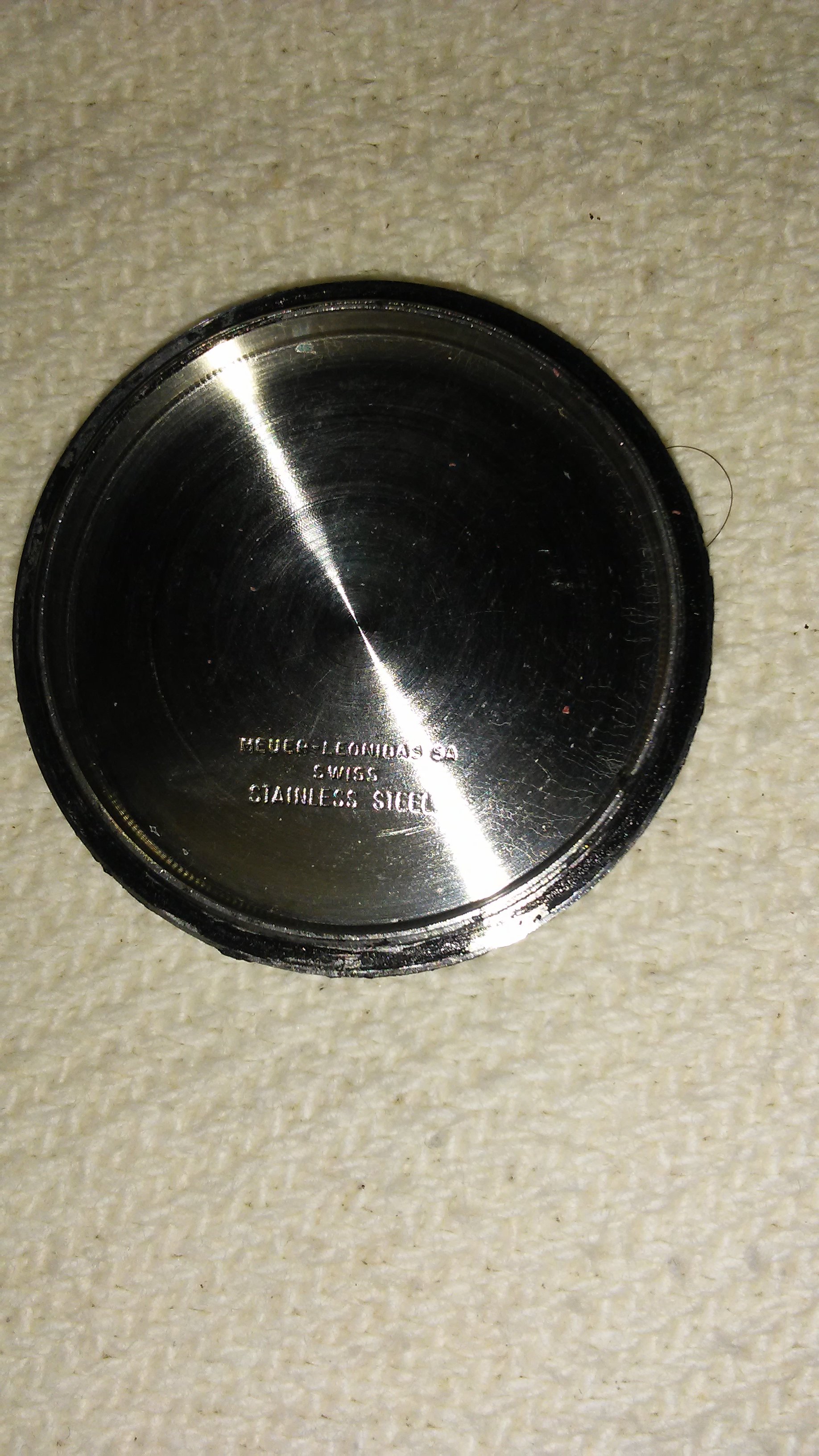

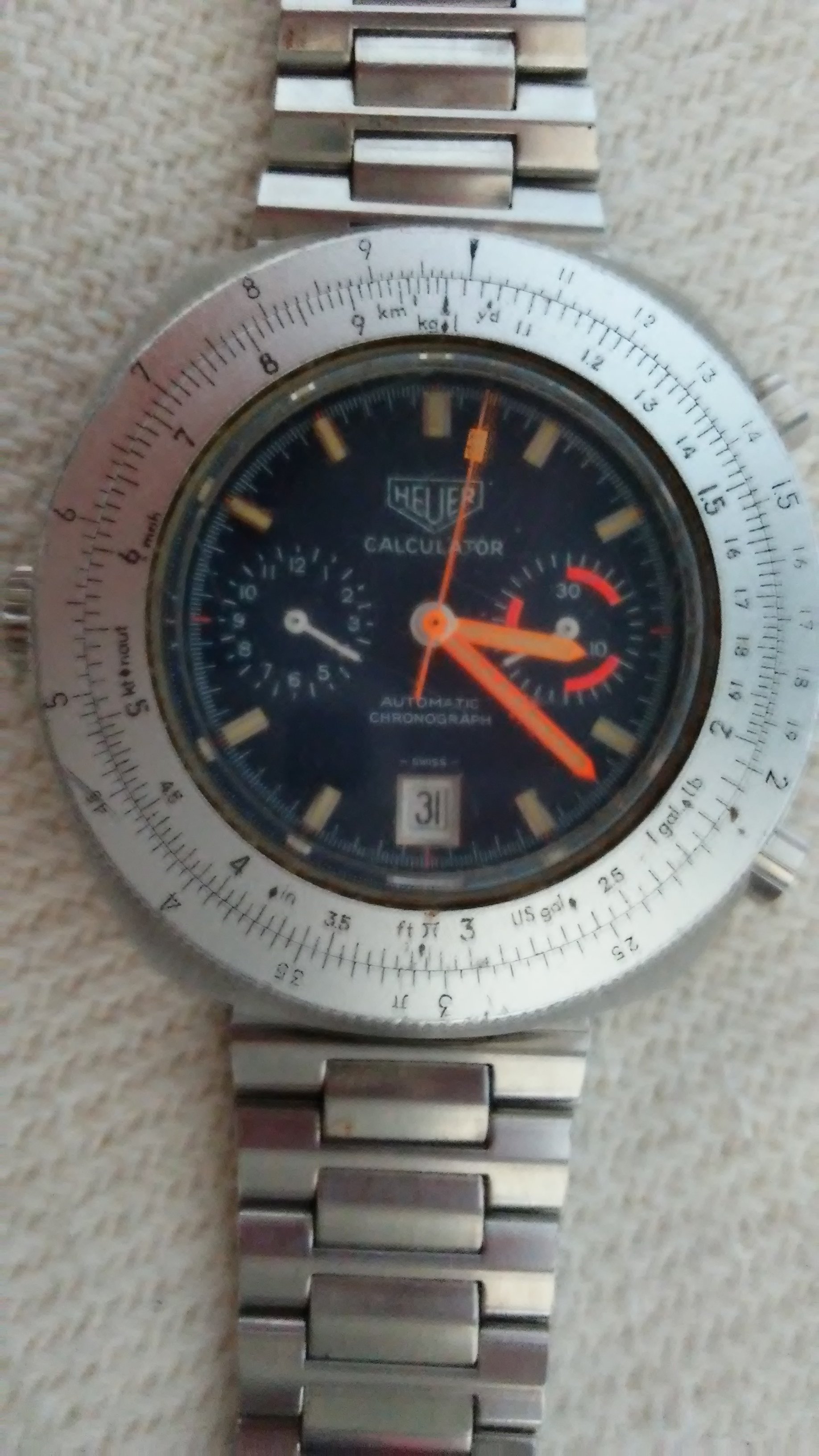

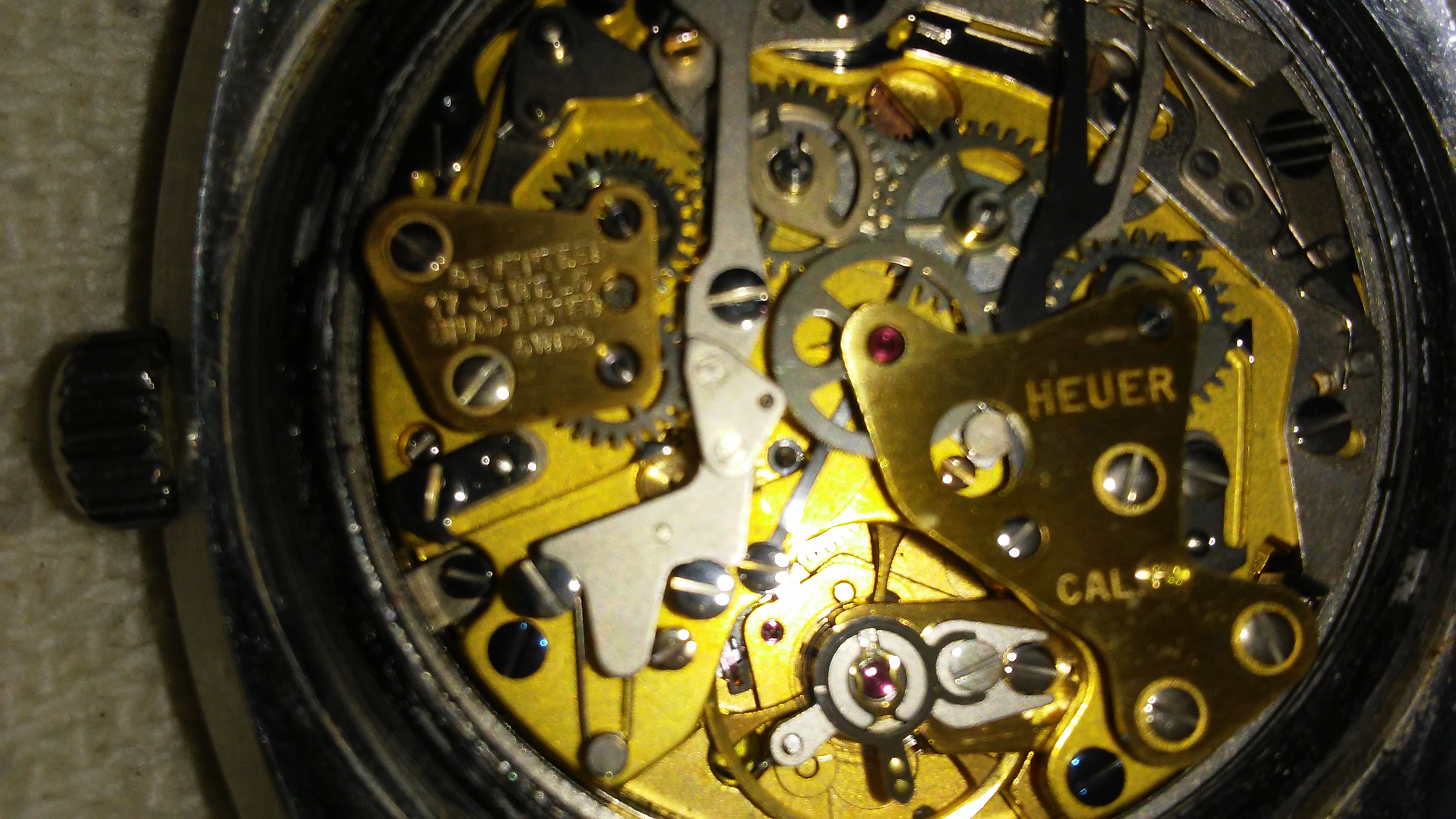

I recently came intona calculator that matches your photo it needs a restoration but hiw do i determine the build date? The piece works fine. Just would like to know what i have here. It almost ended up in a shredder at a recycling plant.
3
I put this on a different thread but got no feed back so let's try this.
I came into a calculator it almost went into a shredder at a recycling plant. One jeweler out of philly offered 400 for it after seeing the photos. I've seen just one button cost that much for this watch. It works great. It does need a new crystal (scratches) rotating bezzle is scratched and has wear but works. Im not a collector. I guess i want to know if i should move the peice as a whole or allow it to be parted out? Its being taken to get a written COA from a approved appraiser.

Very nice! That looks to be in very good condition.
No way of determining the date unfortunately, although based on this NSA bracelet I would expect that this is one of the earlier models, as it looks to share the bracelet with the Montreal (https://www.calibre11.com/heuer-montreal/), so early-mid 1970s
