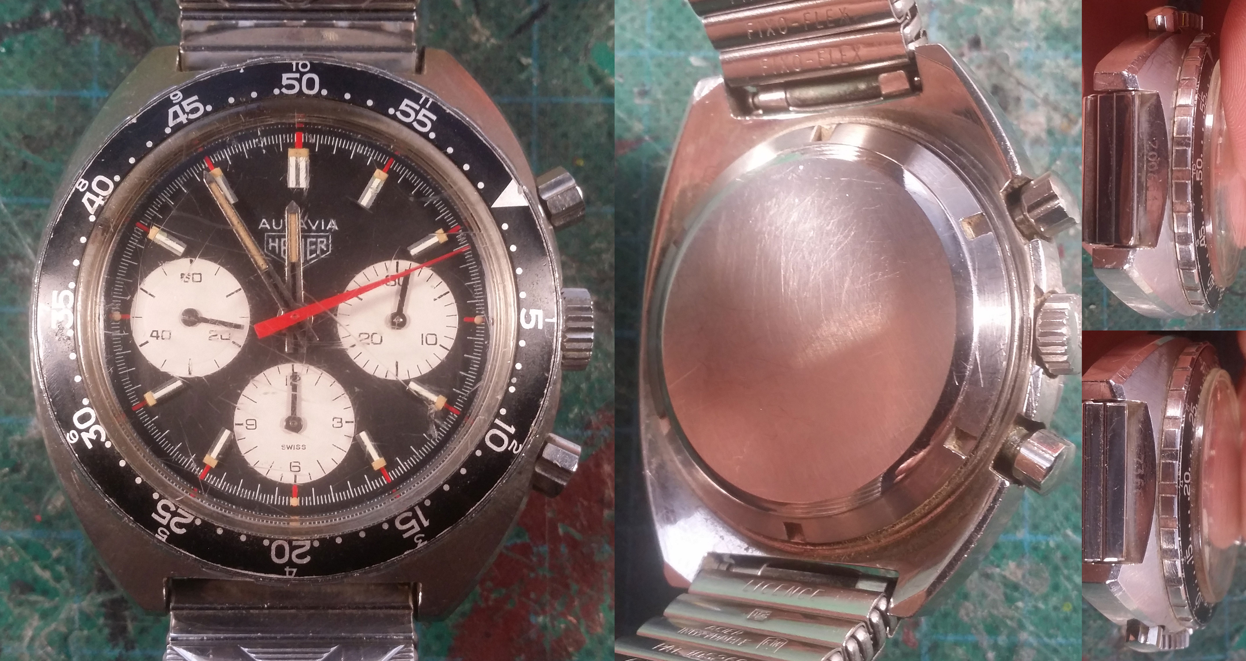

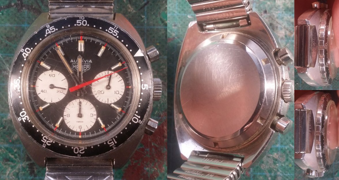

Last year I got chided for not wearing a nice enough watch at a trade show by a manager - good naturedly. I was wearing a simple Seiko Kinetic in steel. Anyway, that trade show is comming up again and I was wondering if I should make a change there. Then I went through my watches (I'm not a collector) and found the watch you see in the picture. I was given that used watch by my stepdad 20 years ago, but haven't worn it so far.
Based on the execllent article on this site, I found out that it is probably from the 70s and a model 73663.
I wound the watch carefully and it works and keeps time correctly. The stopwatch function also works fine.
However, the glass has many small scatches. It appears to be plastic, which I understand might be normal.
My expectation is that this is a genuine watch, which had it's band replaced and it's glass messed up. I'm wondering if I should replace the band and if possible the scratche acrylic with a sapphire glass.
What would you guys advise?

Very nice watch you've got there!! Change the bracelet, which isn't original, for a nice leather strap. The crystal can be polished if it's only scratches. If it's chipped, then best to replace with an acryclic crystal, not sapphire. I'd also suggest a service, even though it keeps good time. You want to try and keep the watch as original as possible - replacing lots of parts will only harm the value, so find a good watchmaker who knows what they're doing.

Everything imagwai said x2.
Beautiful, genuine aged patina on a truly desirable time

As to value, and whether your watch is all original, I would defer to others as I'm not familiar with this reference. All I know is that most cushion case Autavias are 2-register, not 3-register like yours, which makes yours more special. The only other watch I could easily find online with a quick search for price comparison is this one...
http://www.chrono24.com/heuer/mens-...inless-steel-73663-chronograph--id4696831.htm
I have no idea if that's over-priced or not, though. At the end of the day, it's worth what someone is willing to pay and originality and condition are everything when it comes to vintage watches. I get the impression yours is probably all original, the bezel is in better condition than most, and the watch will come up quite well after crystal refurbishment, clean and service.

Very nice watch Stephanius,
As the others have said, service the movement, polish the crystal, and replace the bracelet, but do nothing else!
Originally, your watch would have come with either a Heuer signed "beads of rice" bracelet, or a black Corfam strap.
Finding the correct bracelet for less than US$1500 is a difficult task these days.
Old Corfam staps aren't cheap either, however there's a solution. Heuertime sell an excellent new Corfam replica for a fraction of the price of a real one. Also, TAG Heuer sell a Heuer branded pin buckle that looks similar to what your watch would have originally had.
You will need a 20mm strap and a 16mm buckle.
