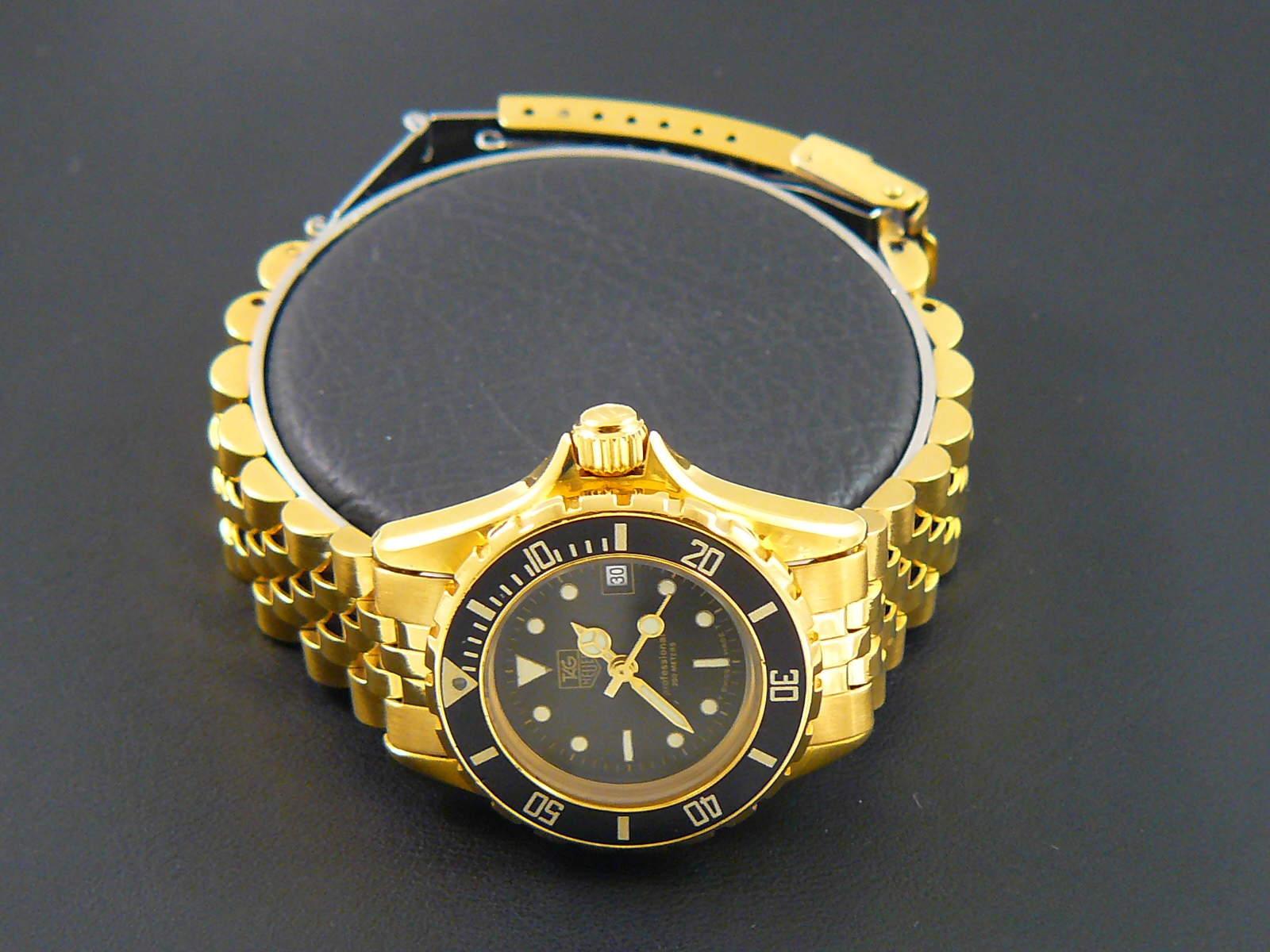

Can anyone help me with new movement for my 980.017 Ladies Wolf on Wallstreet model.
Dont know what replacement to use, tried change battery but still dont work.

Tom, its''s an Eta 956.114 but an ETA 956.112 will fit too and is a better replacement, keep in mind that you order one with the date at the 3, not 6.

I bought a 956.112, but my local watch maker tell me he cant put it in(it is not correct he say). Is he just a shi*ty watchmaker, or what can be wrong??

There is a possibility that an earlier movement is installed in your watch as you state it's a Heuer.
If that is the case and there is an ESA/ ETA 965 movement in it, you're stuck, movement is obsolete, might show up on eBay, but expect $$$ if available and of course, in running, serviced condition.

Its Heuer, do you know what kind of 965? All Numbers
ESA 965.111 is installed in the ones I have here, you can find the number on the place where the battery is installed, under the battery insulator.
