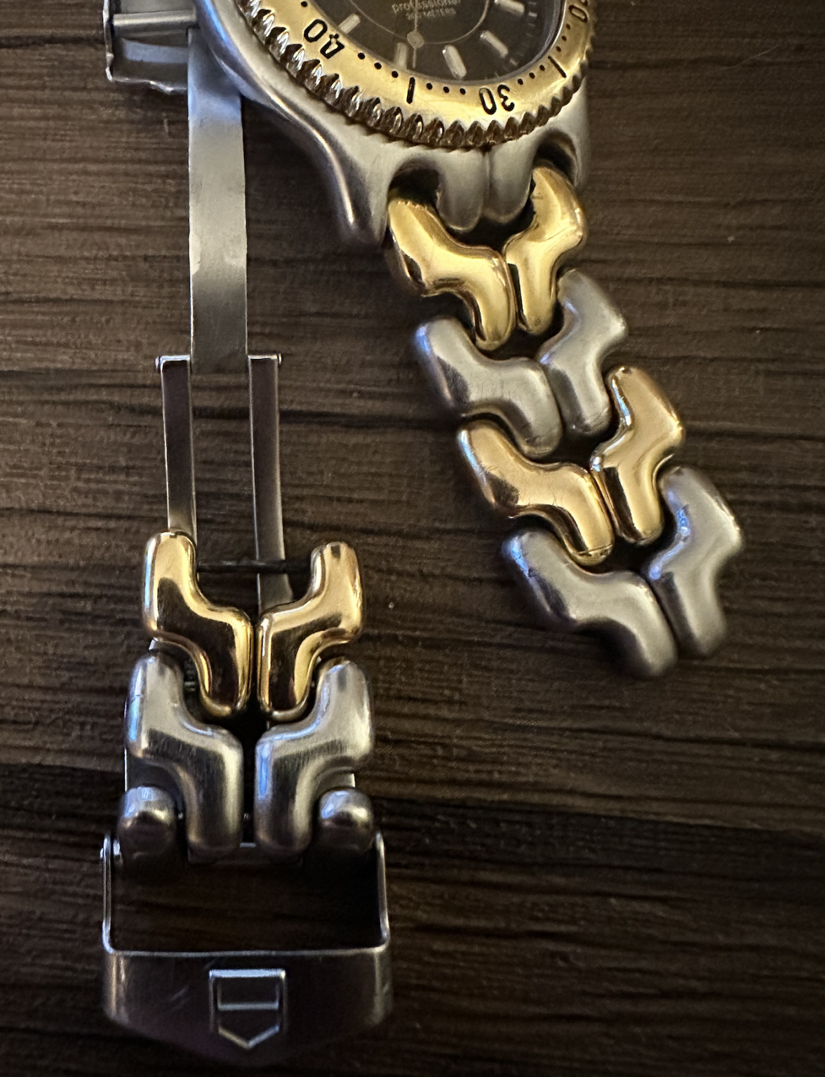

Its the two links closest to the clasp that are loose. The ones attached to the clasp are fine - as are all other links.
Here's a pic - its the links to the left - they are firmly sttached to the claps, but easily disassemble from there (left side "lug" has a bar attached to it, right side lugs just fall off. The two gold lugs in the pic, on the left):

Nice watch and history. If you have enough and the correctly colored spare links plus access to the link tool, then you should be good to go. The toughest part is removing the clasp from the two end links as it is attached with tiny (easily breakable) screws. After that you just install good links to achieve desired length, then the end links with clasp.
Either the posts or the other half of your failing links is bad. I don’t think there are replacement posts, so either half or the whole link needs to be swapped out.
With the link tool, you can easily install the new links plus give all other links a squeeze to ensure closure.
This entire operation should take an experienced jeweler (with the correct tools) a few minutes. Good luck.

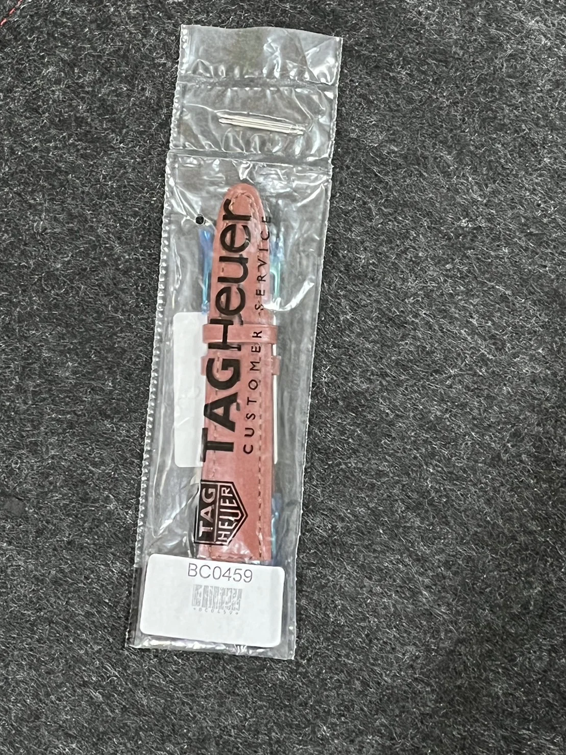

Anyone know where to find the leather straps for the S/EL ?
Check with your AD or TH Boutique. They still seem to be orderable from TAG Heuer depending on one's location. Likely cheaper than buying from eBay too.
The black leather and silver buckle/end-links is part number BC0429.
The brown leather and gold buckle/end-links is part number BC0459.
