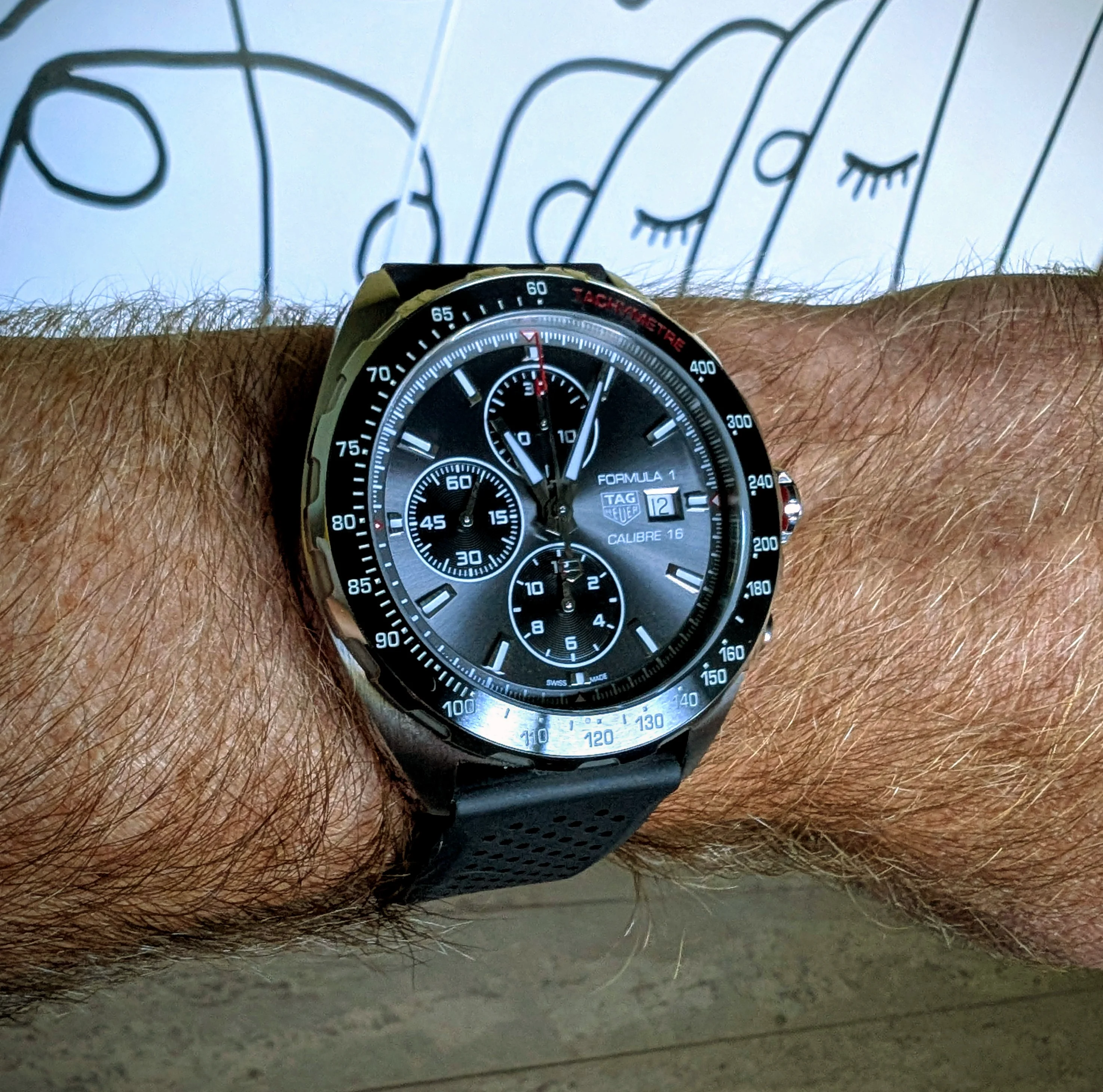

Evening everyone,
I've had my F1 Cal 16 for about 5 months (bought new) and I'm finding that it stops about 24/36 hours after taking it off. It is worn for days at times but still doesn't last long when taken off.
The chronograph isn't in use and it is wound the recommended 40 winds to start it again.
Is this normal? My £180 Seiko will last nearly a week without being wound.
It's pretty disappointing for such an expensive watch if it's normal.
Thanks

Welcome to the forum, @jd. We like pictures here, too, so let's see a picture of that Formula 1 Cal 16!
As @Aquagraph stated above, the H02 produced the big jump in power reserve. I've had some Cal 16s in the past, and it seemed like they would run for about 36+ hours before needing a wind or time on the wrist to keep going. Enjoy the watch!

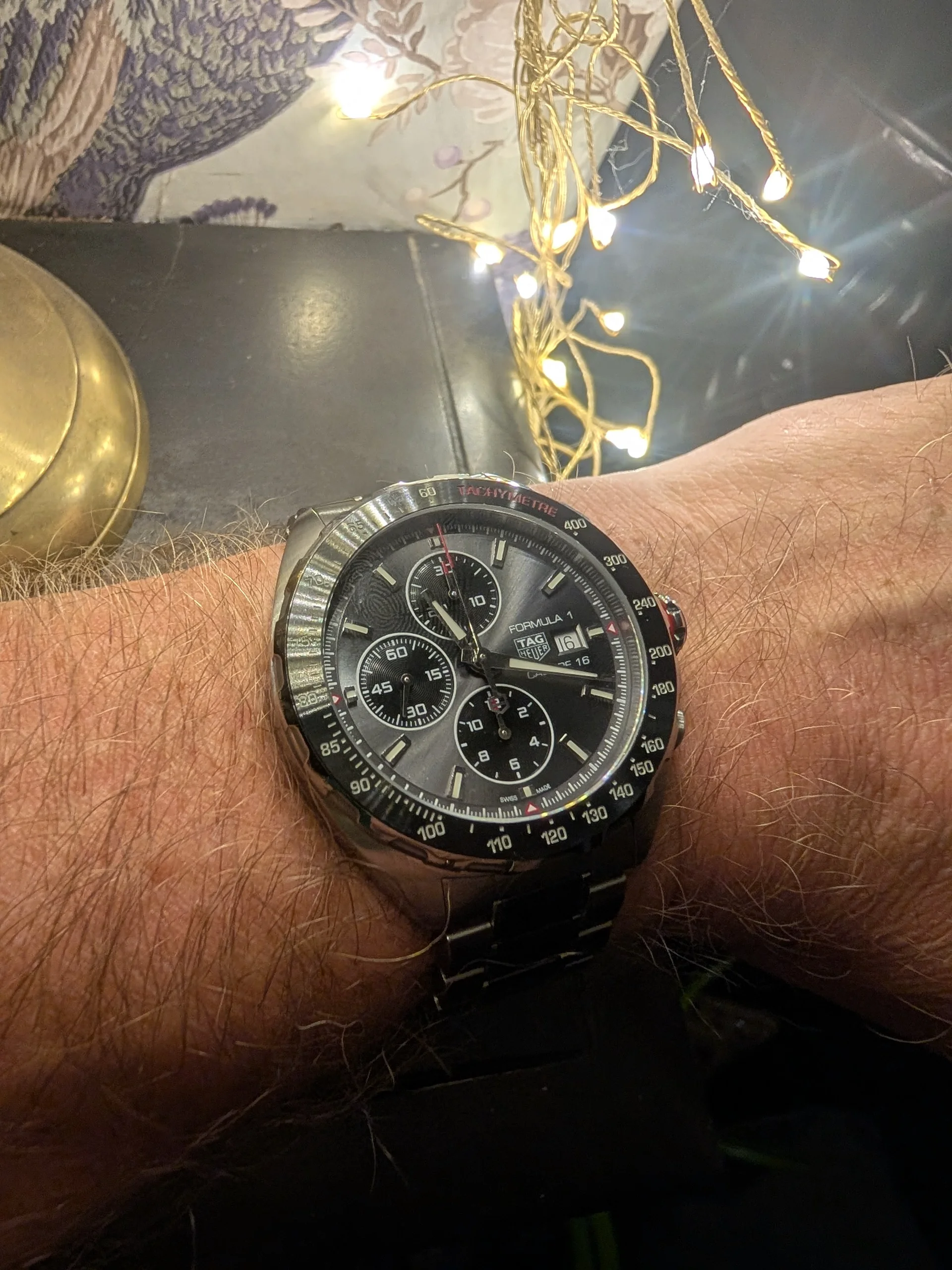

I recently purchased this but wear it most of the time so haven't noticed the power reserve. It's definitely supposed to be 42 hours for the Calibre 16. Even the new Formula 1 Chronographs are Calibre 16 with the same power reserve and they cost more.
