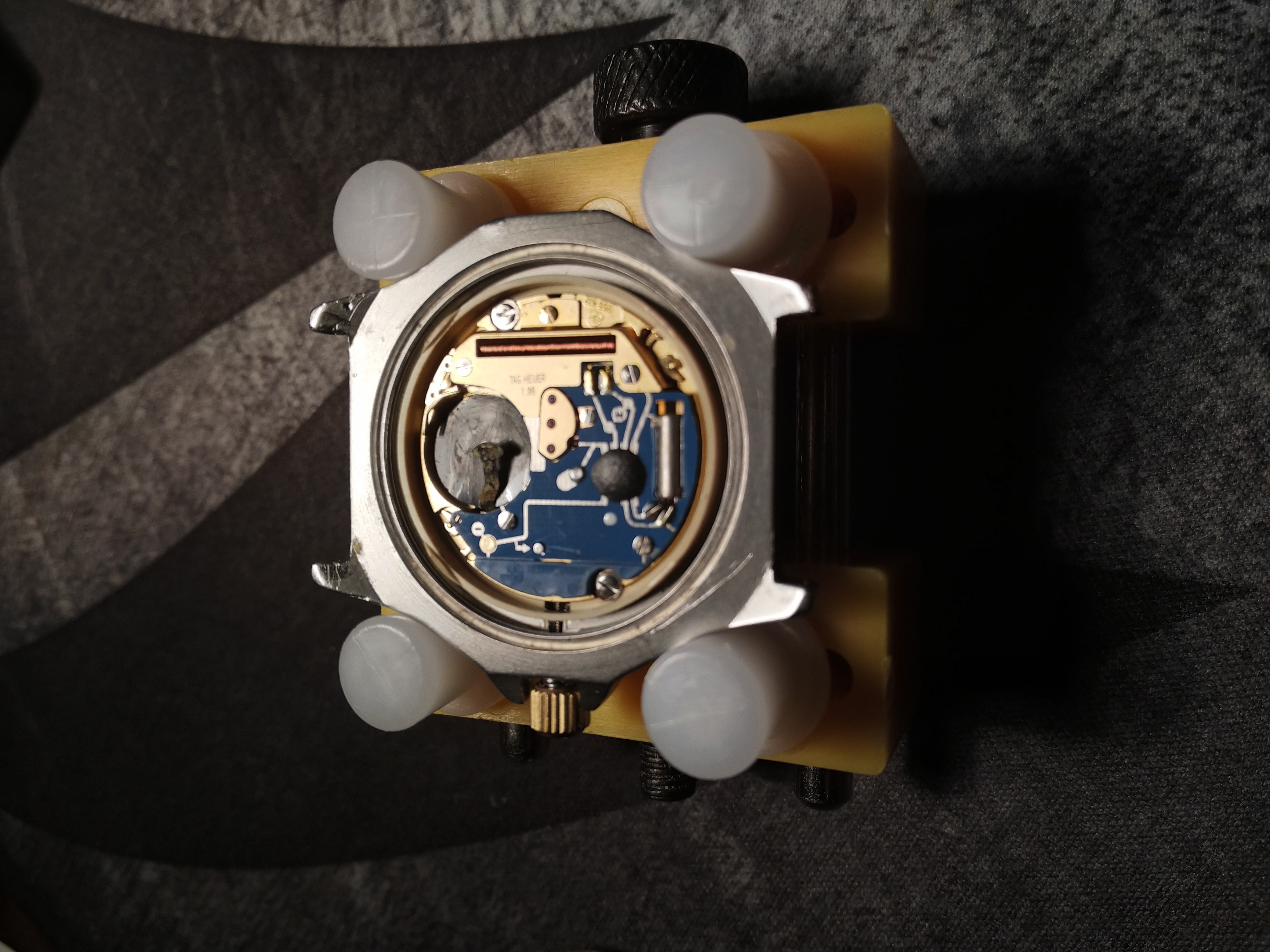

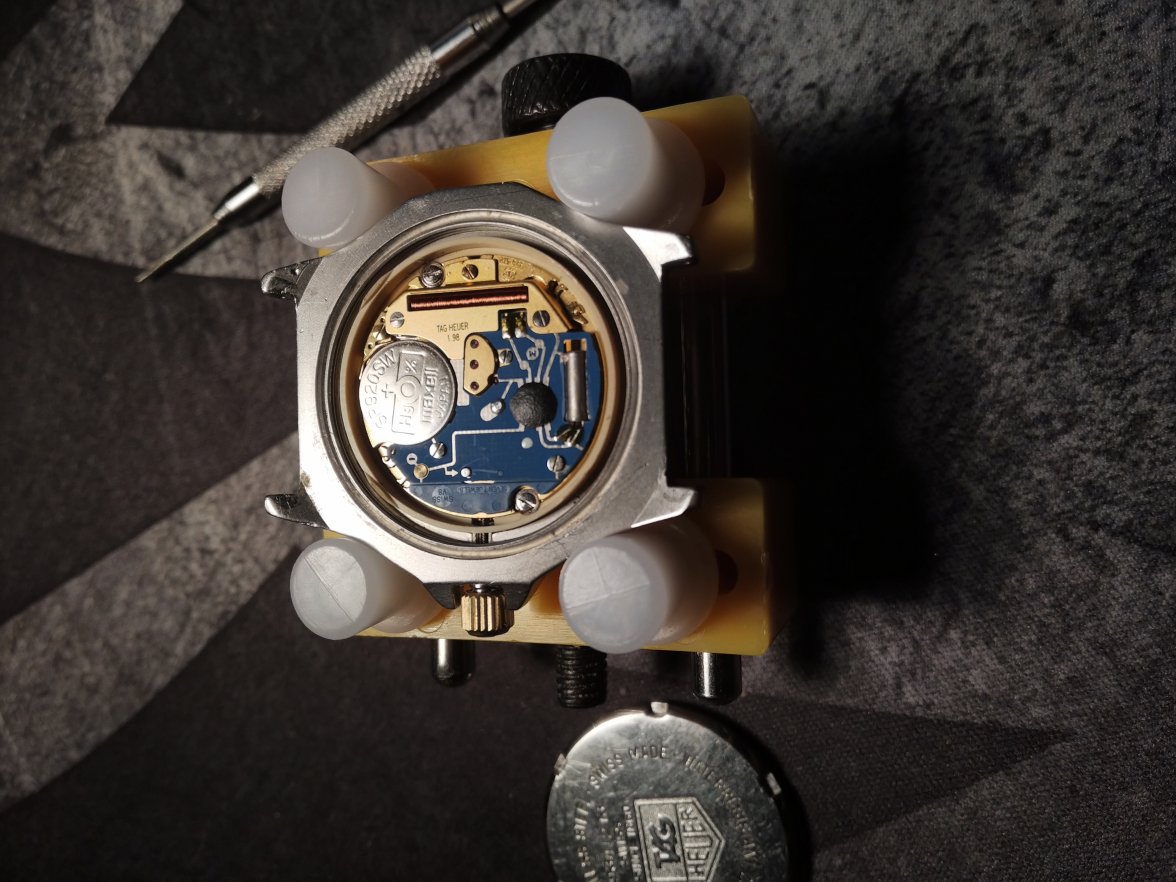

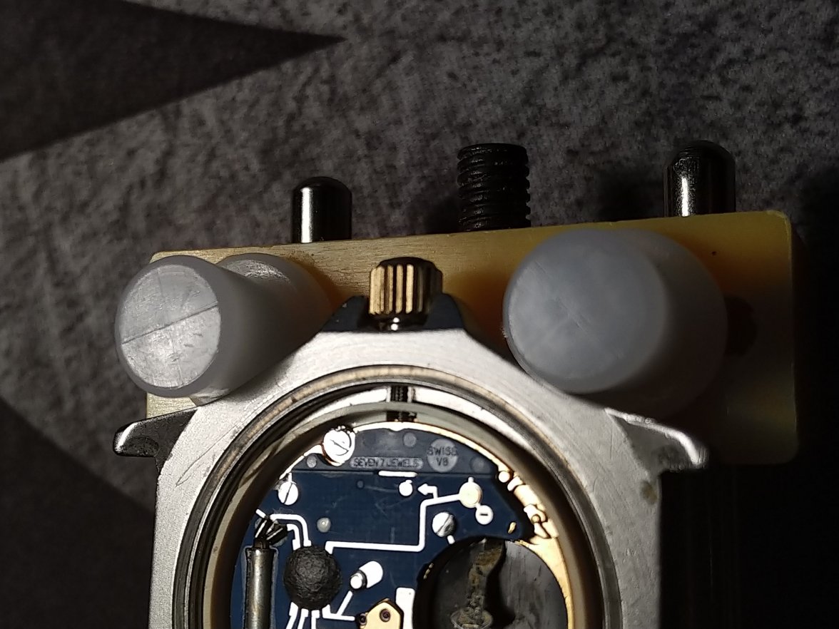

Clearing the air before I get into this; I DID NOT BUY THIS WATCH FROM THIS SITE! I finally received the 3000 Professional that was excitedly asked questions regarding band sizes. It was sold to under the assumption that all it needed was a battery replacement and the band needed some pins. I got watch removed the back case, and a screw fell out, I reinstalled it. Replaced the battery, watch did not tick. Aside from those two things the crown dial was stiff, and did not "pull out" to adjust date/time. After turning it for a few seconds it appeared as if the adjuster was backing backing out of the casing of the watch. Now there is a gap between the dial and the case. The minute hand sort of loosely spins in the dial too. Also the watch was pretty dirty... What can I do? I paid less than $200 for watch, is it even worth paying to have it fixed?

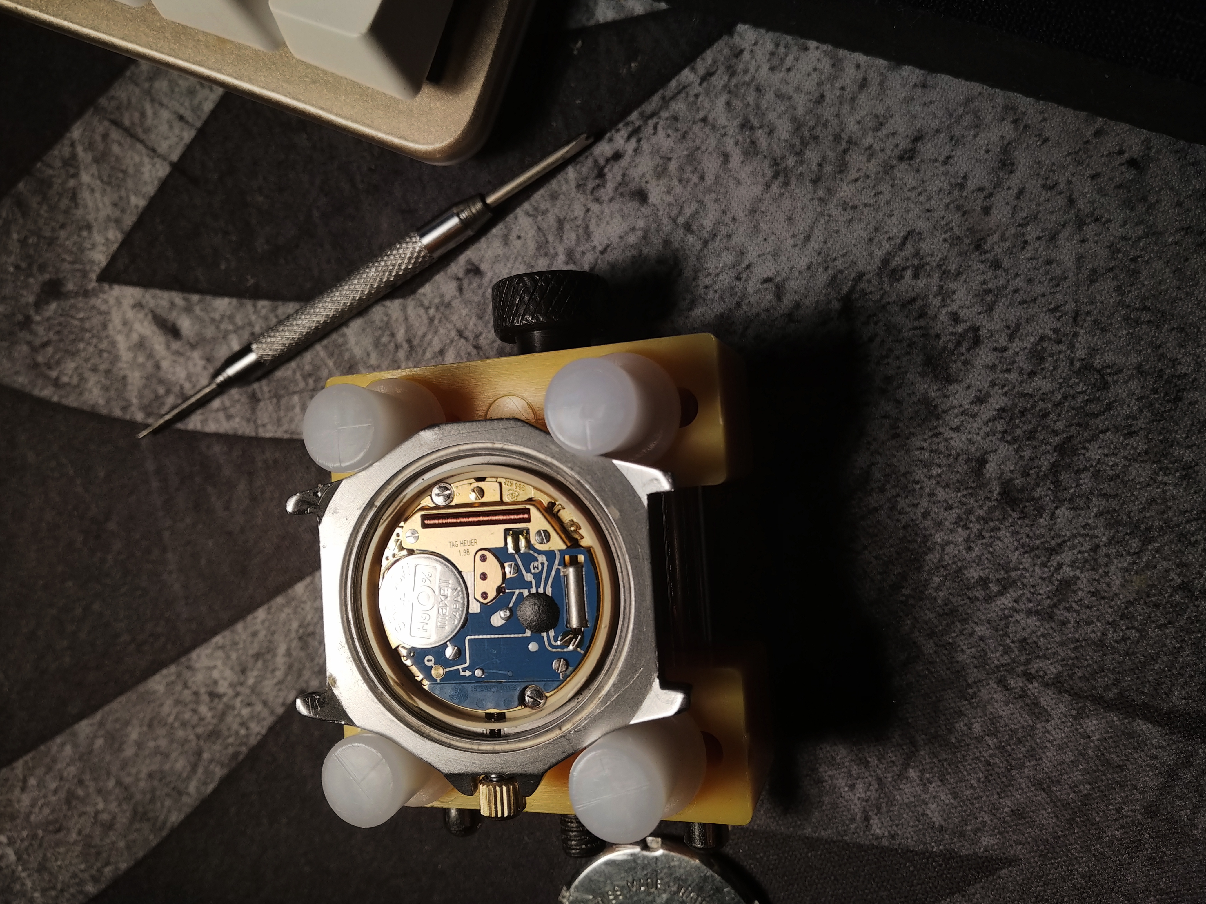

UPDATE: I've continued to mess with the watch because I can't leave anything broken. I tightened down the back of the case further and it started ticking, or at least the second hand was. The minute hand still still just hands loosely and rattles around in the case. So I guess I've got one less thing to try and workout now...
