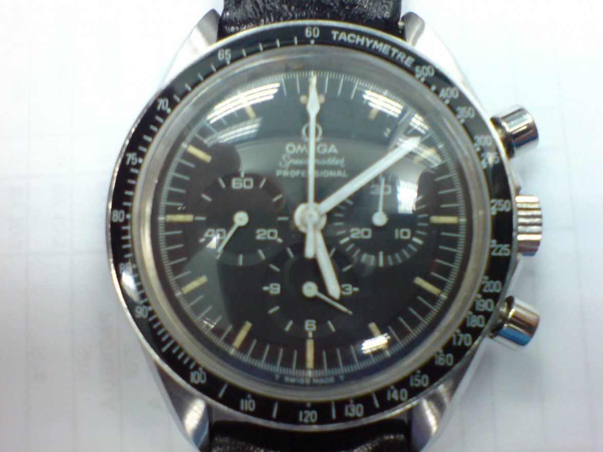

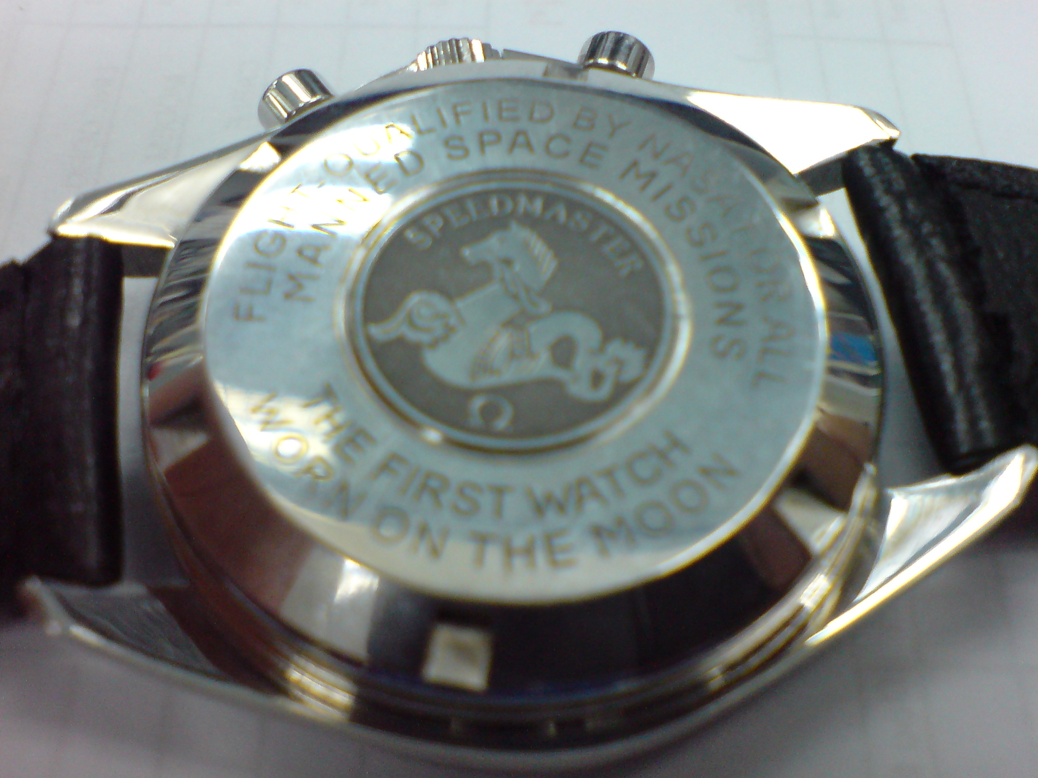

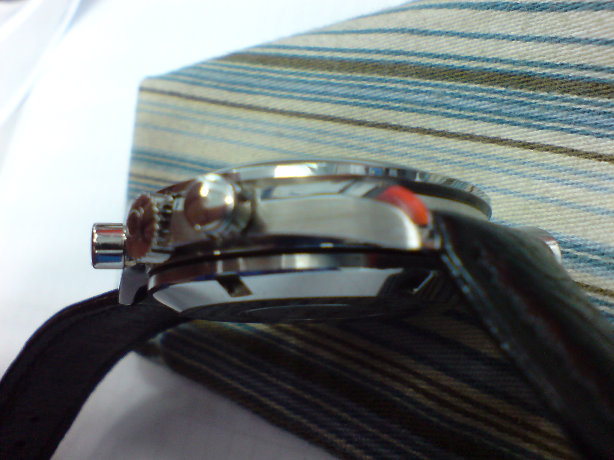

I had this offered to me about 10 years ago, it was supposedly a 145.022-76, but look how thick the case back is. The movement was also a mess, serial number looked like it was from a tissot, and put together. Sorry for the pics, i took these in a hurry at a flea market when the seller was distracted, with one of the early camera phones.

I had this offered to me about 10 years ago, it was supposedly a 145.066-76, but look how thick the case back is. The movement was also a mess, serial number looked like it was from a tissot, and put together. Sorry for the pics, i took these in a hurry at a flea market when the seller was distracted, with one of the early camera phones.
What camera phone did you use 10 years ago?

Would anyone here have bought this?
It's great to see detailed photos up close, but I think the target of these is not the gang of us here. There's gonna be some sad newbs and unsuspecting nostalgia hunters out there. It pays to know what you're getting.
The picture says:
Camera
Sony Ericsson K800i
Date of Creation
2007:10:01 17:10:19
Those were nice phones.

Thanks for that! I was trying to remember what phone i had back then & couldn't... 😀
That caseback, just wow 😀
