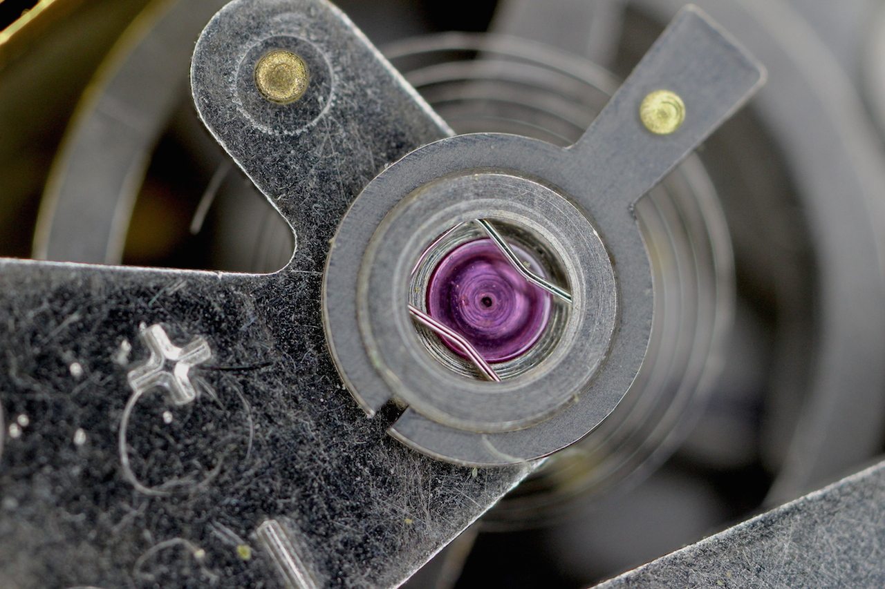

I'm servicing a little Mortima diver driven by a Cattin C66. Not a Patek, but a nice little beater with a "Kalashnikov" movement.
Everything was going fine, it had been stripped, cleaned and ready to re-assemble.
I'd just oiled the plate balance jewel and replaced the cap and went to pick up the shock spring.
My brass tweezers were just a stretch too far to reach from where I was using my microscope, so like an idiot, I picked up the nearest set of tweezers (SS ones!).
I looked down and picked up the tiny cap spring, and just as I was about to move it to the movement I felt that sensation we all dread. startle.gif
The "snick" feeling as the tweezer tips pinged the spring into the ether.

So, the point of this post. I need a new shock spring or a donor movement and I'm hoping somebody may have one in their parts box.

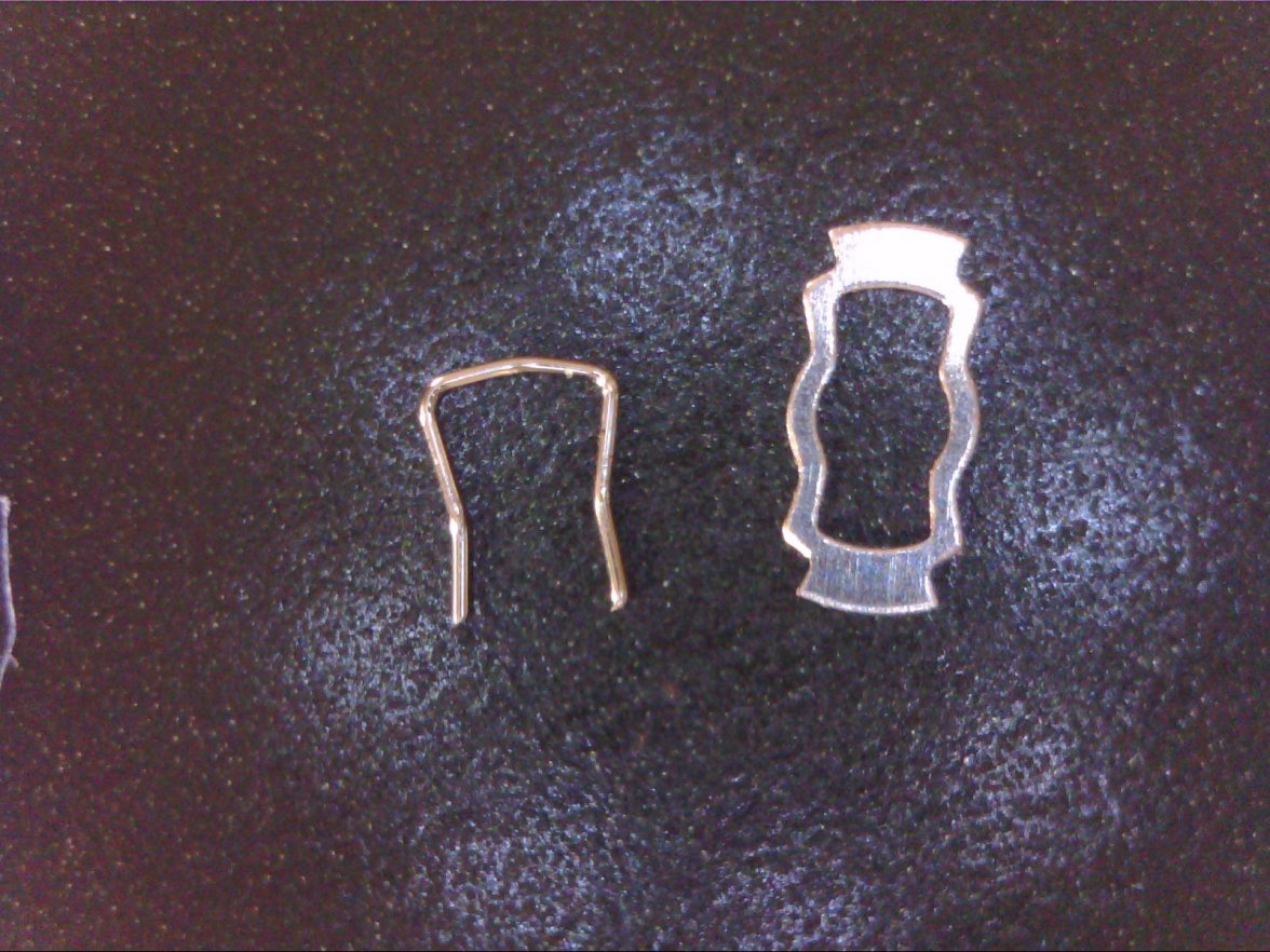

I've included a pic below of the balance jewel spring from the other side, shown next to a Seiko spring for size comparison. As you can see it's a tiny little bugger and not your usual item that could be replaced by a common BestFit spare.

Good luck with that one - the quickest way would be to buy a spare movement likely. The chances of finding this part as a spare is going to be pretty slim...
2,219
4,946
Bad luck there Jim. Surprisingly, Cousins list a whole host of parts for this movement but no shock spring. There's also a service manual/parts list for download but it just lists the Cattin number (380 as I remember).
Do you know the name of that system? Am not sure it would help but...

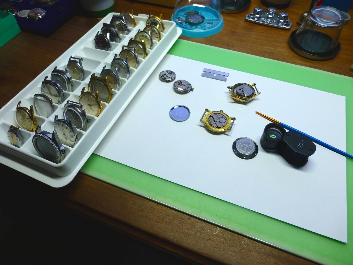

After looking through my junkyard I came across a Cattin C66 in an old thing I got in a box buy.
I know it's only an old pin lever but just getting it working again gives me a sense of job satisfaction.
It sure pays to keep all of those old clunkers and basket cases 😁

Box-O-Watches saves the day.
I'm glad you found something to help because I was dreading going through my boxes.
I hate that tweezer "DOINK".
My last resort before scouring the scrapyard is a KILLER magnet from a commercial hard drive. This bad boy can pull parts from the floor 2 feet in the air. Downside is sheer strength of the field and it has to be put in a special place. 😉
29,112
75,239
Yes those "bag-o-watches" you buy for $5 can certainly come in handy. I use them often for sourcing parts, in particular screws for watches that always come in missing one or two for whatever reason...
