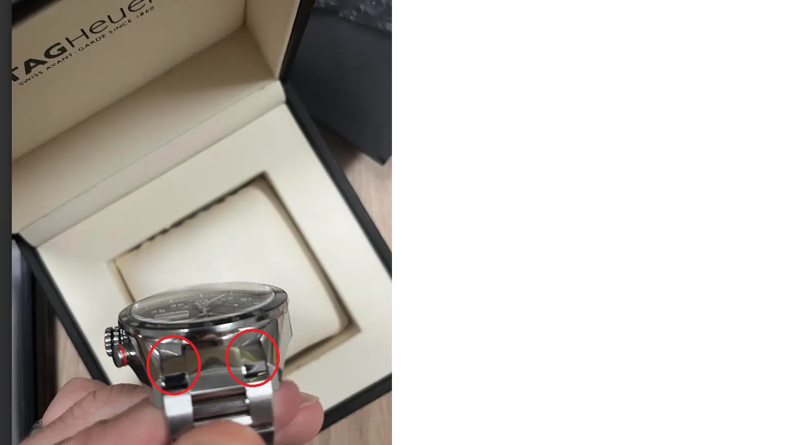

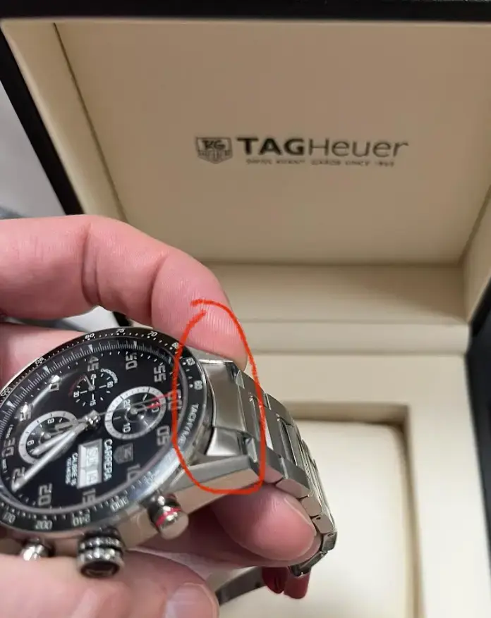

One other question. I got this watch 2nd hand and it's been verified independently as being genuine. It originally came with the black leather strap which I want to put back on it, but it also came with a new Tag steel bracelet which you can see in the photo, but what annoys me is the area highlighted which isn't flush like I see in other photos of this watch. The rest of the Tag steel bracelet looks fine, it's just where it joins the watch. Is it the wrong bracelet for this watch?

The endpieces do look a very poor fit to the case,the rest of the bracelet looks correct though. Could be the endpieces were lost and someone has just put something on to the original bracelet that sort of fits !

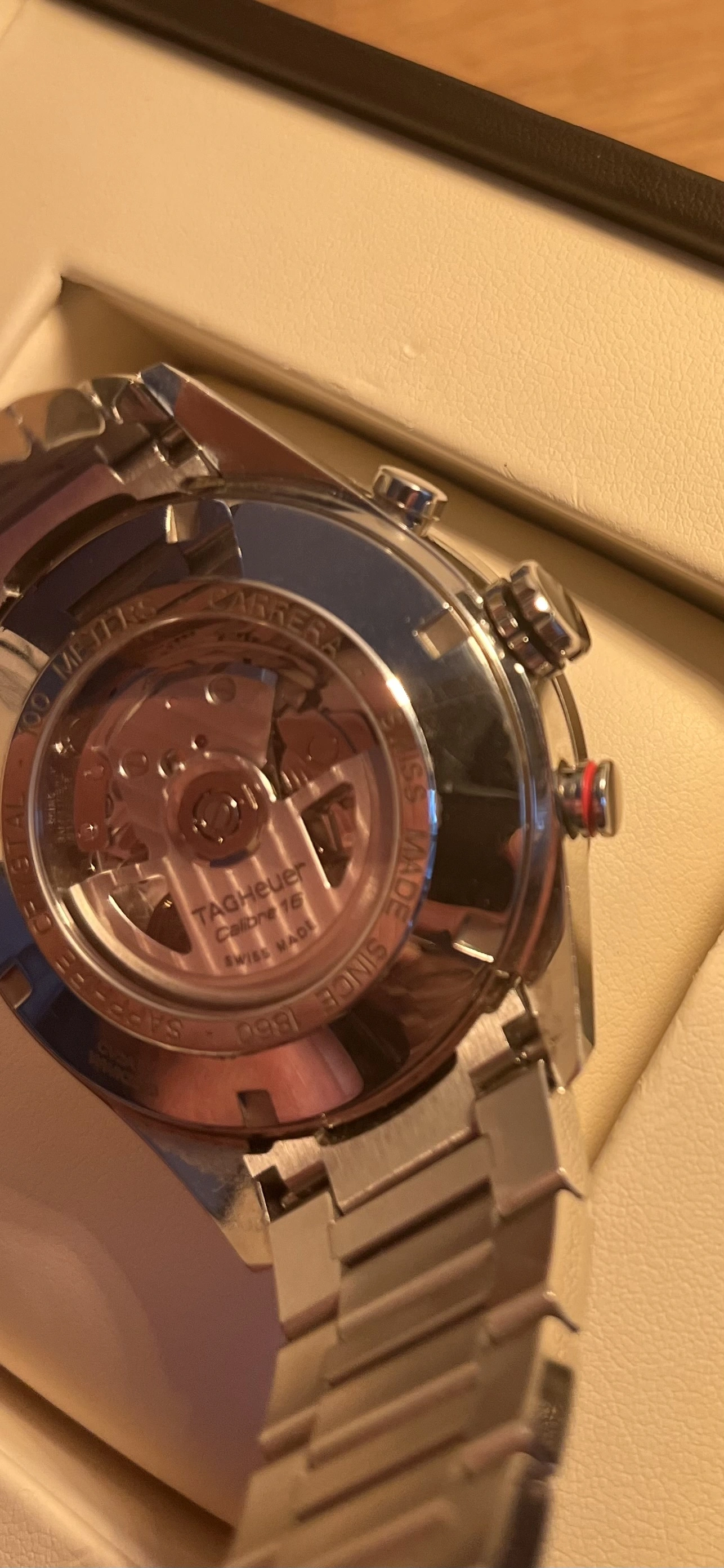

Would photo from underneath help with regards to the fitting?

Pop up a photo of the underside.Those endpieces look hollow rather than solid in your photo.

They are solid endpieces but I don't think they are correct, too short and too shallow.
Either the wrong bracelet or someone has swapped the endpieces.
