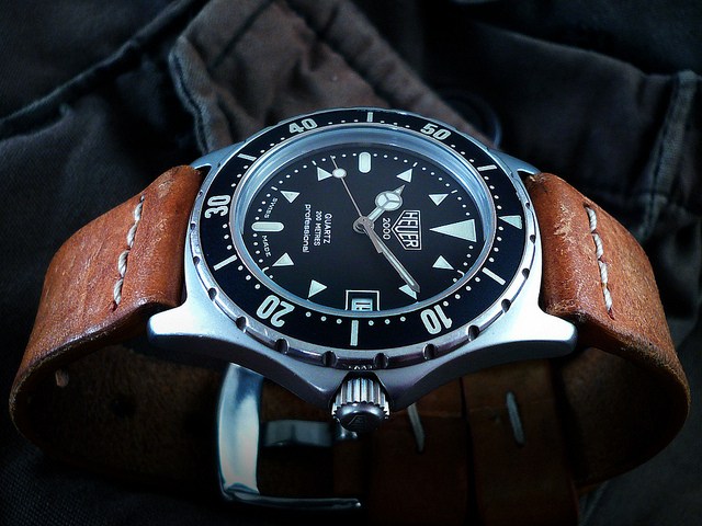

Hello, Bought my Heuer 2000 (973.006) in Sydney in 1985, and it’s been the most brilliant watch.
Around 15 years ago, during service, the crown was replaced with a TAG Heuer version.
Didn’t think too much about it at the time, but is annoying me now.
Have spotted NOS Heuer crowns on eBay, but want make sure I buy the right type (Tag Heuer can’t supply one).
Can anyone help on the spec, diameter, push-in (or not), etc. As well as the best place to buy.
Many thanks.

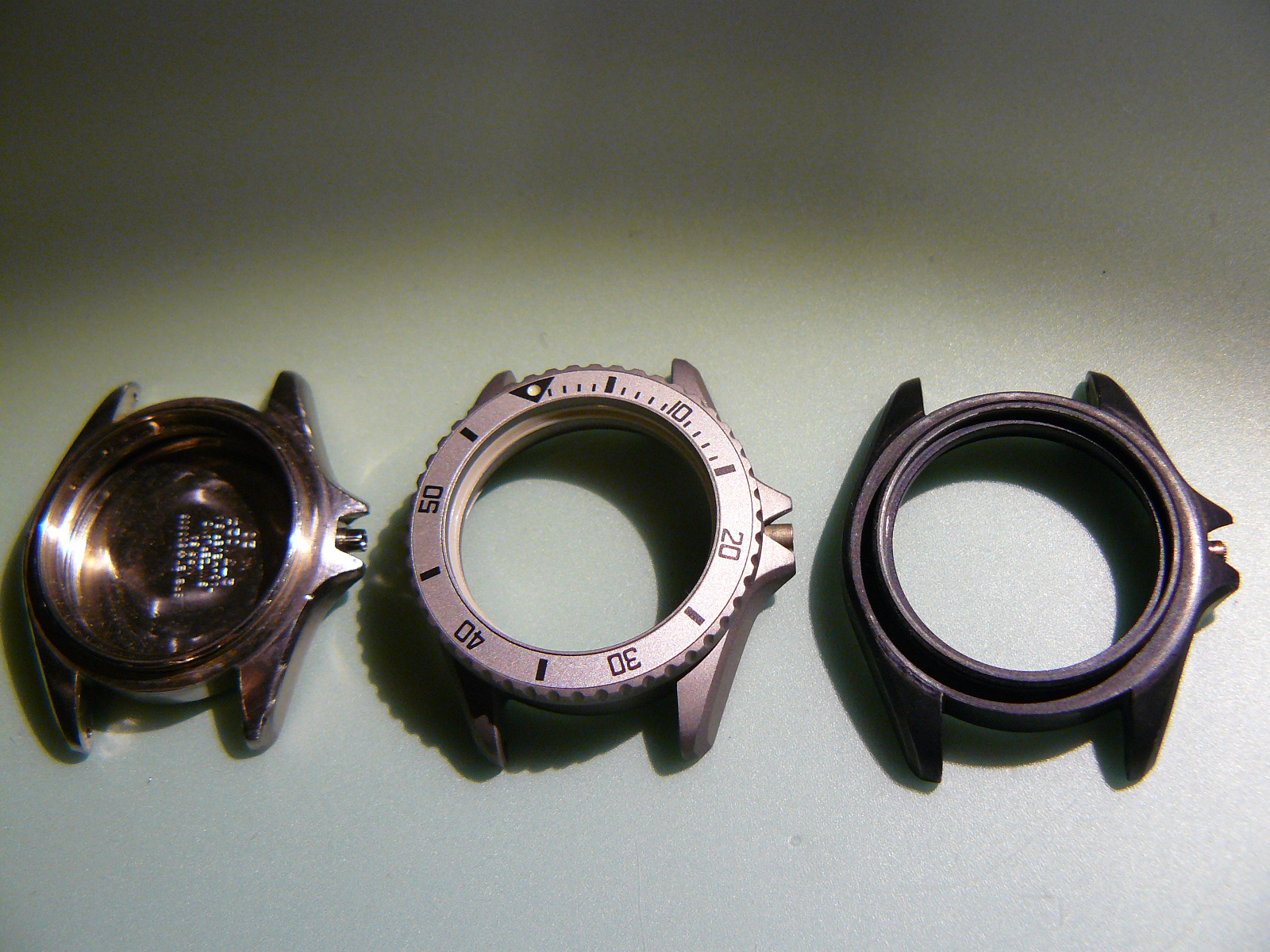

Here is a picture I just made of the 3 different sorts of crown tubes, on the left, the TAG Heuer screw-in crown-tube, in the middle the Heuer screw-in crown tube with the wide diametre (has the crown with no logo on it), and on the right side the Heuer Banjo crown tube, with the teeth on the end.
