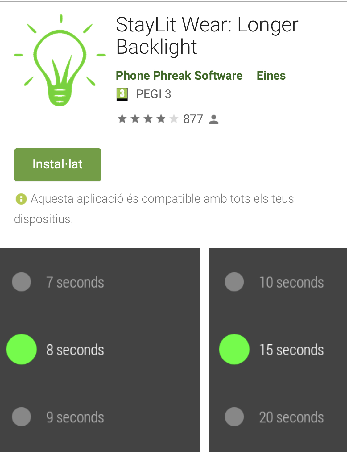

I need a second hand that displays for a minimum of 1 minute for my work but every watch face I seem to find the second hand lasts for 10seconds maximum, then the face goes to sleep. The sleep face does not have a second hand (I have tried changing this with no success). Any advice or guidance please?
Hi, welcome, and congratulations for your new TH Connected Modular 45! 👍
If you are using WatchMaker faces, just go to the settings of the WatchMaker app on the watch, then go to “Keep Watch Awake”, and then select 60 seconds or 120 seconds options
If you are not using WatchMaker app, and you wear just the TH factory installed faces, then you can install the StayLit Wear app on your watch, and then you will be able to adjust the time on bright mode of the faces up to 5 minutes
