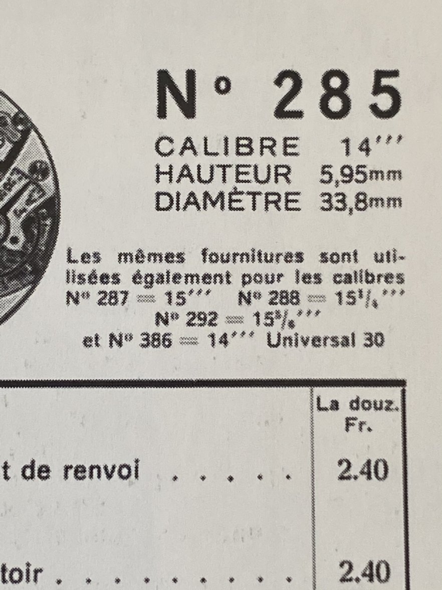

A few other musings on this subject...........
1) in looking through Sala i noticed the height of cal 386 is slightly higher than 285, not sure why?
2) on the parts pages for cal 285 if you look at the small print in the upper right corner there is a note that says 386=14''' Universal 30
not sure what this means, we already know the size (14''') is the same as 285, but not sure what Universal 30 suggests. Also slightly odd is that on the corresponding pages for cal 281, it does not have this note for cal 381, even though cal 381 is used in a (much smaller) number of Compur 30 examples.
Lastly, is it worth throwing Compax 30 into the mix and considering them together with Compur 30, or are they a different beast? Do we know which calibers are used in Compax 30 ??

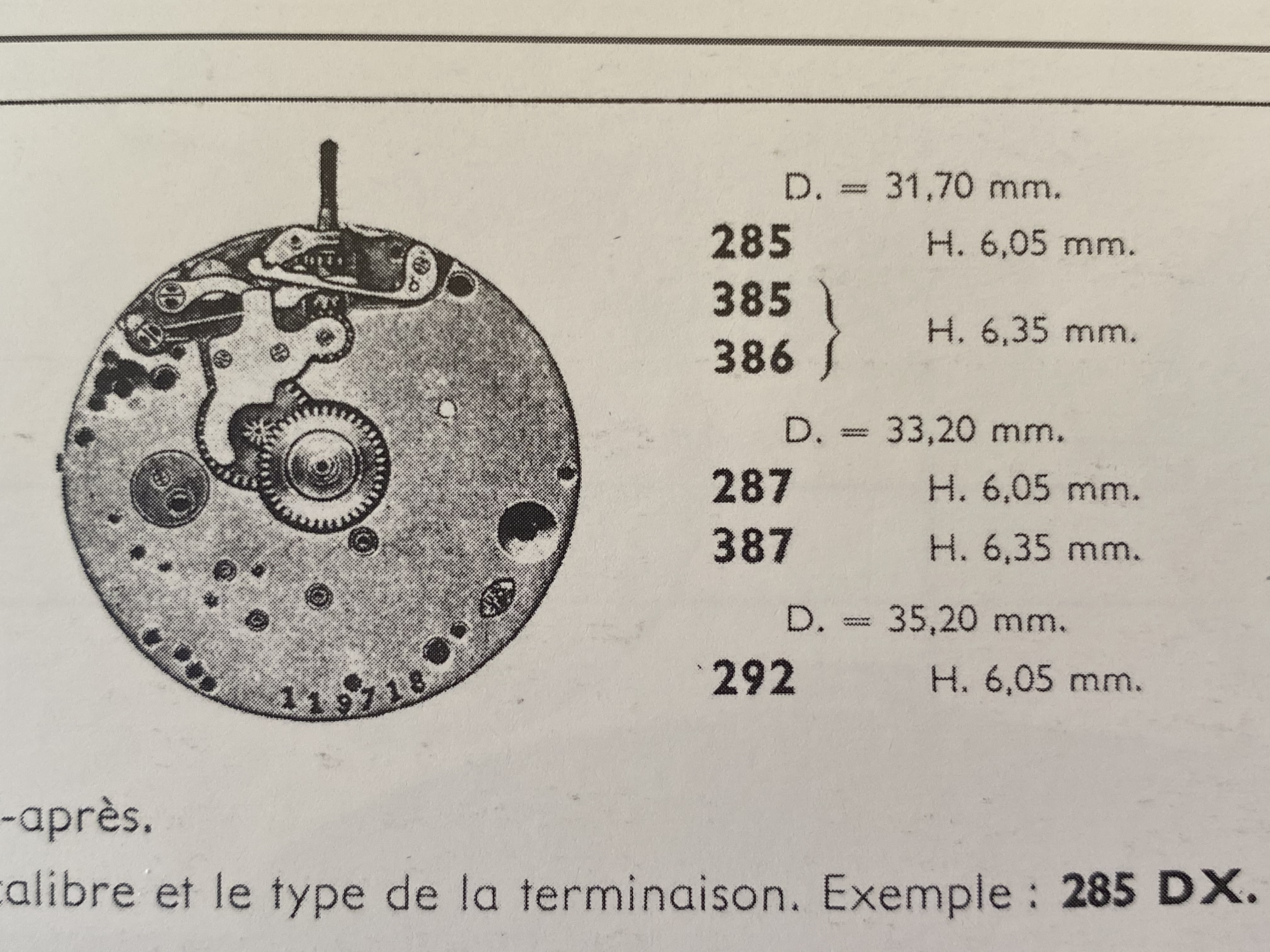

Or - and I won't be surprised if the explanation would be so simple - to the thickness difference between 285 and 385/6 movements!
6,35mm (386) - 6,05mm (285) = 0,30mm --> 30!
maybe a way to differenciate immediately watches powered with 385/6 movements (probably considered less valuable cause a bit thicker at that time?)

@vujen You may be right! I performed a quick search: all the compax/compur 30 I can found on the Internet have 38x calibers 😀
@bgrisso flat hairspring on 38x vs Breguet hairspring on 28x. I guess it affected a bit the height. Do not ask me why, as I have no idea 😁

Interesting ideas. The .3mm height difference falls apart with the cal 381, which is the same exactly height as the cal 281 (5.5mm). However the 381 is much more rarely used than the 386 in Compur 30 as far as I can tell.
From my limited research it appears the 386 is consistently used in Compax 30 ? Does anyone know if the cal 381 is ever used in any examples of Compax 30 ?
It seems an incredibly obscure thing (.3mm height difference in the movement due to the hairspring) to market to consumers by printing on the dial ? It would be like taking some other arbitrary technical fact about the difference between the cal 285 and cal 386 (maybe the 386 has 3 extra parts in the movement or whatever) and branding all those dials as Compur 3. Why would anyone care?
On the other hand, I don't have any better ideas. It seems clear that it must have something to do with the cal 38X series movements.

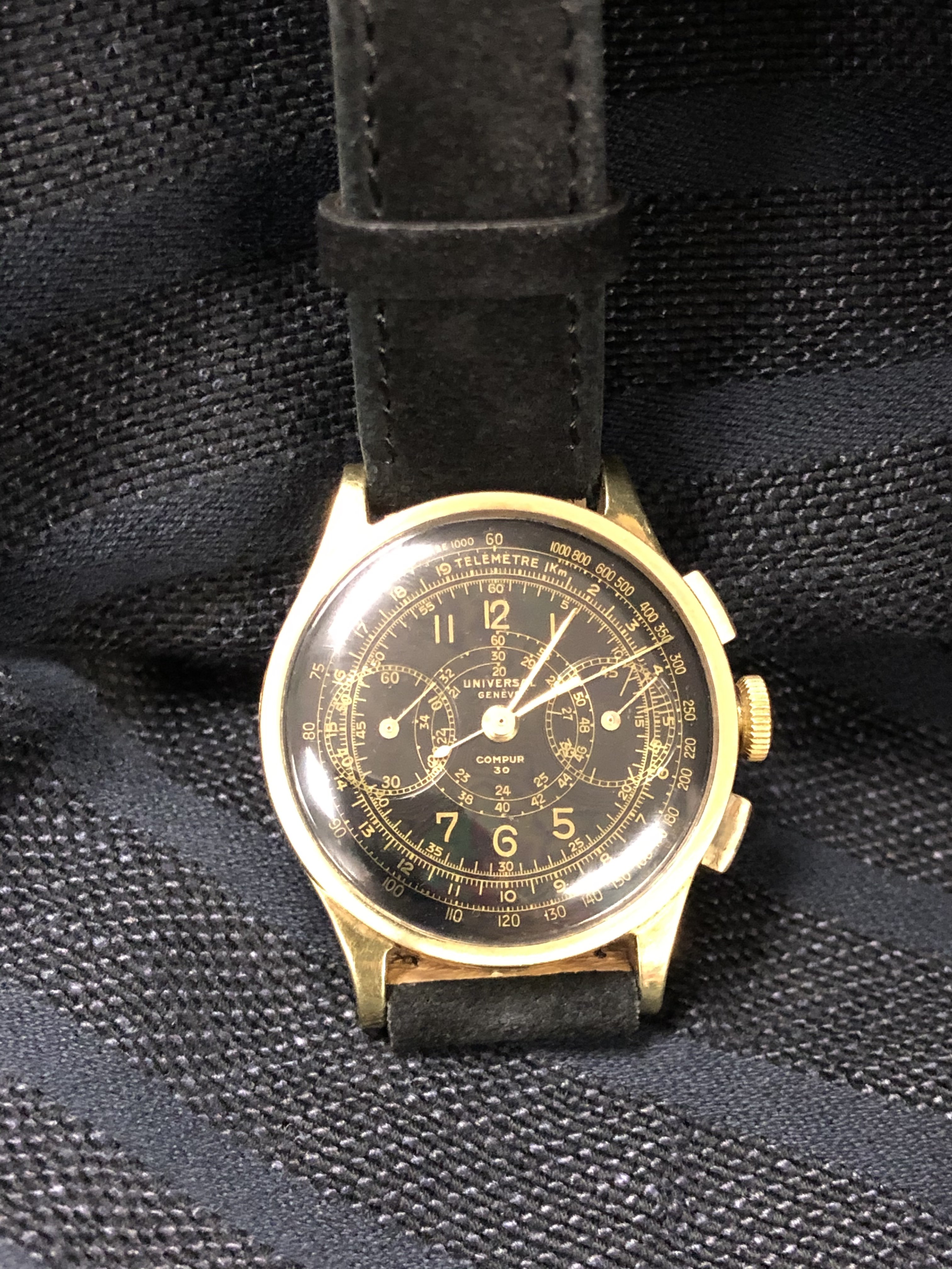

Fascinating stuff as always and some pretty cool ideas so far.
I have only owned the one Compur 30 pictured at the top of this page and it did indeed contain a cal 386 inside. The yellow gold case on that piece was noticeably thin with spindly wire lugs and felt feather-light in hand. With this sample group of all of one watch, I also wondered whether Compur 30 potentially denoted a short-lived budget diffusion line for UG at the time, in step with the austere war years and immediately beyond. A more affordable line of watches (containing a thicker and perhaps less desirable cal 386 inside, with less refined finishing, in cheaper cases made of chrome and thinner gold) would surely have found many buyers in the cash-strapped 1940s.
However, there are obvious problems with this theory too. The main one is that we have all seen spectacular specimens of Compur 30s (for example gilt black dials in gorgeous cases, to take just one example) that would seem to rule out ‘30’ designating an inferior product from a materials or design perspective. Secondly, if the Compur 30s were much cheaper to buy back then we would expect to see way more of them now, not less, than we do of the original ‘Compur’s (which just isn’t the case).

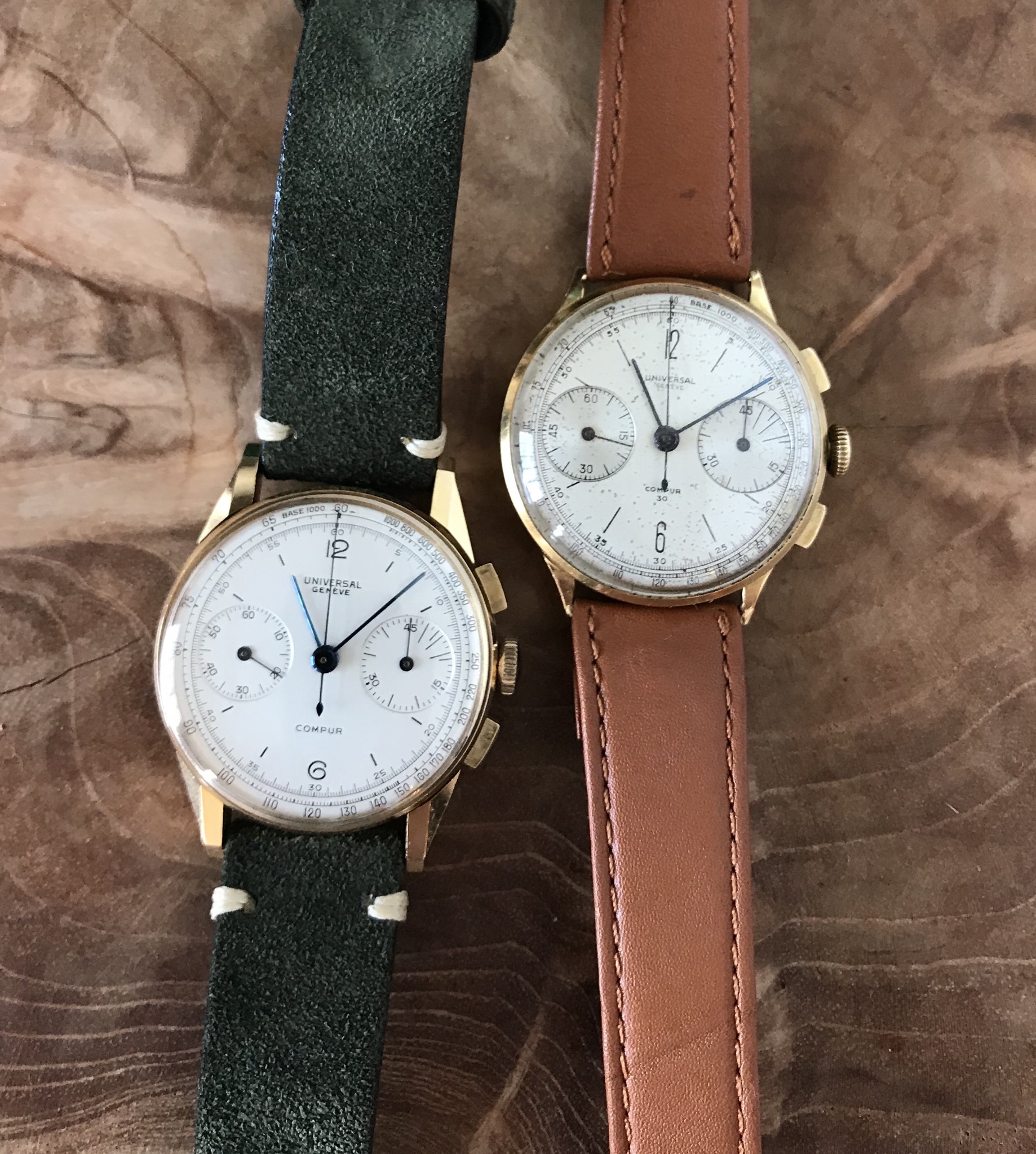

The two Compur 30s that I had were 1) a gold jeanneret (non faceted) case with fab suisse dial and inner dust cover and 2) a Spillman, neither of which seem like they are budget options. Granted it's a small sample size, but I'm not sure the discount theory fits. If they all appeared in chrome cases, or in 14K instead of 18K, maybe that would be more of a clue.
The other issue is that regardless of the extra .3mm difference in mvmt thickness, I doubt this contributed to any increased thickness in the case. The 386 spillman I had was exactly the same thickness as the 285 spillman case, and I suspect the gold case jeanneret likewise compared to a similar 285 regular Compur. I would guess all the cases could house any of the various UG caliber thickness (at least for the specific model line for which they are intended), it was more the diameter that was variable, but that's just a guess. (As a side note it would be an interesting study to know if, for example a case housing a cal 287 Compax, could also handle the increased thickness of say, a cal 287 Tri Compax, but that is entirely different thread).
I'm just struggling to imagine that market meeting, where all the UG staff is sitting around and they say, I know, let's do an line of Compur using the 38X series mvmts, it won't change the case thickness at all, but that extra .3mm is so crucial, we will print it on the dial. It doesn't make any sense. If slimness was valued, I could see putting the thinnest movement height on the dial as a point of pride, but why would you advertise a whole group of watches as being .3mm thicker. Take a muscle car for example, a mustang has a 5.0 (liter) V8 badge on exterior to denote such engines. Or you can get it in a smaller size engine without the 5.0 badge. In our situation, that would be like making all the 5.0 liter cars without any kind of badging at all (regular Compur) and then only put a special badging on the 3.0 liter V6 (Compur 30). It seems like the exact opposite of what you are trying to do with marketing in general.
Anyhow, again I don't have any other theories, and this one is interesting, I'm just trying to take an impartial look at it.

great, thanks for that example. Interesting to see the 30 placed up top next to UG and not with the Compax. In the parts diagram I posted above they also call it "Universal 30". I wonder if the 30 is more associated with "Universal Geneve" than it is with the Compur or Compax name? Although the majority of examples do put it down below next to the model name.
