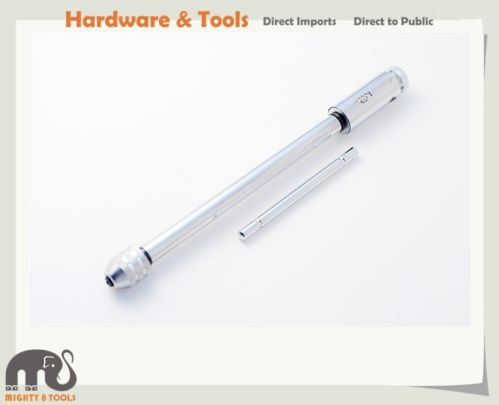

Then I went around the corner to my local tool merchant and got these.

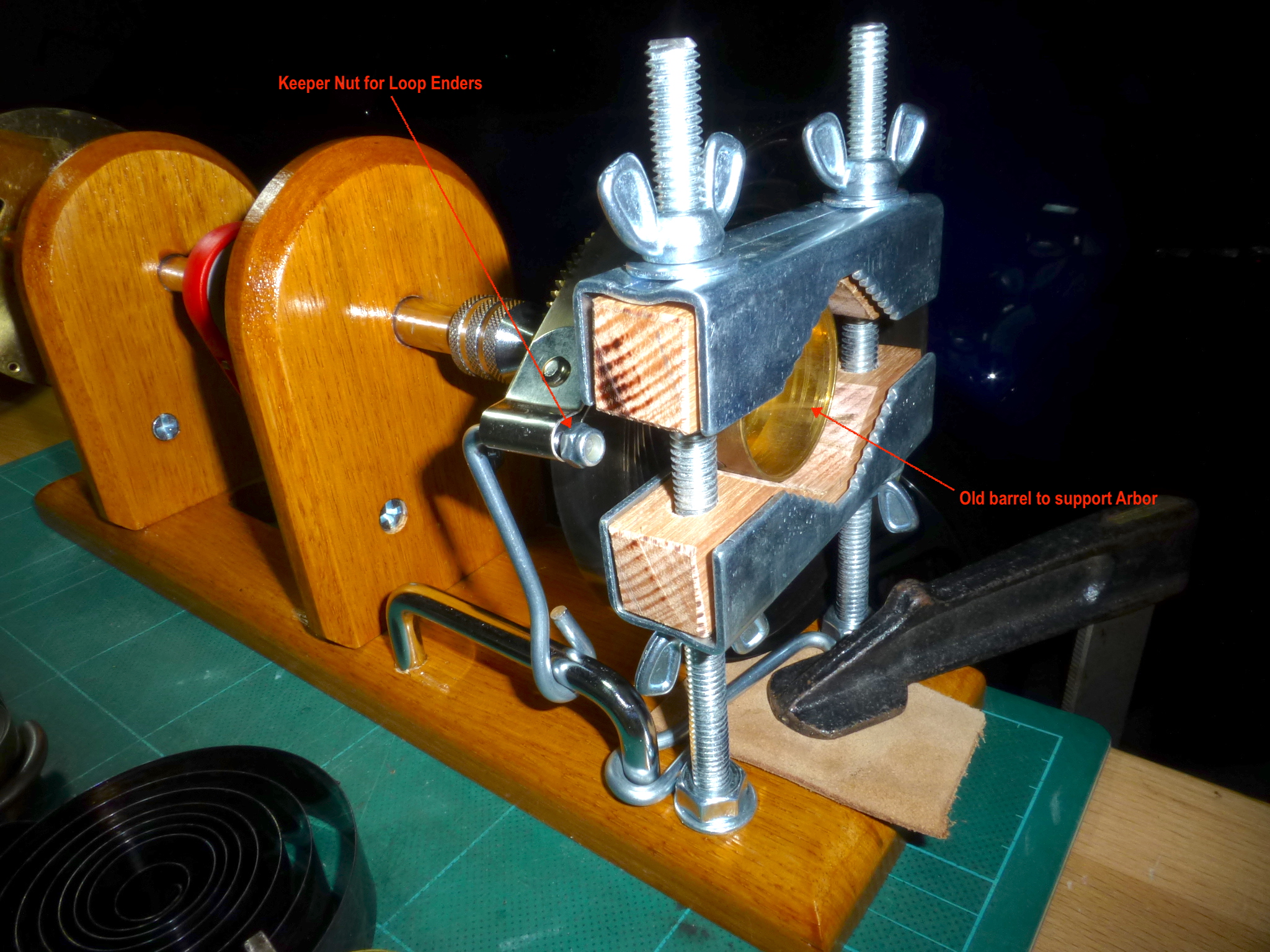

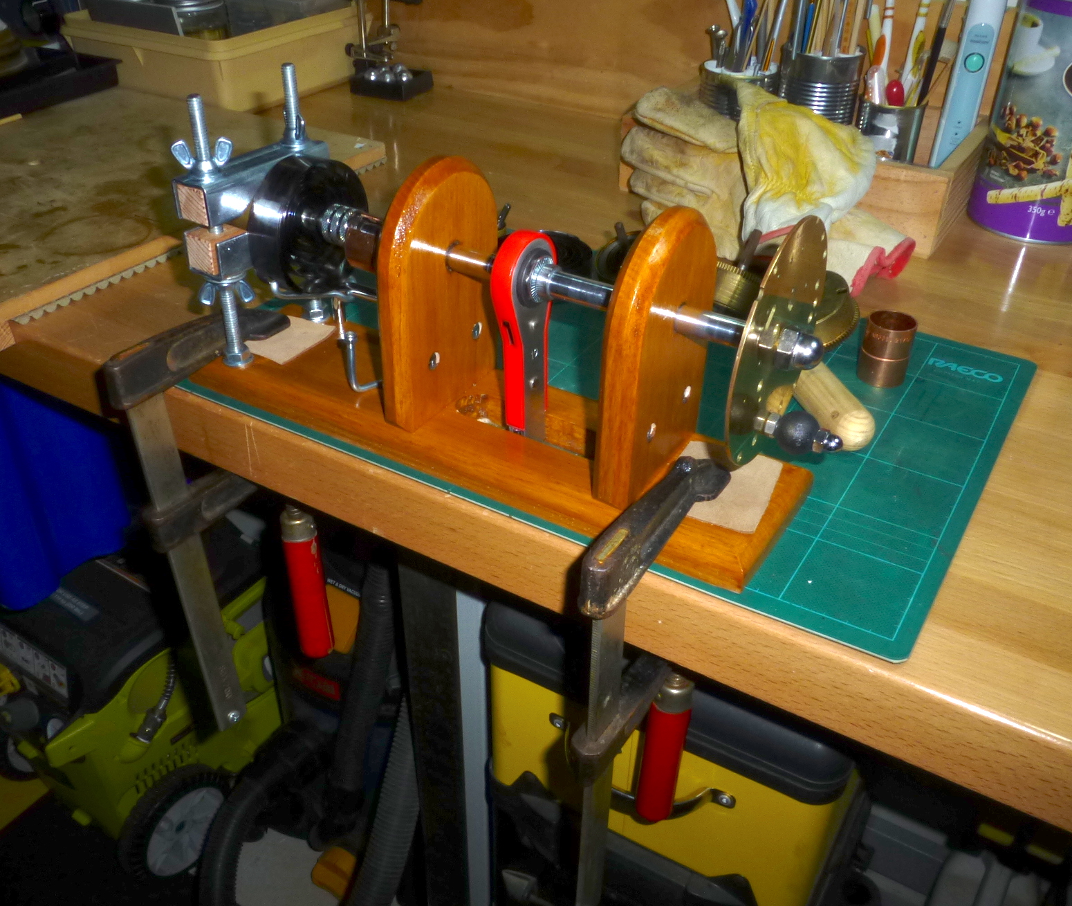

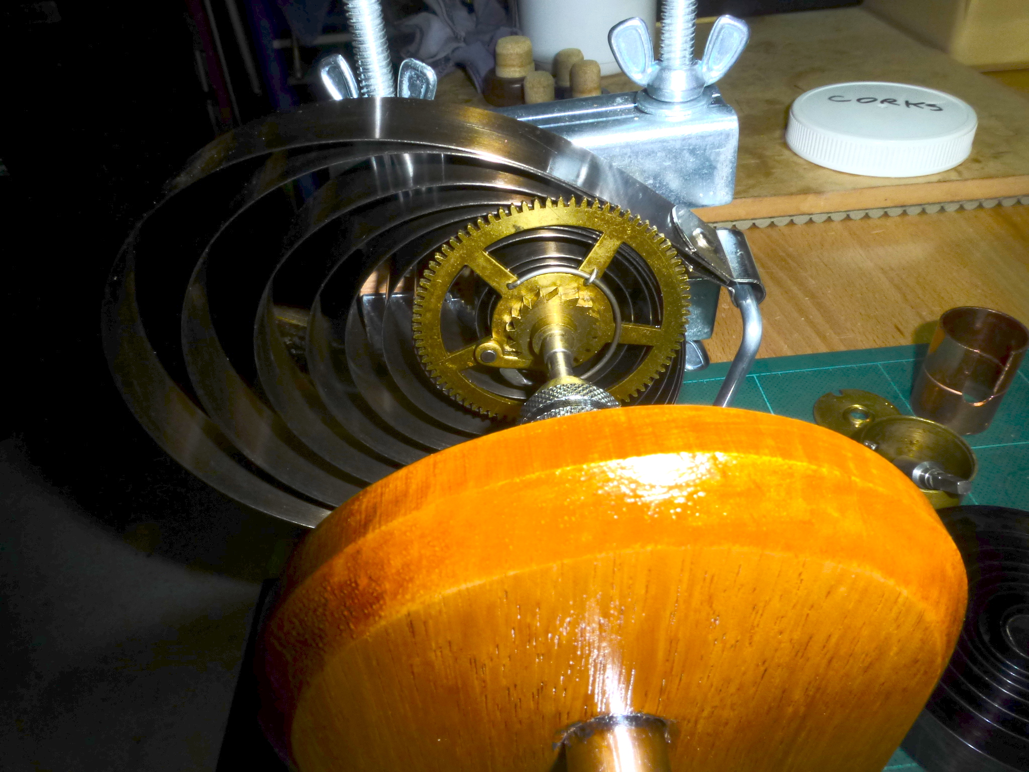

Back home I had a ferret through my scrap box, got some more bits and pieces and started cutting/chopping/modifying/grinding/hammering/screwing and making noise.
Eventually I ended up with this. No more clenched buttocks when working on mainsprings 馃榿.

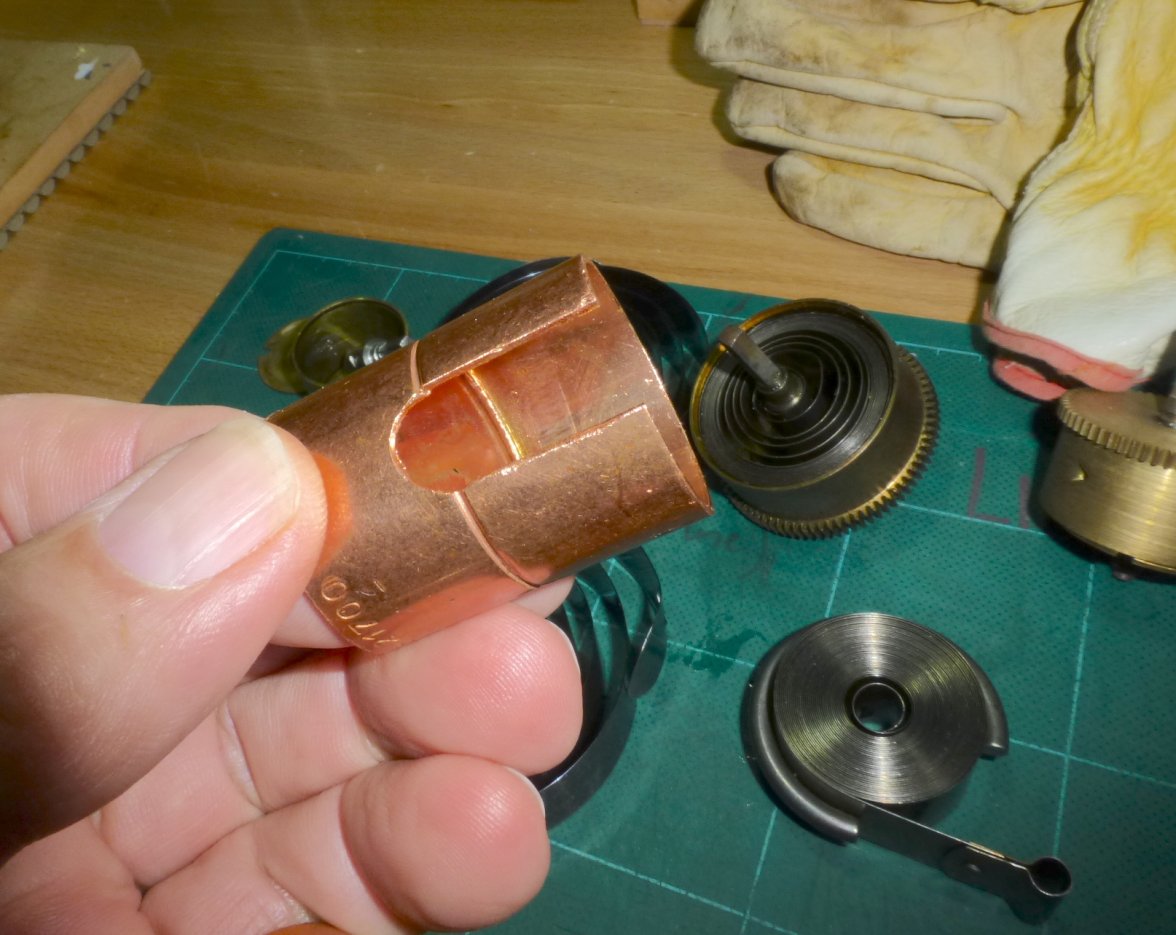

Ingenious! Your set up doesn鈥檛 show what you use for sleeves to capture the coiled mainspring prior to inserting the spring into the barrel. Your set up seems to be designed for hole end mainsprings. How would you use it for loop end mainsprings?
17,465
36,611
Well spotted Doug. At the moment I use copper water pipe adapters modified to fit the barrel for hole enders.
For loop enders I put a thread on the loop hook and use a nut to make sure the hook doesn't escape (don't ask me why I know about that 馃槈).
