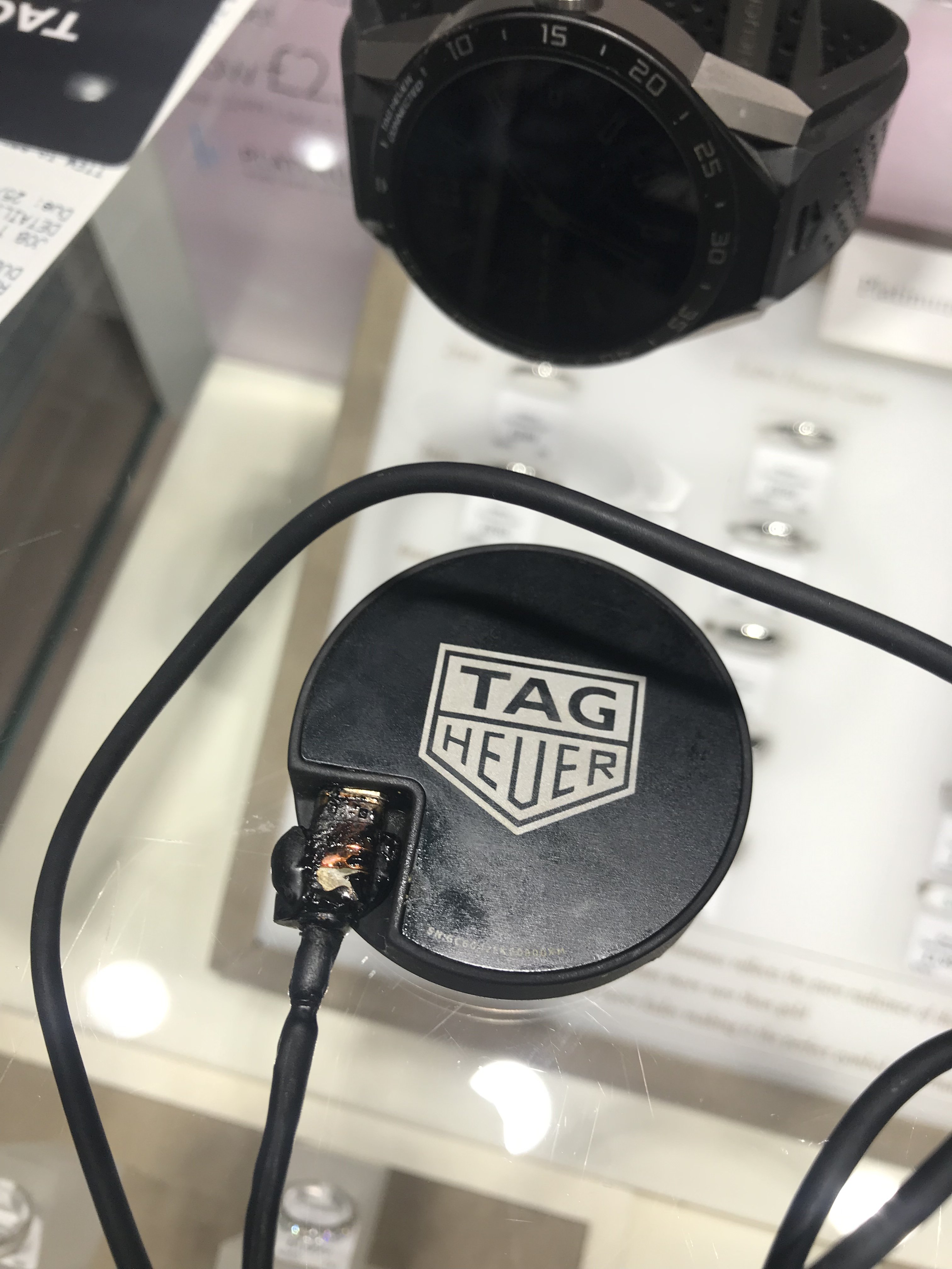

Hey. I’ve had a problem 3 days ago, watch is 5 months old, I noticed the battery was getting warm whilst charging. 2 hours later I’m presented with this and a dead watch. Plugged directly into a USB port into the wall socket (no plug) original wire as well. Sent it back and told to expect it back in Feb 19!!!

Mine (45) since a few days, also while the watch is charging is warm ( with the same charger since April 2017)
There was a updated or chages in software recently?
Mine was updated as needed. So I sure why and the Tag shop said they had not seen it before
