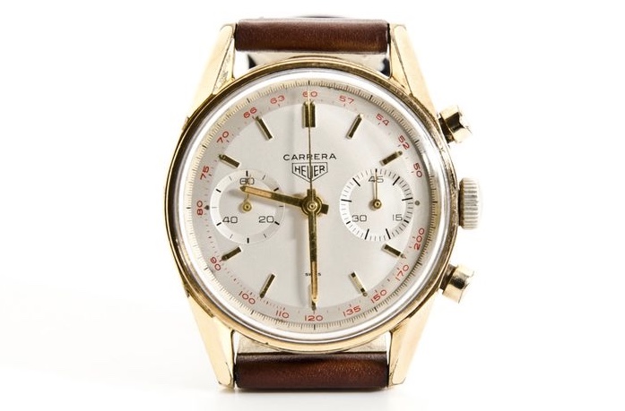

Hi there,
i bought a Carrera 45 some days ago. Serial is 70xxx. Could anyone give me an indication about the age of the watch? What is the best way to check the movement? Send it directly to the Tag Heuer Vintage workshop?
Thx for support!

Hello and welcome, what you have there is actually a reference 3648T - it's gold-plated rather than the stainless steel 3647.
A 70xxx reference would date it to probably middle of 1966 based on the research of those much more knowledgeable than I.
As far as watchmakers go, try Google for one in your area, or ask around here or at the OnTheDash Heuer forum - chronocentric.com/forums/heuer

Your watch looks stunning, I wouldn't do anything other than a basic service. Do not let anyone tell you pushers, crown or hands need to be replaced, they appear to be all original to the watch and look exceptional. For that matter it looks like the watch was rarely worn.
