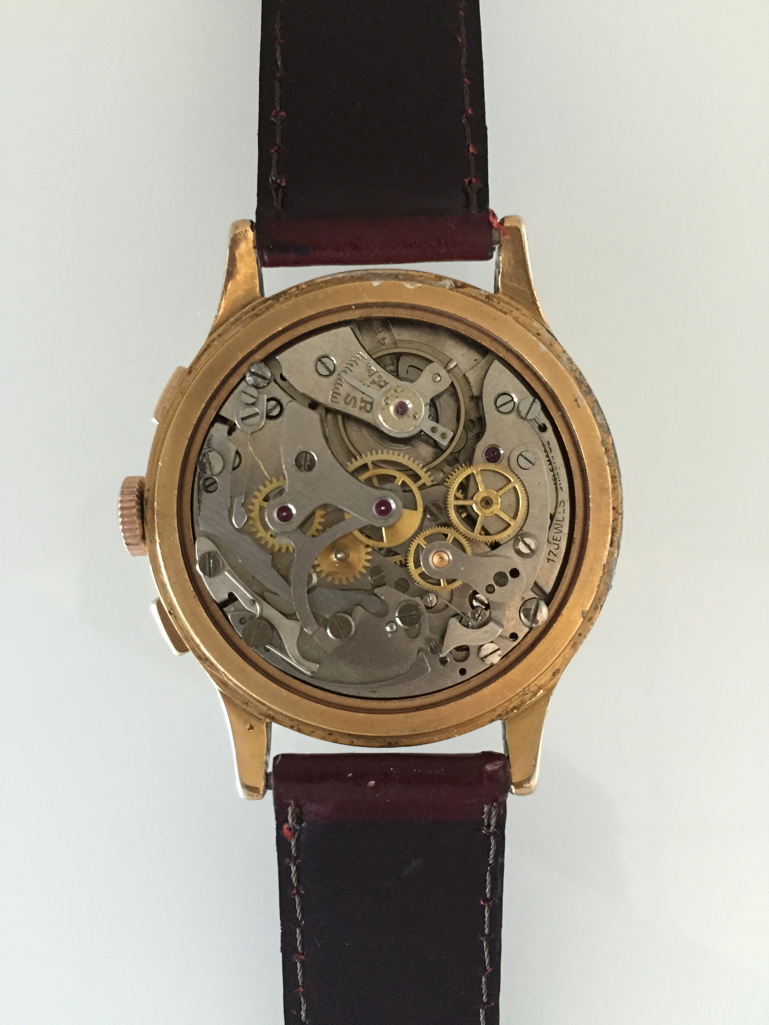

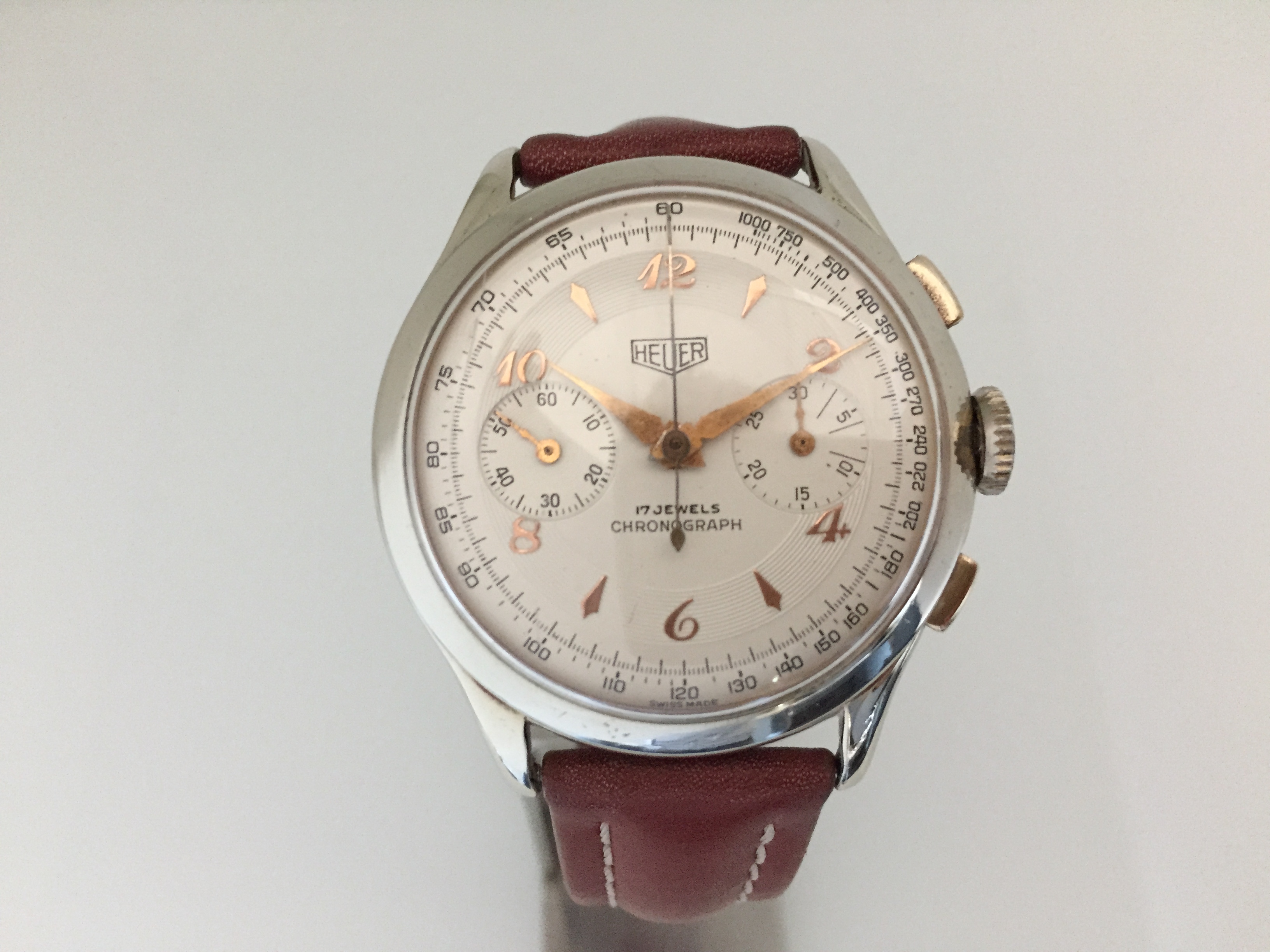

I write because I have in my hands this watch that should be an original Heuer, but I'm not sure.
The movement it's a Landeron 48, so it seems strange, but I've seen some vintage leonidas with the same index and in the 40's I know they worked together and share parts.
Can you give me your opinion?
Thanks

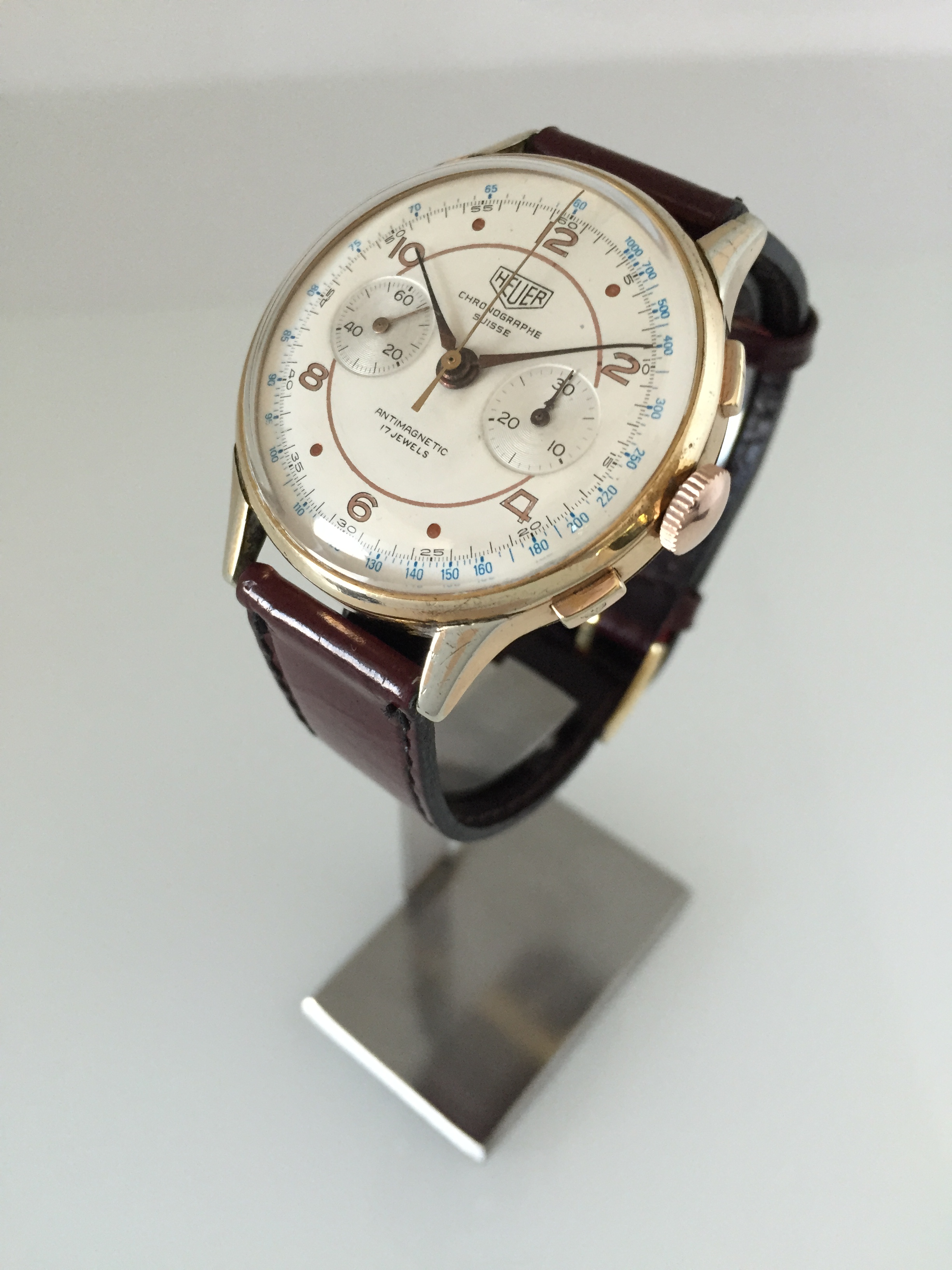

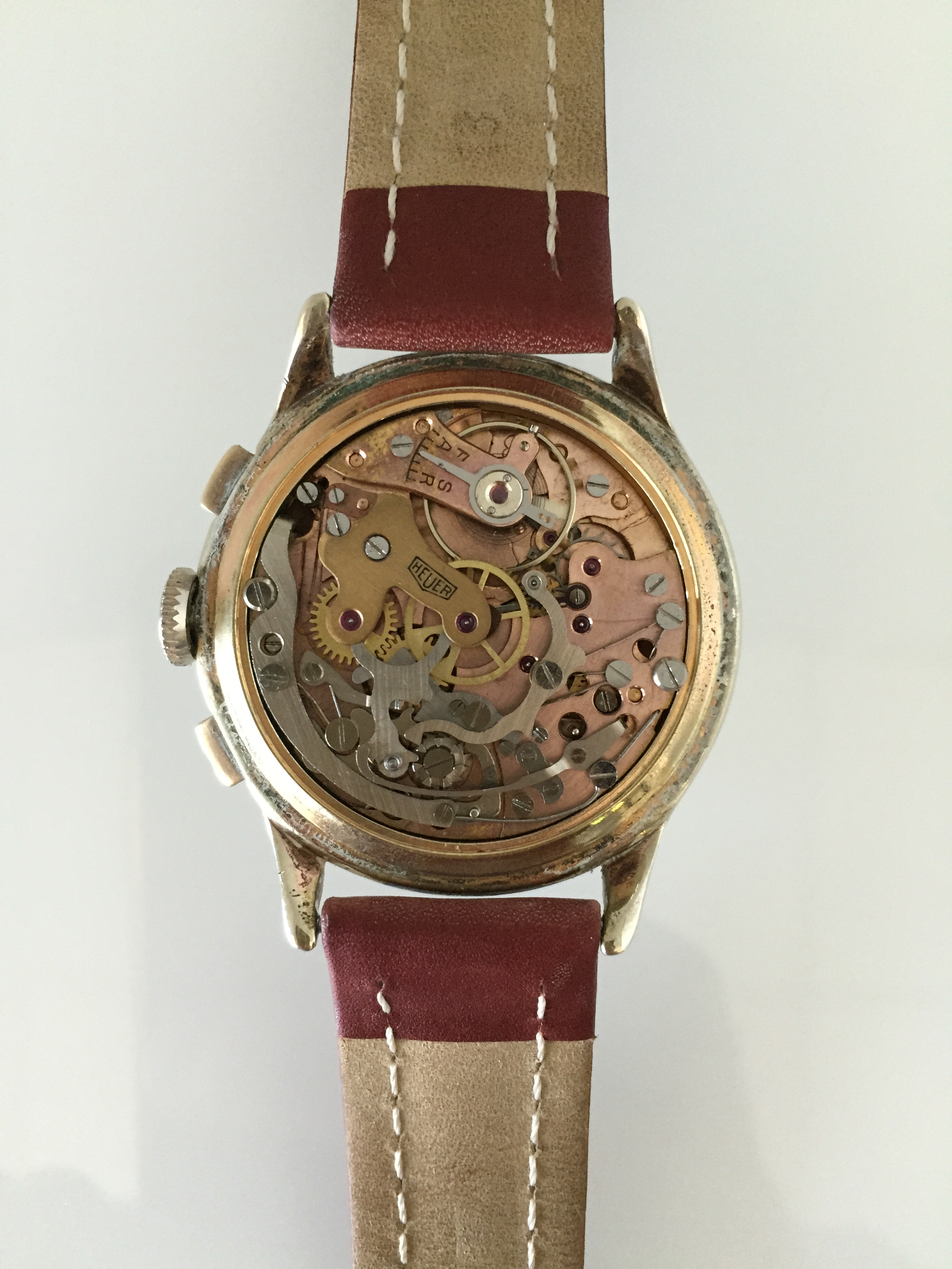

I think I need help also with this one..
Even if it has a Valjoux 92..
What do you think?

Hi and welcome!
Neither watch looks right. The first one looks like a modified Ref. 333, but dial is certainly not original.
Second one is not a genuine Heuer.
