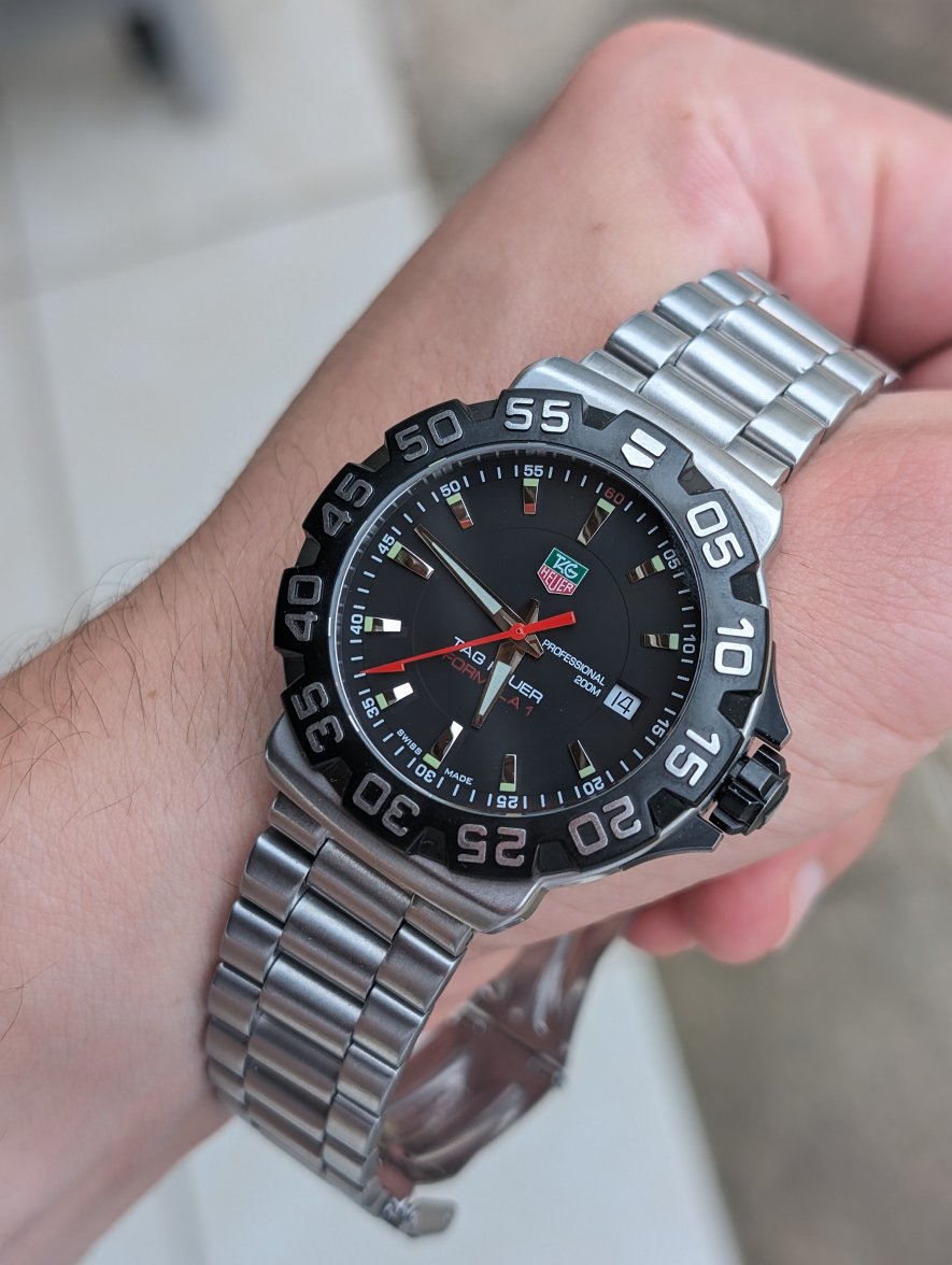

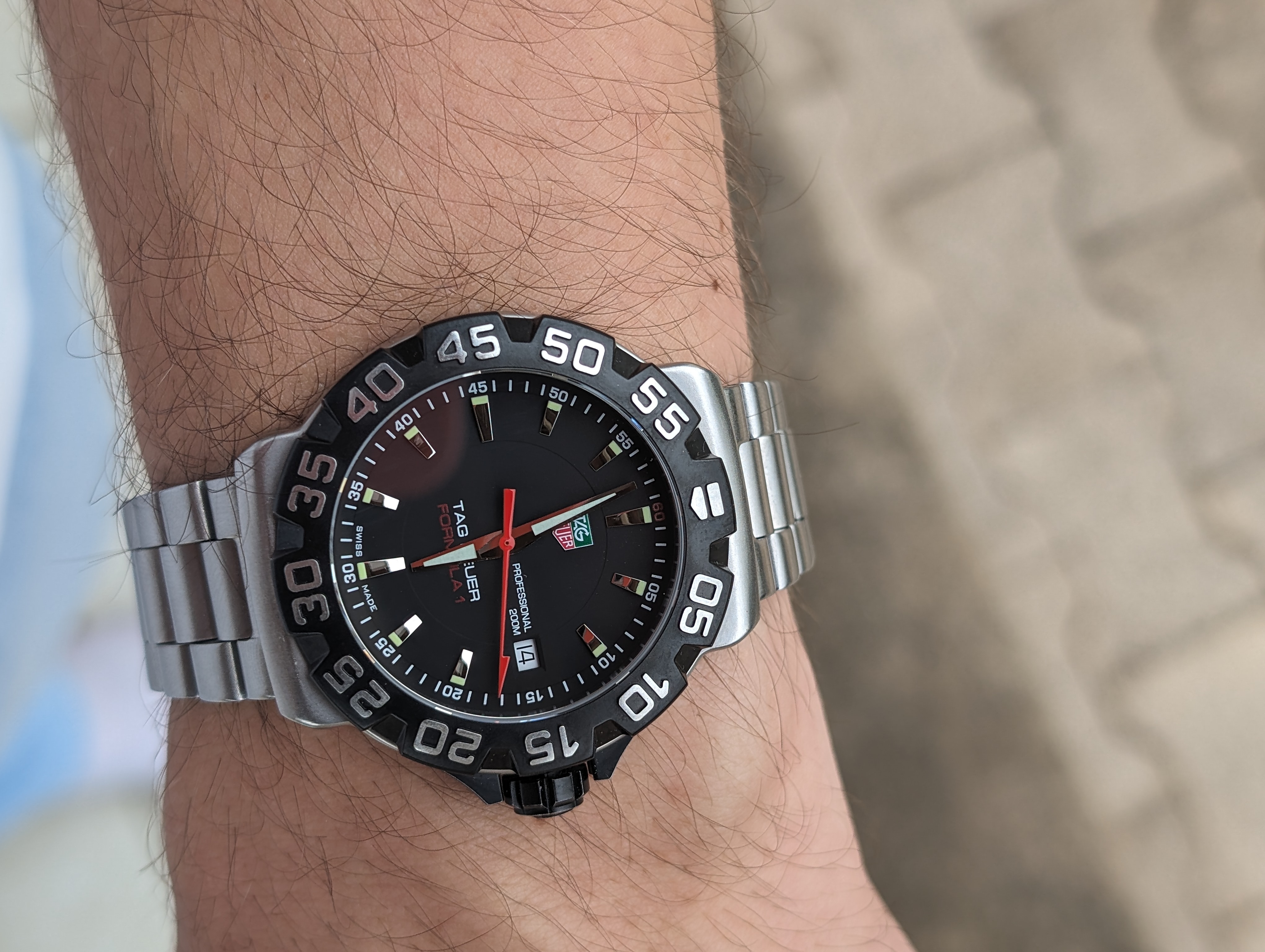

And boy is it good. To me this isn't even super-fake anymore but hyper-fake:
My fine eye for details and a trip to my A.D managed to settles things out though :

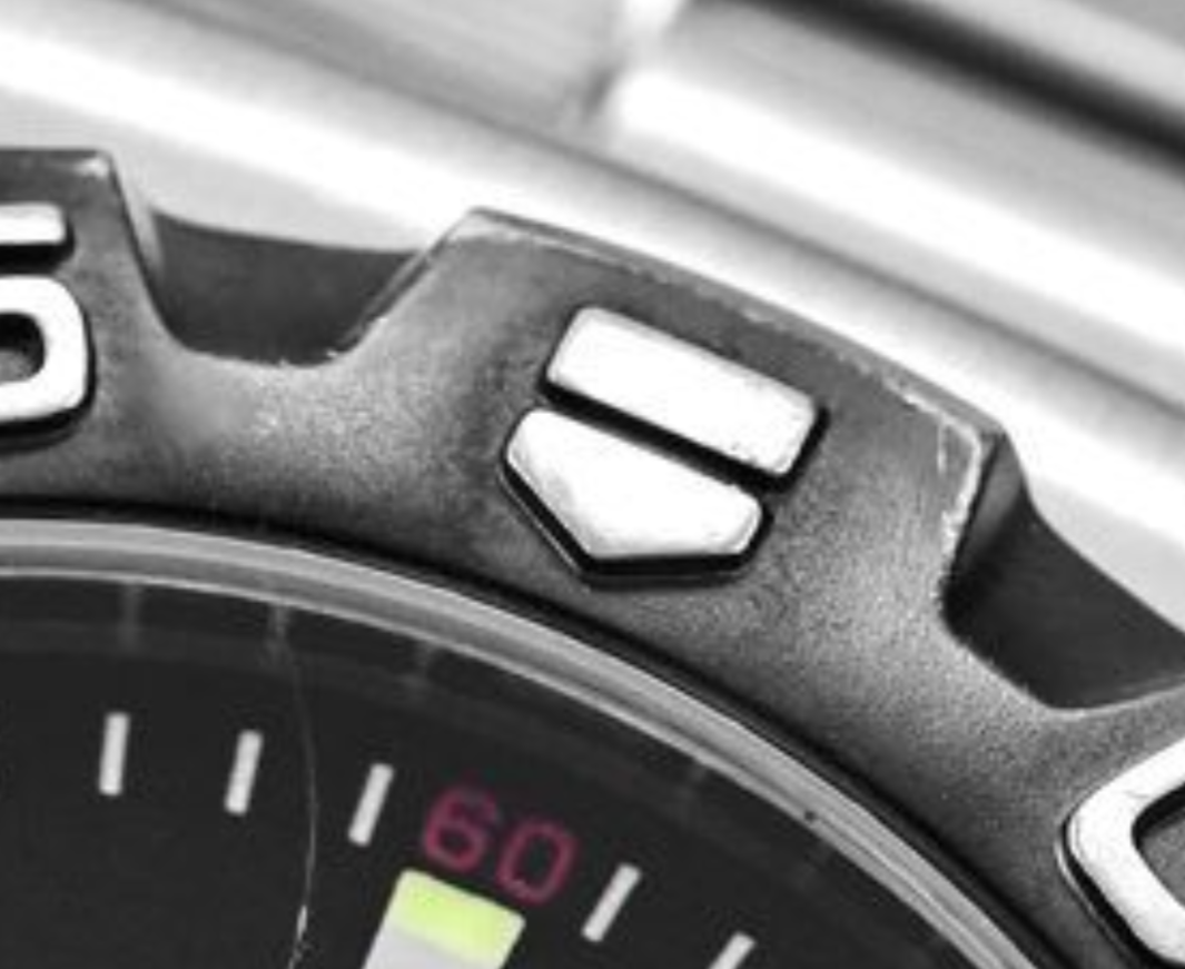

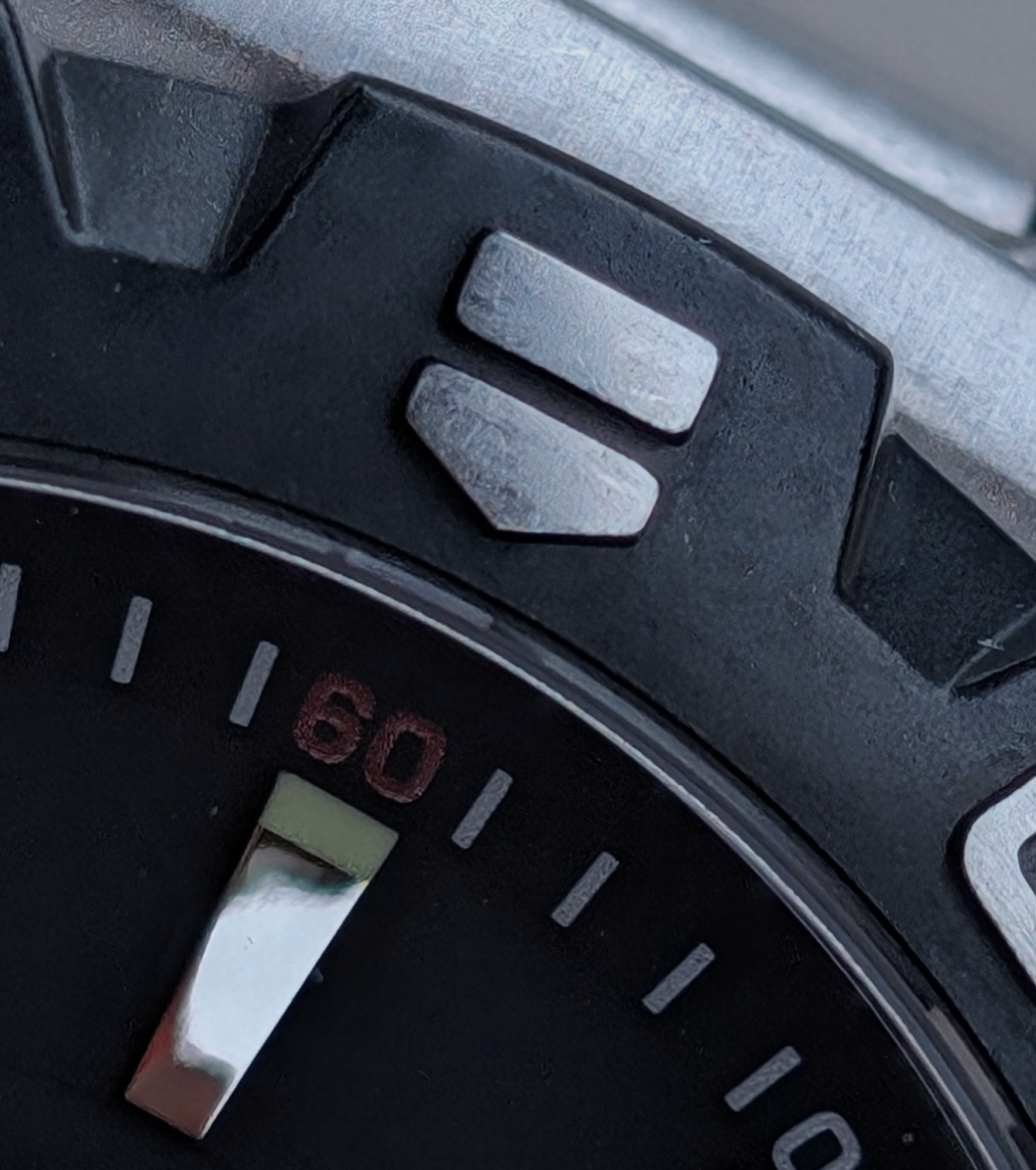

Bezel logo at 12. Above picture is on a certified authentic WAH1110. Below picture is from the watch I bought.
Notice how the space between the two elements is bigger. The "HEUER" part of the logo is also strangely round.

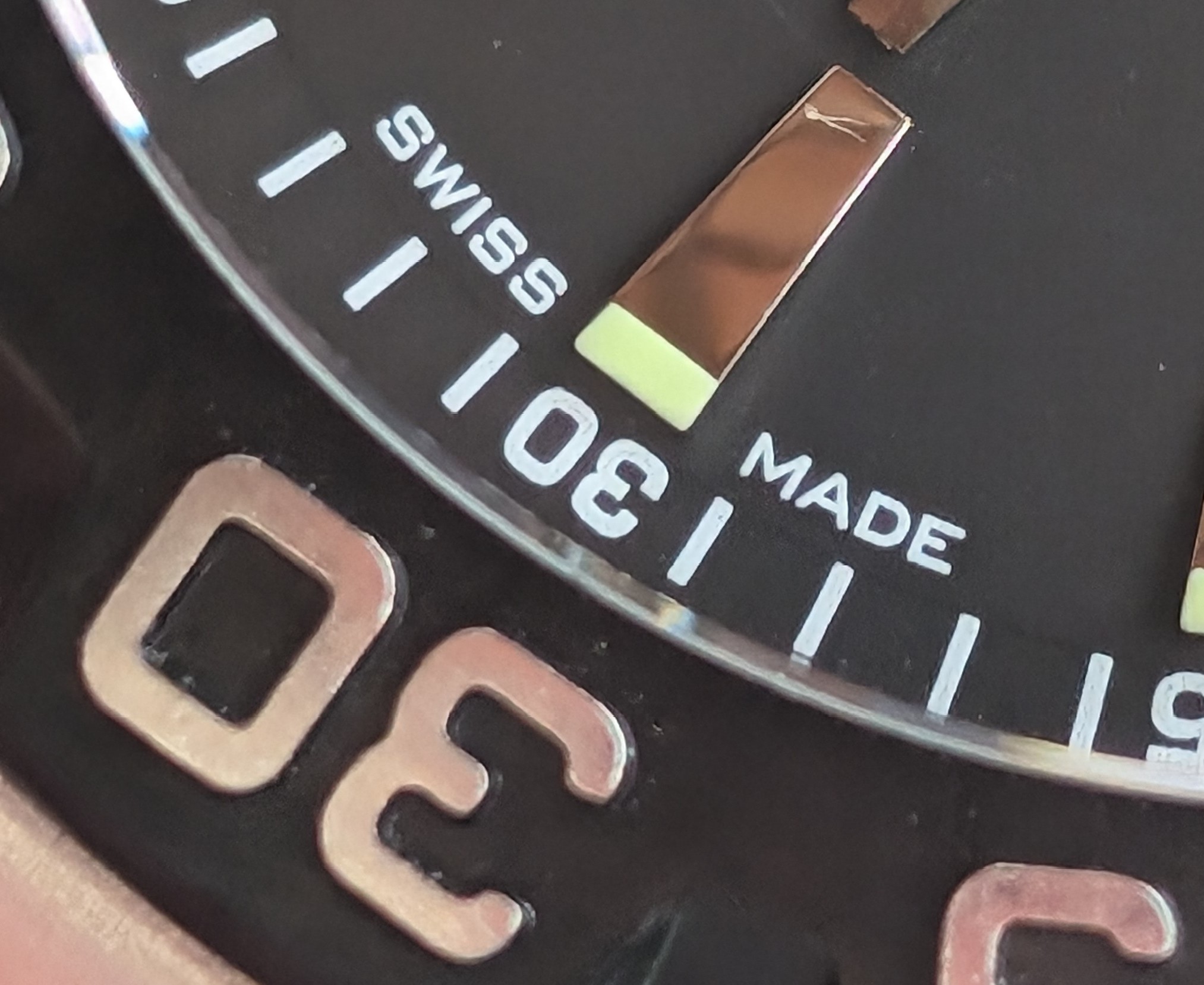

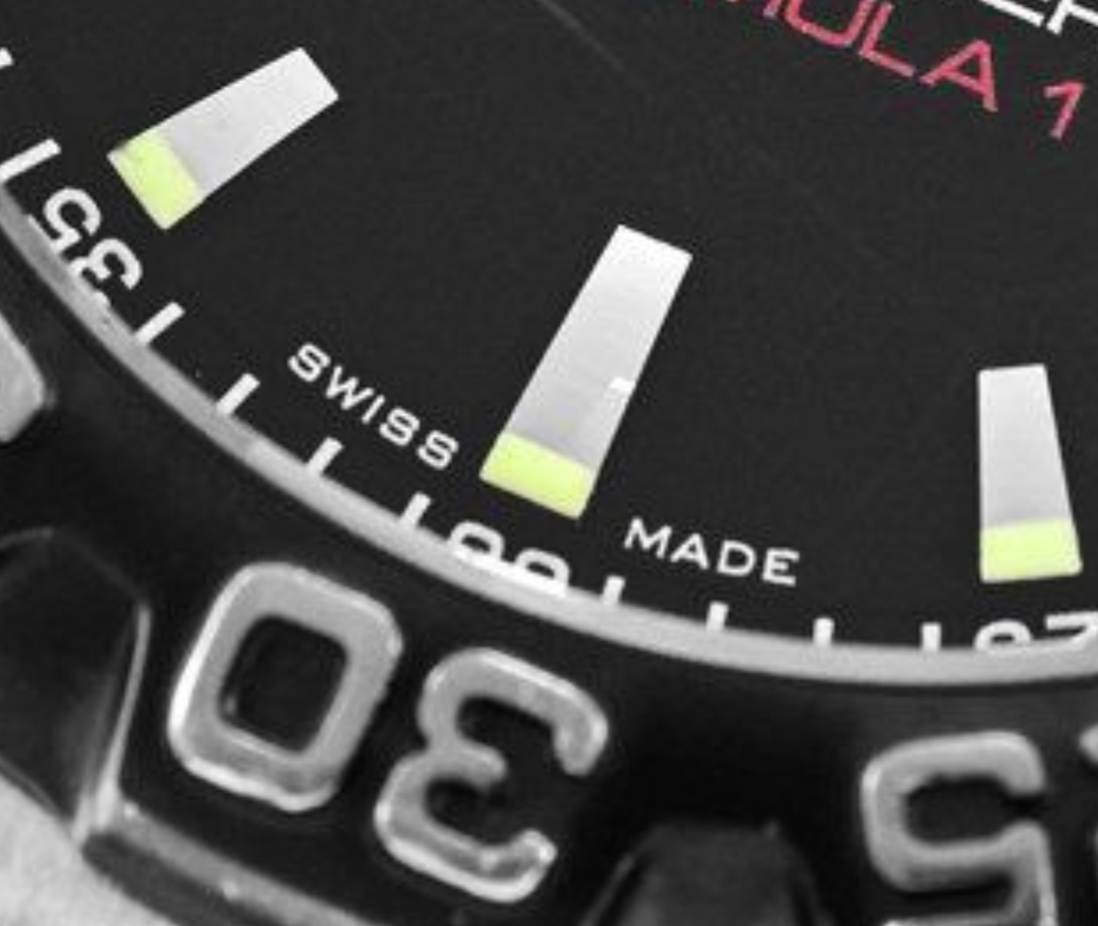

Now onto the SWISS MADE text at six.
Above picture is certified authentic. Below picture, what I bought.
This one is harder, but you can clearly tell that one is "SWISS MADE" while the other, more like "SWISS MADE".
Clearly not the same font.

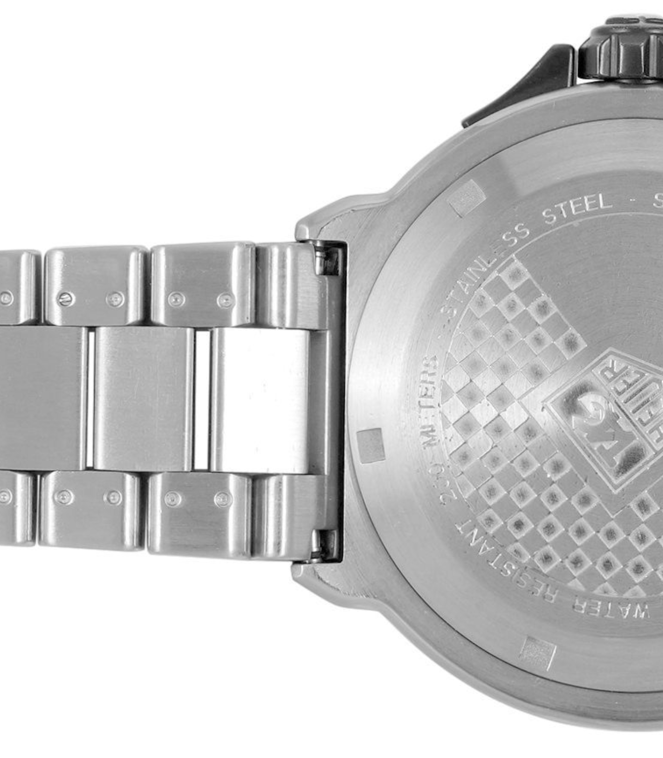

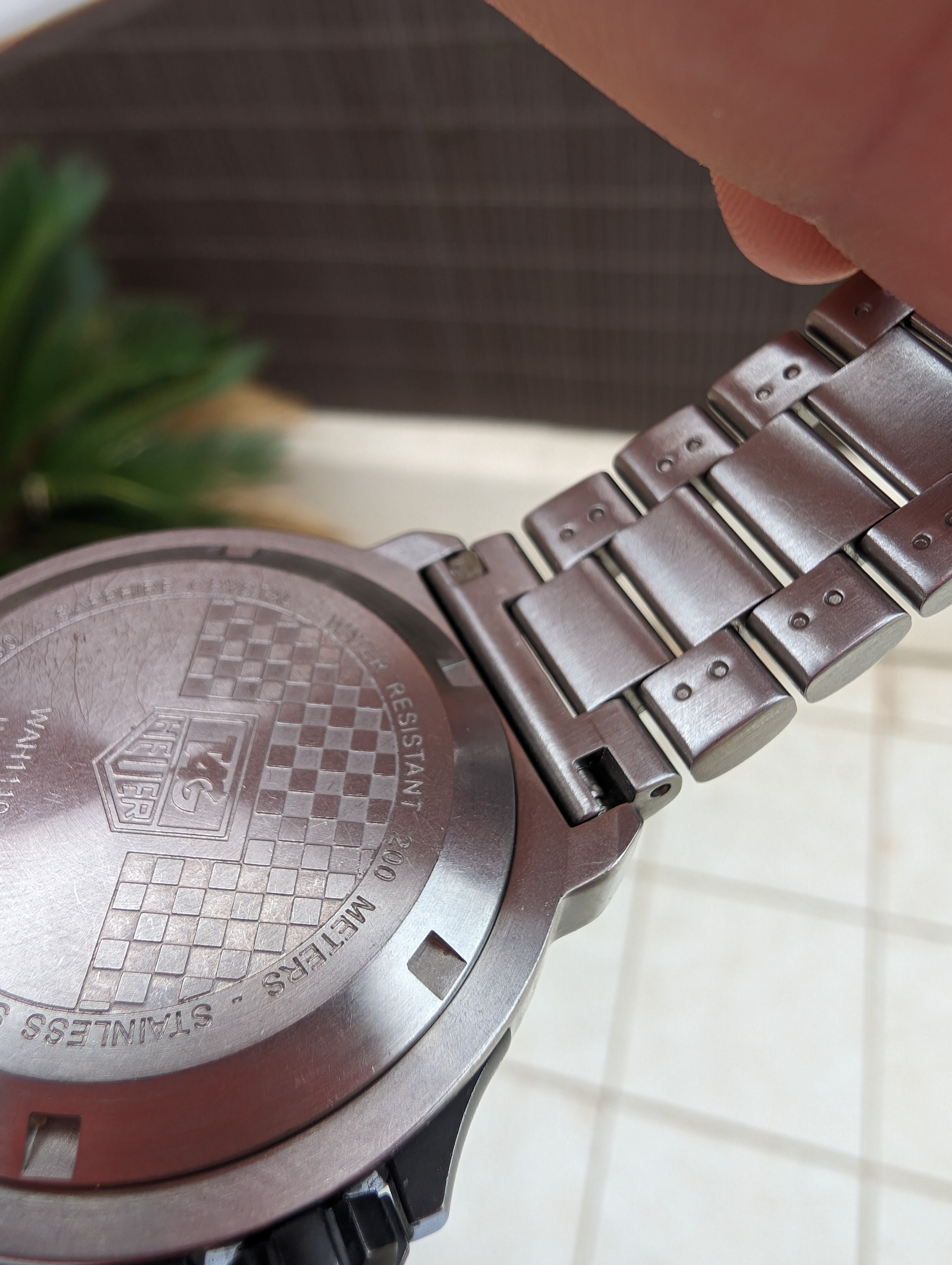

Now, some deep obscures details on the back of the watch.
Here, notice two things :
The space between the little holes on the back of the links.
The space between the edge of the caseback and the holes for the caseback removing tool.
Below is the watch I bought. Above, certified authentic.
Scary good, right ?
Here's the watch opened by A.D, who told me the back had been "hand screw" and was barely staying in place.

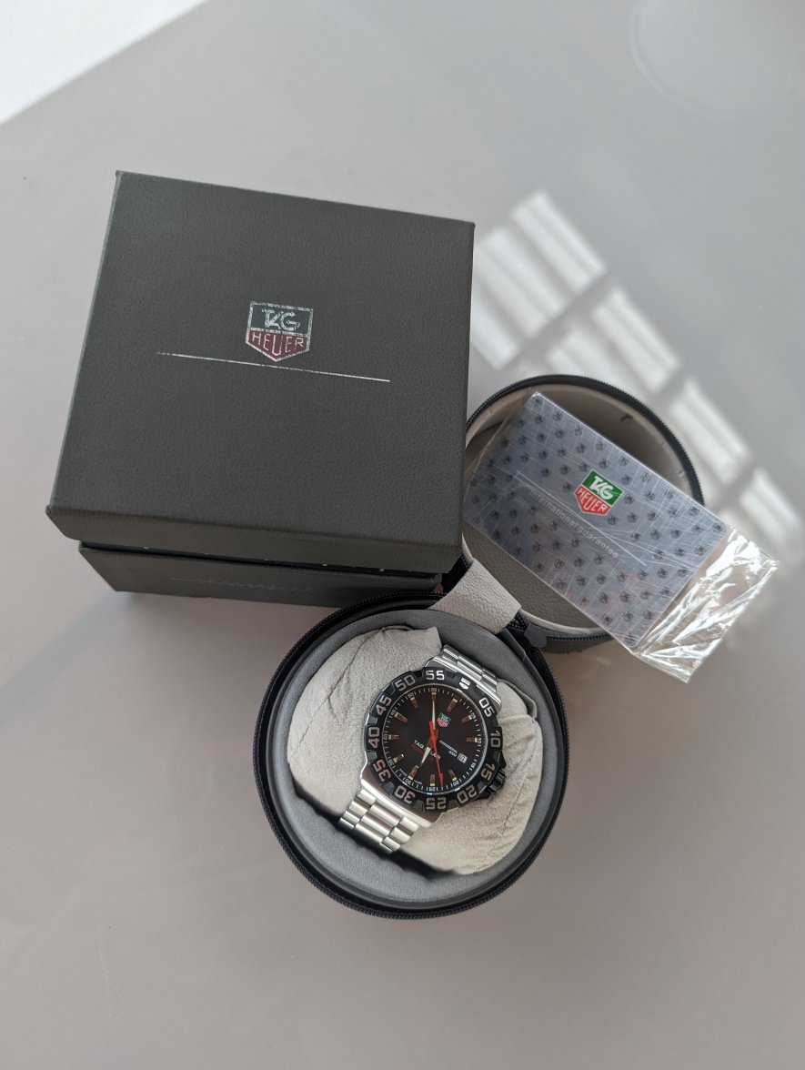

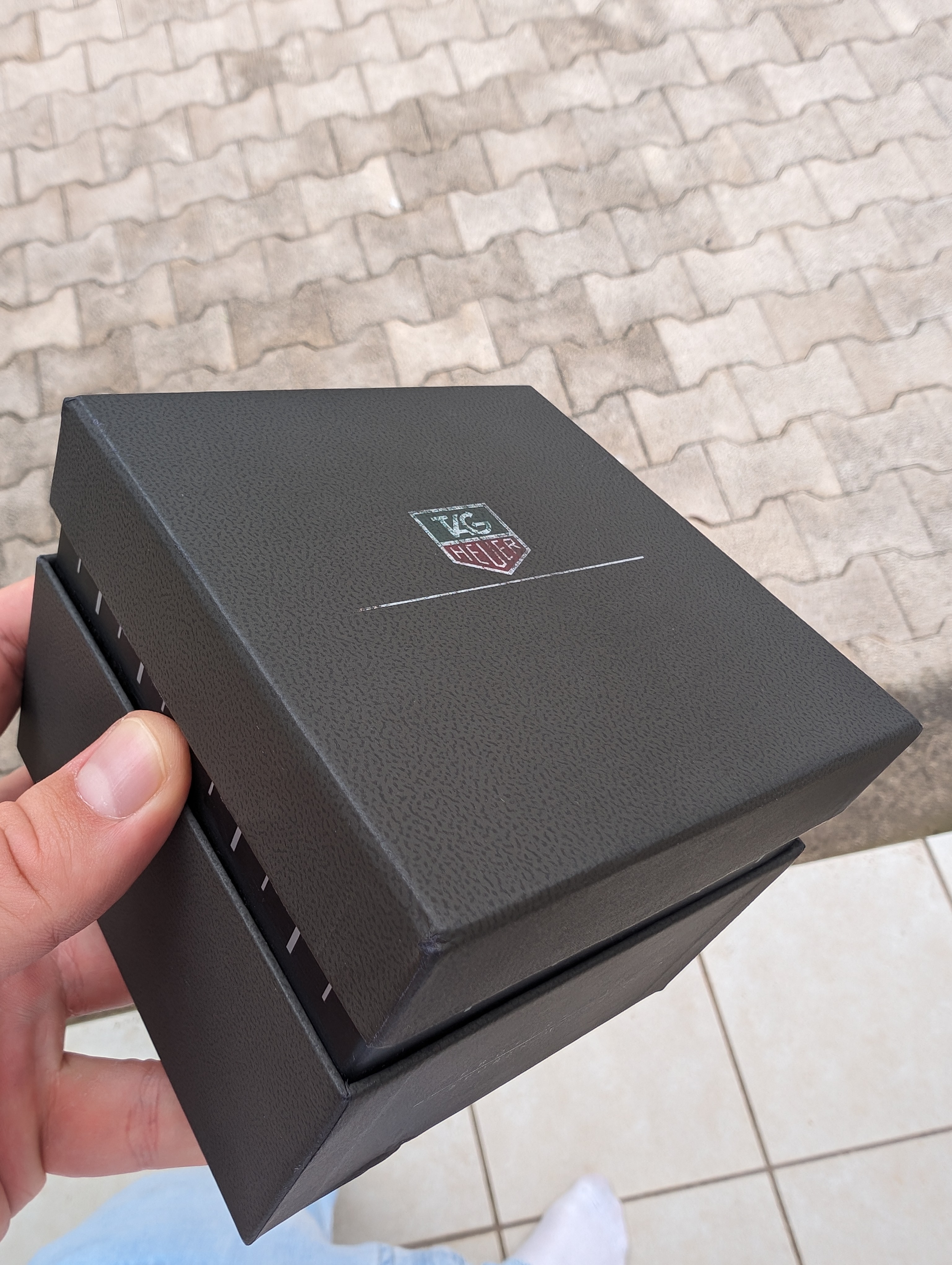

Now, what comes with the watch. Starting with the box.
The patina on the logo really sold me on the authenticity.
But it's all fake. This box is brand new. It even smells new. Nowhere near what a 18 years old box should look, feel, or smell like. Because yes, according to the card, this watch was bought in 2006. Note the fake patina on the card.
Last nail in the coffin, that card. Here's Tag Heuer's 2006 Catalog for monochroms F1s :
That's right. No WAH1110.BA0850. This reference was introduced in 2007...

The box is truly terrible and you can instantly tell it's a fake. The logo is all wrong and the wear clearly artificial. The watch looks good at first glance but although I can't put my finger on it exactly, something just looks a little off. The fact is looks so brand new is also a red flag.

I mean... I did say it looked dodgy. But he wouldn't listen.

And like you.. I can't say why exactly. Just looks wrong.
I played with it a little and it looks just right, with some weight to it as well. I believe there's even some anti reflective layers on that sapphire. But as you said, it has no right to look this fresh which is a dead give away.
Something about the bezel I think, maybe the sizing/proportions aren’t quite right? Bezel font is wrong too.
Bezel, definitely. And also the dial logo. And the whole thing doesn't quite have the same sheen/finishing as a real one - difficult to put your finger on, but it just doesn't have the right "look".

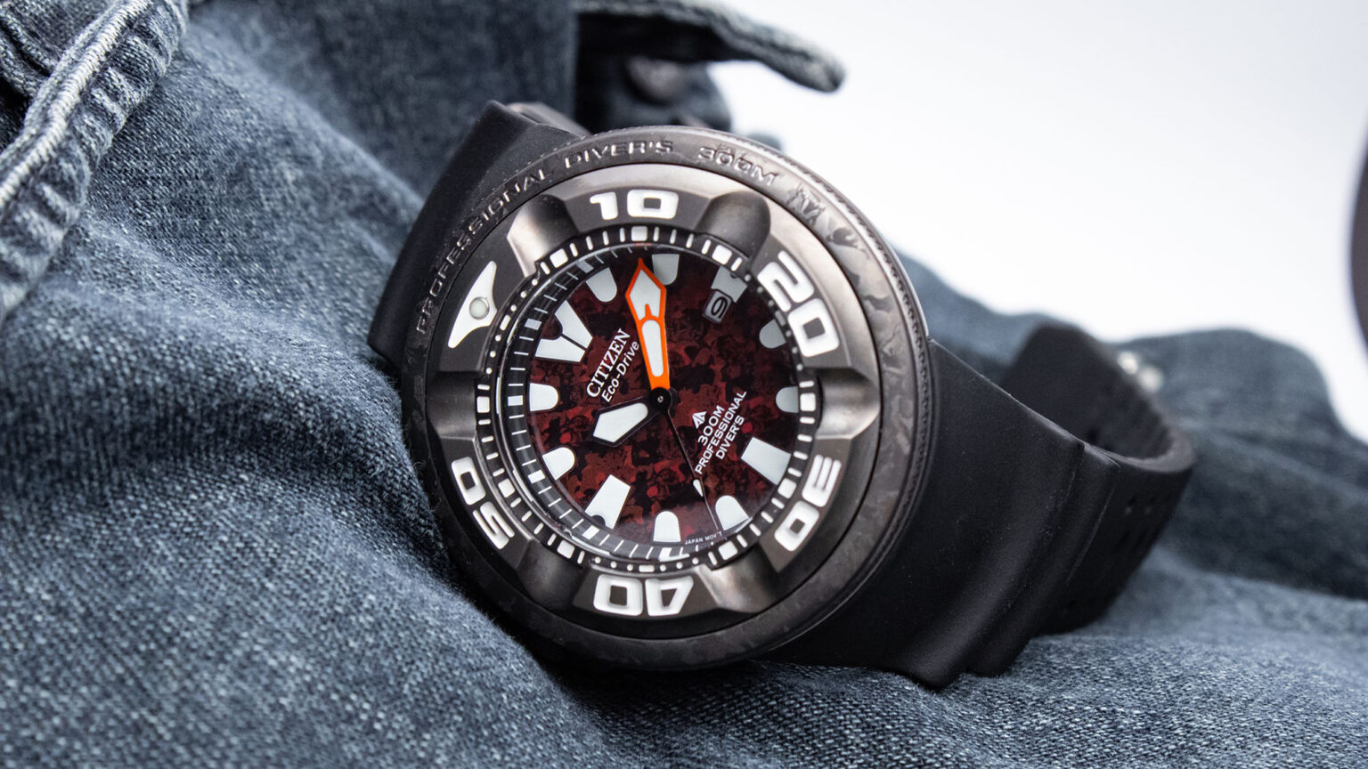

Thanks for the suggestion, but I'm gonna steer clear of eBay for a while. As for my quartz beater purchase, the Citizen Godzilla Promaster filled that niche quite nicely. Comfortably brand new, iso certified and solar powered. It's also a lot more exotic than a black dial F1 from 2007, which I particularly enjoy.
