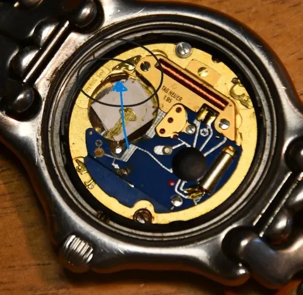

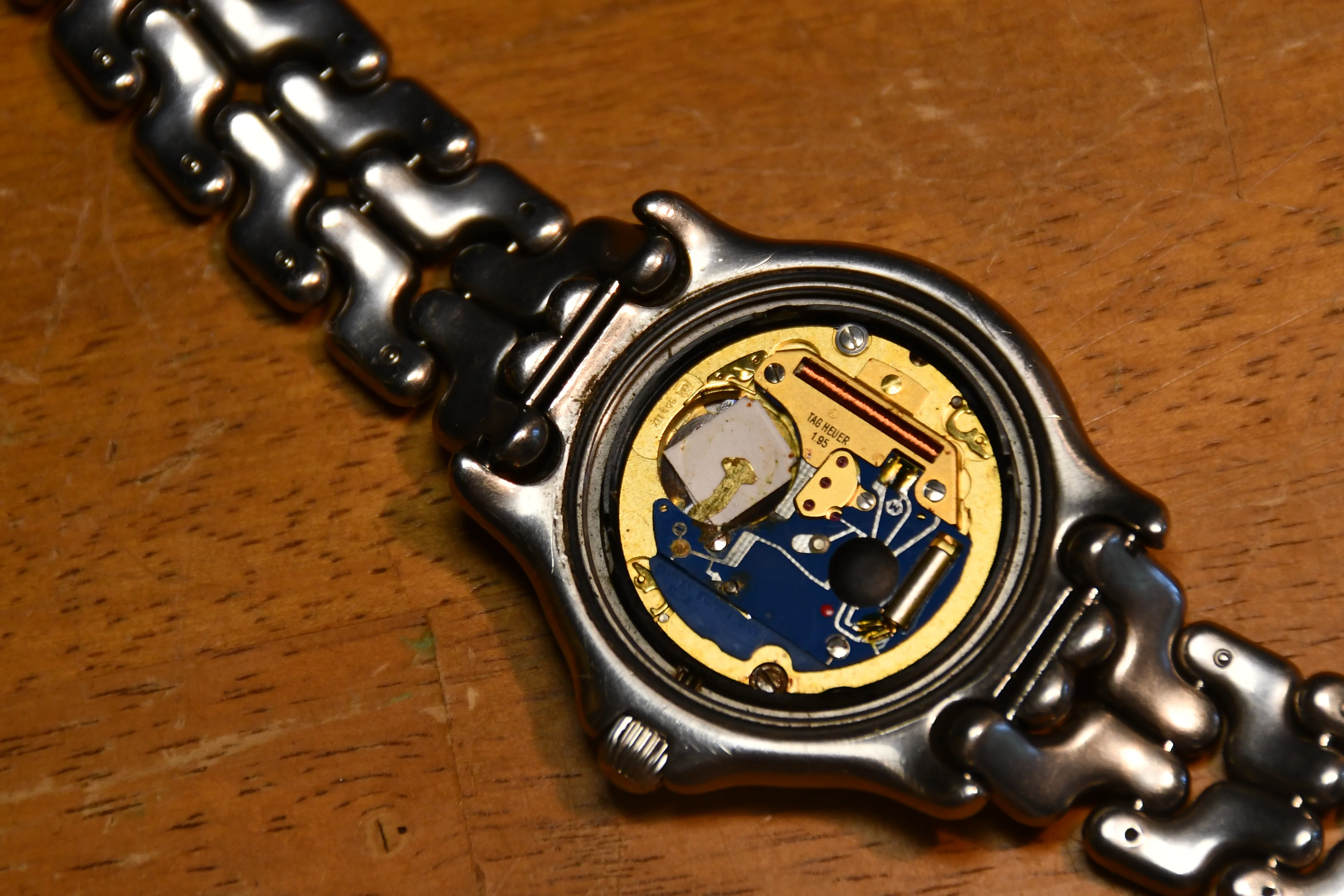

Hi this is my 1st post, nice to meet you guys. I have a S/el. when I put in the new battery and push it to the top or bottom it will work. but when I put on the back cover no joy. I added a small paper shim and still no joy. Is this a known issue and is their a known fix?

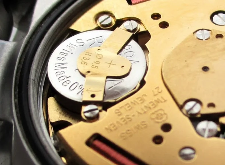

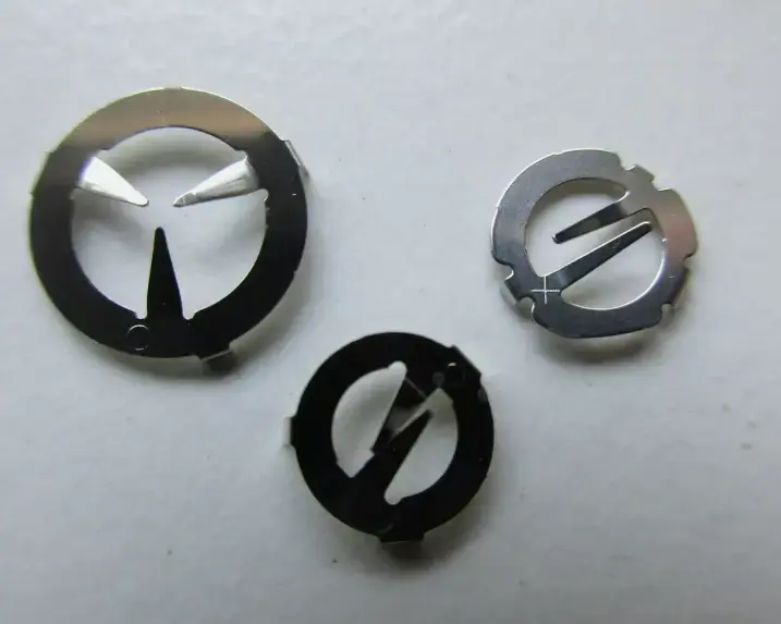

It might be that you are missing a battery spring. This is a circular piece of metal that springs against the backplate and pushes the battery down.

This is usually where you press the battery against and provides the grip to keep it in place.
4
Thanks so much!!! 😀 😉 I added more paper shims and used paper shim to hit that spot that you indicat with your blue arrow. Yahoo it works,,,,, but it stopped after about 4-5 hours. I will get out my fluke to check the battery. Probably why I stopped using it. Because it eats batteries.
