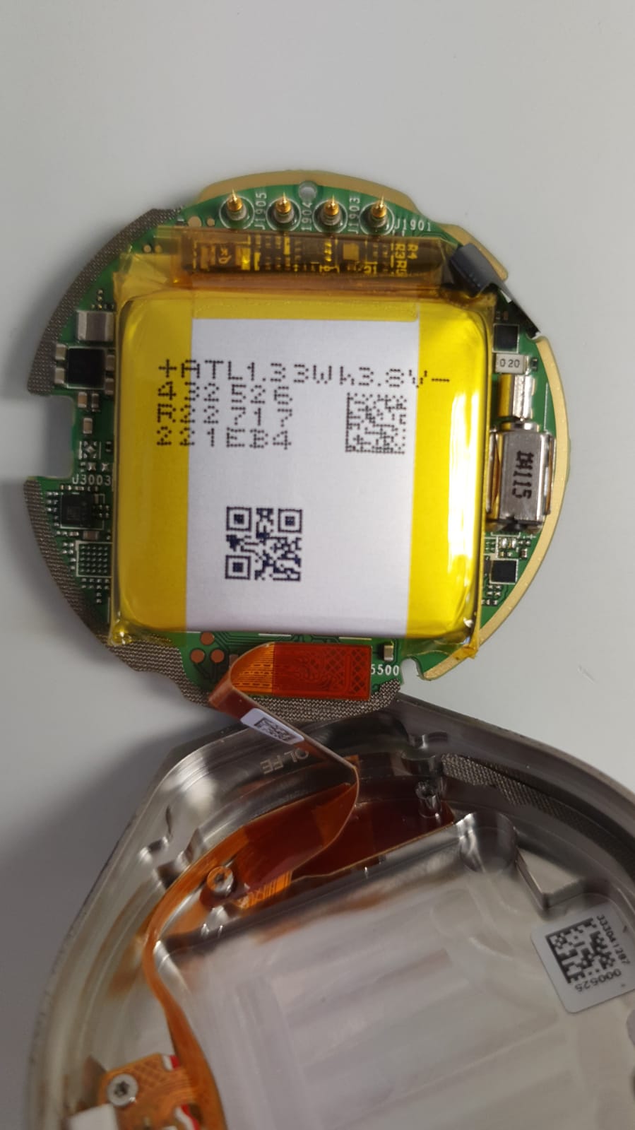

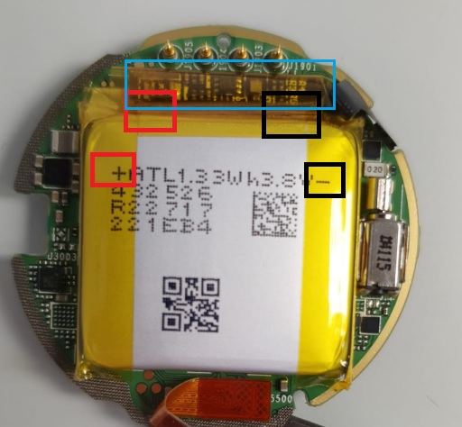

Hi Sir, can battery leads/connectors easily be removed and placed on a new battery ?
Thanks for the replies, I would like also to know how difficult swapping leads is?
80
142
Thank you very much. How difficult or easy is it to swap leads over?
If you can solder this should be straight forward if not have someone do it for you.
The battery has 2 tabs and are +/- marked that are soldered to the PCM(Power Control Module) Blue box above.
This PCM has replace the PCM on the new battery so you have the right main board connector and any logic TH added to this PCM will be maintained.
