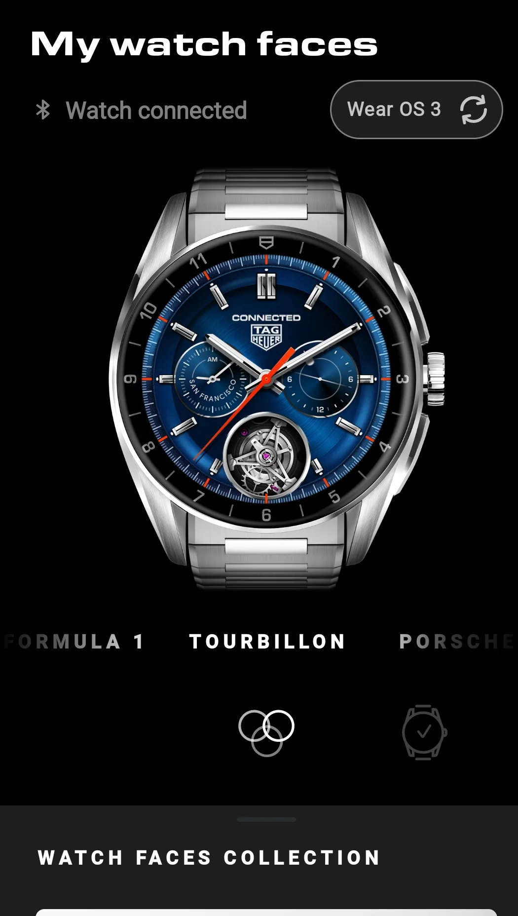

I have had the Tag Heuer Connected calibre e4 42mm for just over a year. I absolutely love the watch. Had similar battery issues. Not lasting more than 12 hrs. Tag Heuer replaced my watch one time asked me to do a factory reset another time and finally again asked me to send the watch back to check.
I have done this now battery lasts more than 24 hours for me.
1. Reset the watch
2. Connect as normal to Tag Heuer app.
3. Now log out from Tag Heuer phone app.
4. Install Wear OS and connect through Wear OS, Tag Heuer app will also connect automatically.
Will show Watch connected and Wear OS. Attached pic.
Work for me dramatically improved battery life. Hope this helps.
1. Reset the watch

Hi Luca, my watch battery lasted 12 to 14 hrs. max. previously, now lasts about 30 hrs. if that helps.
Regards,
