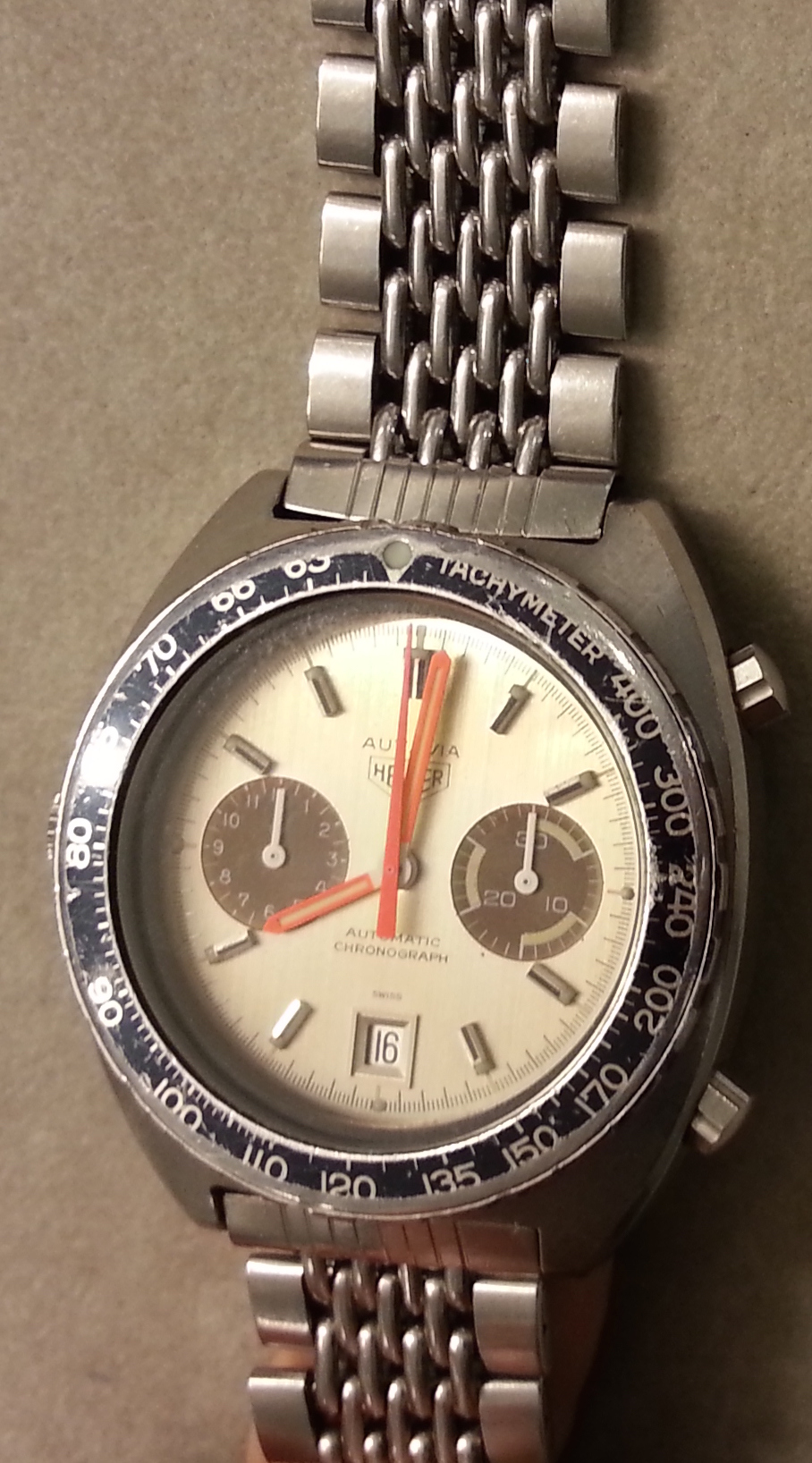

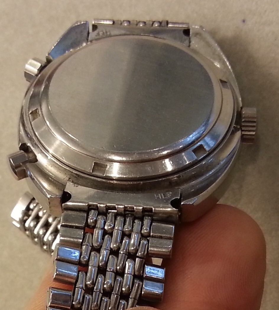

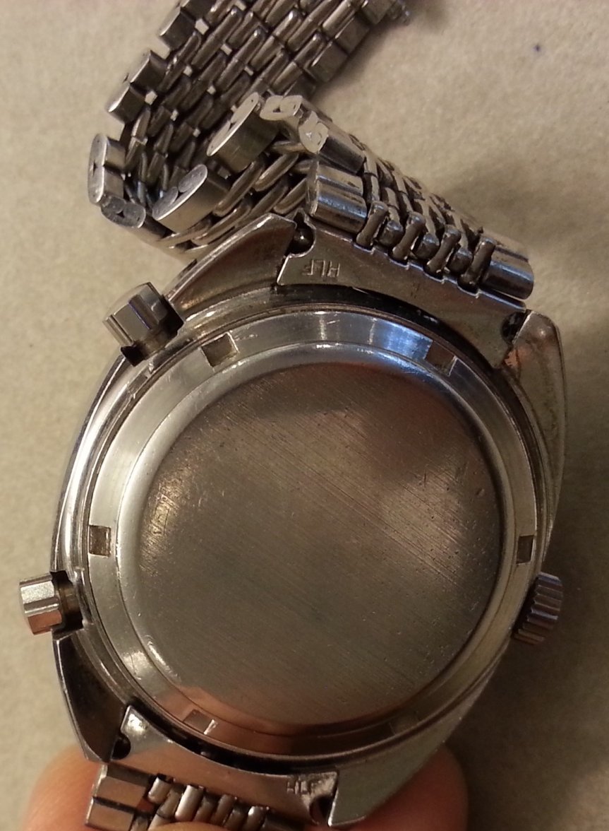

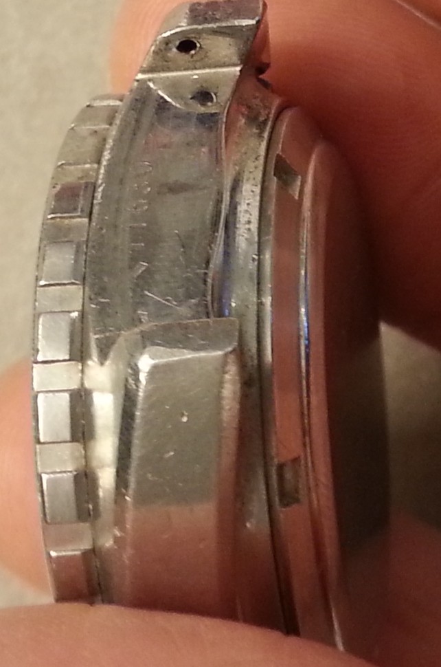

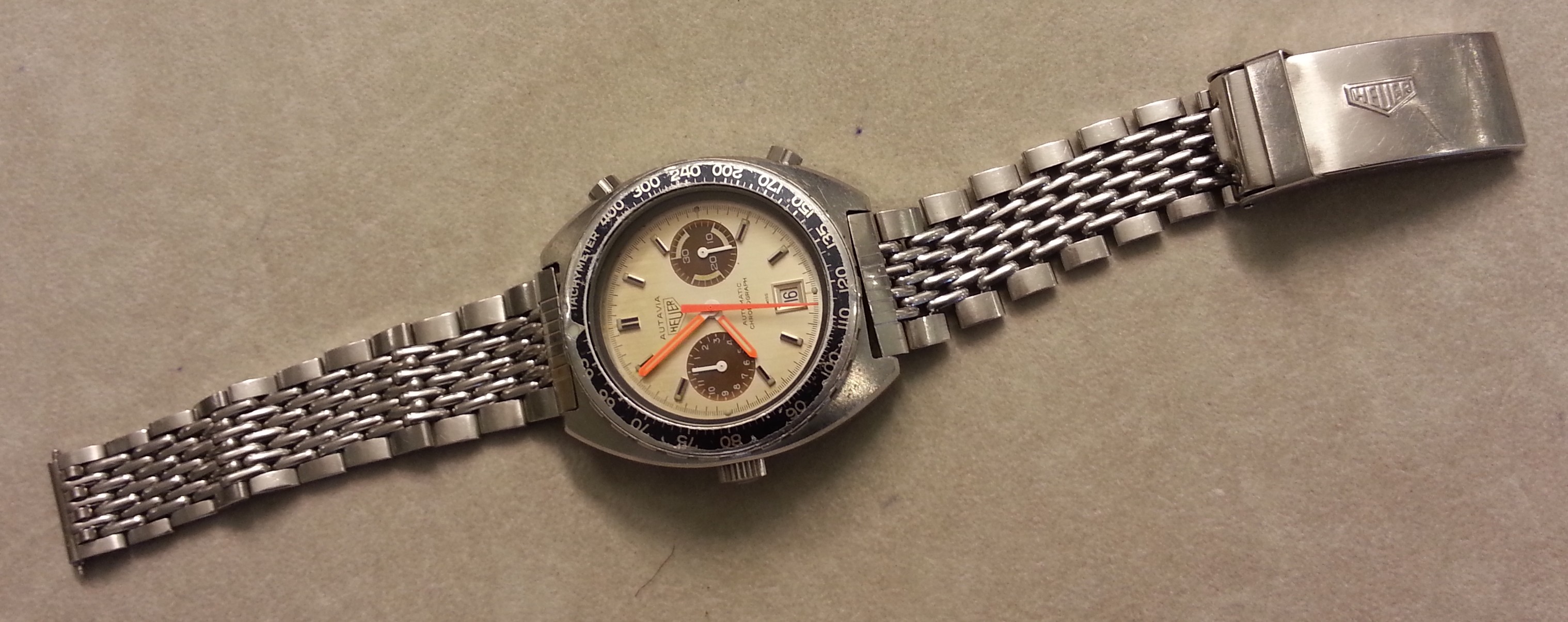

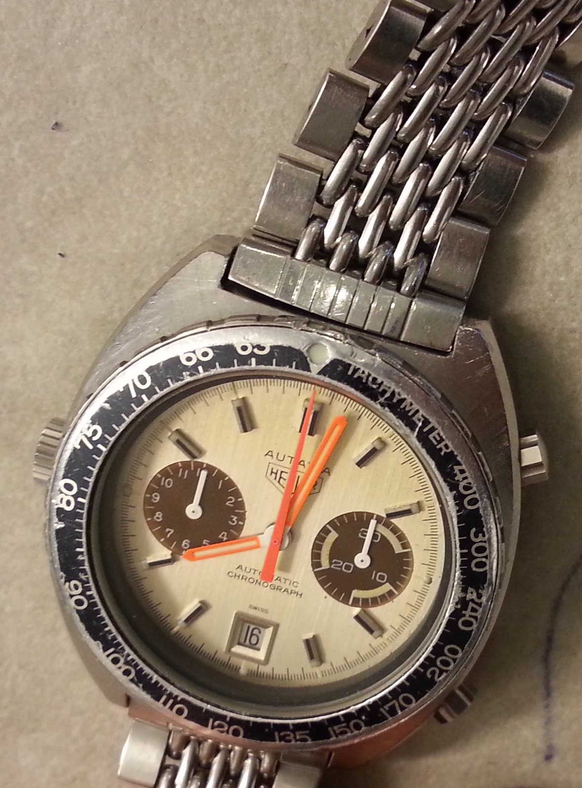

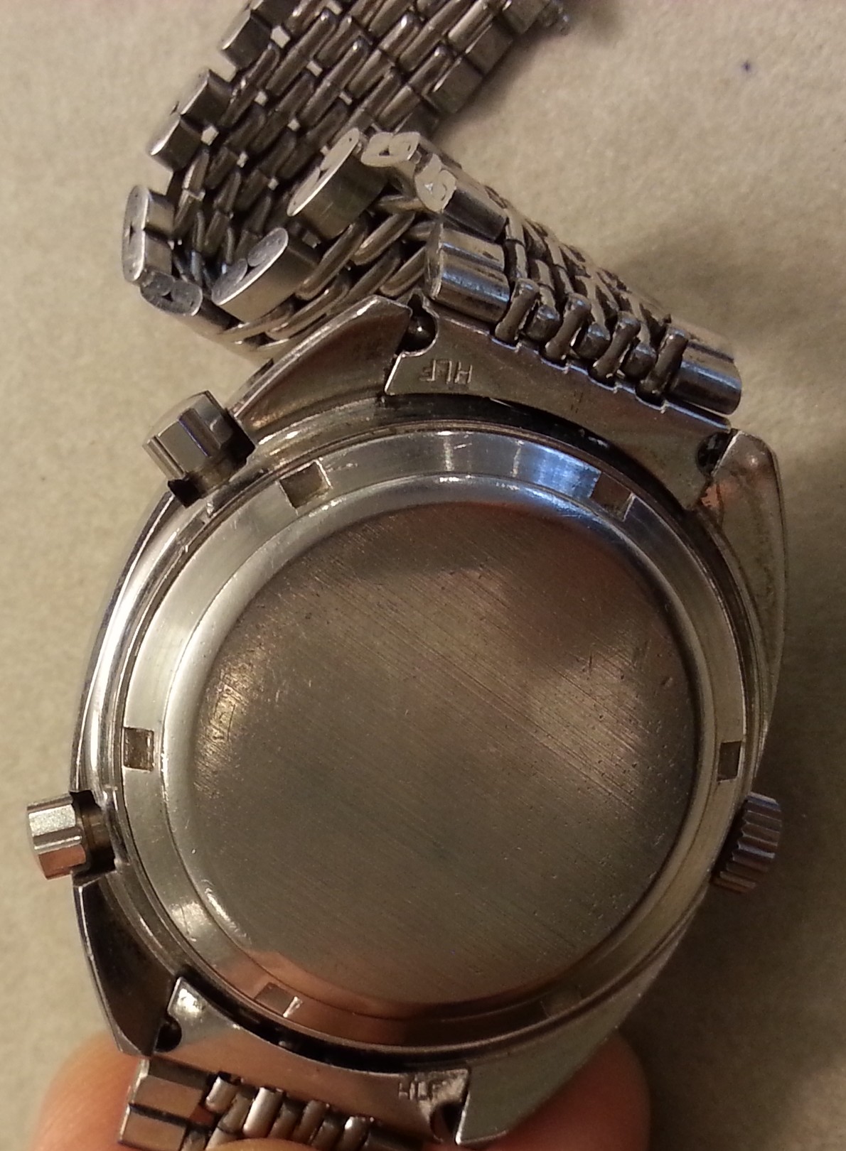

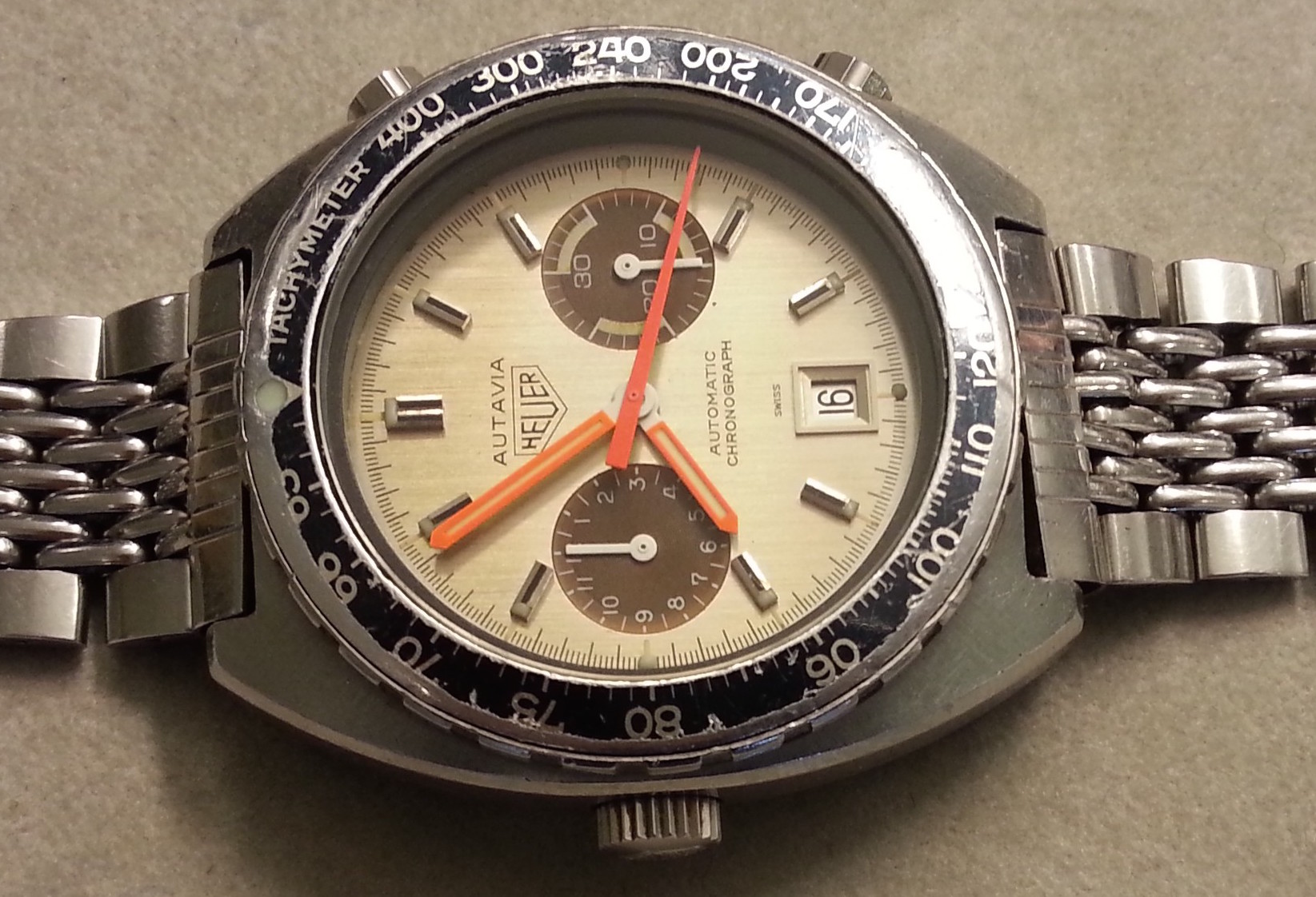

Recently I had a chance to have a look in flesh at this Autavia 11630T (3rd execution?) and did some quick mobile photos. Had it only for some minutes in my hands. It has experienced definitely rough times since it left the factory, but the dial looks very attractive to me, so I am considering a purchase and want to find out, what a fair value would be, regarding its condition. To me, as a newbie, it looks unpolished and basically to be correct?
Of course I searched the net for current market prices, but have not found to much about such creamy white dials, (left aside the real Orange Boys). I am also concerned about the general service costs and specially for the beaten bezel.
SN 261xxx
11630
both numbers good readable

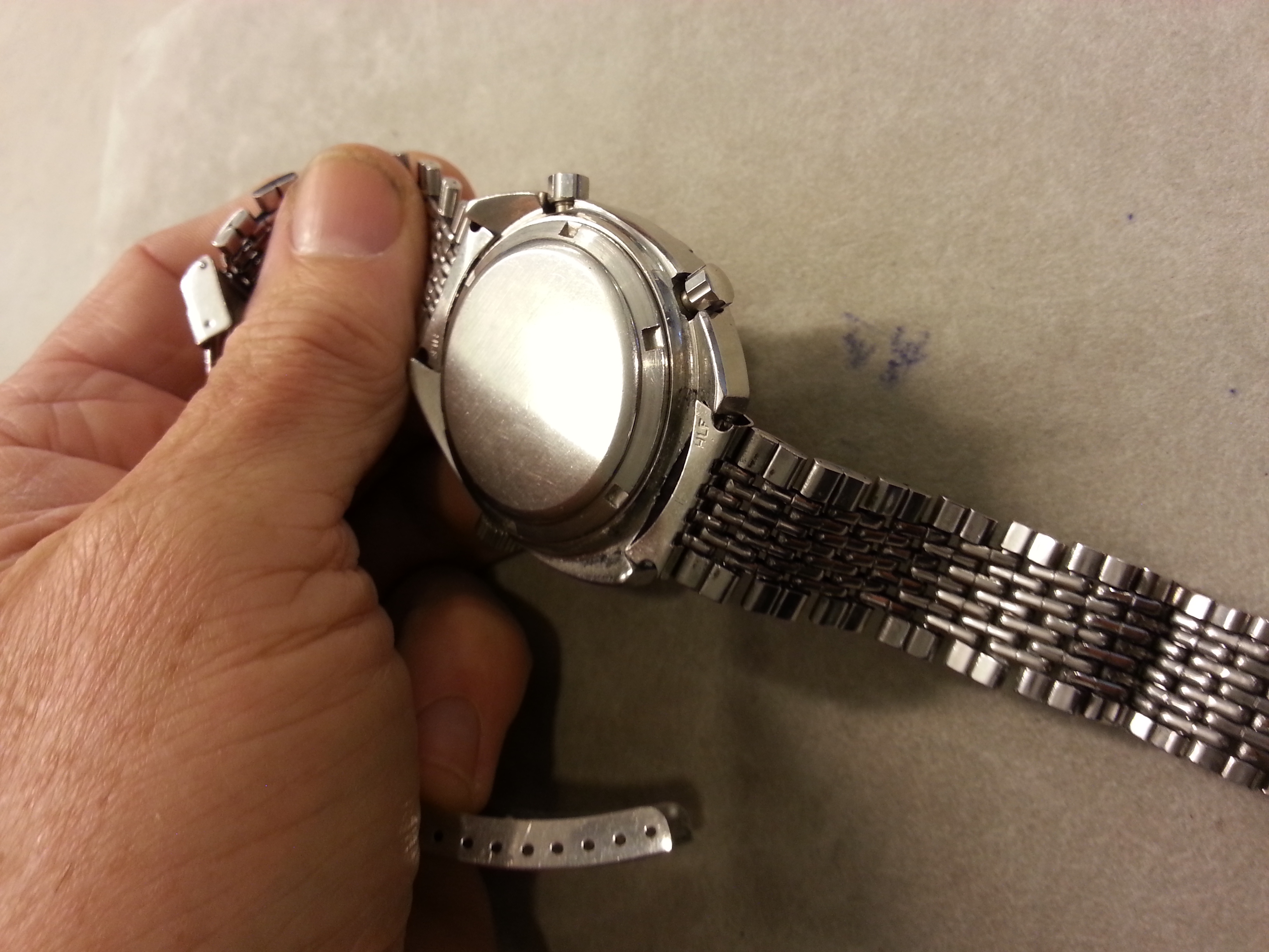

Stop functions and resetting of 30min counter and central second seem to work, but the bezel has a problem. It is very hard to turn, feels stiff and sluggish. Date function works when turning it over 24h, do not know if there is any quick set on Autavias.

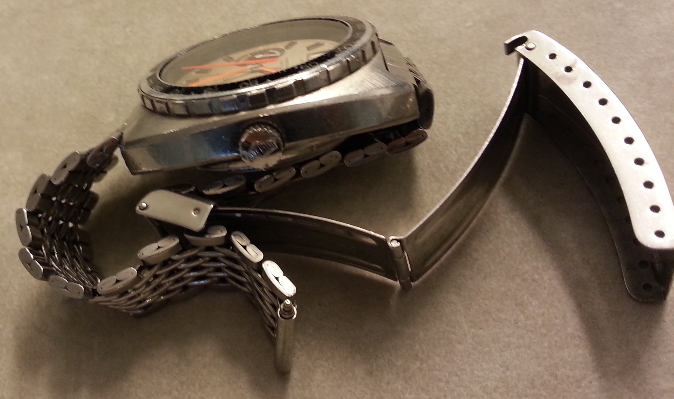

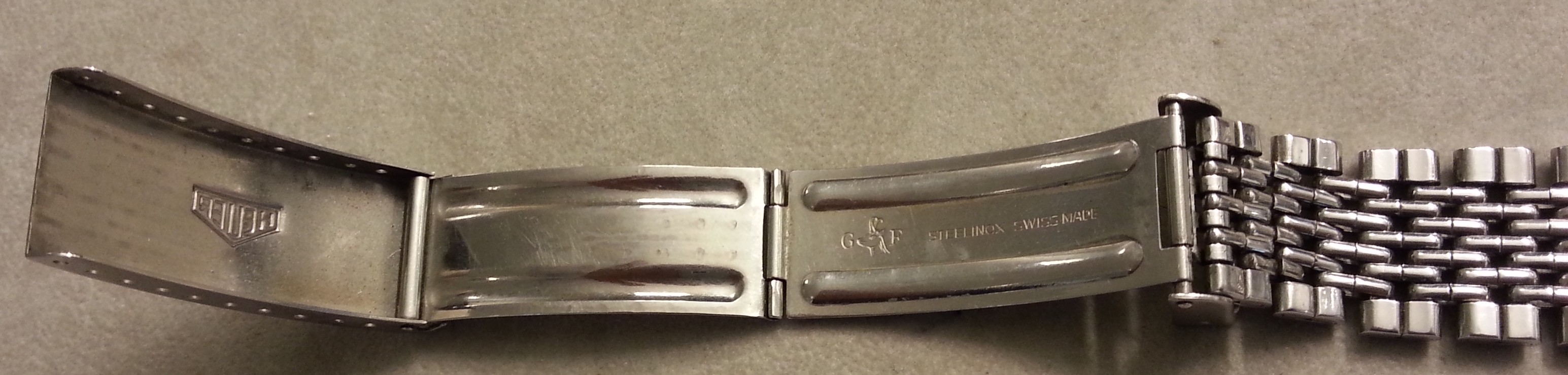

I wonder, why the GF bracelet does not have this little date signature, as I have seen on others?
So I would appreciate a lot any opinions, considerations, hints from you experts.......

Nice find- White/ Silver 11630s are hard to find. But there are a few "buts":
- The case is an 11630, as per the lugs

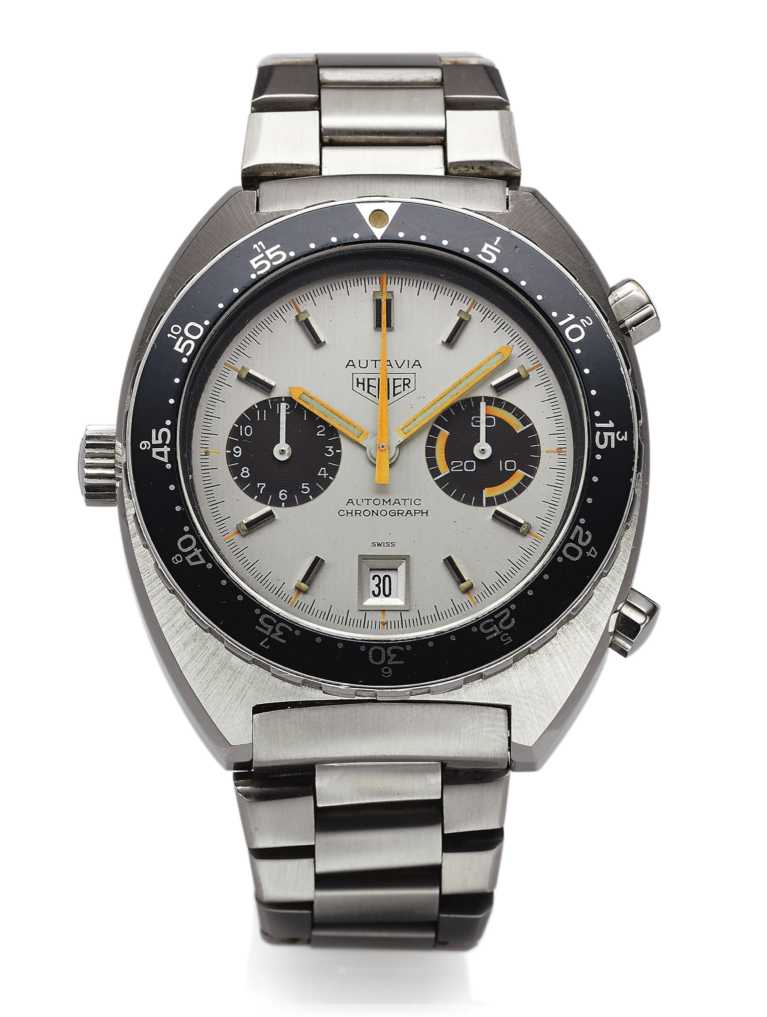

- I'm not 100% sure it's a 11630 dial...but it probably is. There is a white/ silver/ cream 1163.
- Here is a 11630 Silver with refinished lume
Differences in dial design are normal. your dial should have those Orange hash marks at the end of each hour marker- it probably did, but they've faded with time (you can kind of see them in the photo)
- Case is a bit beaten, but these are "easy" to fix (well, easy for @abcoro )
- New bezel would make a huge difference
- Bracelet looks quite stretched
There is no date quick-set on Calibre 11/12/14/15.
Still, given the rarity of these dials, I'd probably go ahead. I don't know if there really is a "market" price for a watch like this. $2000 would be a bargain, $3000 would probably be OK and I wouldn't pay $4000. Expect to pay the best part of $2000 if you wanted to get this back to its best (service, parts, bezel, case refurb).
Let us know what you do!

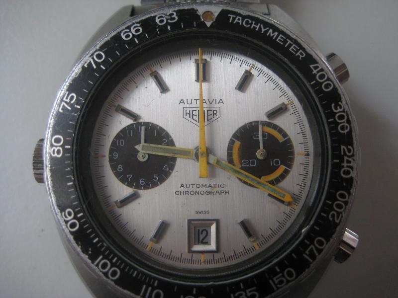

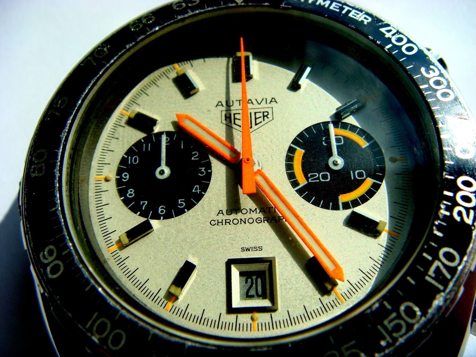

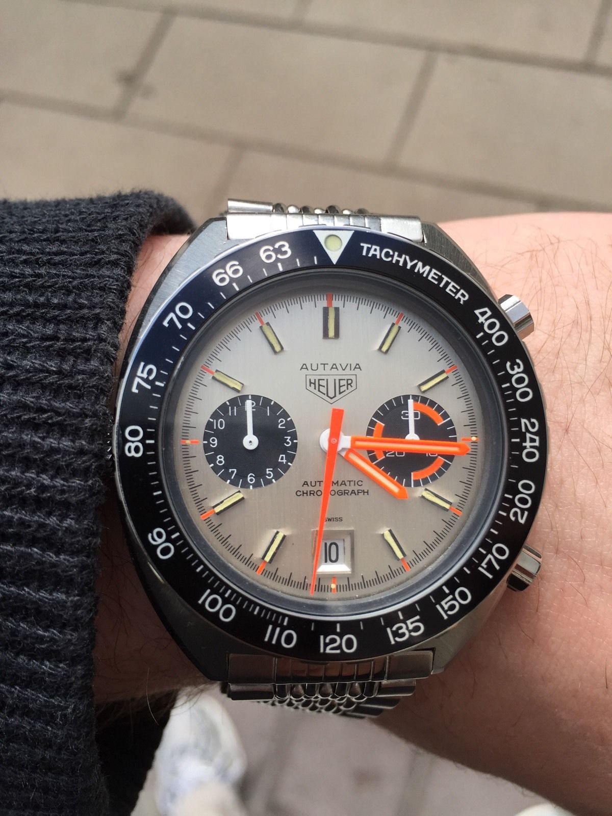

Till then I would like to show, what my little web research about recent sells of these silver whites has brought.
Different watches in different conditions, bezels and bracelets, but they all share this appealing face.
Hope I do not offend anyone here, should there be his own watch or even wrist amongst these!
