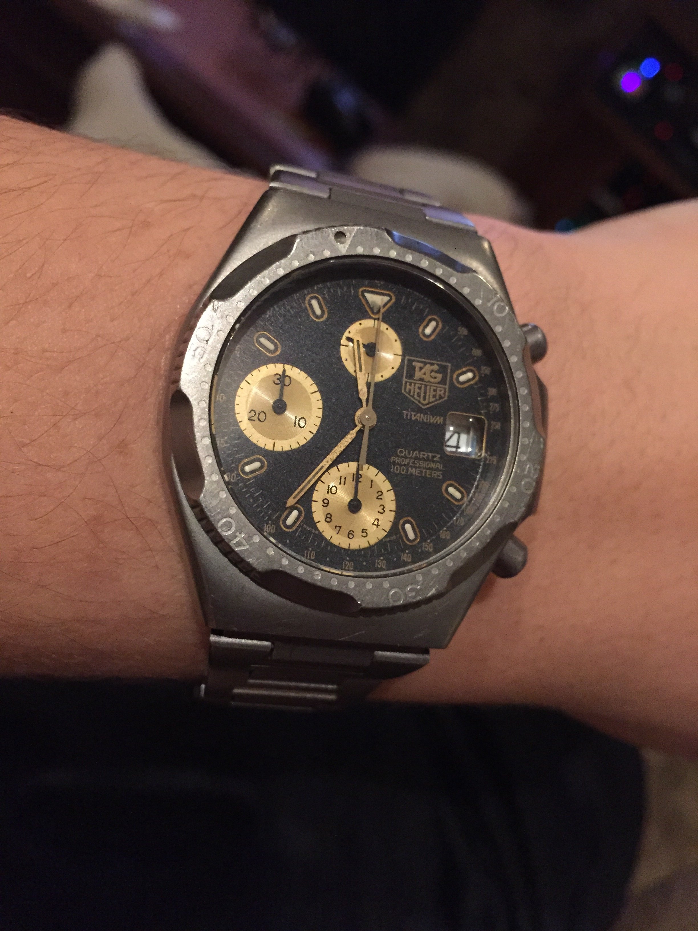

Hey all,
I'm new to the forum--My dad just passed onto me an old Tag of his, a titanium quartz from the late 80's. It looks great (honestly i love it, quartz be damned) and needs a battery. I wanted to know what i should do in order to take care of it? Take it somewhere and have it checked mechanically? Ive never owned a vintage watch before and i want to make this a daily wearer but i'm concerned it might not be tough enough or there might not be any parts for it and don't want to ruin it with daily wear (my ideal would be to wear it everyday, take it underwater, and not break the thing)--this being an heirloom of my dad's just holds significance to me. I want it in good enough shape so I can take it swimming with no fear. You think tag can do an overhaul on it?... Should i do that?! Honestly just not sure where to start. Any advice would be appreciated.
11
4
Update: Tag just informed me they cannot do an overhaul on the piece. So do I just put a battery on the thing and let it run? Is there anything i can do?

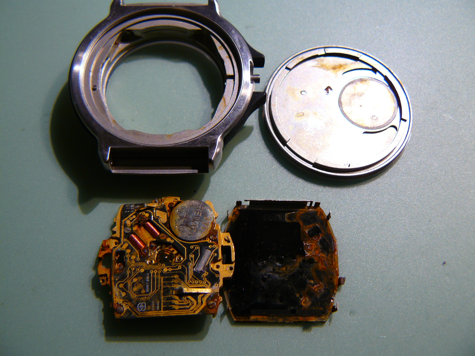

Some horror pictures I made from watches inside after someone jumped into the water with a multifunctional crown watch (Pull/ Push/ Turn but not screw-in):
